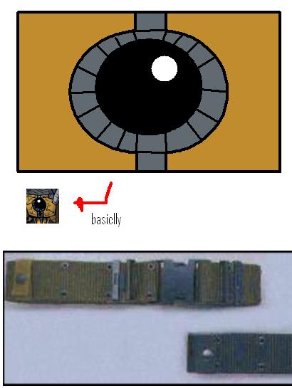

My femme mando from the mandalorian wedding photo is coming along nicely. Im a bit stumped with the cod piece. There is a black semi transparant dome on the top. It looks like an R2-D2 eye. Any suggestion of what to use?

get a small square of plywood. If your "transparent dome" is say, 4 inches in diameter, get a 6" sqauare of plywood and cut the 4 inch circle out of it. Now get yourself some smoke tint acrylic probably bout 1/4" id say...and heat it up in your oven.
now your best bet is with that square make a little box that will hook up to a vaccumm. Like with the hose connection. Once you have a sweet little vac box, get that acrylic nice and hot and flimsy. pull it out and set it over the hole, and then turn the vac on...but turn it on in spurts...and that should give you your semi transparent dome.

hmmm, I dunno but that just looks like her belt buckle, granted it looks like it's a black semi transparent dome, like a jewel maybe?
My suggestion to you is to wander the toy sections in search of an oversized "cow eye" marble or rubber bouncy ball (I've seen some of those at Target years ago). I'd suggest the rubber ball because it would be much easier to cut in half and turn into that "dome".
Failing that, I'm sure you could do a search on "acrylic gemstones" and find the right sized orb/jewel to use for that belt buckle. Incidentally, craft stores also carry orbs that are in fact two halves you can fill with decorative greeblies and turn into (christmas) ornaments, one of smaller size could also do nicely.

yea i think that is a belt buckle, maybe a USMC quick release style belt just more built up around the sides and the Gem in the center, you could possibly make it out of sintra or some other plastic and glue it on the front of the clip
