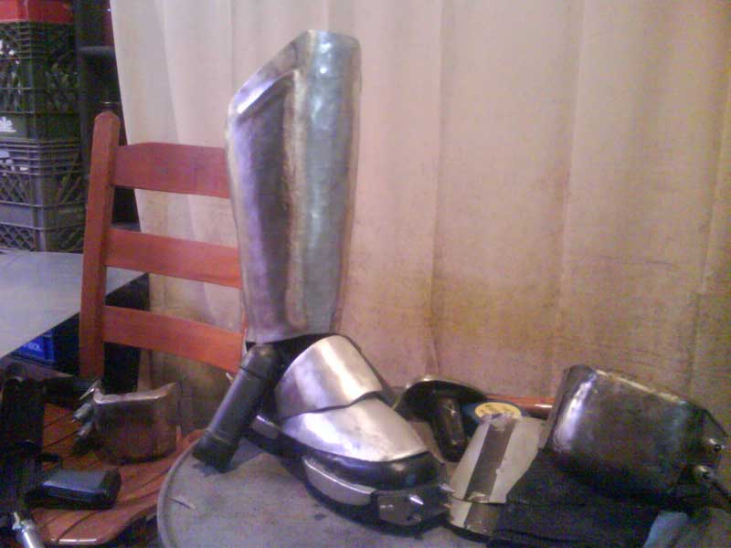

I've designed a very mando looking articulated heavy boot armor. 3 pieces hand hammered out of 14 guage aluminum and articulated (how we describe moving armor in the armorsmith world) to allow for maximum foot movement.

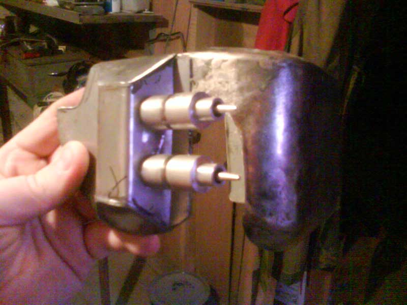

Also an updated picture of the stainless steel knees I've been working on. I decided to go with a heavier steel so that I can actually get down on them without worrying about breakage or bending. These are 18gu stainless, and the launchers contain small nickle plated brass darts. Just gotta finish capping the launcher boxes and the knees will be ready for painting. =)
Updates!
Knees are done. I'm including a picture of one in the finished stage, and all thats left is putting in some padding.

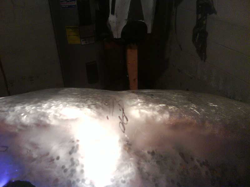

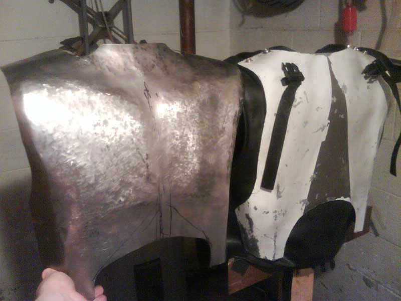

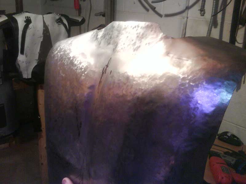

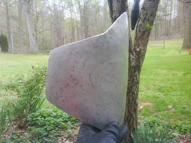

Back plate is also just about finished. I have dished the piece out so that it conforms naturally to my back structure. I still need to trim the sides and neck up a bit and give it maybe an hours worth of planishing work, but other than that it is pretty much done. I've placed some extra pics of it in here so you can see the nice sweeping curves of the back, so if any of you plan to try to the same thing then you have some reference.

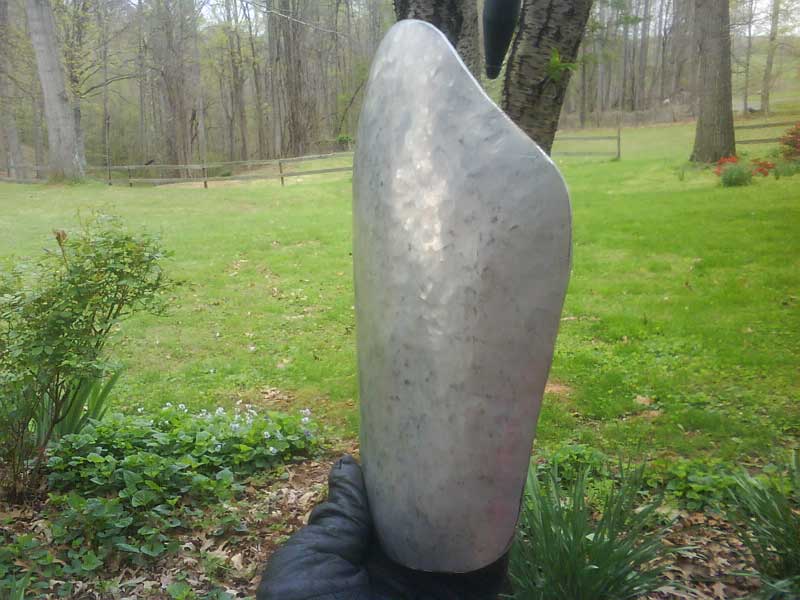

Here is the left shin armor. Skip made me some of the clone shin patterns, and I used those to build off of. These are basically a longer Jango style shin guard with a back piece that fits inside just at the bottom of the calf muscle to keep it covered yet comfortable for all kinds of motion.
I put in some flutes both on the top right and left sides, basically these are for show but it's a very nice look that gives it a deeper appearance. My only problem is that the bottom front has a crack in it that I need to fill in with some aluminum braze. Once I get the right one done I can work on the sheaths for the knives that will sit on the front of each greave.
This is what it looks like at 75% done.
I'm liking the heavy four-spiked boots - very nasty! Isn't it hard to walk around covered in all this metal? :confused:lol:
LOL yeah, everyone loves my boots! =P
Actually, it's not that hard at all. Everything is articulated to fit perfectly and move fluidly. The greaves fit my leg muscle structure perfectly, so that makes them highly comfortable. The backs of them only go as high the bottom of my calf muscle and are rolled out just enough to keep from digging into my skin. Plus with this being aluminum, the entire boot armor w/greave may weigh in at 3 pounds max.
