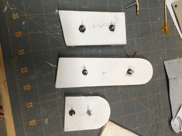

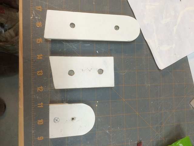

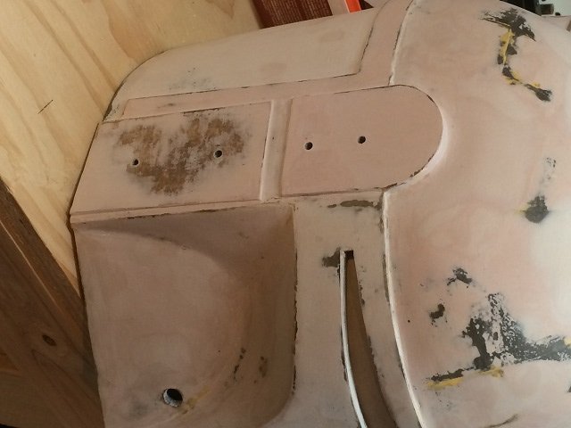

I started working on the attachment method for the earpieces. Here you can see the holes I pre-drilled in the helmet itself:
I then lined up the earpieces, and made a mark on the from the inside of the helmet onto the earpiece. I then ground-out a larger hole in the back of the earpiece large enough to completely recess a #6-32 machine screw head.:
I then hardened each hole with a little bit of fiber glass resin. After that was cured, I then set each screw in the right location while lining it up on the helmet using a dab of quick set epoxy. I then pulled the piece off the helmet and then used some JB weld to make the screws solid:

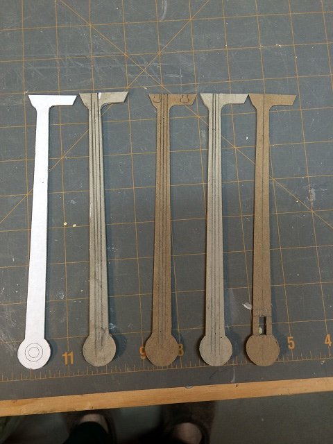

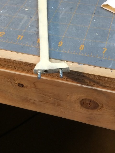

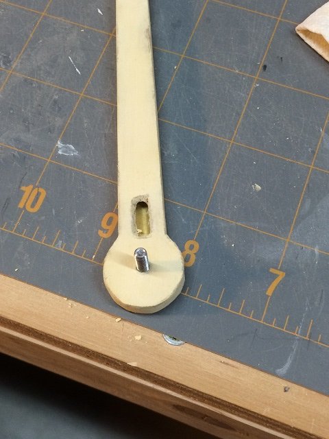

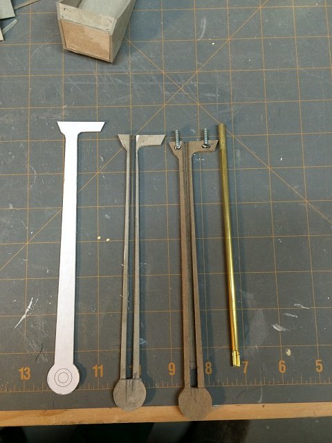

I also was working on a much improved range finder stalk that was hollow for the potentially of running wires, if needed, as well as some screws to support easier attachment of the range finder itself. I settled on using a 4mm outer-diameter brass tube which is just small enough to fit within the stalk dimensions. I used various thicknesses of cardboard so that the total thickness would add up right. You can see each peice here, with the hole at the base of the stalk cut out:
Here the stalk is partially put together. You can see the brass tube with the end cut and shaped for the base end of the stalk (the brass tube will actually go in face down from what is shown here, but this way you can see the shape I made at the base).
I ended up using some jb weld to really hold the screws in place. I epoxied the tube in place, and then glued the remaining layers and clamped it all very tight over night. Here you can see the base and the end of the complete piece, after some initial filling and sanding. The stalk is also quite strong with the tube giving the stalk a lot of structural integrity:

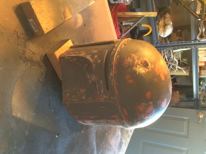

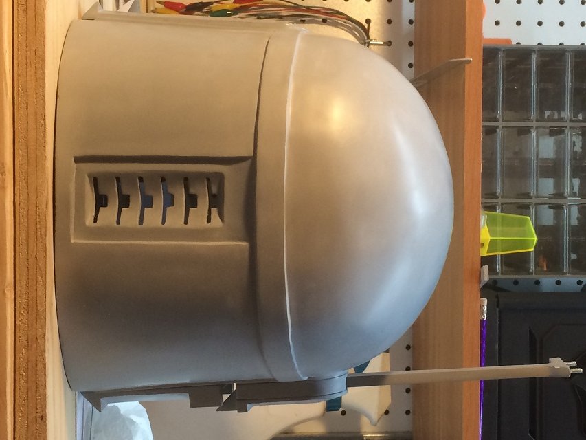

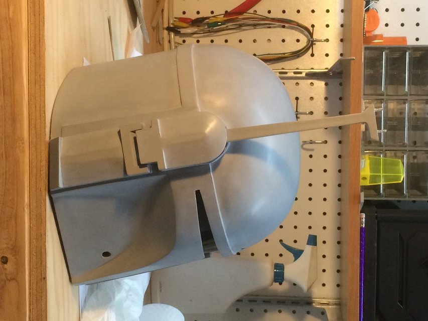

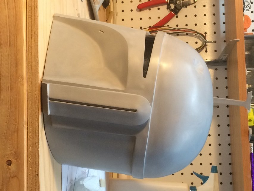

Here's my latest. I primed the helmet using an all-purpose gray primer to find all the imperfections, of which there very many...
One thing I found is that I didn't like the all-purpose primer as it took well over 24 hours to fully cure to the point where I could use glazing and spot putty without dissolving the primer. In any case, here is the helmet in a after spot putty and sanding down to about 320 grit:

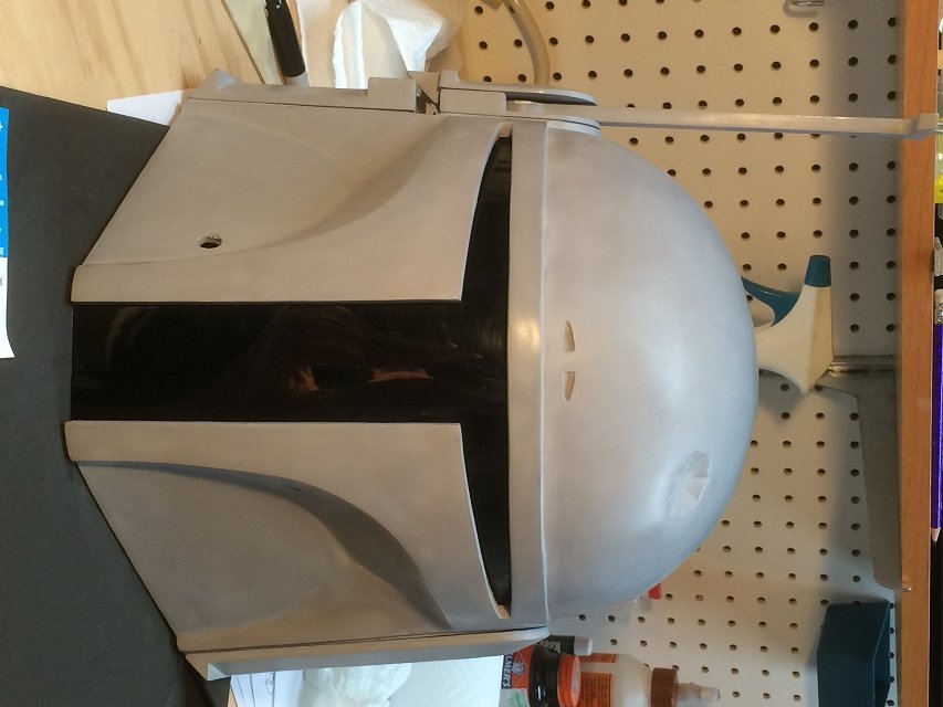

Due to the primer issue, I switched to an automotive sandable primer which worked out much, much better. After a couple of rounds of priming / putty-fixes / sanding / priming...I went ahead and put in the visor temporarily (it's just set in, not secured at this point) Here's the final helmet wet sanded down to 600 grit. It is really smooth and really looks great in person:

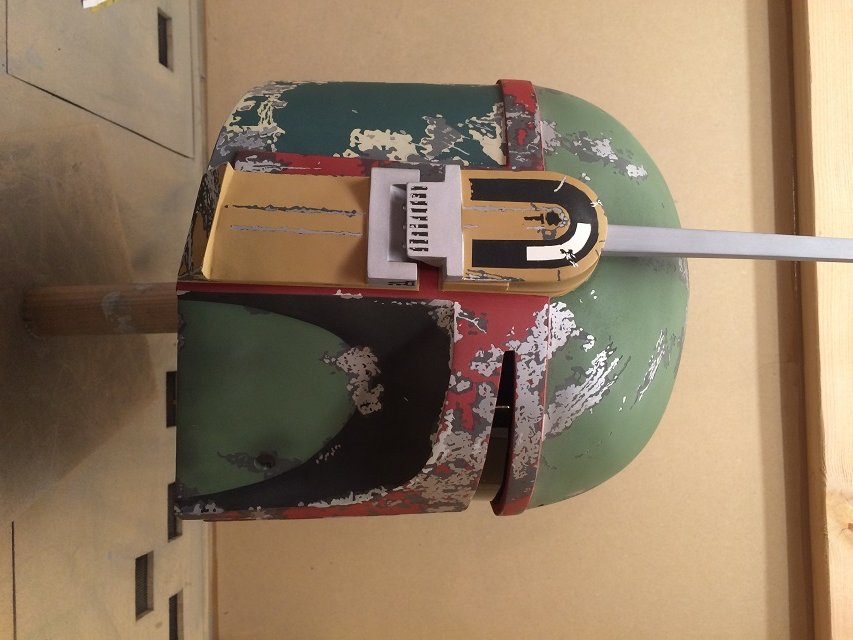

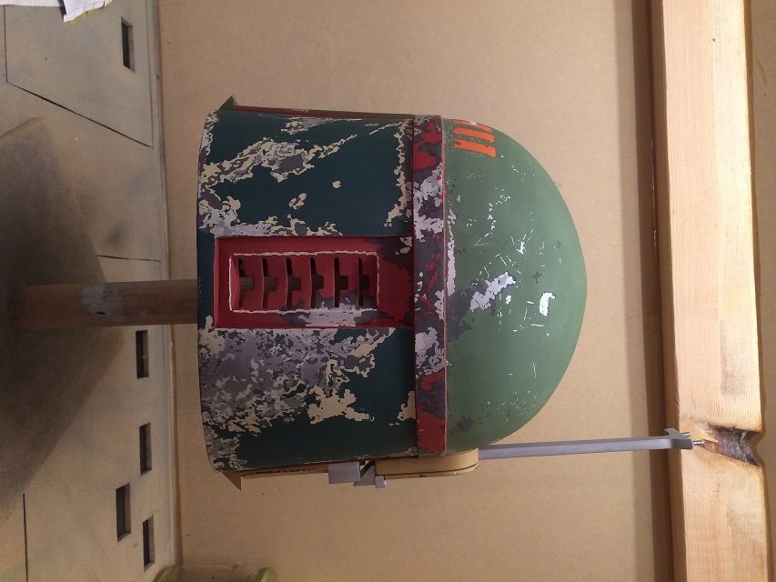

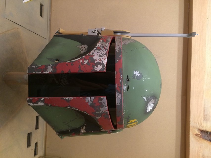

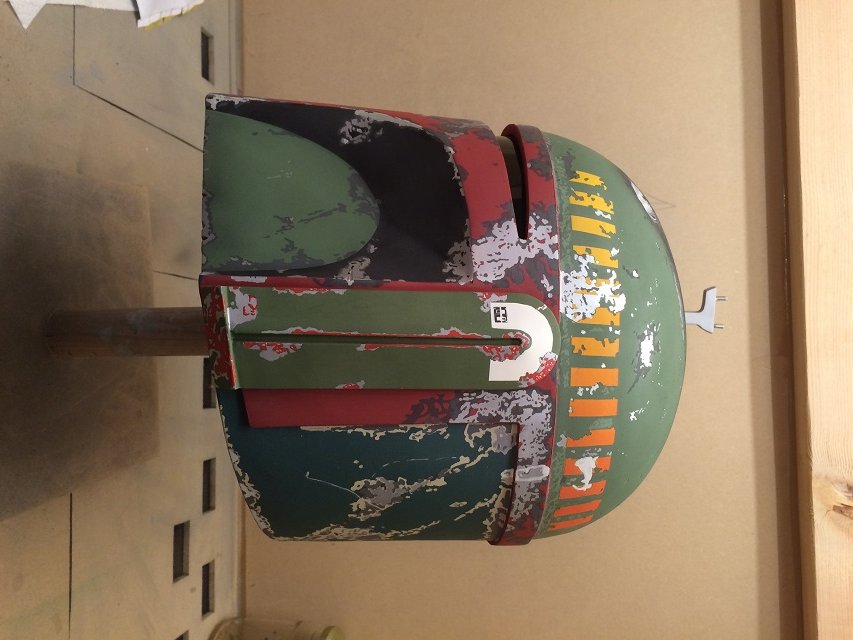

I've spent quite some time working on getting this lid painted up, so I thought I'd go ahead and show the results. I am pretty happy with it as this is first helmet. I still have a few minor details here and there in addition to possibly using the 0000 wire wool to tone down a bit of the carbon scoring / weathering in a few places. I have the borden, but I forgot to put it back in when I snapped these pics. Oh well. I am looking for a good ESB style MQ-1 circuit board for the back if anyone can suggest a good source. Anyway here are the pics:
