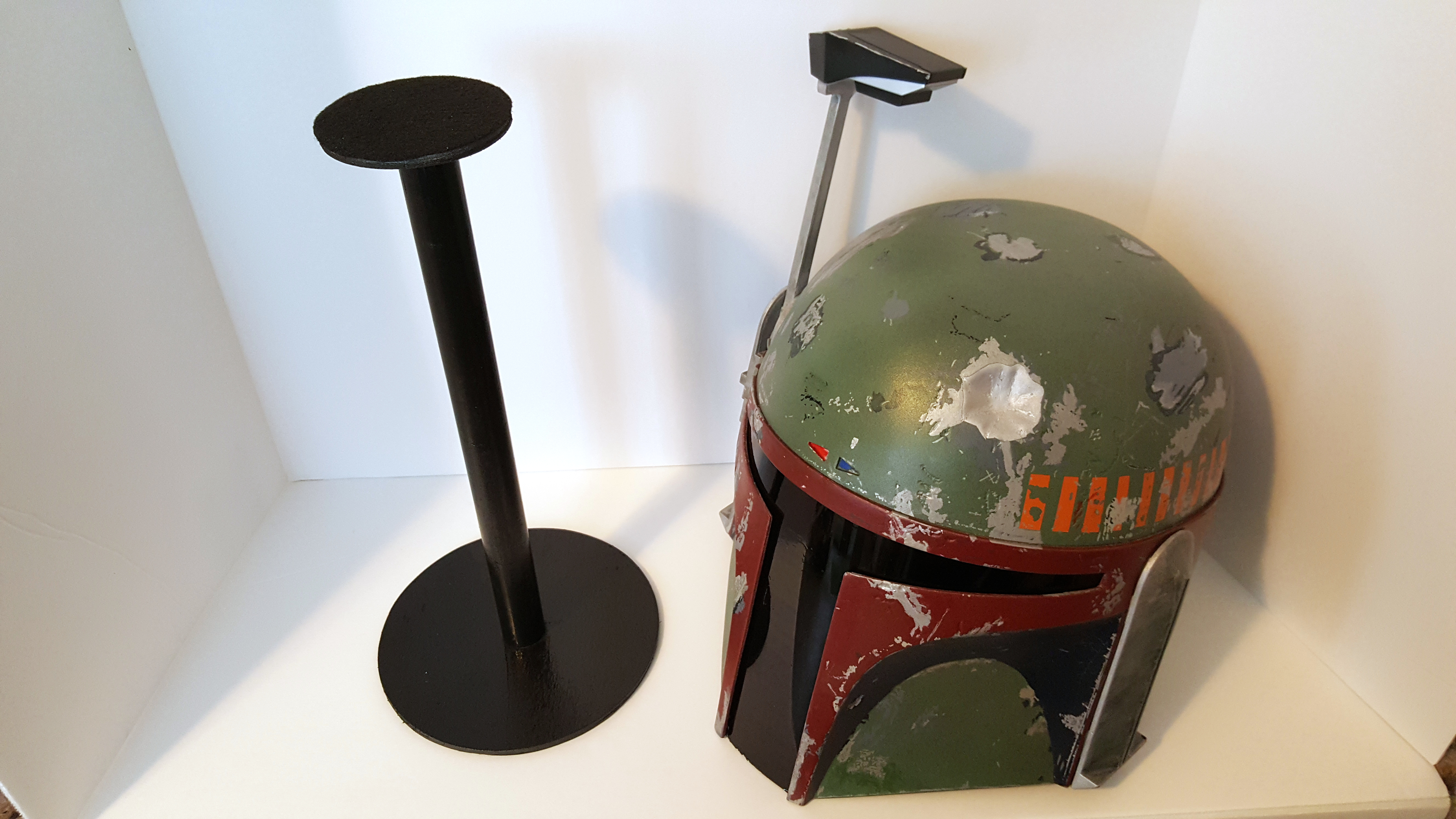

First, cut the dowel rods to the desired lengths ( in this case. 12" for my Fett, and 15" for my two Stormtroopers).
Pre-drill about a 1/16" hole in the center of only 3 of the 6 and 3 inch discs, and also pre-drill a one inch deep hole in the center of both ends of the sized dowel rod.
Using regular 1x1/8" wood screws, tightly, but carefully screw the base and top discs into either end of the dowel, making sure not to over tighten and accidentally split or strip the wood.
Then using regular Elmer's , (or dedicated wood glue if you like ), glue another non drilled 6 inch disc to the underside of the 6 inch disc you just screwed into the dowel, and do the same for the top disc, with another non-drilled 3 inch disc.
Squeeze them together for a few minutes to promote adhesion, then tape them tightly and securely together, to keep the discs from separating
( this is the Sandwich phase)
This hides the screws, and also give you a finished flat surface on both ends. ( pic 1 )

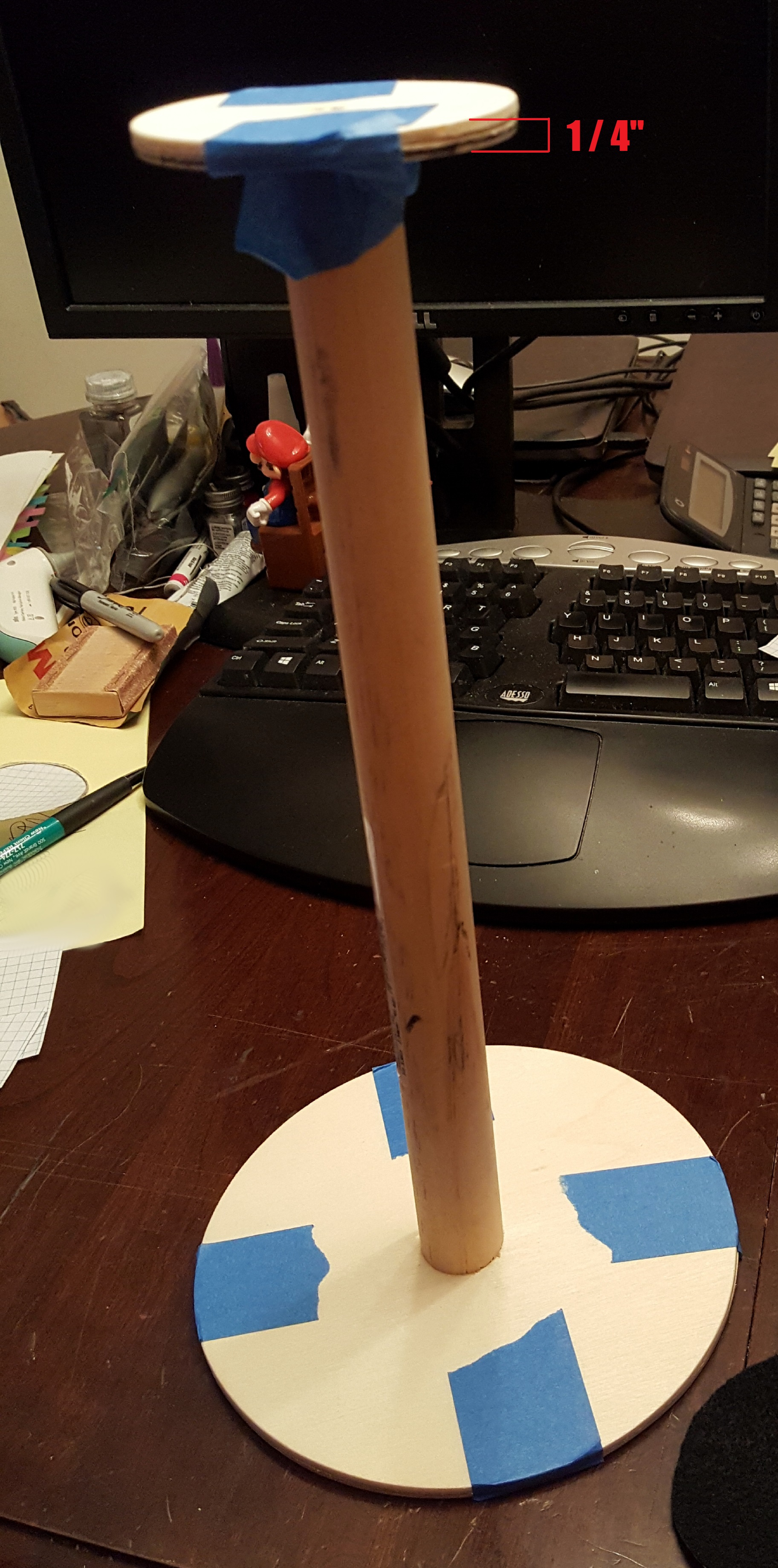

Before painting begins, remove the tape from the glue stage, then tape out the round bare wood on the top discs. ( and bottom if you like, although if your paint area is properly maintained, and you use some fresh drop material/news paper, the bottoms should remain clean on their own.)
Begin painting, remembering to evenly pass back and forth over all areas of the stand, pressing and releasing the nozzle as you pass each time, and keeping about 6-8 away from the stand.
This conserves paint, and gives a better, more consistent application.
I only had to do two layers on mine, but took some extra care in making sure the edges of the discs were adequately covered.
After they dry, one coat of Gloss Clear is all I needed.
Again, wait to dry completely, so no smudges or fingerprint accidents happen.

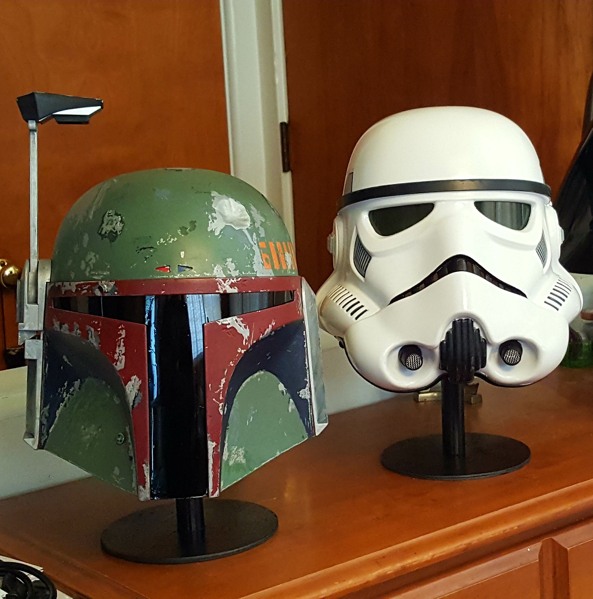

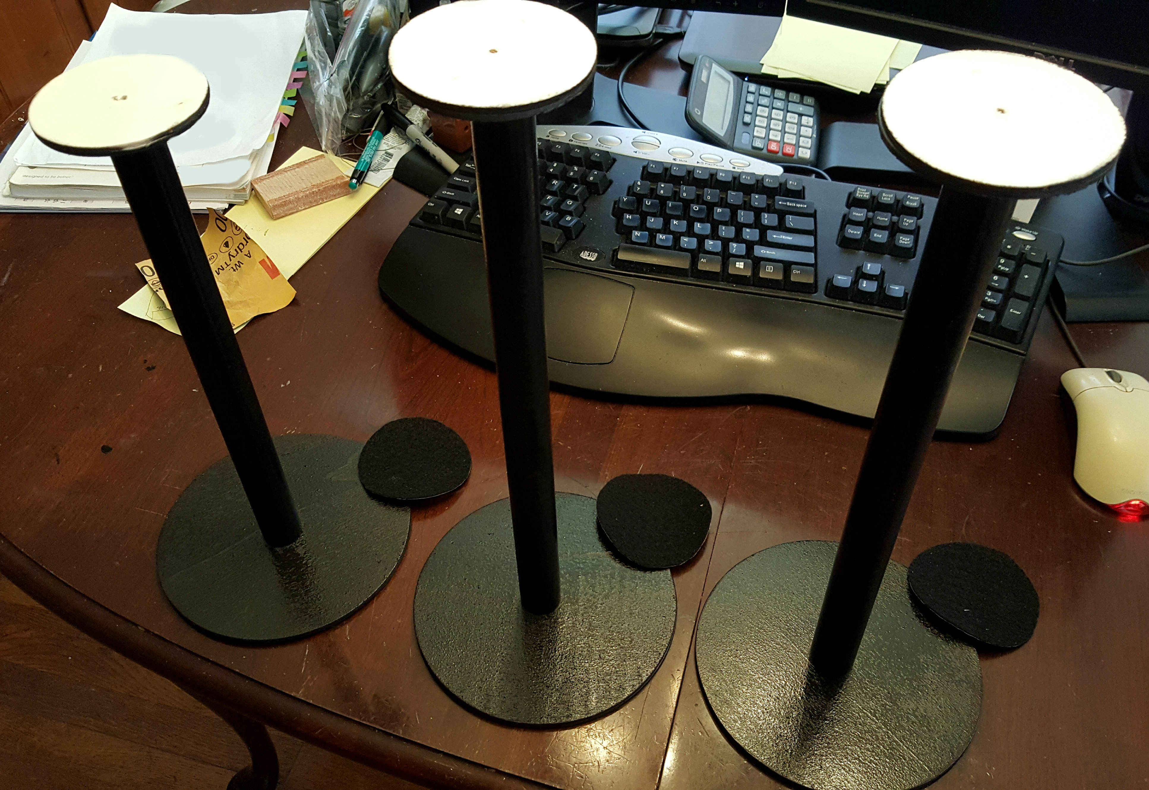

Remove the tape on the top discs,(pic 2) remove the backing film from, and then center your felt discs over the top of the discs, and apply them evenly (pic 3).
You are now ready to display. (pics 4, 5, 6)
(In helmet shots, my Hasbro Black Series Fett ESB to ROTJ conversion, the Hasbro R1 to ROTJ Trooper conversion, and my EFX ANH Precision Cast replica ).
After all said and done, all the materials I had to buy, broke down to $8.00 per stand.
