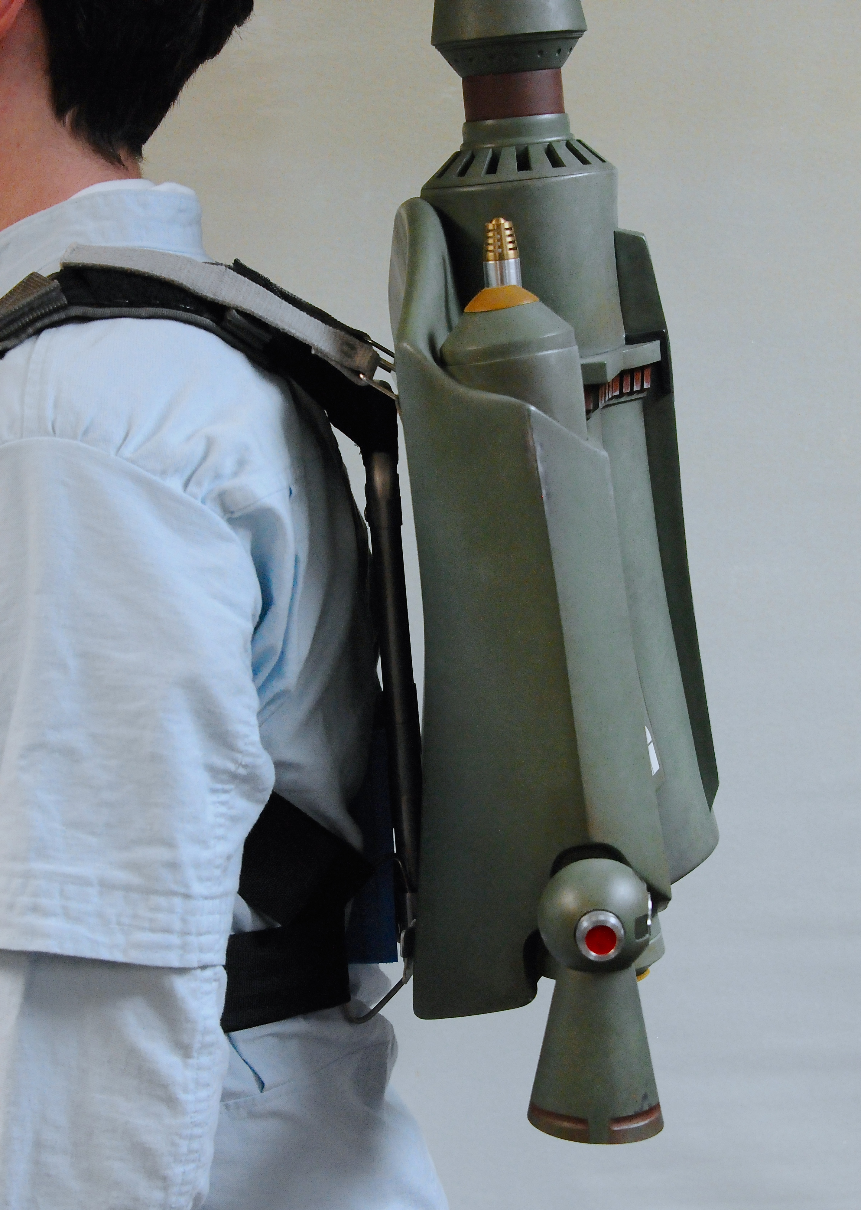

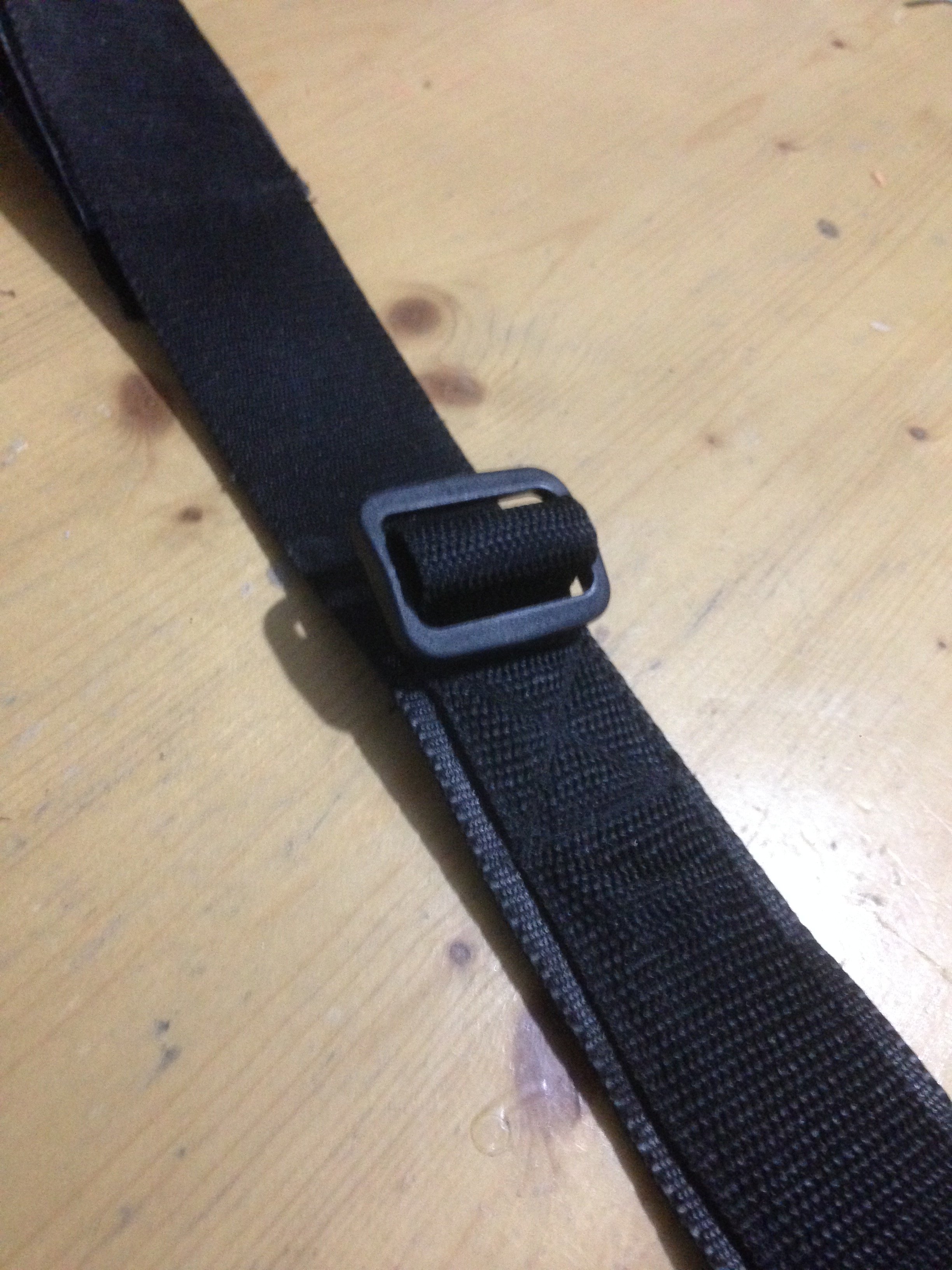

2. Jetpack harness. I have the Bigdane HHProps screen accurate version, but I feel like the 2 shoulder straps aren't doing squat. They just pop right off with any small movement. What's the best way to keep them nice and taught for every troop? Or is there a more "troop friendly" jetpack harness that isn't the traditional scuba frame?

2. The scuba frame harness from my understanding is really one of the better ways of attaching the JP and is one of the "coolest" (temperature wise) for the costume. You might want to post pictures on how your harness is setup? The two top straps should not be sliding off and are more then likely not properly cinched.

The traditional harness is defintly the best solution for trooping. Other solutions like a vest with attached straps dont sit that tight so they move and a vest is pretty hot. I did 8 hours without removing the backpack.
Your hooks may need adjusting on your jetpack or the straps shortening . The jetpack sits on the bar and thecsteaos pull it in towards the top.

Getting the straps to connect tight to the jet pack was tuff for us as well. I made the connection on the shoulders with Velcro for adjustment and bent the pack clips so the
strap rings just pass through the hooks. The main connection should be the bottom rail with hardly any weight on the straps themselves. The jet pack should set
vertical so as not to cause 'pullback' on the collar.
Ours move but not enough to come off. I did consider putting a small piece of black foam low down between pack and armor to gently push them apart and keep things tight
while trooping. It's a balancing act to make these things work.

This is awesome, thanks. Yeah I have almost no weight on the top straps which is part of my problem, they just fall right off the clips :lol: I have little adjusters on the straps but when my wife pulls the straps through the holes in the back plate, i think the adjusters are moving slightly and elongating the straps. I'm thinking about finding a good length and just stapling them so they don't move anymore.

You could attach webbing sliders onto the front of the shoulder strap . You could then have a longer strap that attaches to the jetpack and adjust each side to suit by pulling the strap from under the front of the flak vest

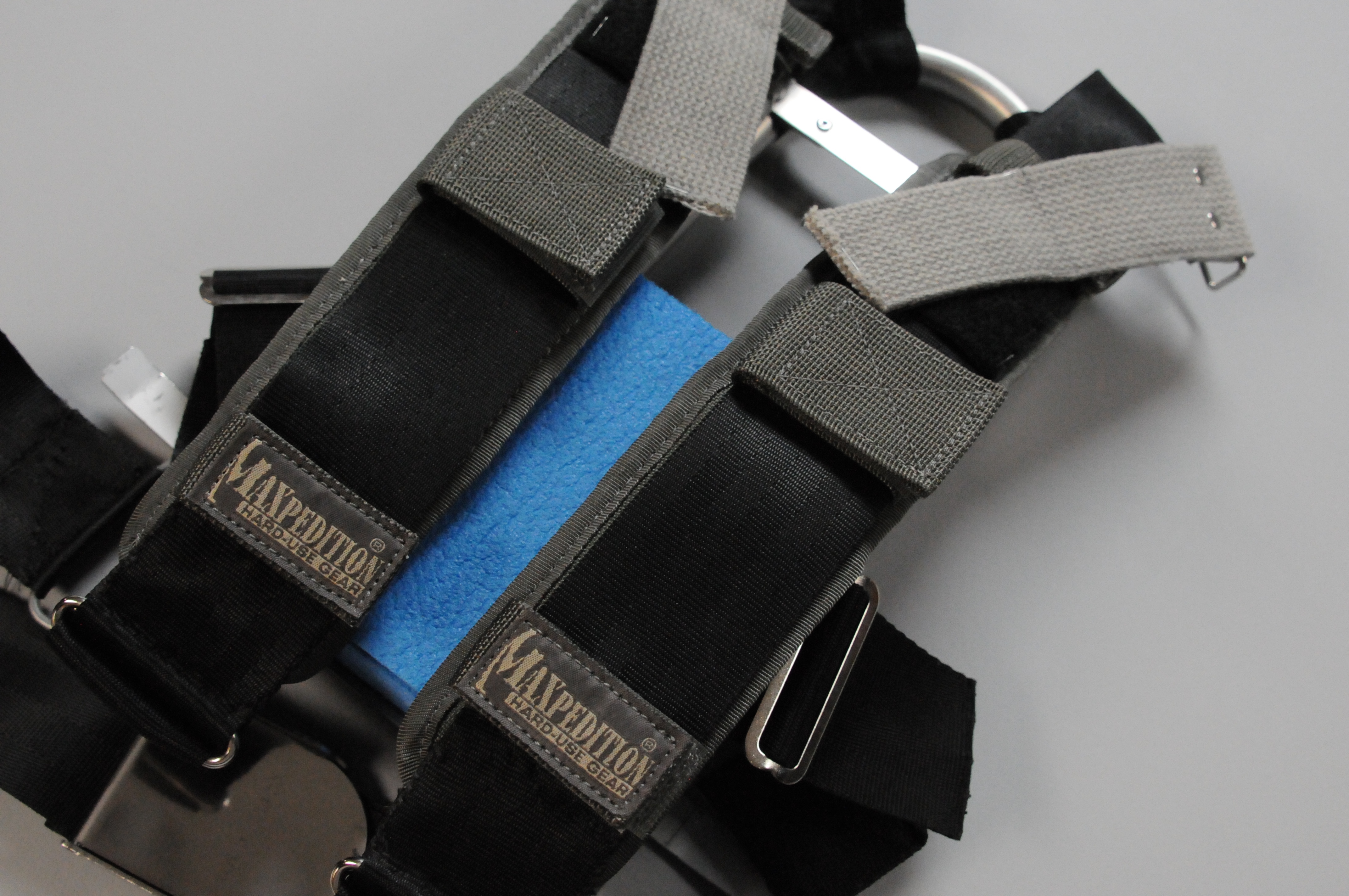

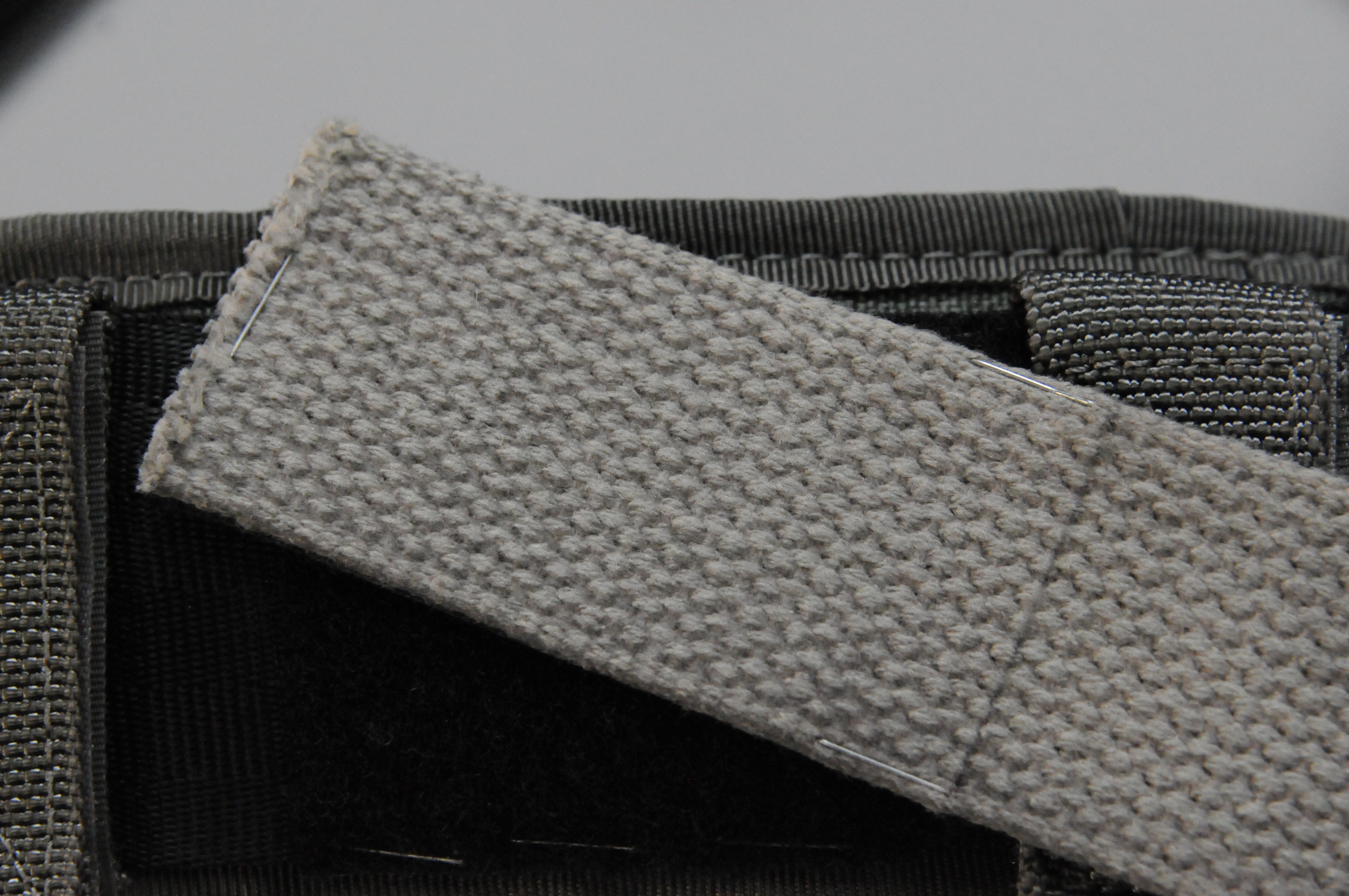

I know that it seems overly simple but for ease of adjustment we use good old Velcro and it has worked well.
It's hard to pull Velcro apart horizontally which is the direction of pull on the jet pack. Just use good size pieces
for plenty of contact. Once set it will be less parts to slip and less to mess with on future changes.
A few pics of our setup.
I know this is a minimal fix but there are a lot of ways to over think things and starting this simple worked for us.
