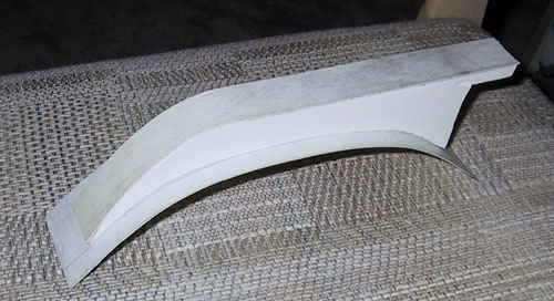

alright, so since i took out the original fin cause it sucked, i made a new one out of Bristol board, and taped it to another piece of bristol board, and fed it up from inside the helmet. (
- not my picture but it shows exactly what i did). i dont think im going to change the angle of the mouth piece seeing as it will be insanely hard, and i probably will NOT be able to get it the way i want.
