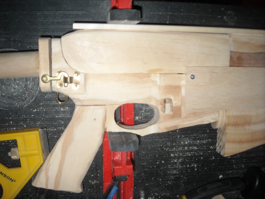

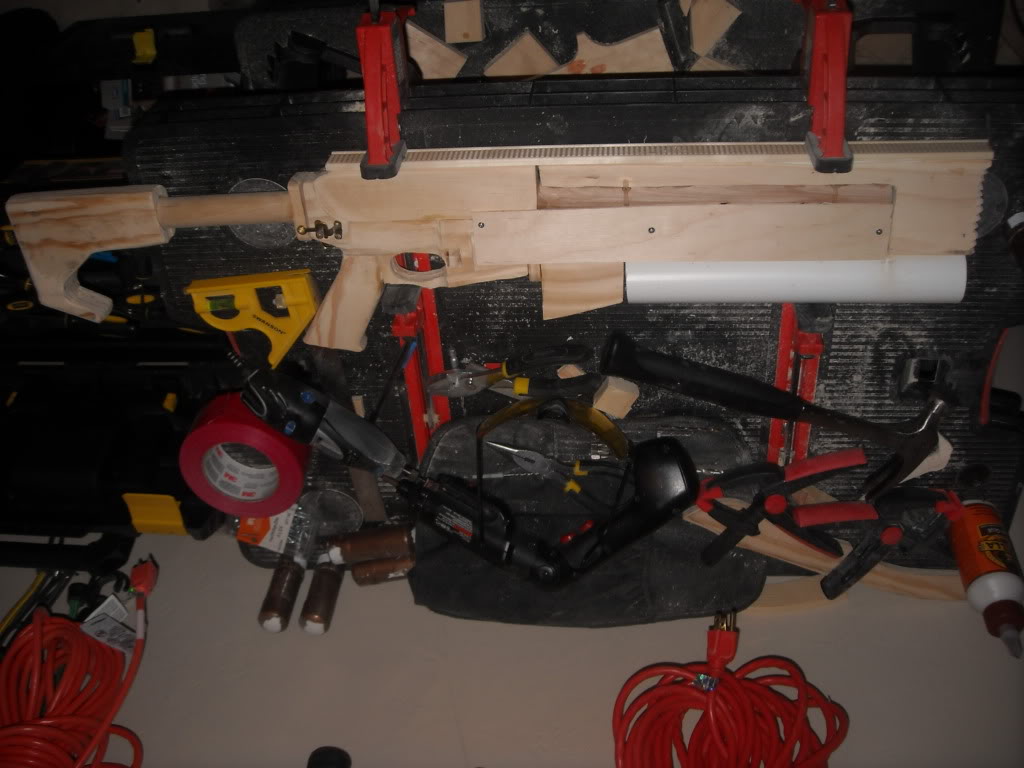

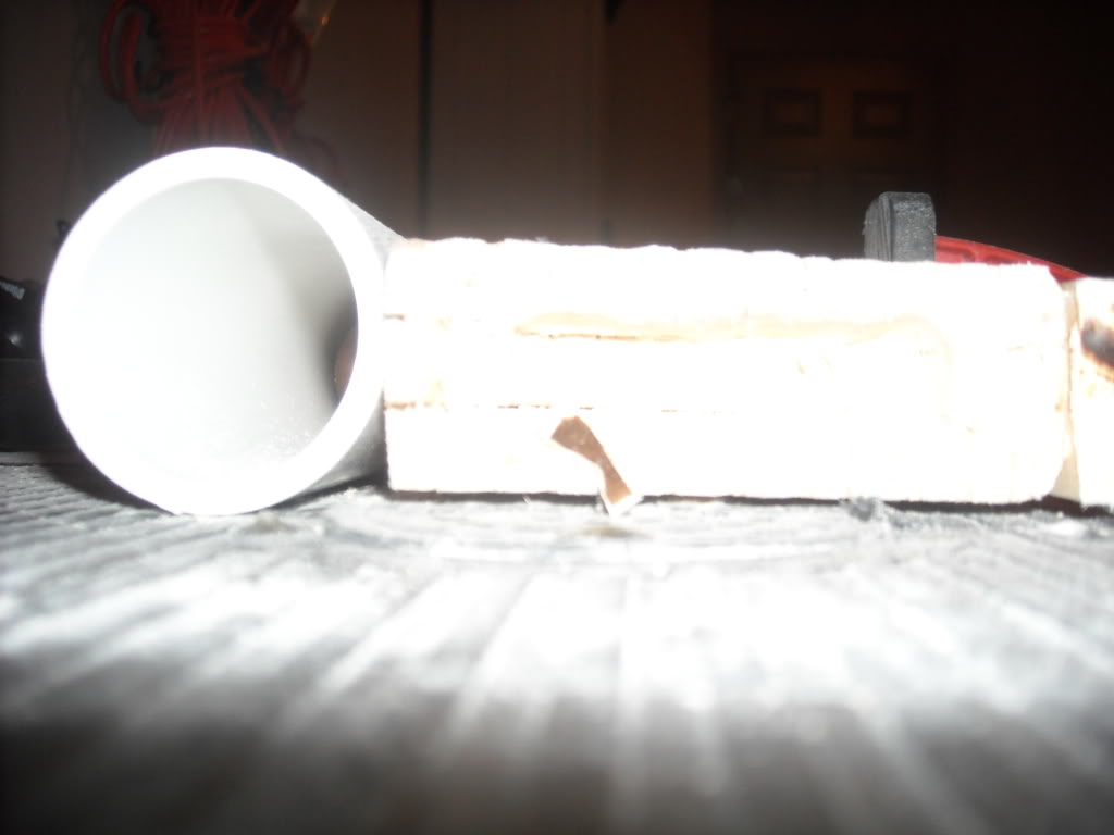

more progress... still on the rifle this time. However, it's so close to finished I may work on the plates again next week so stay tuned! lol.
Awesome! This is a dumb question but how did you connect all the pieces of wood? Glue? Nails? Both? I'm thinking about building my own weapons out of wood like you're doing.
glue and woodscrews... no nails in there but I do have a lot of woodscrews to hold together the main pieces, and I used Gorillaglue Woodglue to hold the majoriy of it together.
actually... I think I may make a new rifle... I came up with a pretty awesome idea that's a lil more Swarzy using an enfield action and magazine, m4 stock and pistol grip and some pieces of PVC, and some ideas i got from the Fallout 3 Laser Rifle. As for the armor, well I now know a time frame I NEED to get it done in. I want to have this kit ready by Halloween, so I'll be REALLY hitting it hard over the next few weeks to get it all together. After reviewing some threads over on the mercs, I think I will be greening out and making myself into a Mandalorian Protector.
