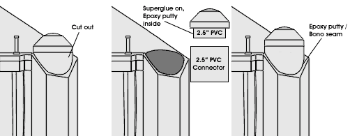

One thing that bugged be about the MB kit was the top of the side tanks, they just never really lined up with the top caps, and didn't go up high enough. I cut them out, and replace them with some PVC pipe connector which was the same diameter as the caps. Also in one of the photos you can see the rectangle detail in the centre that is missing on the MB kit.
