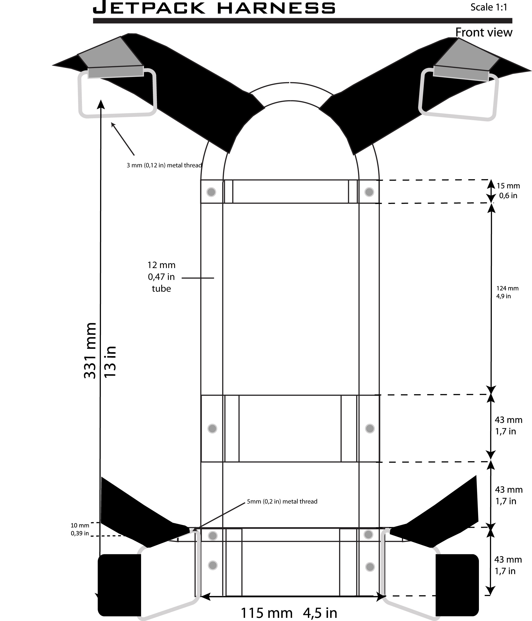

During last month i planned to make my own JP harness.
Before starting this project i submit to your expert eyes this blueprint with measurements i took from ref pics.
Do you think i'm correct?

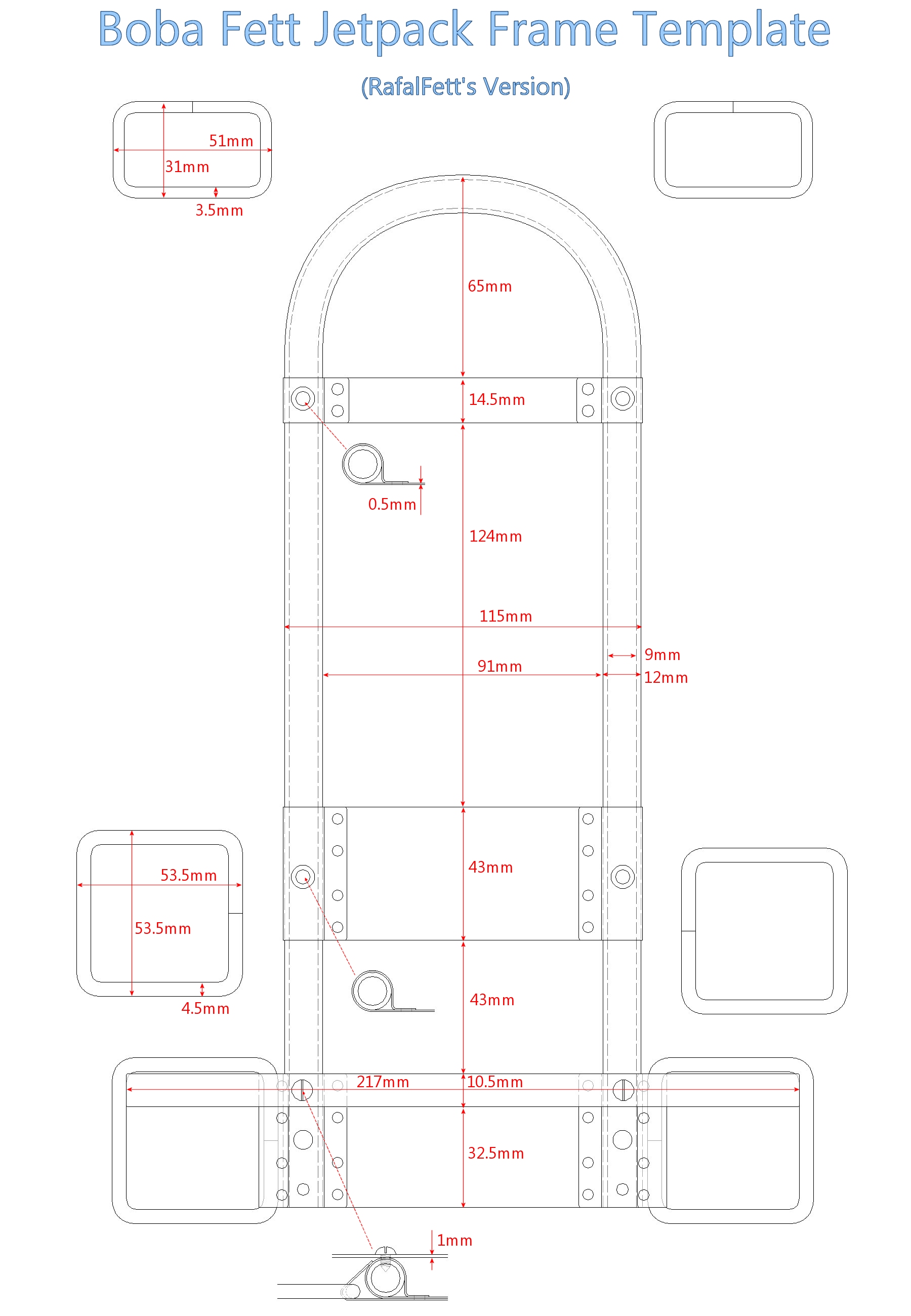

The funny thing is that I had this project (amongst others too) in work in the last months and is more or less finished (the measurements were added quickly just to show the overall size of the frame):
I used all the available images from the TDH Gallery (Supertrooper/Pre-Pro #1, ANH SE and the MoM/SWtE exibits images) to achieve the best proportions and sizes for the jetpack frame.
Hi Rafal !
I think you're the best in measurements. But i think the buckles at the bottom of the harness have a parallelogram shape, not rectangular.

Thanks a lot, StrumFett! I already modified the buckle form and I will post the updated files (in my misc template thread ==> RafalFett's Misc Templates and Blueprints) when I'll complete all the measurements.

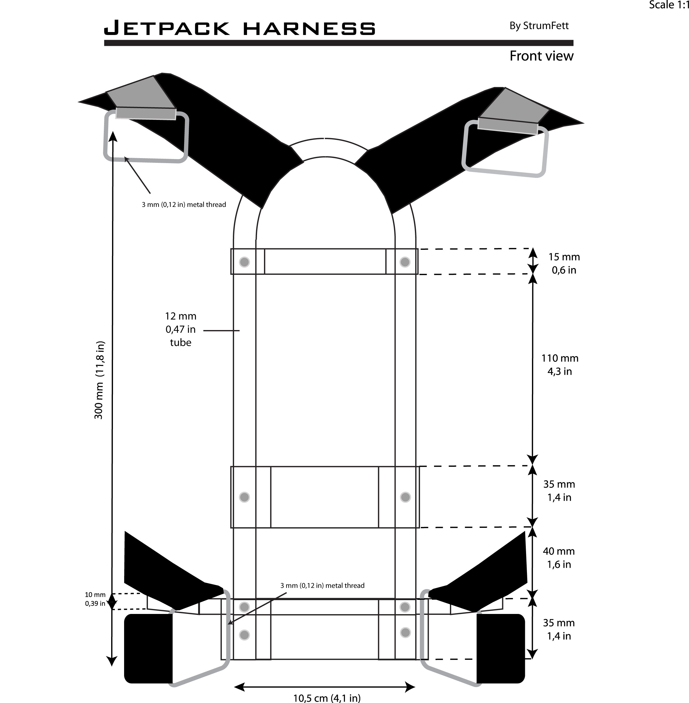

I changed some measurements of the JP (thanks again to RafalFett).
So this is the new JP blueprint :
I will start to make it real in few weeks (i have to finish my armor first).
