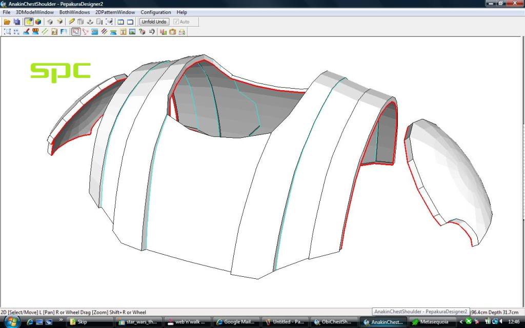

I modelled a solid one piece in 3D which I think is wearable though it will probably restrict movement but will give you the look of the Jedi armor. I will be working on a more complex multi part version at some point in the future too. With the 3D model I create templates to make them using card and fibreglass or sintra.
Here's a pic of the one piece I did:
LOL! Lately I've been doing some new 3D stuff. Those were done before my TCW Clone lid. As I said I hope to get some time to redo the Jedi armor to offer more movement and greater accuracy.

These two 3D reference photos are funny. If you noticed, that second one has this chest armor solid and on first picture it is created from plates similar as this steel armor, connected together to be more flexible. Maybe velcro from inside of these chest plates. Hm rubber armor. It sounds interesting but it will have some weight then can be problem to paint it. But generally it is interesting idea, cos it will be more flexible than plastic or fiberglass and you have solved problem with return edges on armor parts. May be hybrid/sandwich construction with reinforced core.
