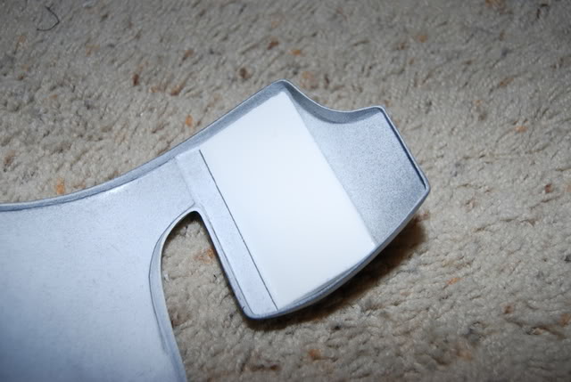

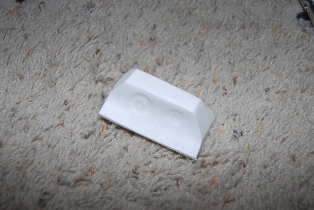

Step 1
locate your resin pieces FP included in your kit and place them into the correct knee. I suggest maybe adding some tape to hold them in place while you do the work

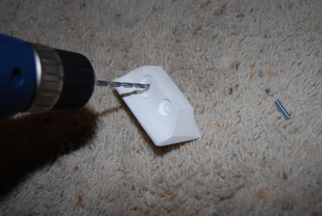

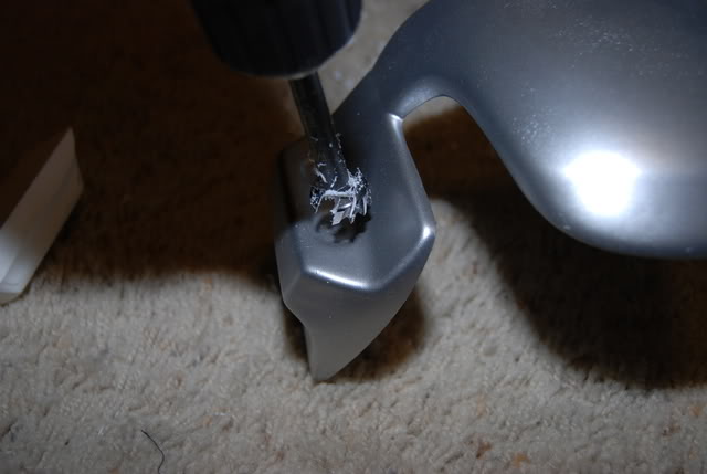

Step 2
hold resin piece in place while you drill your hole....MAKE SURE YOU USE A BORING DRILL BIT...AND MAKE SURE YOU HOLD THE RESIN PIECE IN PLACE....YOU WANT TO DRILL RIGHT THROUGH THE ARMOR INTO THE RESIN PIECE SO EVERYTHING LINES UP!!!

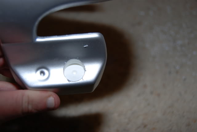

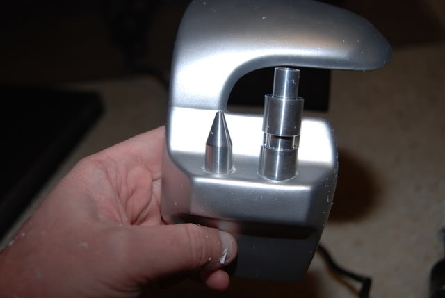

Step 3
make sure darts fit in hole...also you may notice some clean up you can do to smooth any rough edges after you drill
just grab some sand paper and it will take care of any small issues from drilling the hole

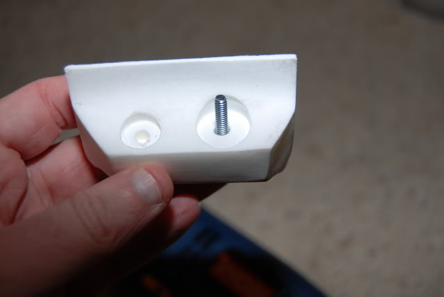

Step 4
use a Dremel and cut off the end the screw you are going to use
then drill a hole in your resin piece
after hole is drilled then JB weld the screw into place
Step 5
attach darts to screws and make sure everything fits together
