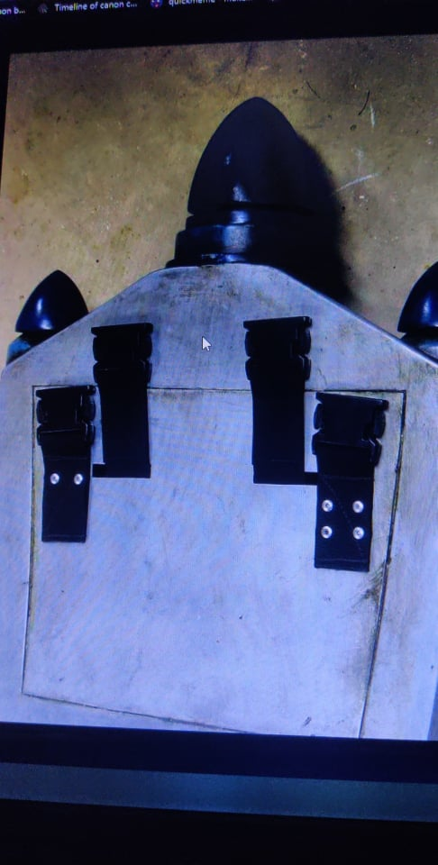

I was wondering if anyone has a visual reference on how mount my jet pack to my backplate / harness and how the clips are secured onto the jetpack ? And help would be greatly appreciated !
Here are 2 ways of attaching the Jetpack to the harness. 1 way is to directly attach the straps to the jetpack with chicago screws (or similar type hardware). The other is to run the straps into the hollow body of the pack and attach them to the inside.
I attached my pack using the direct bolt method.
I only have 2 clips....the photo has 4 because it is demonstrating both methods of attachment on a single jetpack. You either do 1 method or the other.
