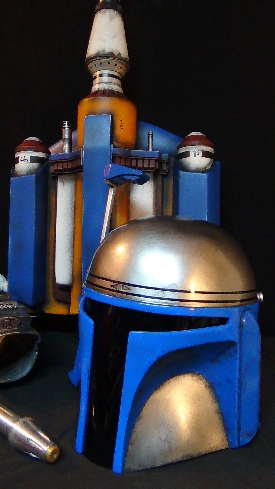

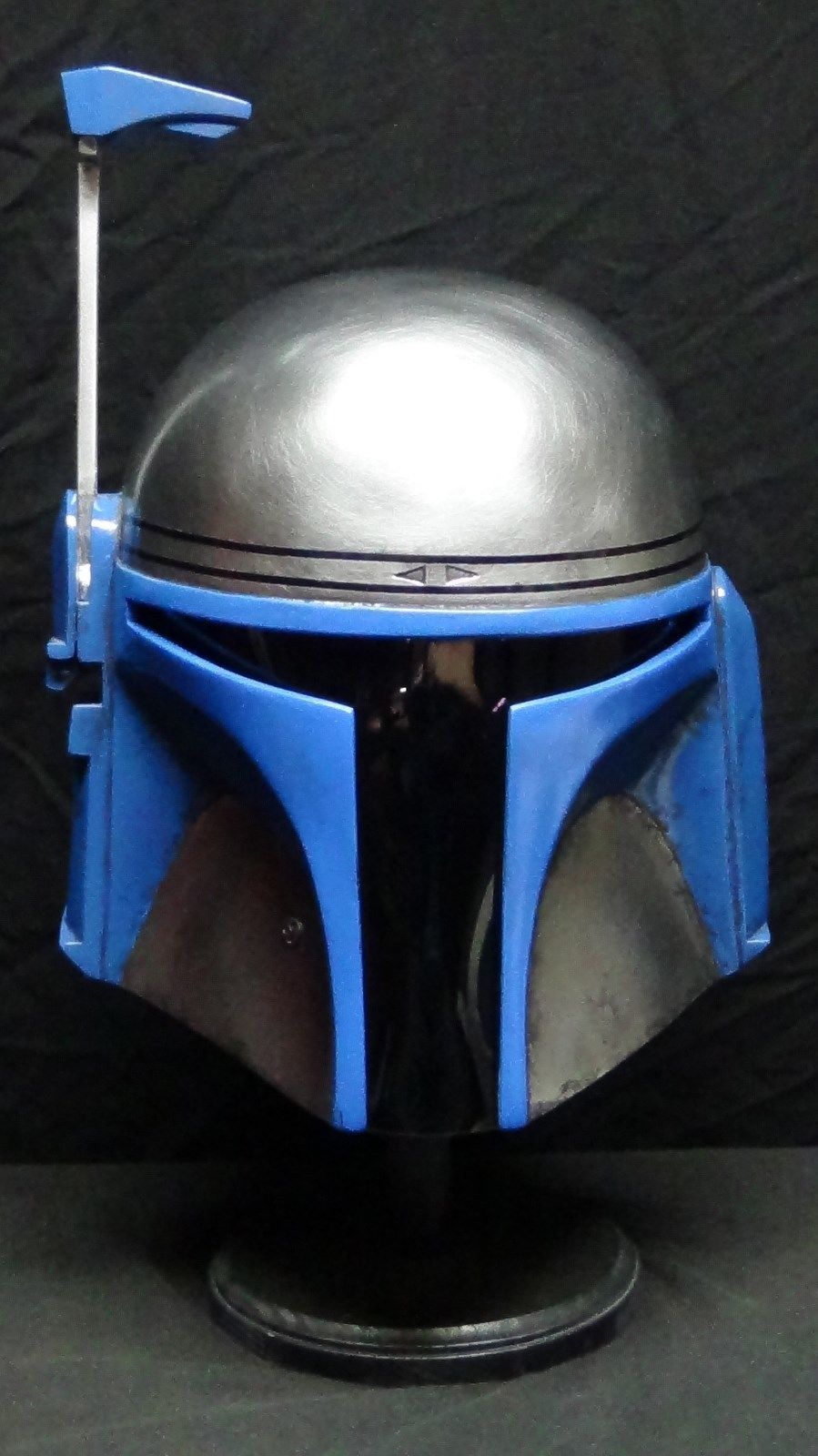

i bought my Jango helmet and armor vest from eaglewolf,he used a black base coat then Chrome Alclad II.Its the best brushed steel effect I've seen.Before he sprayed the chrome he buffed the black coat with a fine scothbrite pad to give the next coat it's brushed look.Then the clearcoat gives it a more steel look as opposed to chrome...here's a pic of him wearing it as I've no pics of me on this device!

Black base coat....then a very fine scotch brite pad....then chrome alclad II paint....then clear coat.the chrome alclad paint comes in a spray can ...it's a bit pricey but it's the most important part....check eagle wolfs posts also he covers how he painted it up.The chrome looks super shiny untill you clear coat it,then it looks like brushed stainless....if you need any more pics from different angles or close ups let me know ,I'll post them up!
Check his posts ,his primer may have been a straight grey ,I don't remember...the black base coat may have been a gloss black...then a light sanding in circular motions on the gloss black to accept the the coat of alclad chrome sounds right but check....cause the method he used was perfect...
