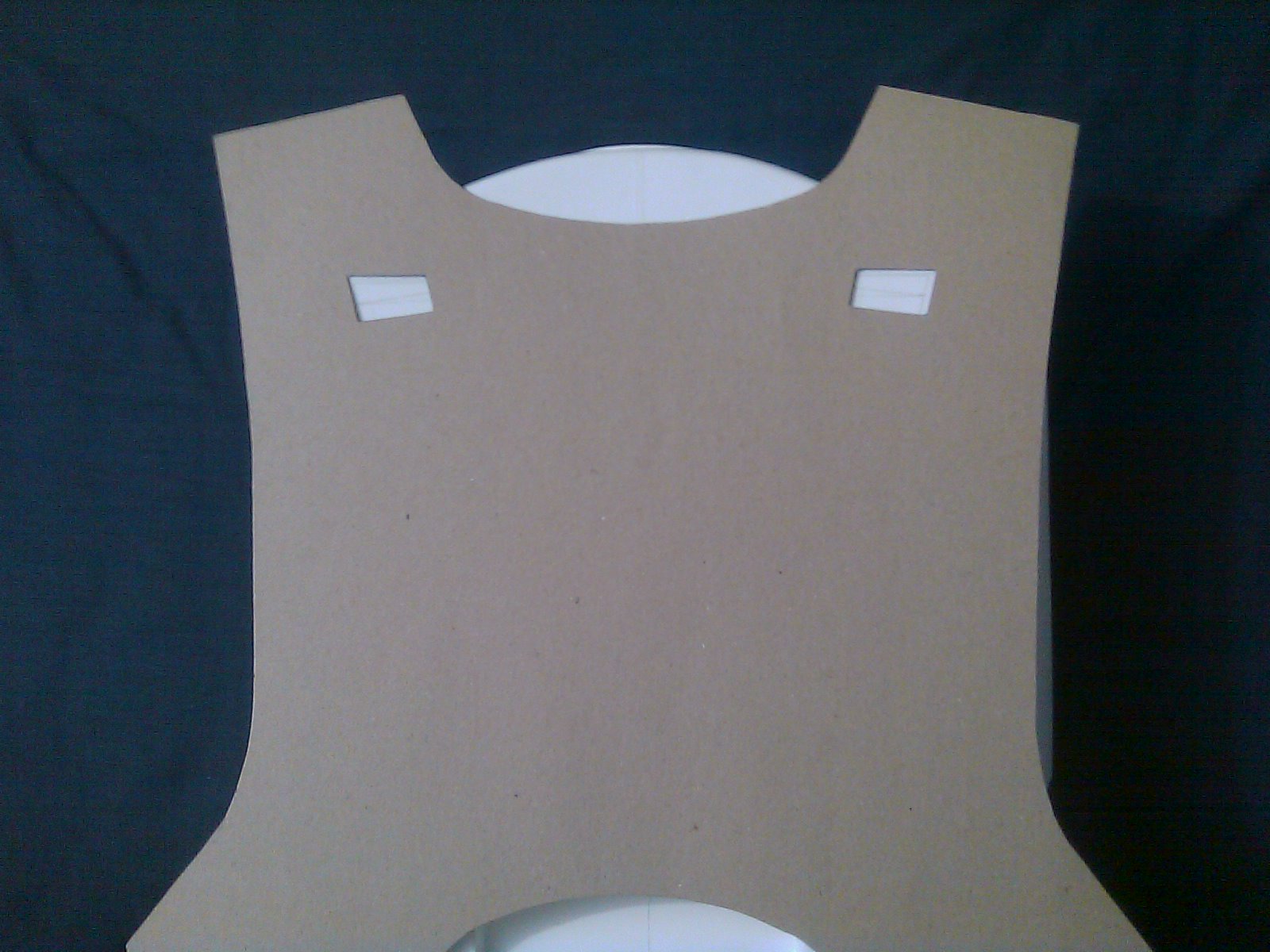

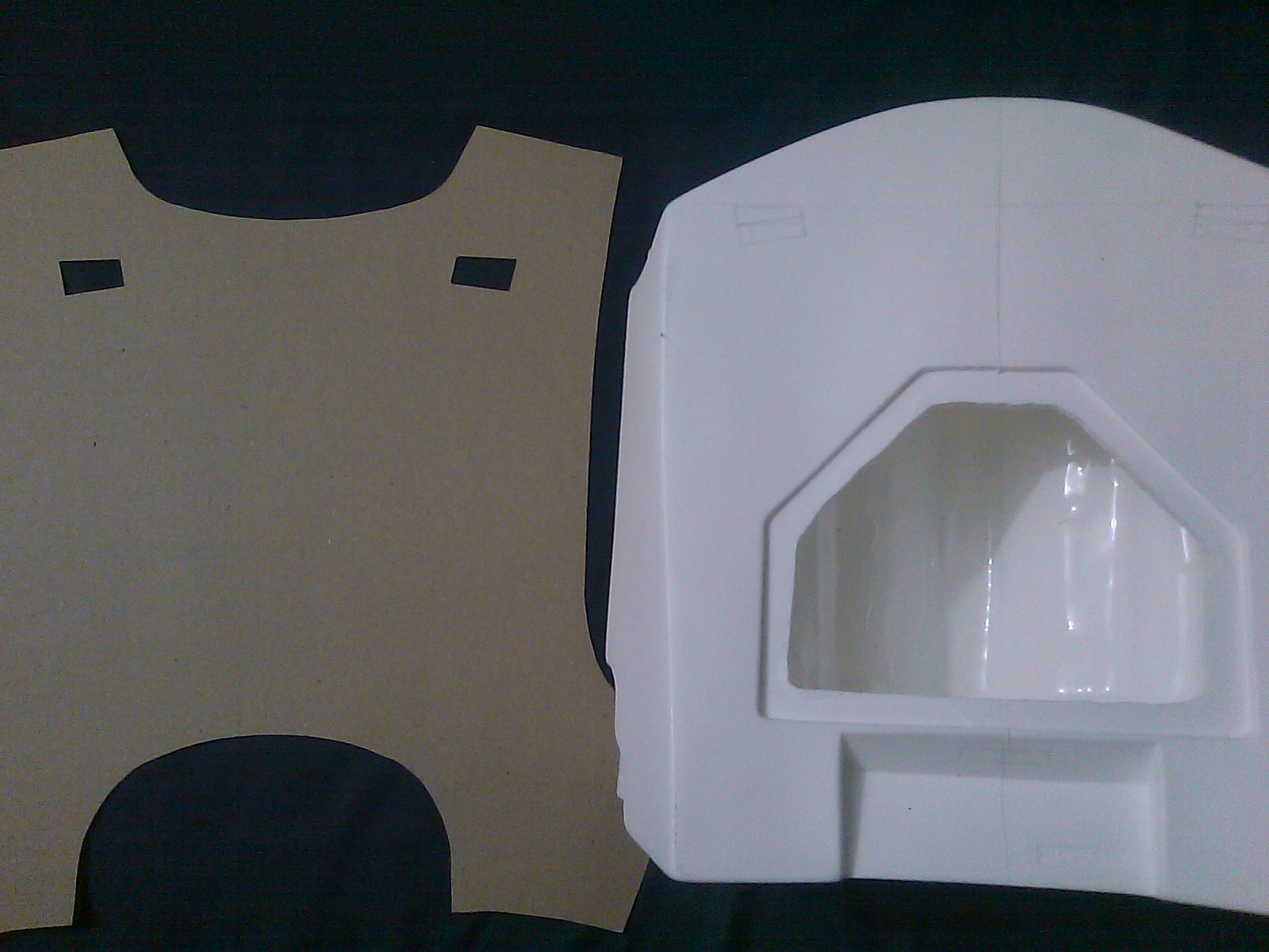

jetpack jango arnes.JPGIMAG0241.jpgHello give me a couple days and I will post some pictures of my Man of war Clasic jango jetpack installation.................for now takes thisIMAG0240.jpgthere are 2 holes in top and 1 down, to attach the arnes.I used a cartoon pattern (Alan sinclair) to makes the top lines and in the center of the jetpack down the center hole..........see you............
