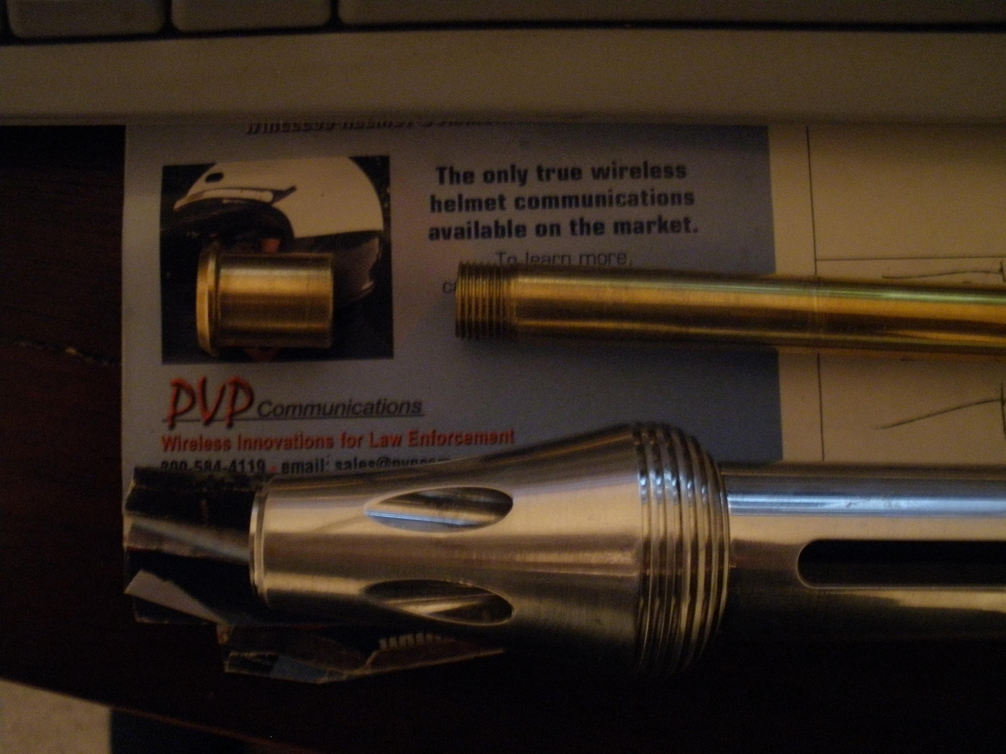

Is it the brass tip screwed onto the brass tube that you can't get undone? If so you could always just find something to stick all the way through the brass tube to push the barrell plug out.

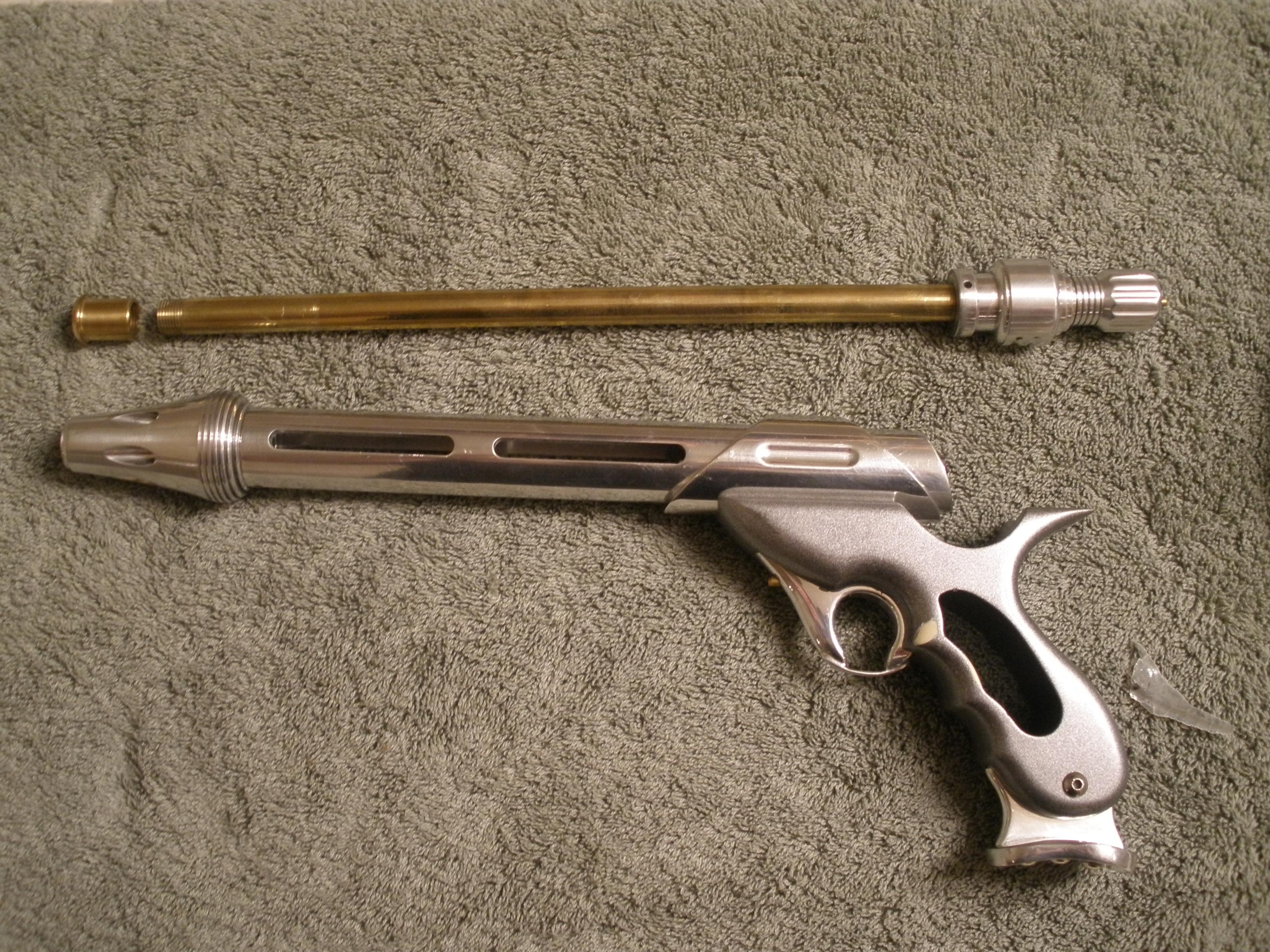

That brass tube goes the entire length of the gun. It's threaded to the back knurled part and the front barrel tip. Grab the back and the brass front and unscrew. Here's a pic. Once it's spearted you can push out the plug from the back of the brass tip and paint it black if you want.
Thanks for all of your help. I can unscrew the little screw on the bottom, but I can't get past that. My hands are torn up from trying to unscrew the tip. For some reason I ended with a pair of MR's that were so well put together they can't be unscrewed. I wreck some jar openers trying to unscrew them.
both set screws stay in the gun. The one in the front holds on the tip, the one in the back holds the tube in to the rear portion. your pressure points to get this apart is the gold ring in front, and the grip portion on the back of the barrel. When you pull it apart, the big tip stays on the gun. Then, if you want to remove that tip, you loosen that set screw. Make sure you're gripping just the gold ring at the front.
I couldn't ever get just the brass ring at the front to unscrew without un-doing the bottom set screw and turning the brass ring along with the flared barrell end. That is why I suggested that method. Jango 5204 is totally correct but mine I guess were put together pretty tightly as well. I hope you get it.
I give up. My hands are raw...I bought new super grippy jar openers, I used WD-40, tools...and they won't budge. I guess I'll just have to paint the tip :(
They must have used thread lock on yours. I was going to say that if you can't get them out you could always drill a hole through them then stick something through the hole to try to pull them out. I don't know how far you want to go to get them out. You could also get some gold rub n buff and try to cover the orange using a q-tip.
