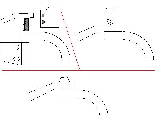

Got an interesting Conundrum for you guys here, and its really doing my head in. Ive decided to attach my armour via the bolt method from Bobamakers tutorial, and bolting the collar onto the vest, and also bolting the backplate onto the collar, for the cape etc....
Heres the problem.. how would i get into it? if the collar and backplate are bolted to eachother and the vest via the shoulder studs, how would i get the vest on in the first place, let alone do up the velcro at the back, or thread the harness buckles through the backplate to attach the jet pack onto the harness...
the only solution i can think of is only have one bolt go through for the cape, and to use it as a swivel hinge and swing it around to the right side after velcro sealing the back and threading the harness clips through, to lock into the right collar.. but how would i go about locking it into that collar?
If anyone can ease my headache on this that would be great... :) or even offer ideas that dont involve replacing the bolt method to velcro lol... :P i was thinking of snaps for the backplate attachment, but i want it more secure and flush with the collar as well...
Ok, I hope I am reading this right... Are you saying you are bolting the backplate to the neck plate? If that is the case, it is simple, the studs pose as the nuts and you simply screw them on and off when you put them on. BM's armor was set up that way with the bolts on the backplate that go through the holes in the neck in which you screw on the studs with the nut insert that was how he did it on a fellow garrison members.
The way mine works is that the studs on the shoulders are the nuts that the bolts screw into.
When I put the suit on, I get bolted in at the collar.
I did up a little drawing on MS paint to give a example...
Ah ok, so the actual Stud threads down onto the bolt, not a nut on the underside?
And it doesnt bolt through the actual vest then either i take it? :)
I think most of the guys have snaps on the collar part(attached to the vest) and the back plate is attached via the bolts and in turn is held in place along w/the jet pack.
correct. the stud threads down onto the bolt, and none of it goes through the vest.
i have my collar attached to the vest at the front edge, then the back is held down just by weight.
