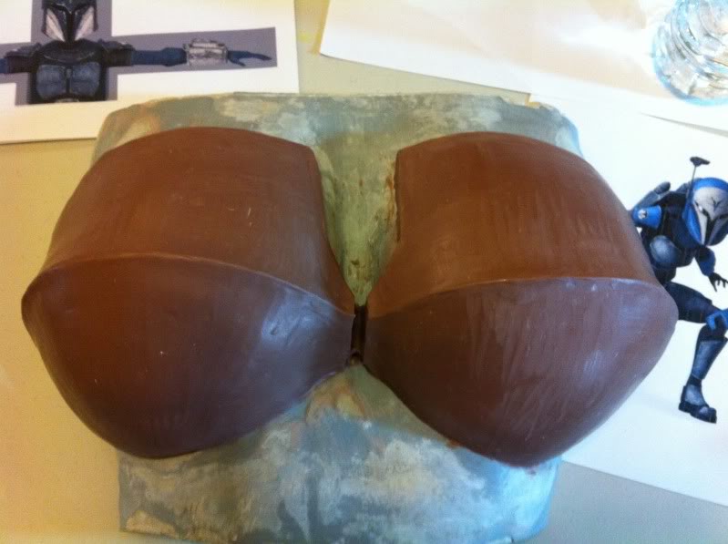

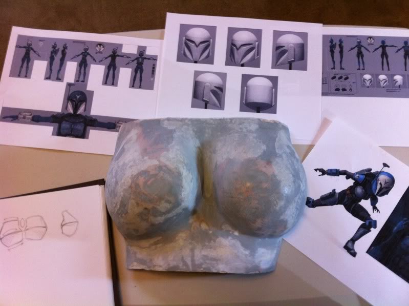

CHEST ARMOR SCULPT:
The starting chest "buck":

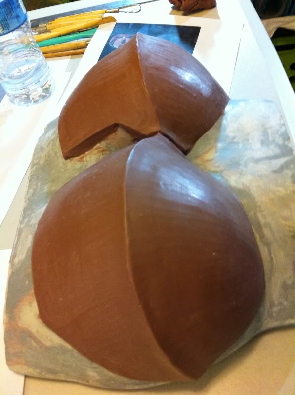

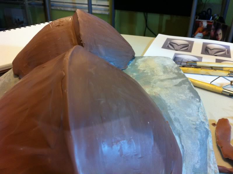

Roughing out the general shape:

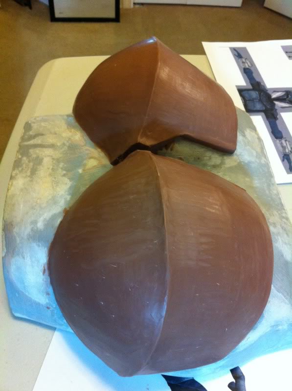

Smoothing it out!:
General touch ups will be done before casting:

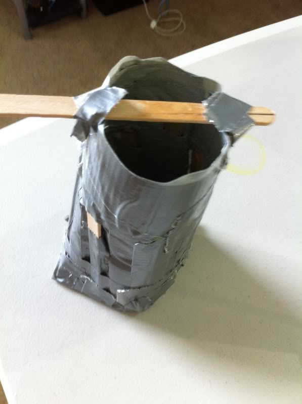

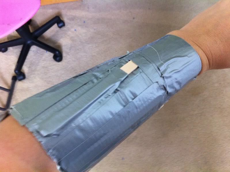

For time's sake (or the fact I tend to be impatient) I rigged a very quick duct tape mold of my forearm. I AM CRAZY. ALSO IMPATIENT. That's my final disclaimer on that note.:

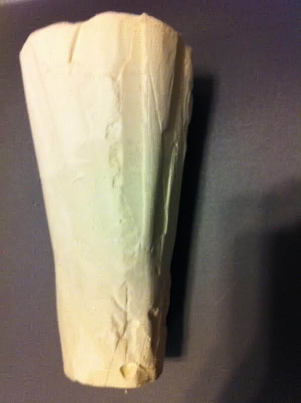

Prepped the quicky mold, and poured in the quick set plaster... easy!
The result is lumpy, but will work perfectly:

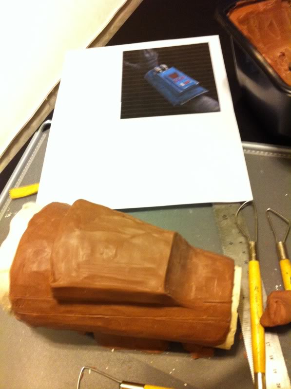

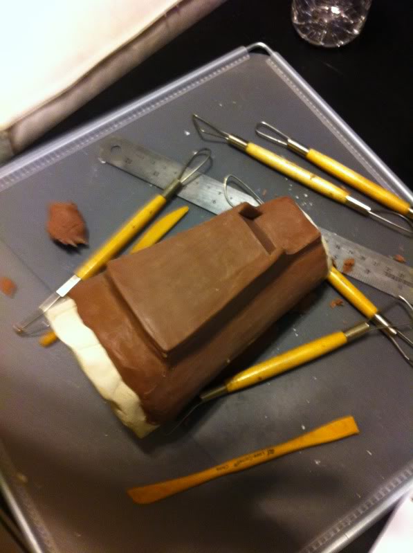

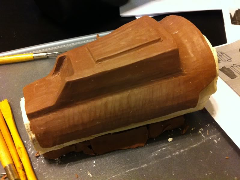

Building the top of the gauntlet:
Refining details:
Tada! I do some clean up tomorrow before these puppies are also cast into plaster.

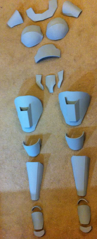

The sculpted components are now vacuum formed! I will be selling pulls of the chest pieces and the gauntlets very soon and probably out of my hotel room at Celebration as well!

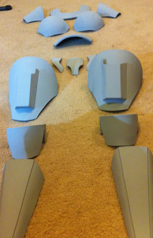

Next step is getting the other pieces cut out of sintra.
Had time to get a good layer of primer on all of the main armor components today. One more layer of sanding and primer, then this stuff is ready to paint! Gauntlet, back plate, jetpack and helmet work tomorrow!
Sorry for the bad images, the pieces are sitting on my sewing room floor.

I know it's not going to be 100% screen accurate, the chest pieces are very obviously not as flat as they are in the cartoon as well. My focus is going to be putting effort into a polished overall costume that fits me well, not getting every angle percentage just right... Plus I only have two more weeks to finish this set, eep!
