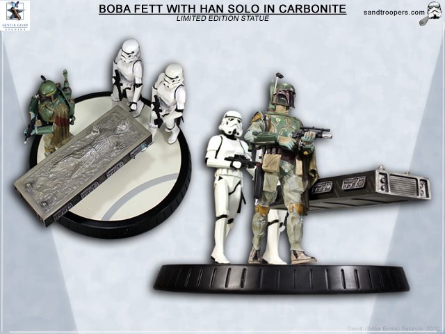

I know everyone is asking "how are you going to make a prop hover," so I will be following up with some plans to show you how I intend to do it. I actually got the idea from the Gentle Giant statuette:

The idea is to have a platform supported by a 1.5" pole that is offset / off center. This is used in magician tricks to give the illusion of levitation all of the time. Fett will be standing by the pole to conceal it.
