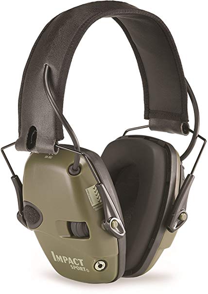

In one of the helmets that I've since sold, I disassembled these headphones and used the mic and earphones to amplify ambient sounds outside of my helmet. It worked really well, but my helmet was crowded.
They're pricey but there are other less expensive options out there. I used the Honeywell Howard Leight Impact earmuffs. I shoot a lot so I had a couple of extra pairs to play with.

In one of the helmets that I've since sold, I disassembled these headphones and used the mic and earphones to amplify ambient sounds outside of my helmet. It worked really well, but my helmet was crowded. View attachment 187125
I've used these before at the range. Do you have a photo of how you disassembled them? I definitely don't have enough room in my helmet to put these in it even if I removed the band.
