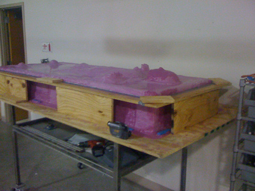

The plan is to pour on tues/weds this week and get photos up.
The delay is restarting the hard coat, and building a frame. Ill post a pic of the frame tonight or tomorrow and you'll understand:)

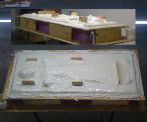

The delay was us going back and building this, to better support the dissassembling of the hard shell.
There will be a complete tutorial on making this posted on completion. (Except the mistakes hehe:)
Yesterday before we started, did two more sides yesterday, two this morning.
It will be demolded this afternoon. Ill hopefuly be able to pour one before I go out of town tomorrow morning, if not, im going to ask Mike to pour oneand send me pics of it.

This thing is massive. the end rubber piece is 22 lbs:) 3.5 x 15 x 15.
It takes a full gallon kit of rubber or resin to pull one, havent tried resin, but im assuming the same as rubber.

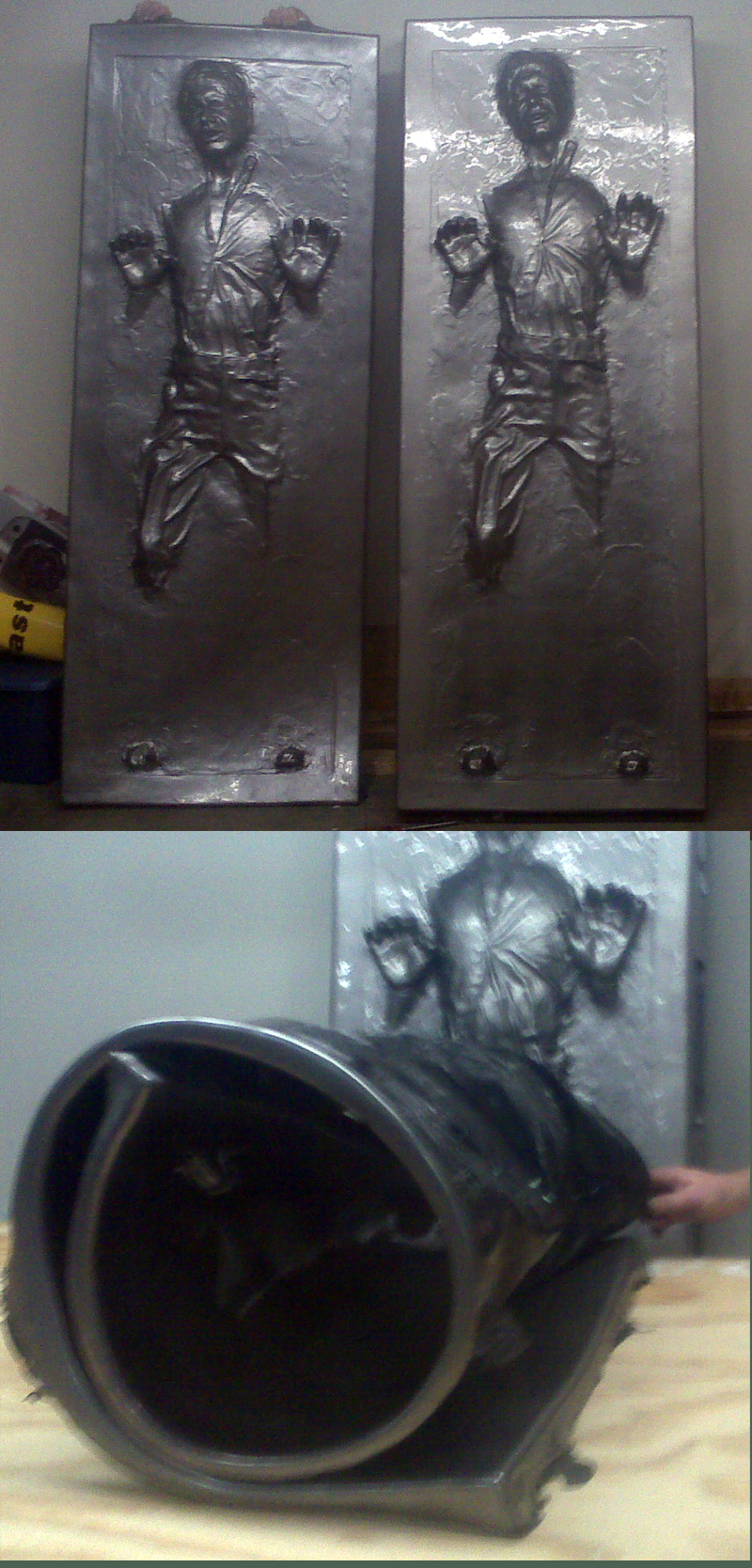

Heres the pic you have all been waiting for.
Its me holding the heavy sucka up.

Im going to estimate the shipping in the us from 50 to 100 east and west coast for the rubber. There are still a few thing I need to look at, such as if the piece is rolled for 3 days, that it lays out flat and perfect. I may have to let them fully cure for a day or two before shipping to insure that no 'creasing happens'.
I dont believe that it should be created all the way to the edge like I did this time, I think it should go to where the 'texture' stops on the face.
It will save me a little resin, and logically, that 'part' is where the seam should be. It will make it easier to build 'full' props for people. I will make one out of foam core for people to see.
