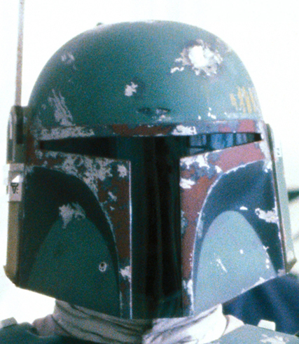

The wavey brow.... is super subtle on the ESB helmet. Its there because the brow was broken and repaired. Not perfectly mind you. With that said yes it can be done... but be careful not to over do it. Spidey Fett did this as have many others including myself. I cant stress enough how subtle the wave ACTUALLY is though.

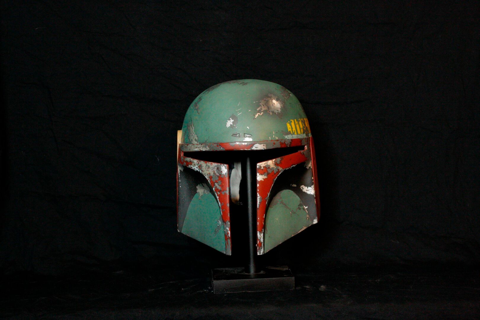

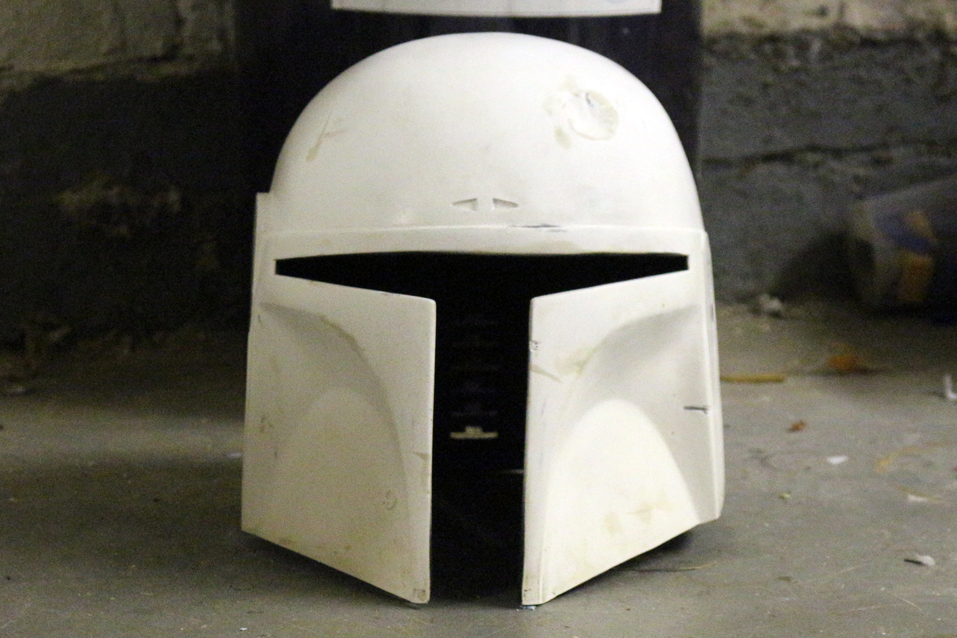

When cutting the visor, I left a little bit of the resin behind and bondoed it flat to the edge. It's difficult to gauge the size since the paint job also plays a big part in making the wave look more significant.

I second that it should be very very subtle.
Spideyfett over exaggerated the brow and placed it too far towards the center in my opinion.
Just to put things into perspective, this is how very subtle the waviness should actually be. Some angles seem to make it almost impossible to spot, too.
It really won't take a lot of Bondo to make a GMH look like this.
