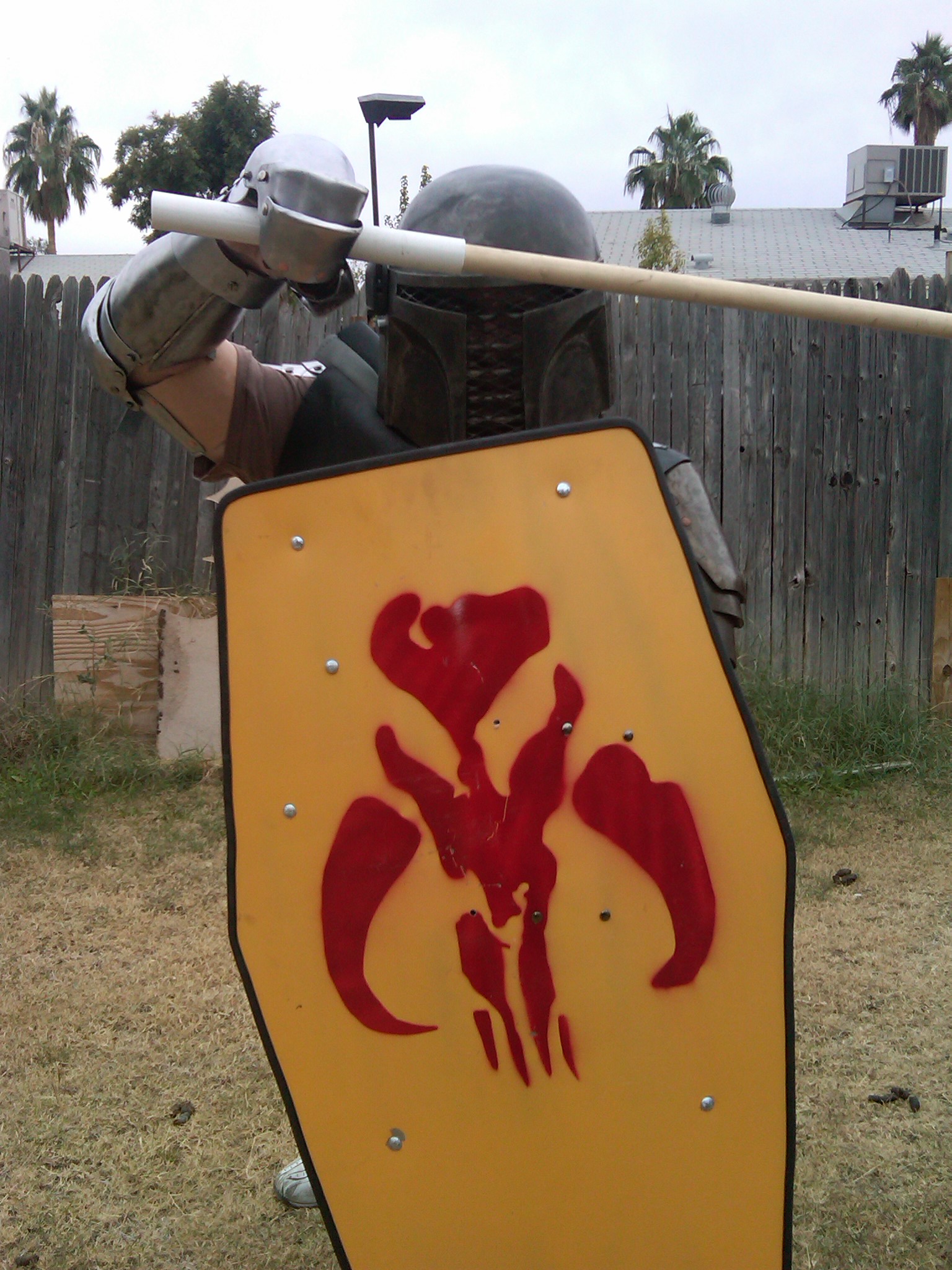

I'm the red and gold mando from this pic:
Cool pic, where did the mando all the way in the back of th non photoshopped go? or is it because he is a Boba?

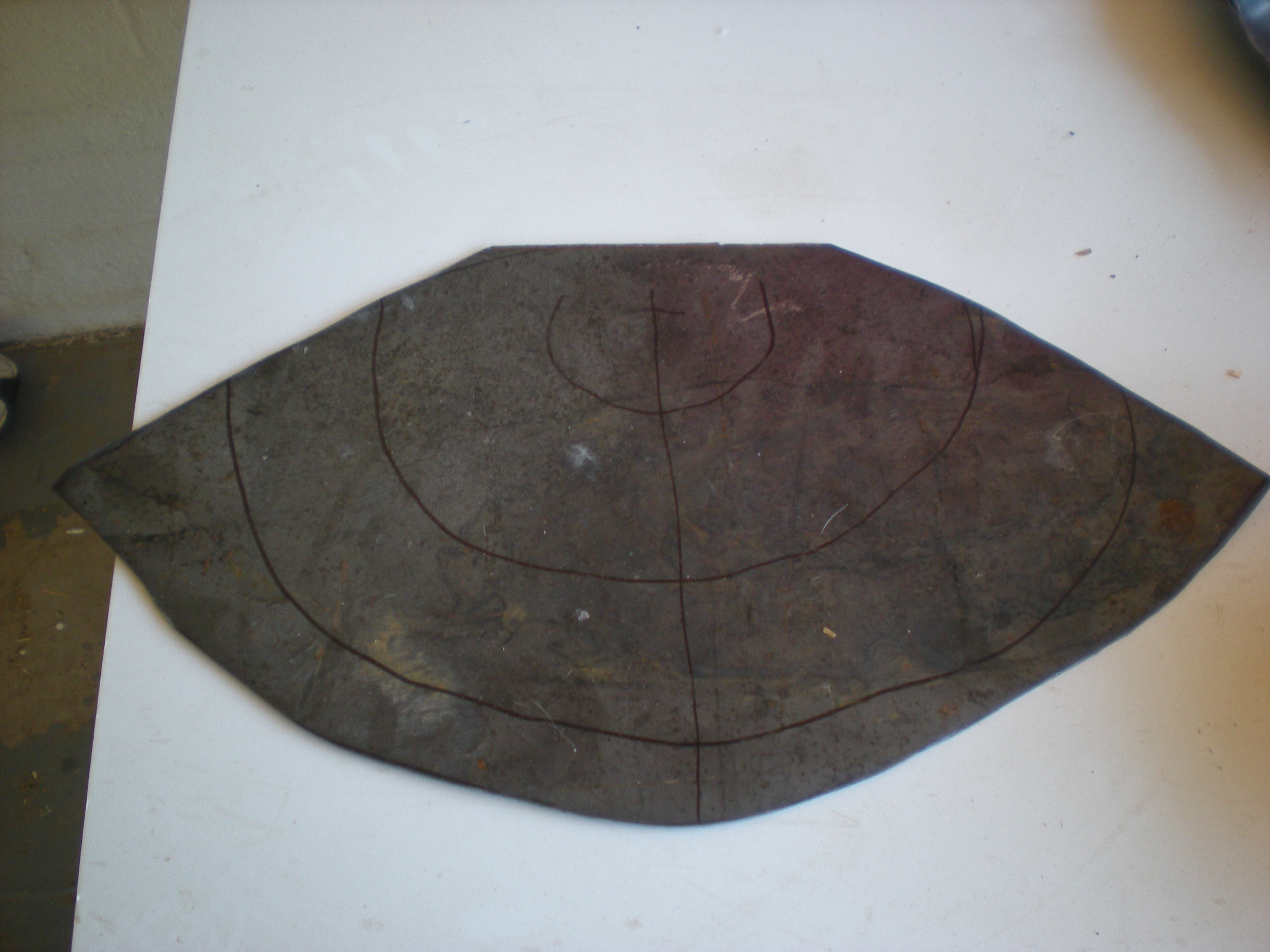

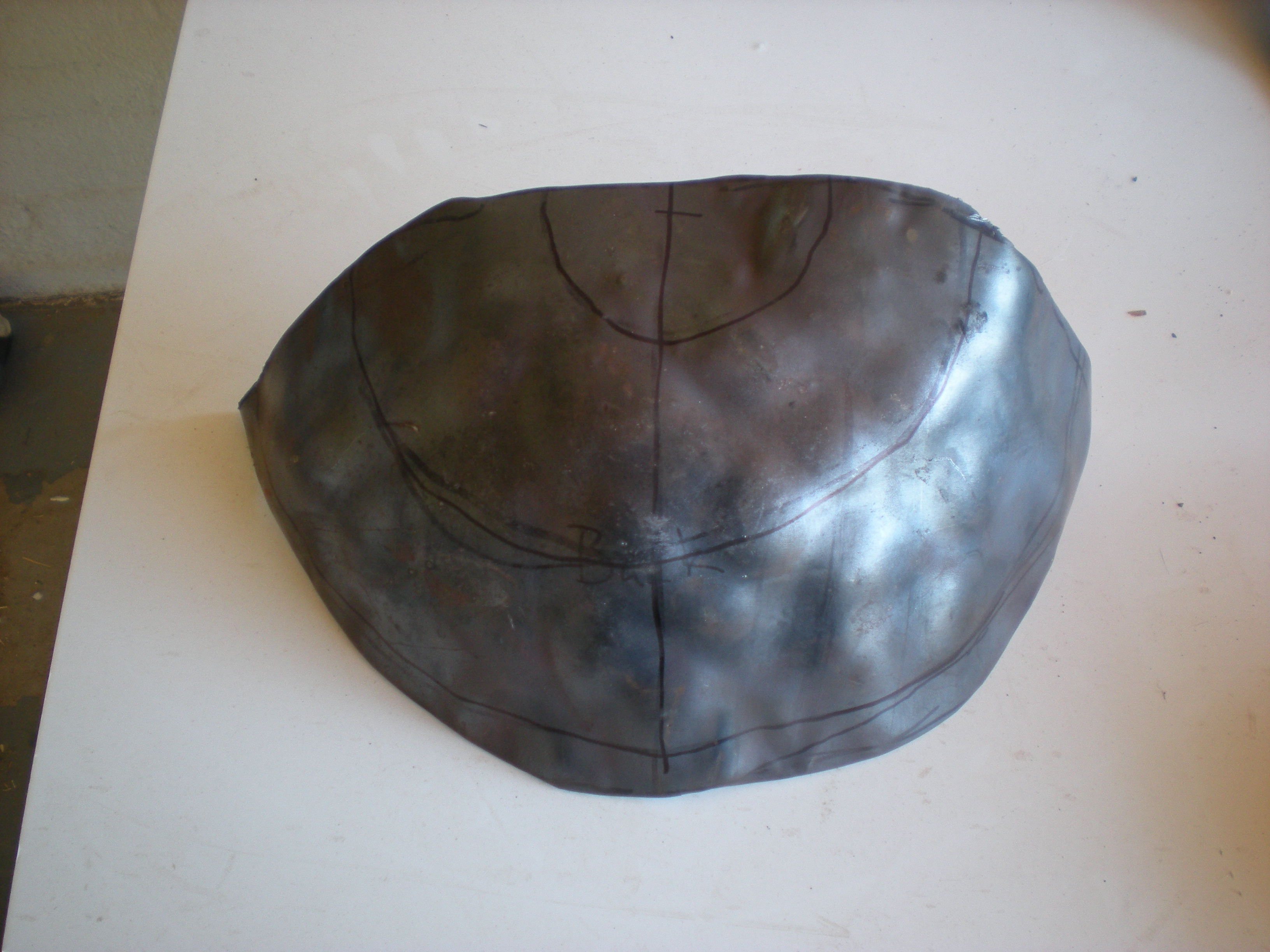

here is a step by step forming of the helmet dome hemispheres. Except for final planishing to make it smooth.

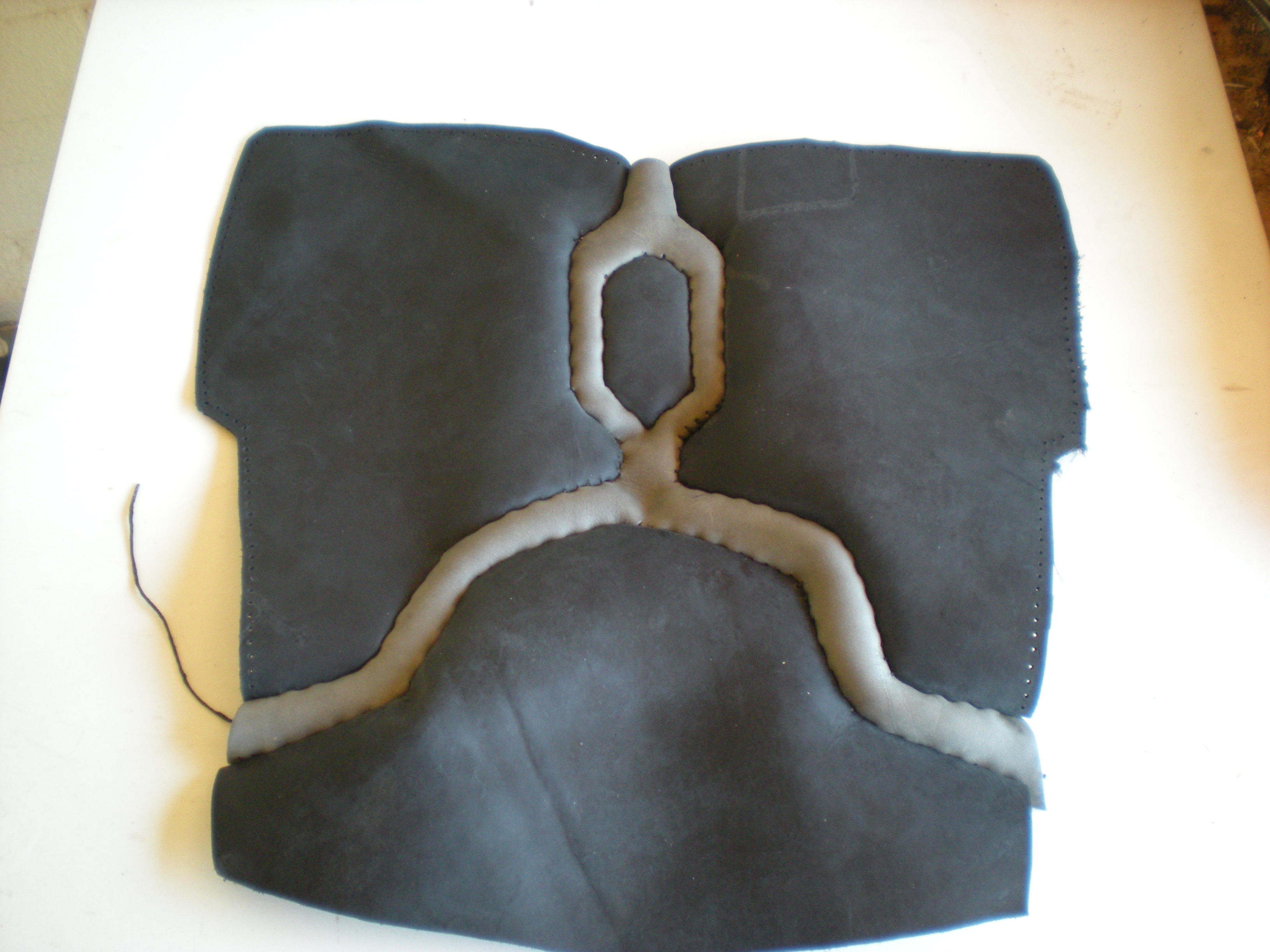

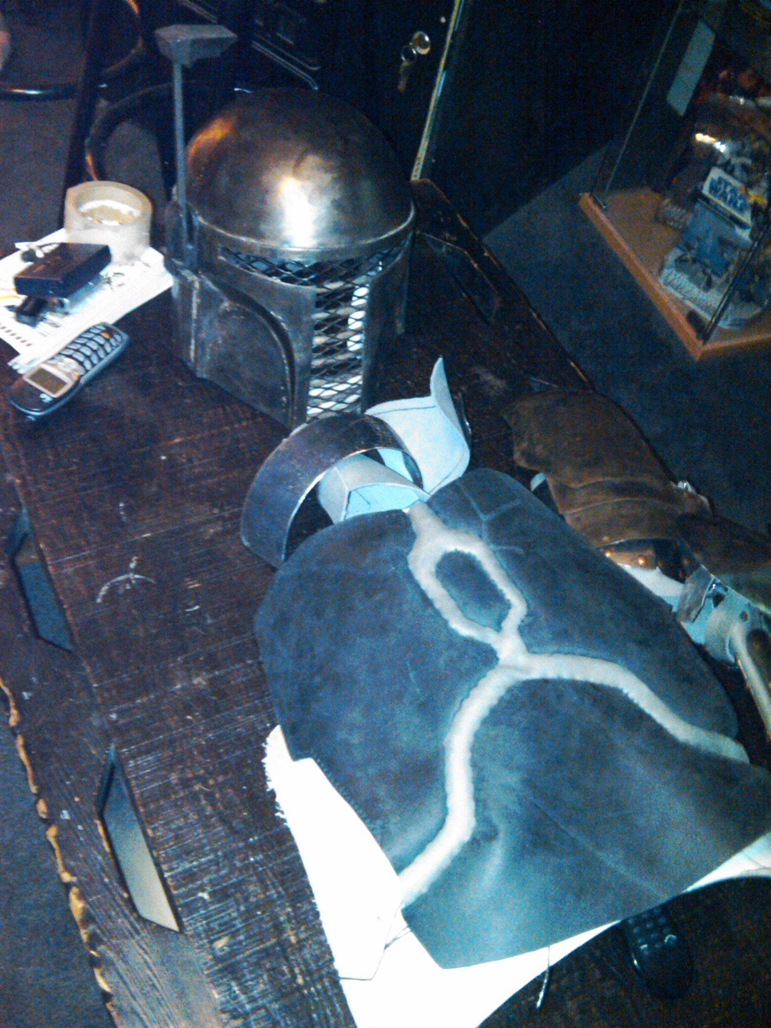

and also my leather chest guard that will go over the full breast plate.
Bill, have you thought about raising the dome instead of dishing? Takes a little longer, but you wouldn't need to weld those 2 pieces and metal wouldn't get stretched so it would last in SCA combat longer.
Just a thought. Thats a pretty bada-- helmet man, and it's great to see some old traditions make it's way to mando armor production.

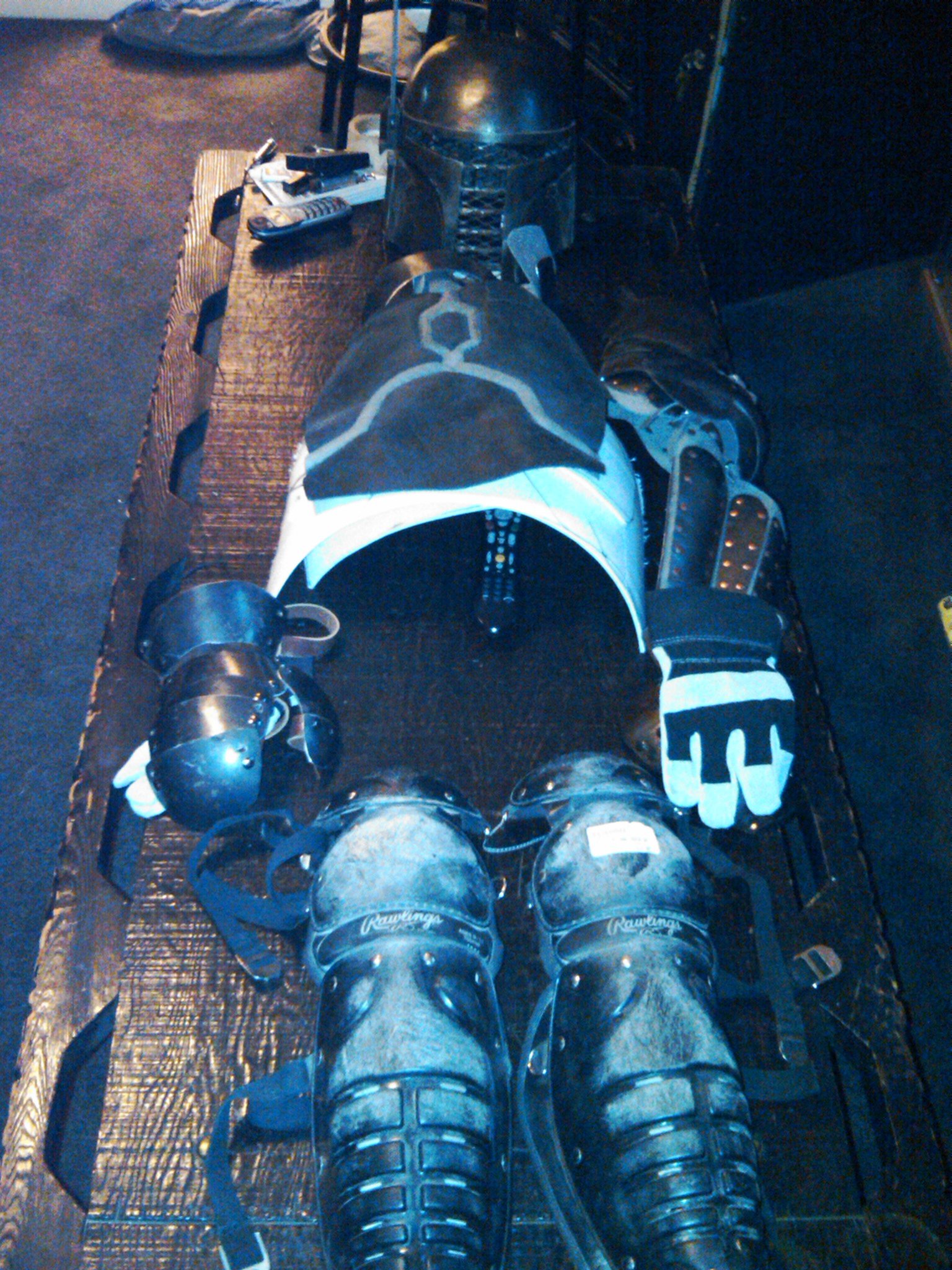

Figured I'd add some of my latest pics. I picked up a 55 gallon plastic drum from the salvage yard and used it to make the chest and kidney parts. They'll be covered with the leather Mando pattern I started. It'll be a full vest when done.
I've also got my left arm 90% done from gauntlet to shoulder. got the right gauntlet done now too.
Legs will be done with baseball catchers knee/shine guards. I will put either alluminium or leather plates over them to hide the modern look.
