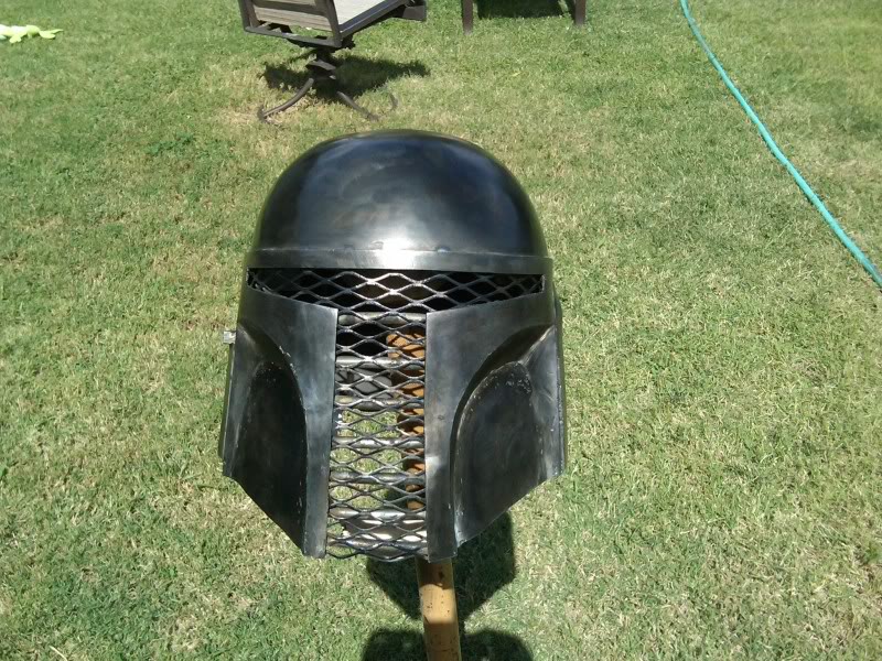

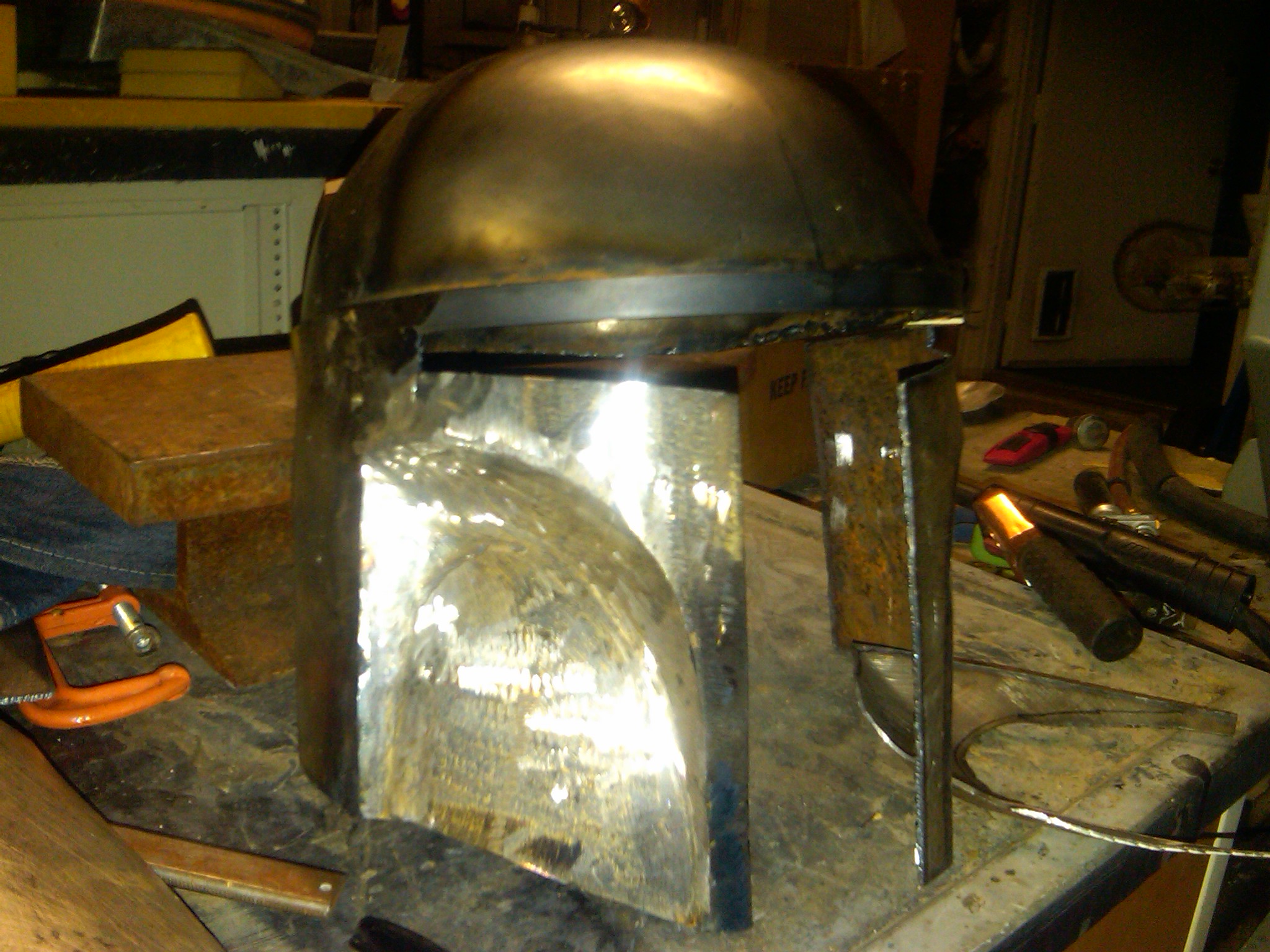

Been working on this for quite some time. Finally got around to building a press and it has been working better than I expected. This helmet is 12 gage low carbon steel and I should be able to fight in the SCA with it when done.

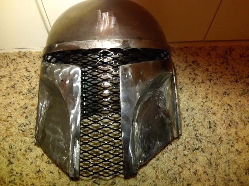

FINISHED PIC ~7.5lbs:
NEW SHOT OF RANGE FINDER:
And the final look:
And the ear, it actually looks a lot cooler than this picture
I'm still trying to decide how I want to do the range finder
that is rockin! i've been wanting to get a metal helmet for a minute. how difficult would that be to do in a lighter guage sheet metal?
The weight is going to be probably 7-9 lbs, or about 3x that of a normal fiberglass or resin one. Typical SCA medieval armor helmets are in this range of 6-11 lbs.
I don't think it would be much easier to do in a thinner gage metal. In fact some parts would probably be harder, like the welding and grinding.
I do plan to do armor as well. It will be Mando inspired but will have to follow a lot of SCA rules in order to cover and protect correctly, so it will have a lot of medieval look to it as well.

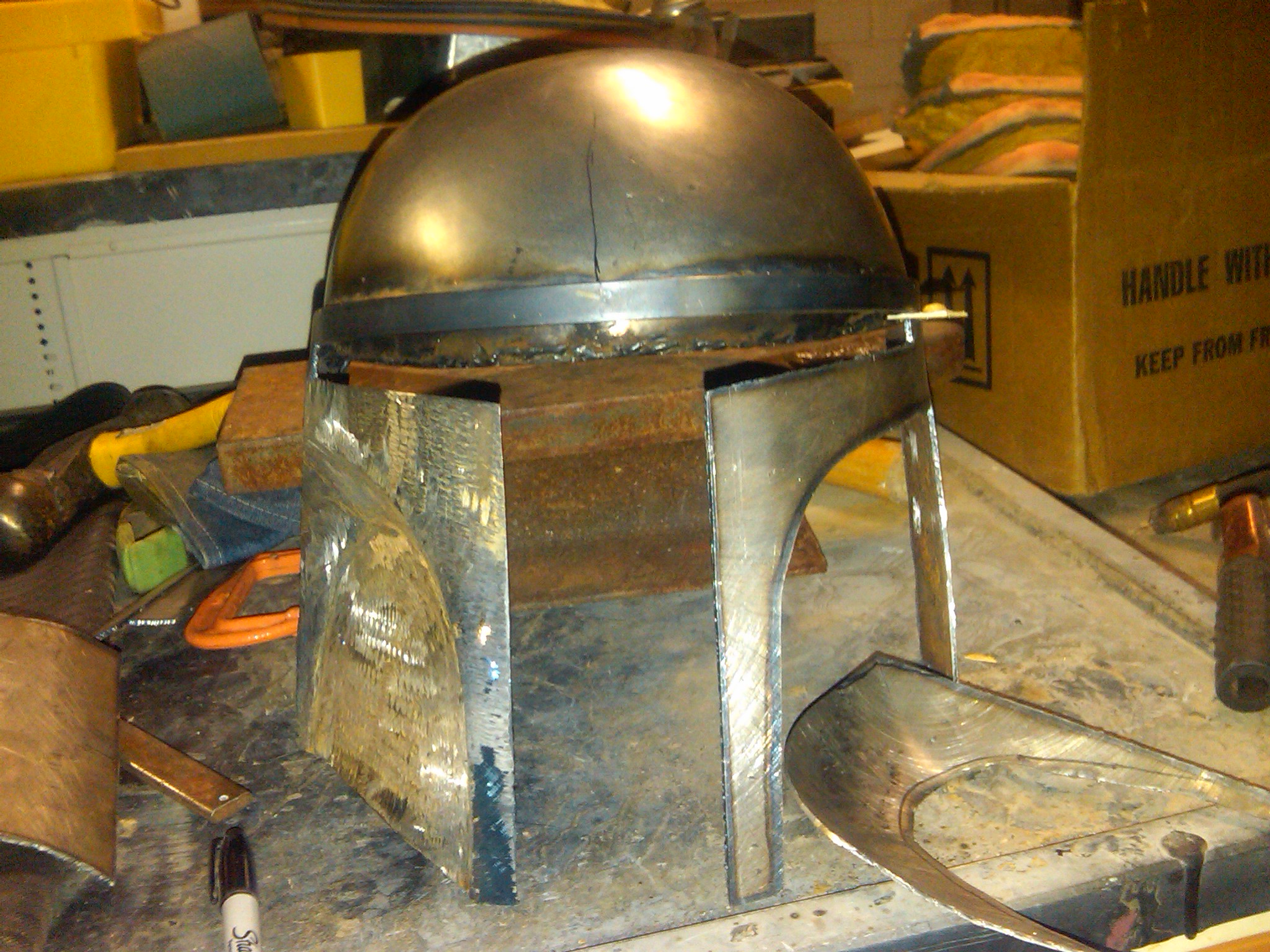

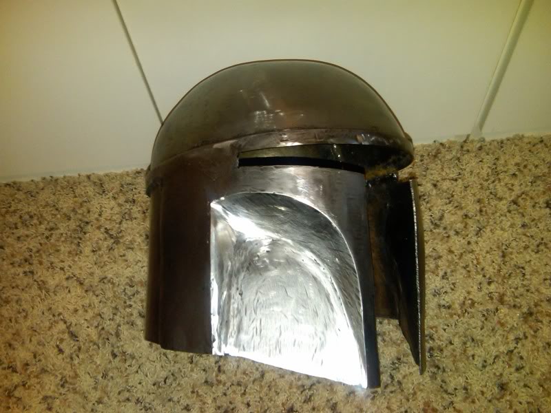

Photobucket was down, so here are some attached update pics Didn't do much tonight. Will try to get the left cheek by the end of the weekend.

I was going to do one in Aluminium, but found that welding aluminium is an art far beyond my ability. Between Lance and I we banged out about 10 sets of aluminium armor for the mandos in the pic above and several others. We have been wanting to do helmets, but never had a real way to dish metal that much. Just beating out a chest plate was a lot of work and that is minimal dishing. By using the 12 ton press I made from a bottle jack and a cast iron ball I am able to do about 16 hours of hammer swinging in about 4-5 hours. My welding skills have always been very minimal but are improving daily. I ran out of gas for my MIG welder last night and just got some more today. Lets see what kind of progress I can get this weekend.

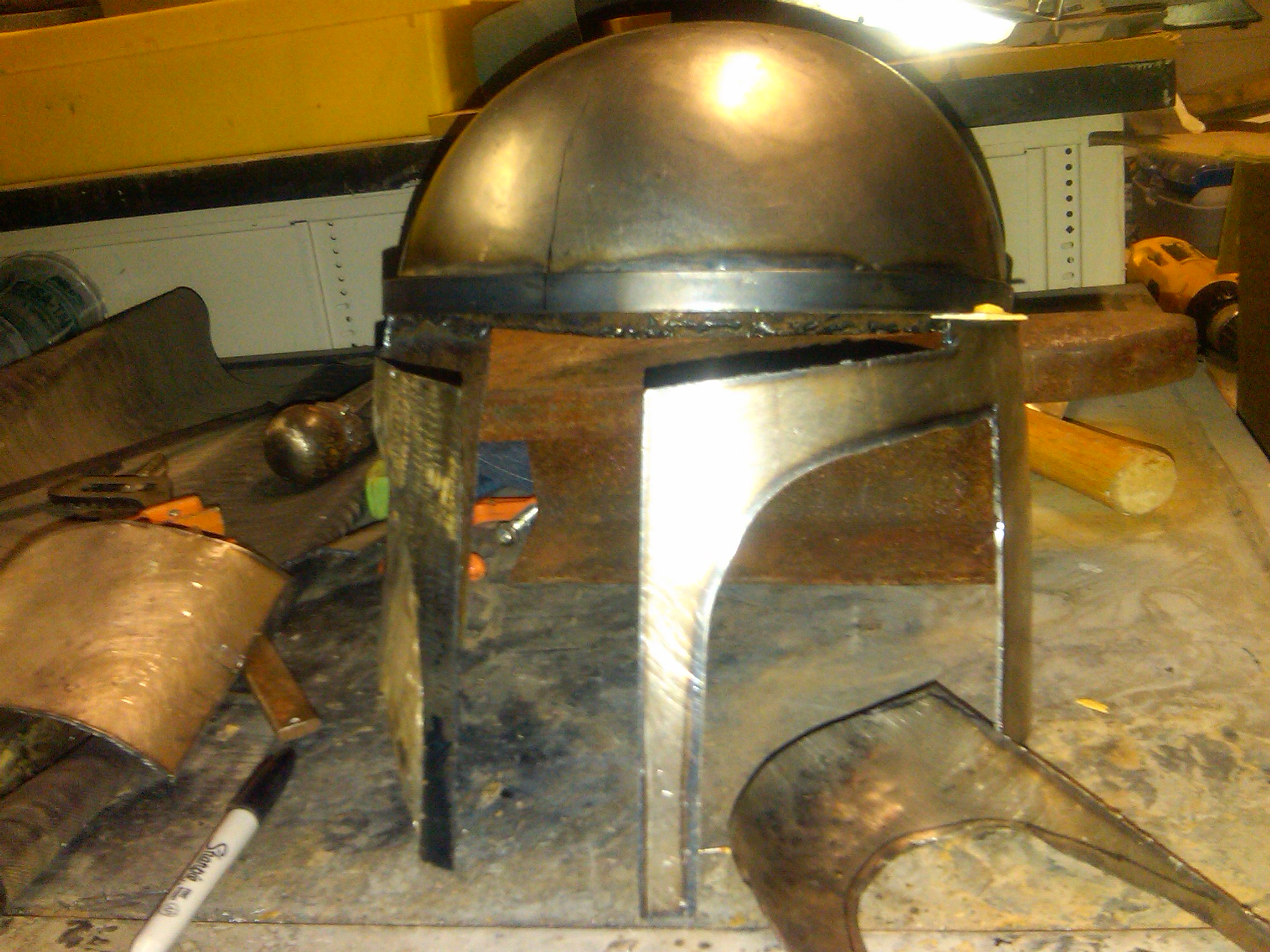

updated the photobucket with some structurally complete photos. I still have some cleanup and mainly got to square off the bottom. Will probably do most of that tonight and tomorrow.

You're using a pretty heavy gauge of metal there. My armour is 16-gauge, and I'm planning on doing my helmet in the same. How much would the metal thin being dished for the dome? Should I start with 15? 14? And are you going for the simple hemispherical dome, or the more complex "baseball-helmet" shape of the original helmet?
--Jonah
I took patterns off of I a helmet I have, I think an MSH. It has the "baseball-helmet" shape with the bulge in the back right quarter.
I have some of the sheet metal armor that I piced up from someone here. I'm not sure of the gage, but it is really really thin. the stretching will thin it some, but not as much as you'd think. It'll be an almost un-noticeable amount. I sugest dishing it in two halves and welding them together. I started with the plan of doing quarters, but after doing the first to I tried the other half as once pices and it worked out great.
