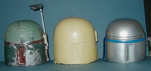

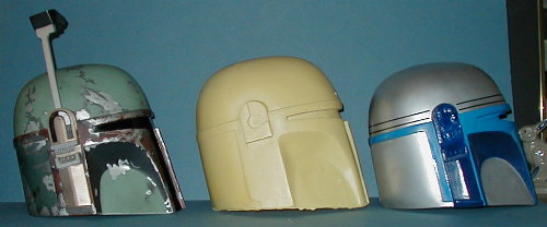

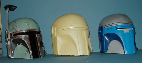

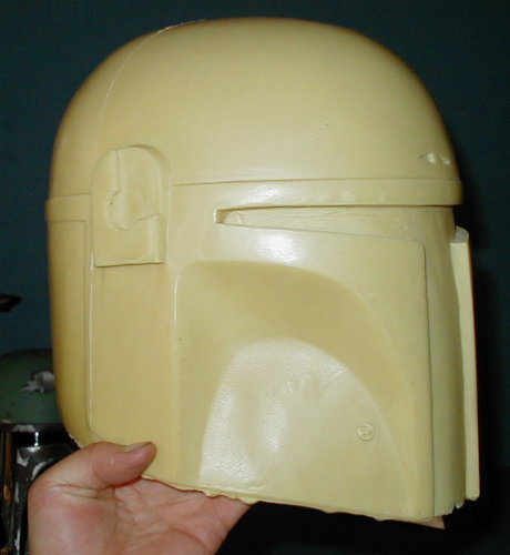

I new to all these new helmets. So here is a little blast from the past for the best of the best helmets BITD 13-15 years ago. I'm used to the old FP MSH, MSH2, GF, and Mystery Helmets from 13+ years ago.
THESE were the helmets to have BITD!!! I had all of them.
MSH

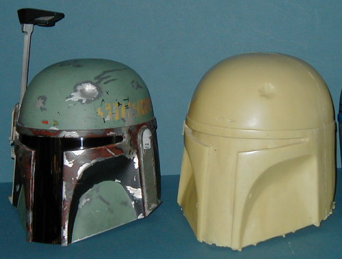

GF helmet (Gerardo Fallono) My least favorite BTW
Mystery Helmet

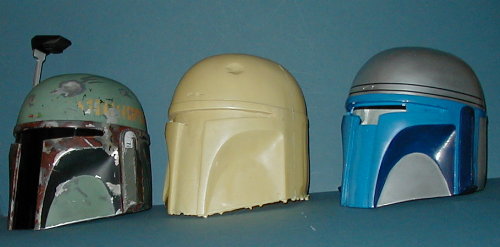

MSH2 compared to DP and GF
Looking at these helmets, I miss them terribly!!
