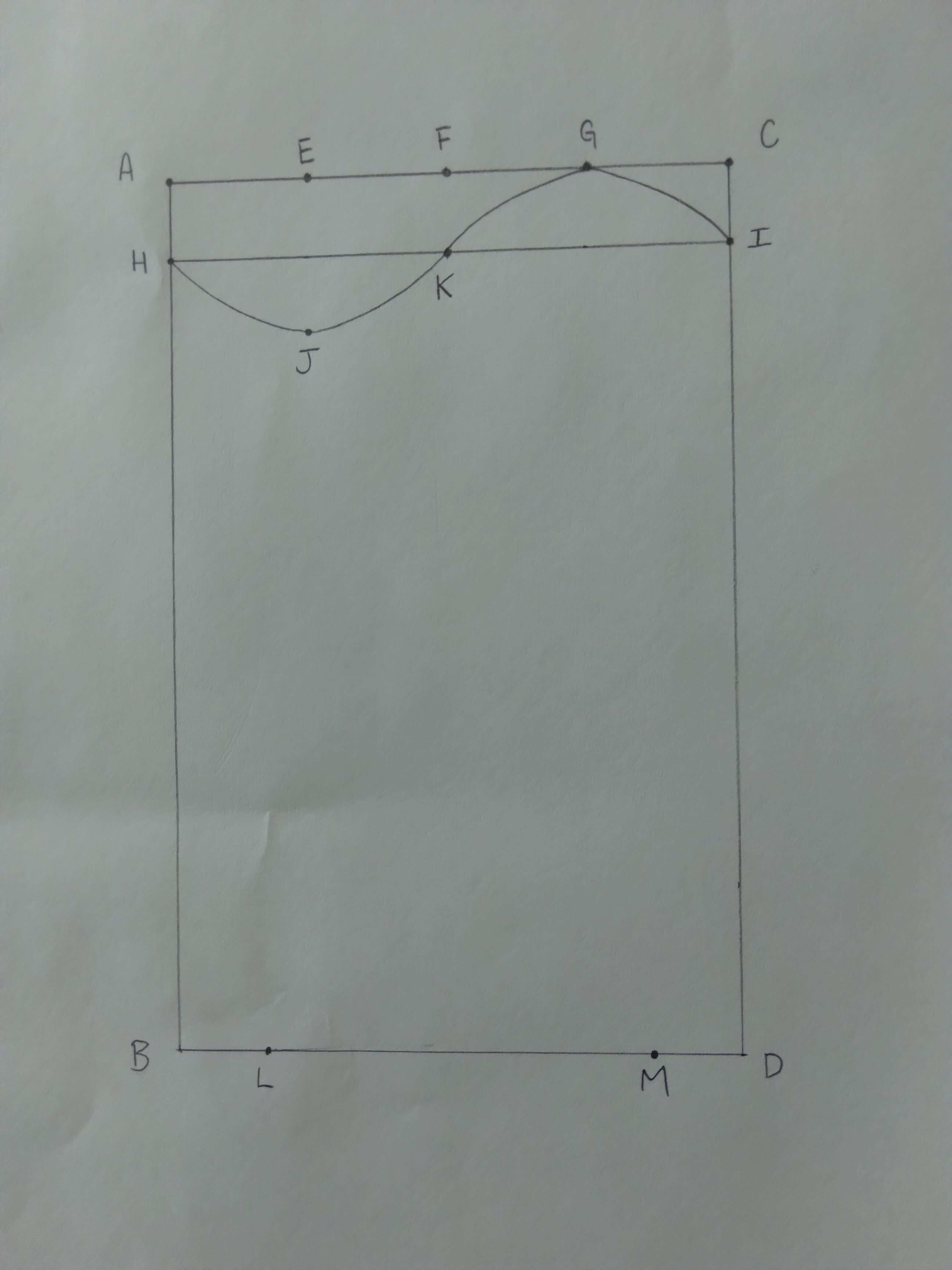

1. Draw a rectangle. Points A-C and B-D equal your Total Sleeve Width. Points A-B and C-D equal your Sleeve Length. Split your top line into quarters and mark E, F, & G. (For instance, my Total Sleeve length was 16", so I ended up with four 4" segments)
2. 2 1/4" down from points A & C, draw horizontal line H-I.
3. 4 1/2" down from point E, mark J
4. On line H-I, mark K directly under point F (right in the middle). The right half will be the outside of the sleeve, the left will be the inside.

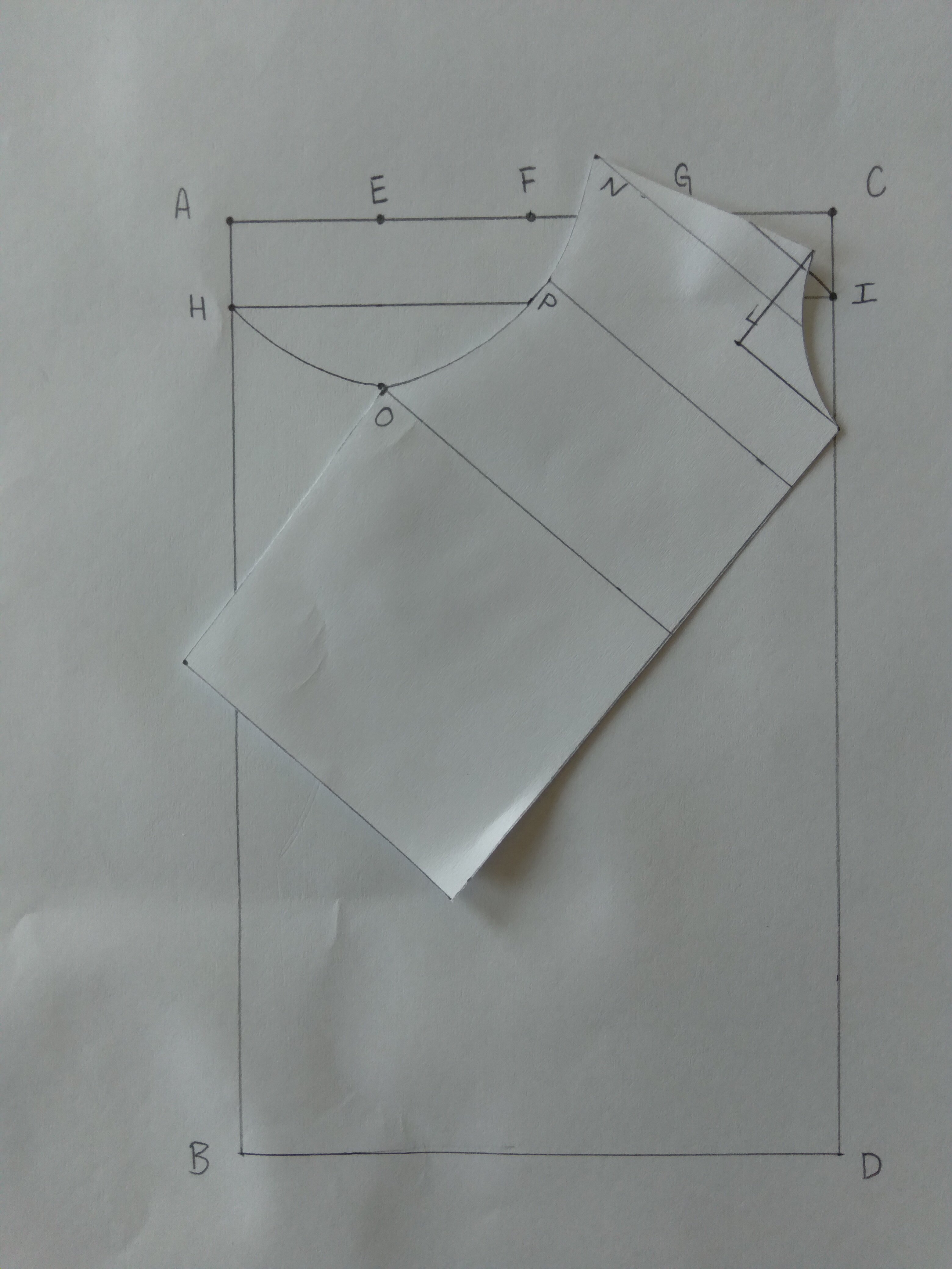

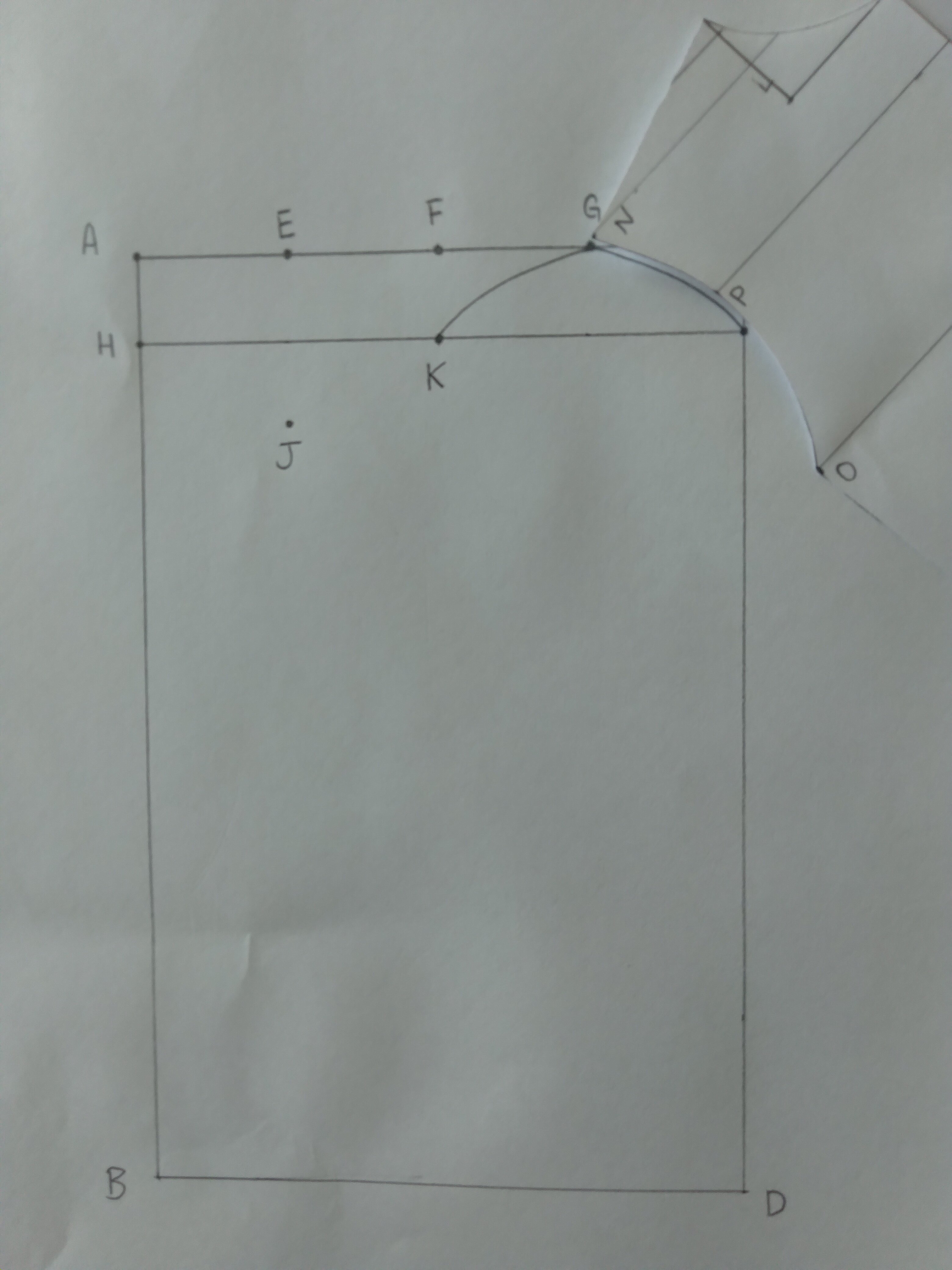

5. Place Point N (the shoulder seam) from the vest pattern onto point G of your sleeve pattern, then move the vest pattern until the armhole curve meets up with point I on the sleeve. Draw the curve and repeat between points G and K.
6. Place point O (the side seam) of your vest pattern onto point J of your sleeve pattern, then move the vest pattern until the curve meets up with point K on your sleeve. Draw the curve then repeat between points J and H.
7. On line B-D, mark your Cuff Width equally between the two points. For instance, my cuff width was 11 inches placed between 16 inches leaving a space of 2 1/2 inches on each side. Mark L and M.
8. Connect points H & L and I & M with straight lines, this is your seam.
