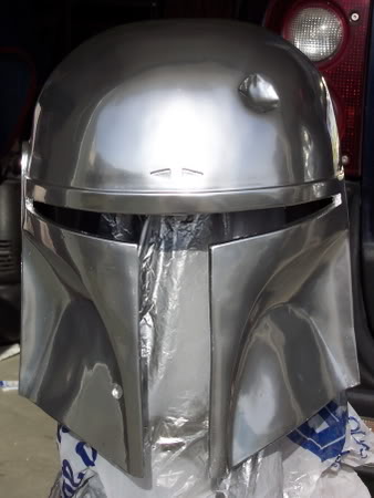

I picked up this wonderful helmet yesterday at the post office and I could not ignore it so I had to start it. MS# #23, with the cold cast parts, I cut out the visor, sanded, filled and primed yesterday and today I wet sanded and Sprayed down some very nice silver paint. I have most of the paints to start the but the rest of them are on the slow boat to Alaska. I am using Rouge Studios tutorial and paint list.
I really like this color silver (Krylon Silver metal) it has a great finish, but will need a good clear coat on it as well.

On the sanding I started with 150 grit to start, then I did the hot water & soap wash followed by a little bit more 150 and then finished with 220. Krylon Black (wetsandable) primer, then i wet sanded it with a medium grit sponge (3m) pad followed by the fine grit. After drying, I touched up the spots I missed with 220 and then I did a final pass of 400 grit, rubbed it down with a tack cloth and sprayed away.
The paint is Krylon Premium Silver Foil Metallic, SKU 1060. It comes in a tall skinny can and the nozle in stead of just a regular spay patters comes out in a flat horizontal patern that makes it real easy to get a good coat on with. I did a few passes to get it down and then built it up a bit.
Now the bad news, the paint is touchy and can rub off with yoru fingers (great for weathering) and requries a clear coat. I was about to try the Kylon Accrilic clear coat and the two paints reacted badly on my test strip so I have to find a better clear/gloss coat.
On the good side the Panzer Olive Green sticks well and does work as does the liquid mask.

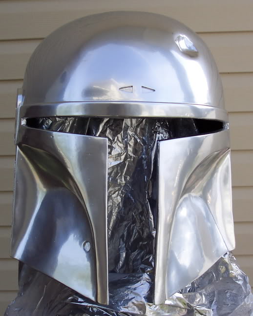

I forgot here is a shot in the sunlight, put on your sunglasses.
Crap! The paint is a lauquer based paint and it does not like the clear coats. I spoke with Krylon and hte only clear coat I can throw on it is the Low odor clear coat, but when I tried that it realy dulls the paint and gets a little milky (possibly a paint cure problem too). :confused
I am going to wait a week before touching it again and I will see what happens, plus I have to head back to work for a week anyway and won't be home.
If anyone knows of a clear coat that works well with laquer's please let me know!
