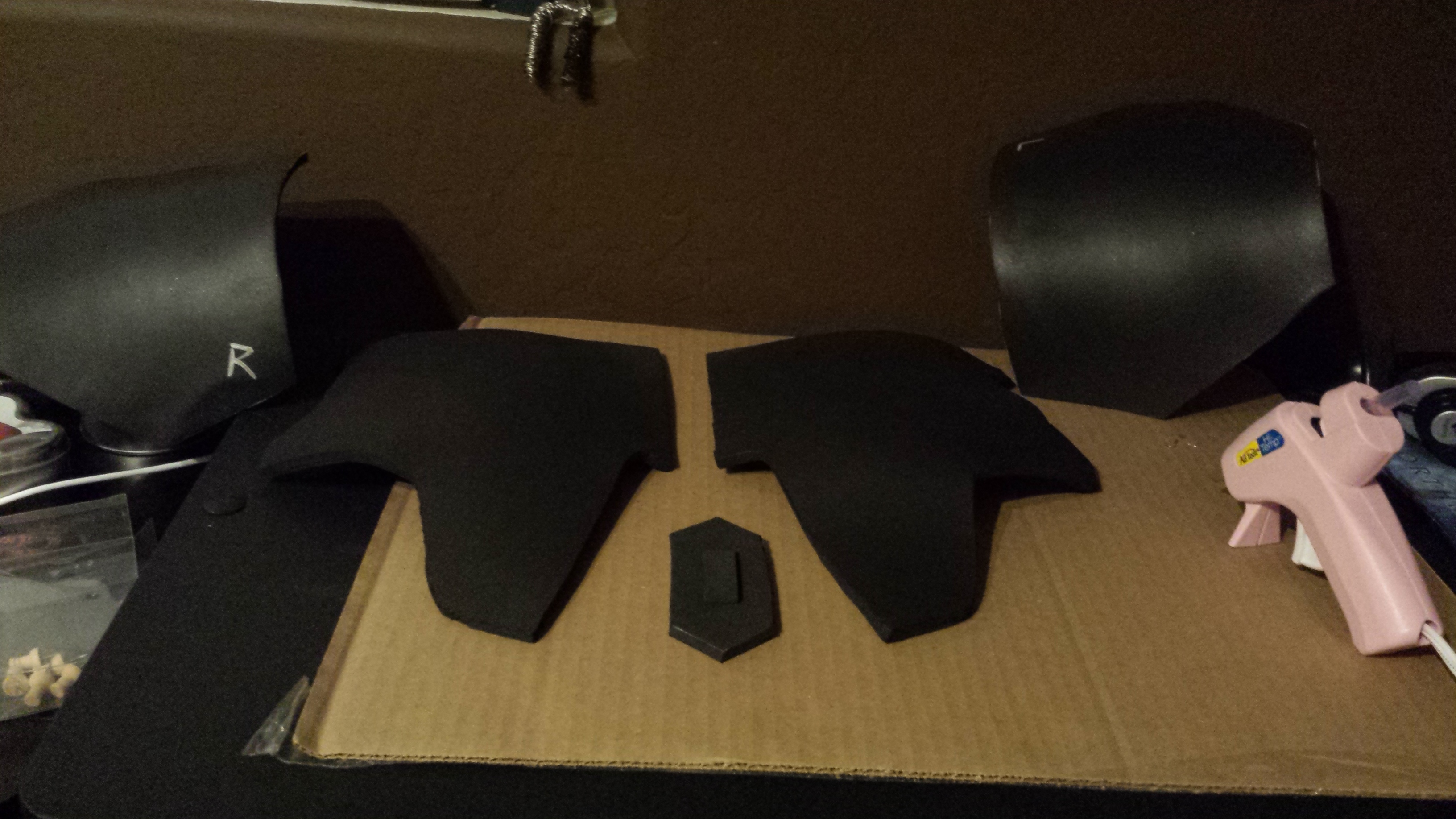

Made my shoulder pieces tonight out of foam. I had barely enough time to cut them out and form them. Early day tomorrow, but after work I am planning on finishing the cut-outs of for my armor sections.

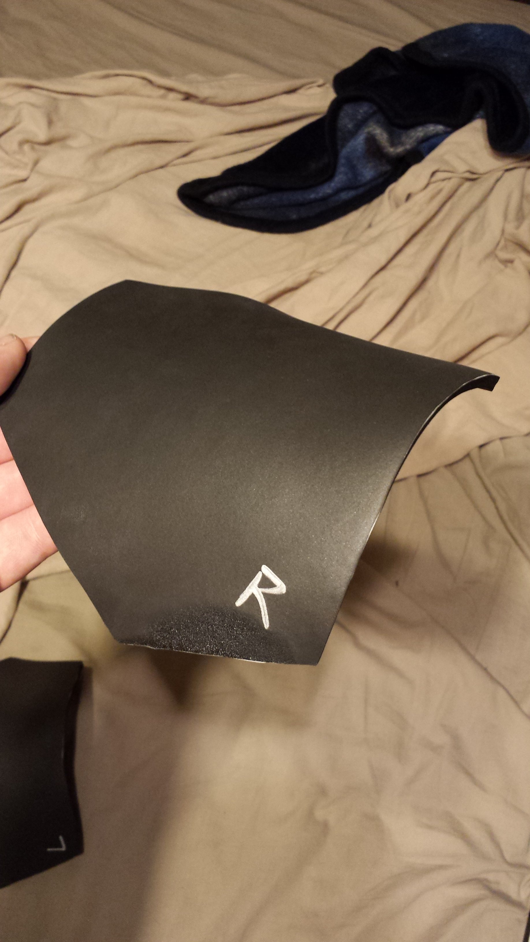

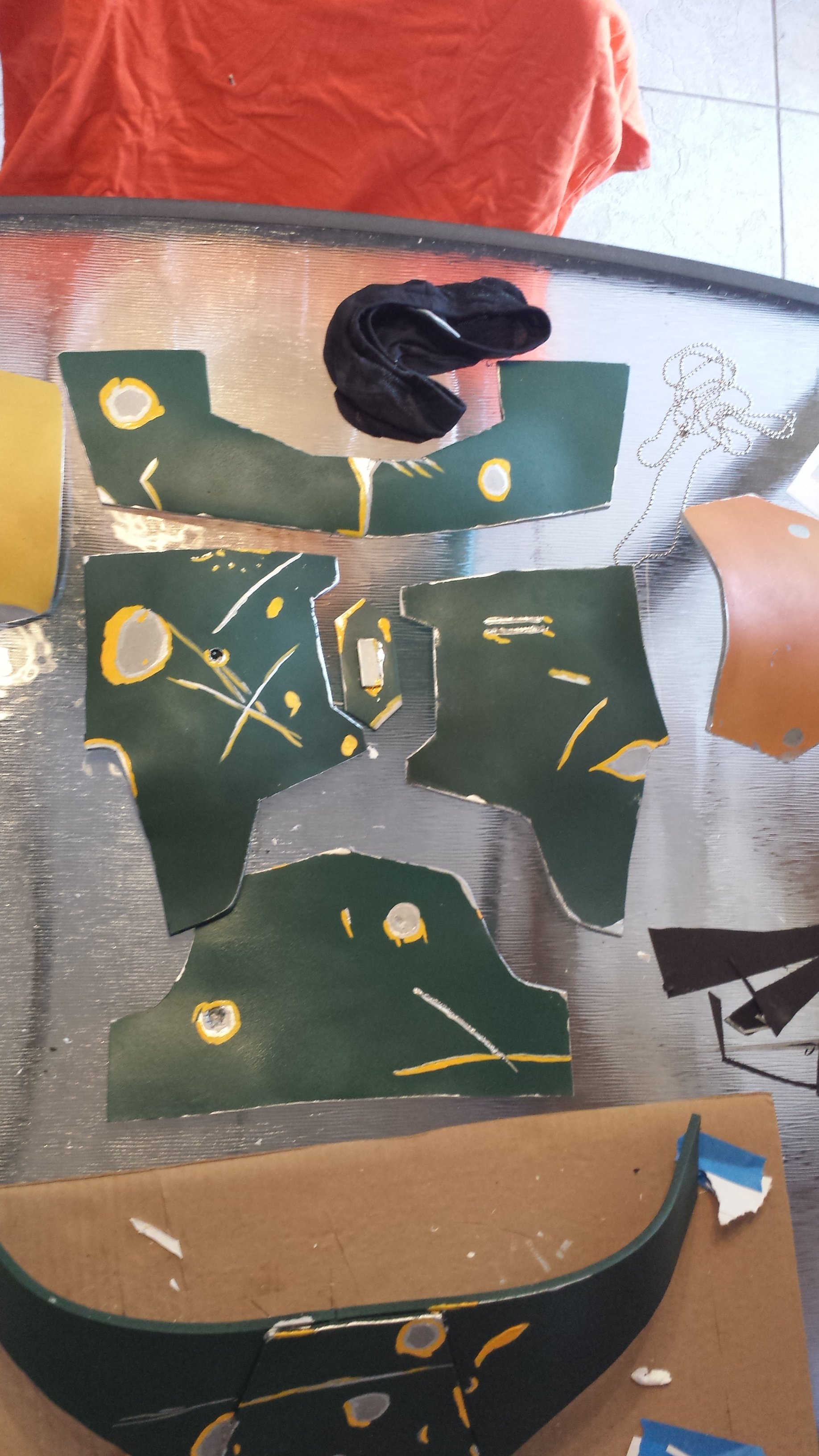

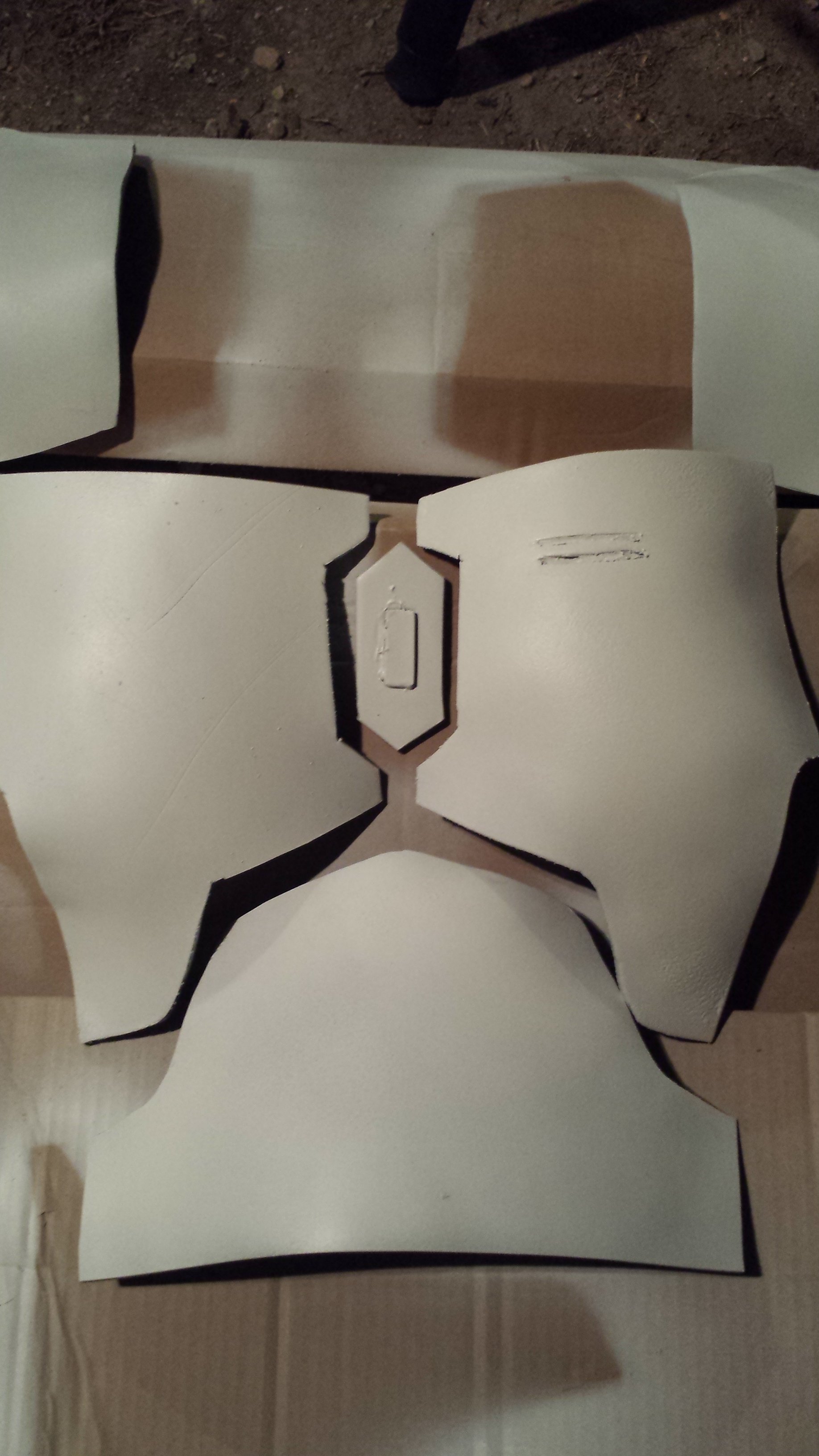

So tonight I cut out the most of the rest of my armor on foam, heated and formed them, and then sprayed plasti dip on the pieces. I have the chest and belly sections as well as the shoulders.

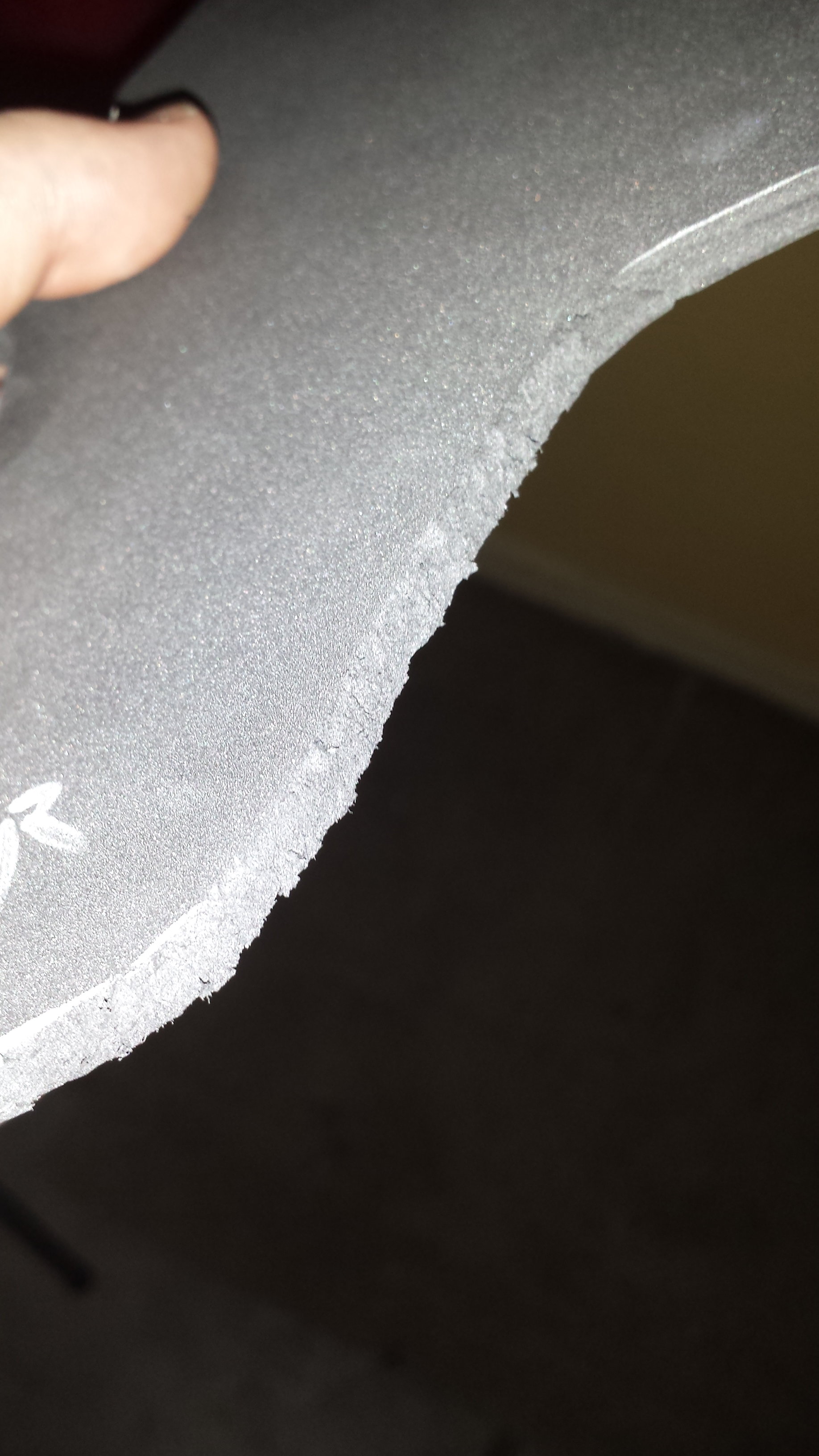

I did not make the most clean cuts on one part but I did heat it up and smooth it out, which worked fairly well.
I ran out of plasti dip, need to buy more. I noticed that less really is not more with plasti dip spray. I have read several posts regarding it and to get that glossy smooth finish a good amount of it needs to be applied or it just looks really textured and that is not really what I am going for. As always any and all input is appreciated.

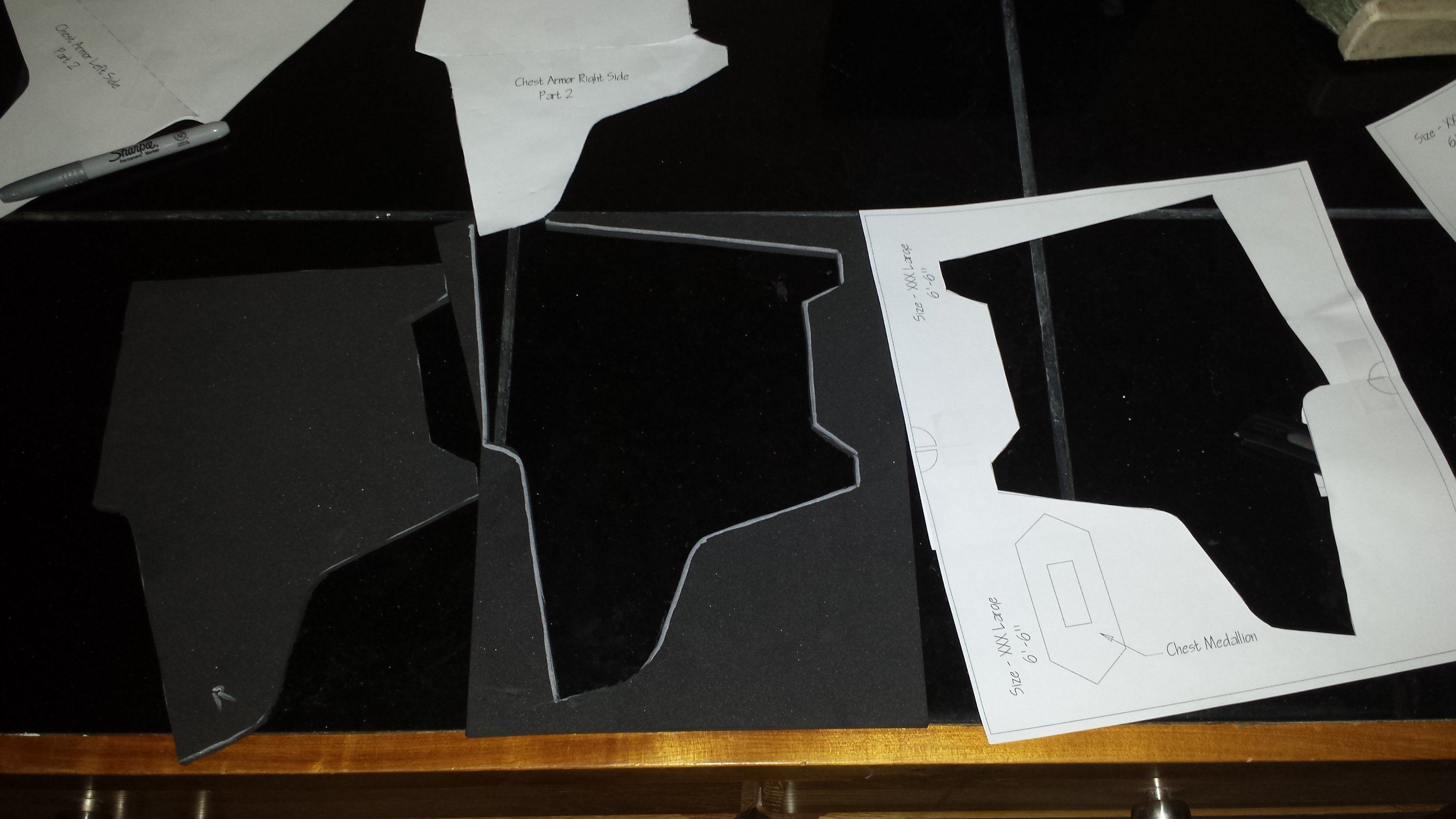

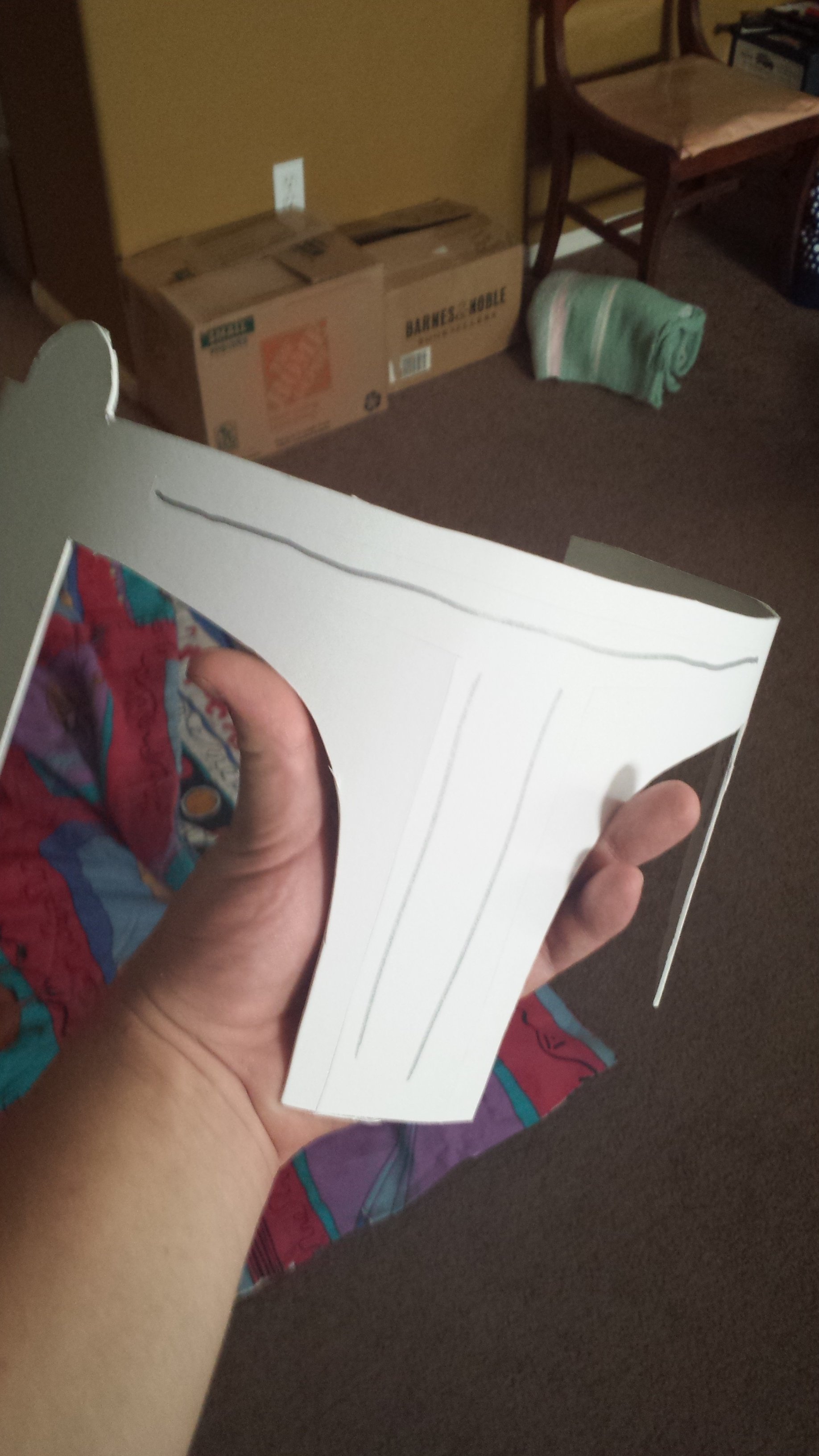

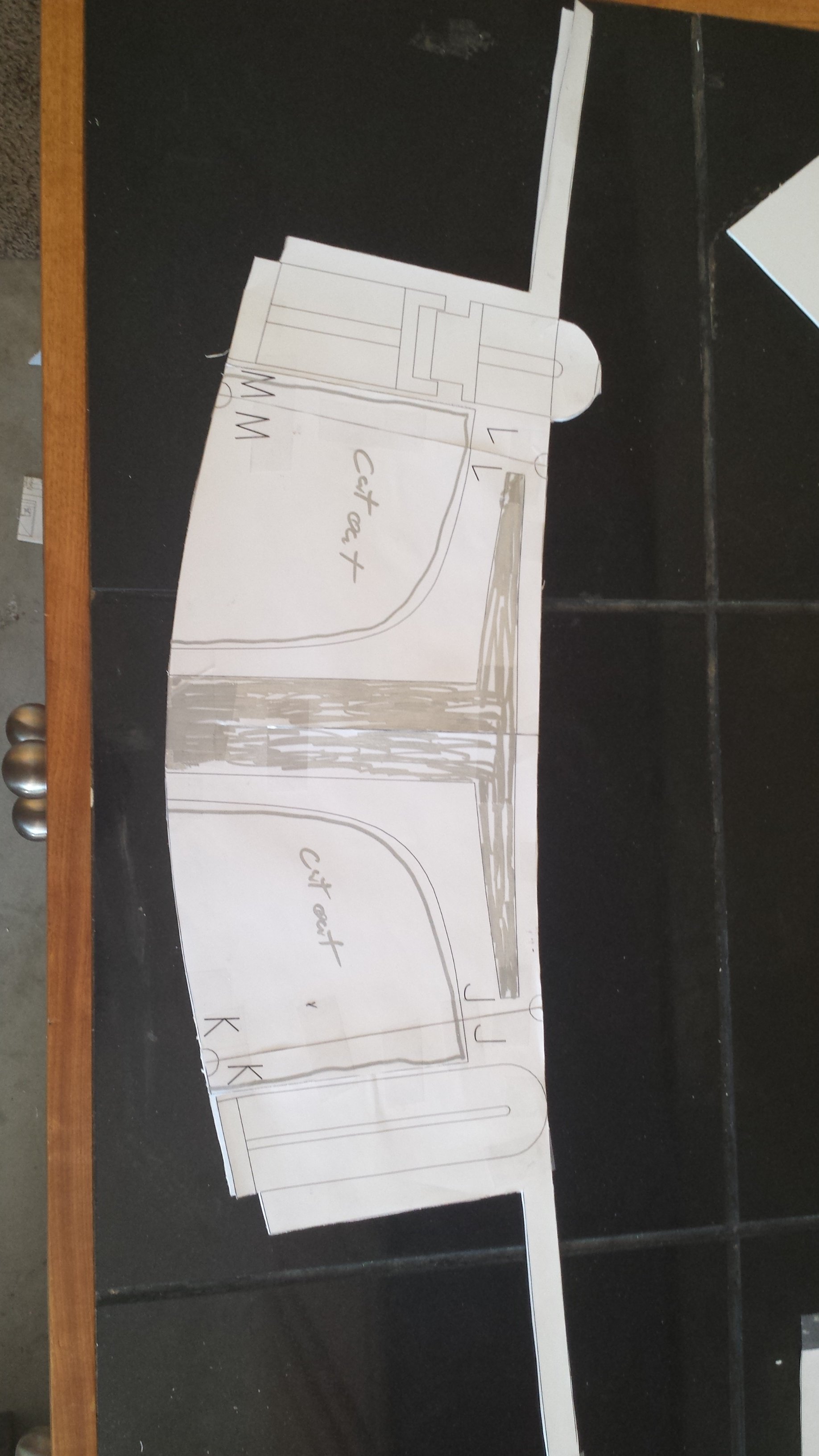

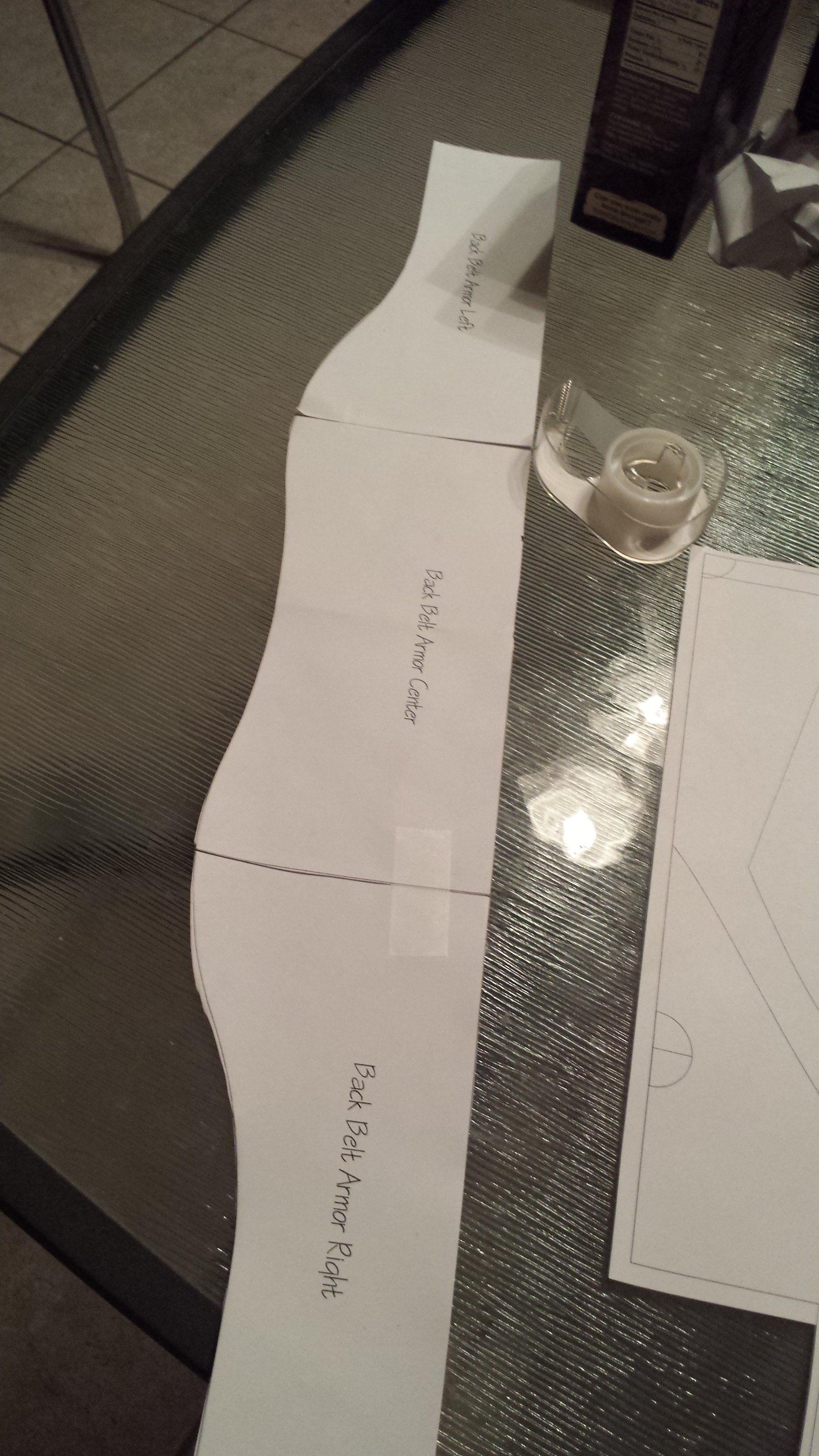

Ok so between work and life I have had limited time to work on my build, but I put in some solid time last night. I cut the cod piece, back belt, and neck pieces last night. I also cut the first part of my helmet out. I used 2mm matt board from Michael's craft store and Alan's templates. Then using the mist setting on a spray bottle I lightly coated the cut out with water. I then bent it to shape and let it sit.
This whole process took about 2 hours. Going slow and making precise cuts, and I still did not do it as perfectly as I hoped to.:(
Over all I think that I did a good job on this part. I need to cut out the rest of the armor, form it, and then plasti dip all of the parts. Side note, to get a really good glossy look to plasti dip, do not spray as recommended on the can. Get CLOSE and make it wet. Be careful of runs. Do several layers of light coat (this will look textured) and then do your finishing layer. Looks pretty good when you are done :lol:lol:
I have some other work done as well but I did not get a chance to photograph them. More to come...

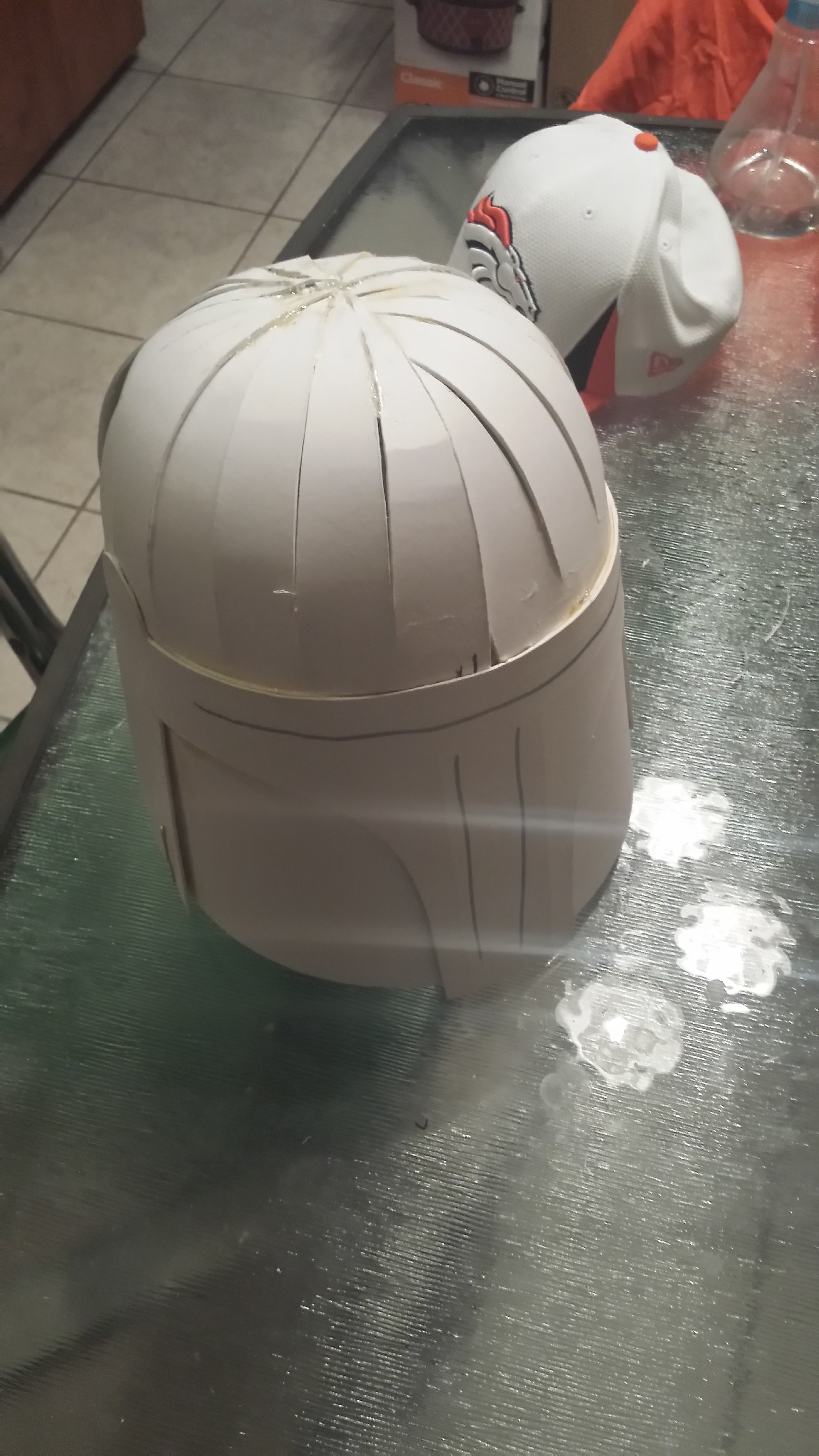

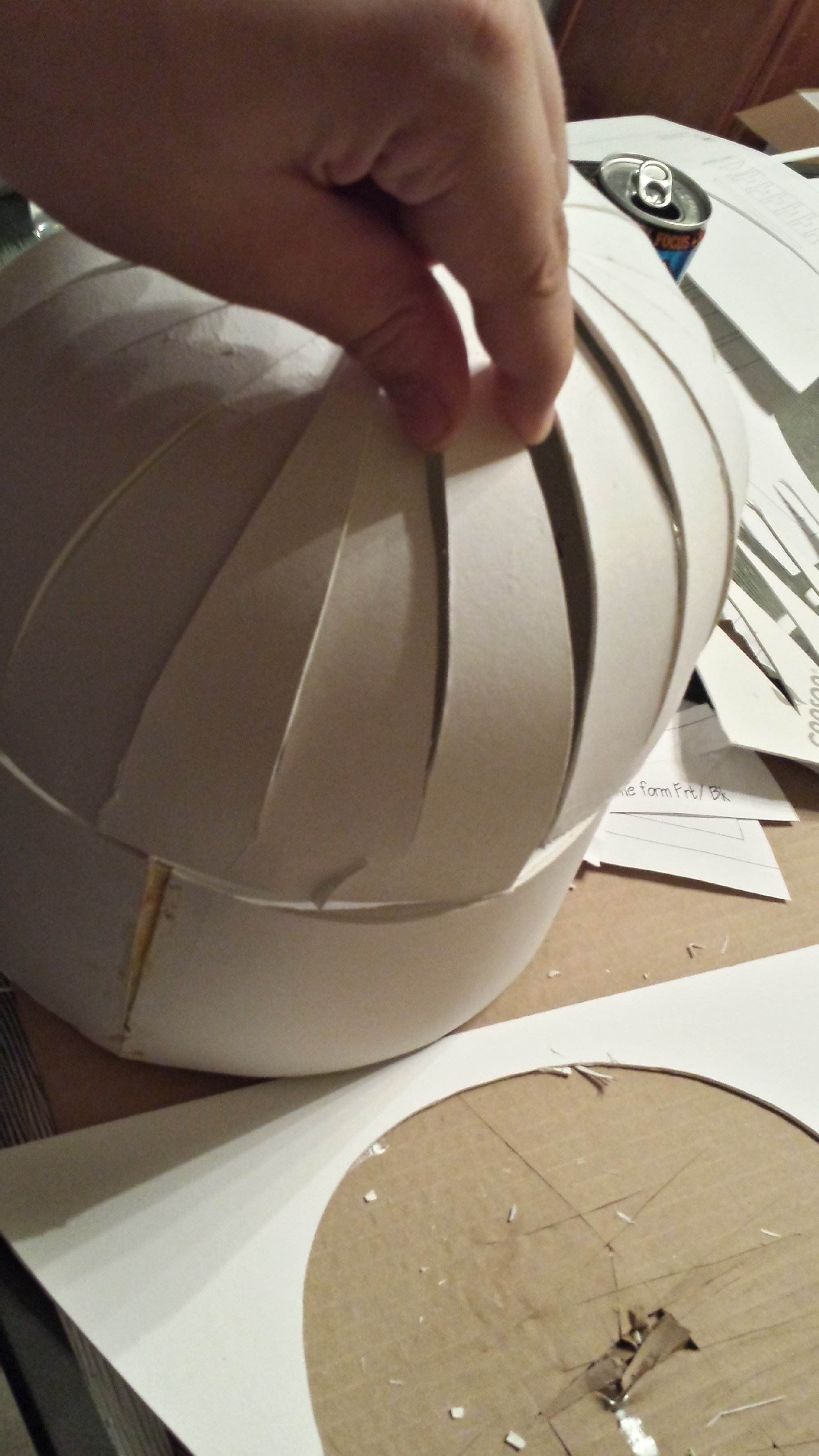

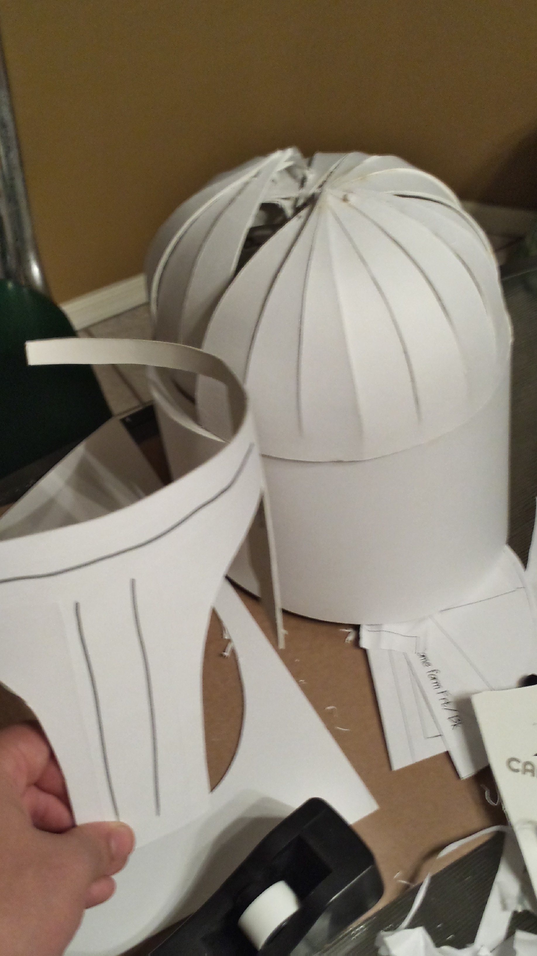

Ok so I have been busy at work but the last few days I have been putting in some quality hours on my helmet. I have the dome and visor sections attached to the inner surface. Just a side note, remember to always use a REALLY sharp knife/razor blade to cut out this matt board. It is really hard to cut even if your blade is a little dull.
Anyway, I had some serious trouble with the dome. I cut it out really closely to the template, not perfect, and then tried to assemble the three sections. Fail.
It was not nearly domed enough. The trick with this part is to wet the matt board really well and bend it farther than you would think necessary. More than 45 degrees. the dome is somewhat sharp angled arch and not a 60 degree dome.
I had to remember to put in the arch supports cut out from Alan's template, this part helped. I found the easiest way to do this was to glue the bottom sections down and let them dry all to the curved base of the dome.
Next I wet down and pressed firm the "fingers" of the dome to get them to go together. Most of them lined up perfectly but a few rebelled against me, so I delt with them like the French and cut the tips of them off :lol:
Then a dab of hot glue at the point for some instant securing and later I added wood glue. Every gluing phase I let the helmet sit for about 8 hours or so until it was very solid. I was afraid of going at it too early and having it come apart on me.
At this stage I was starting to see a helmet come together, but saw some serious errors. Hopefully I can make these go away with the wall filler and sanding (x100). As always if anyone has any tips tricks or criticisms let me know :) Thanks

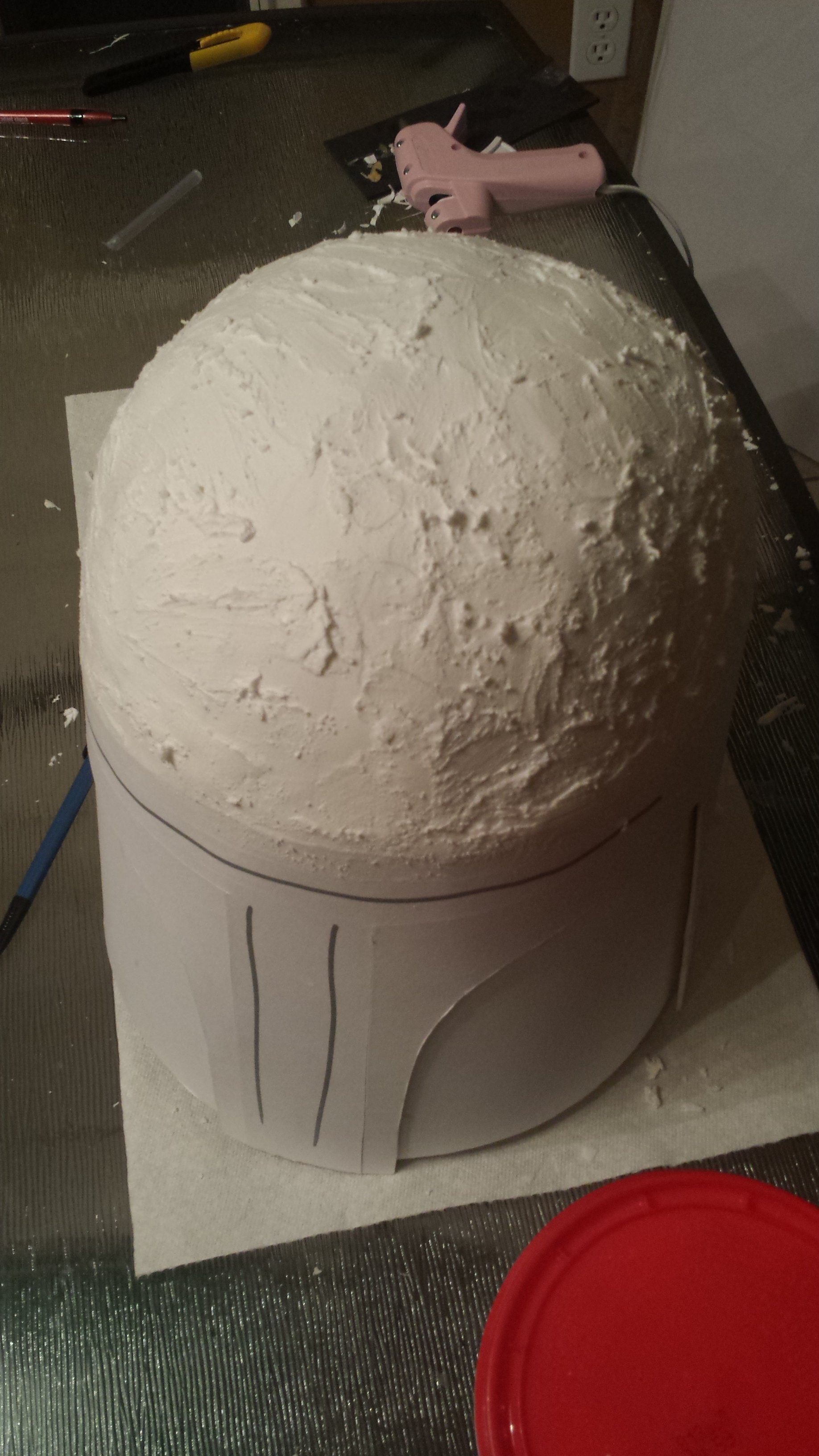

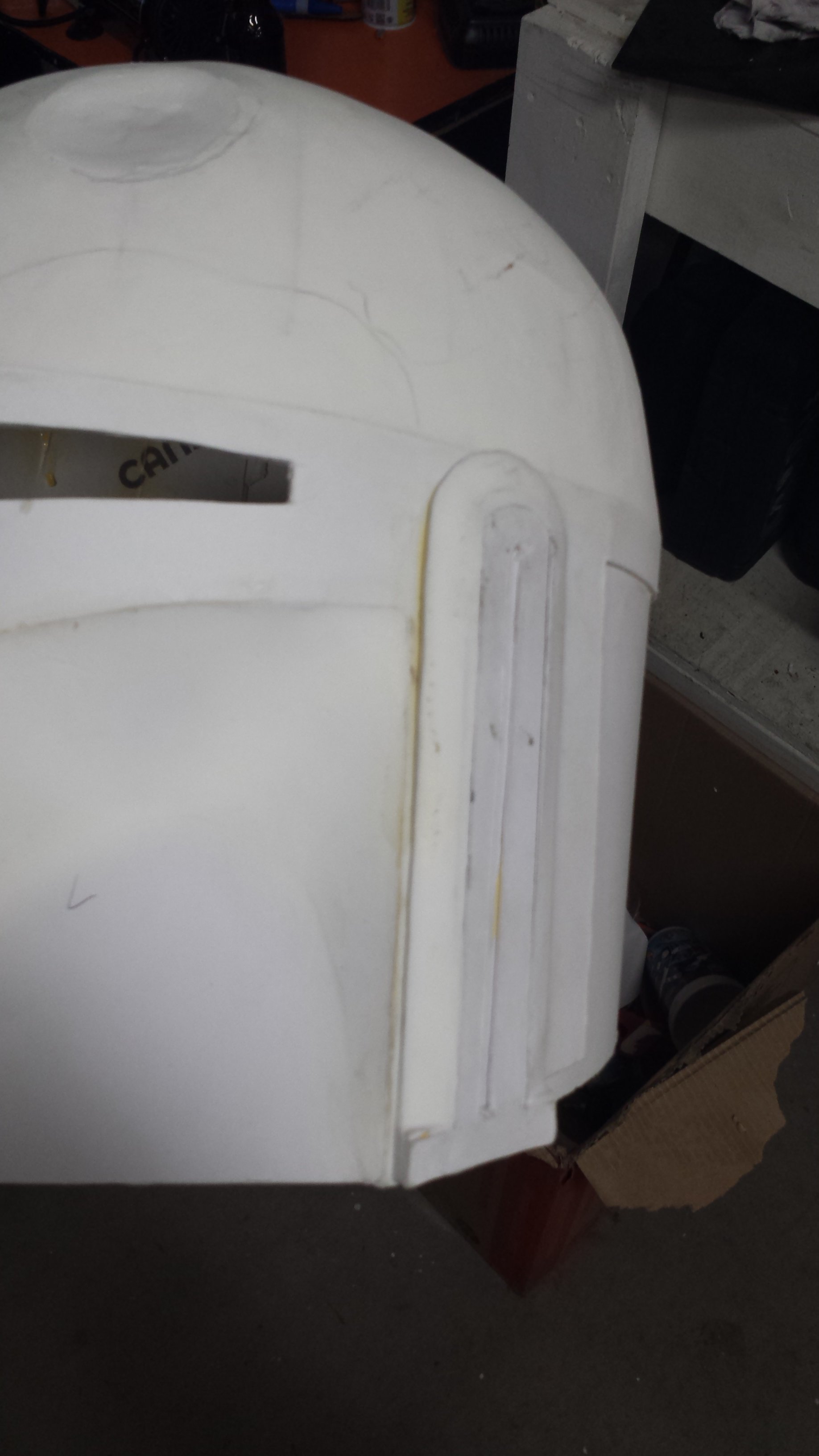

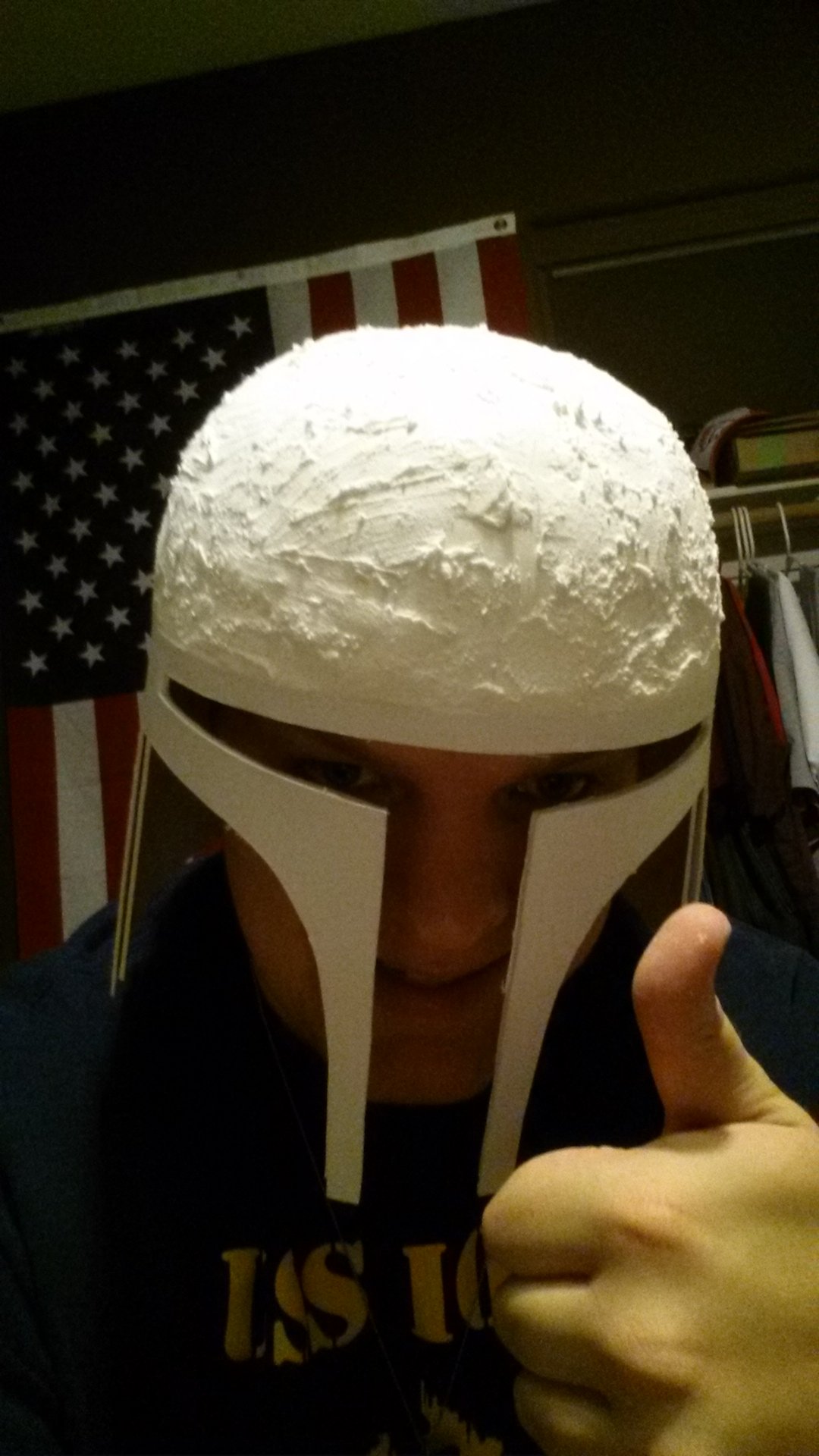

Right into it, I have done some more work on the helmet. Wall filler has been applied to the dome and have dome.
This is what it looks like now. I have some sanding and re applying of the filler ahead of me. Hopefully it will not require 10 re-applications.
I will post after I have a good looking dome, also going to cut out the cheek and visor sections.

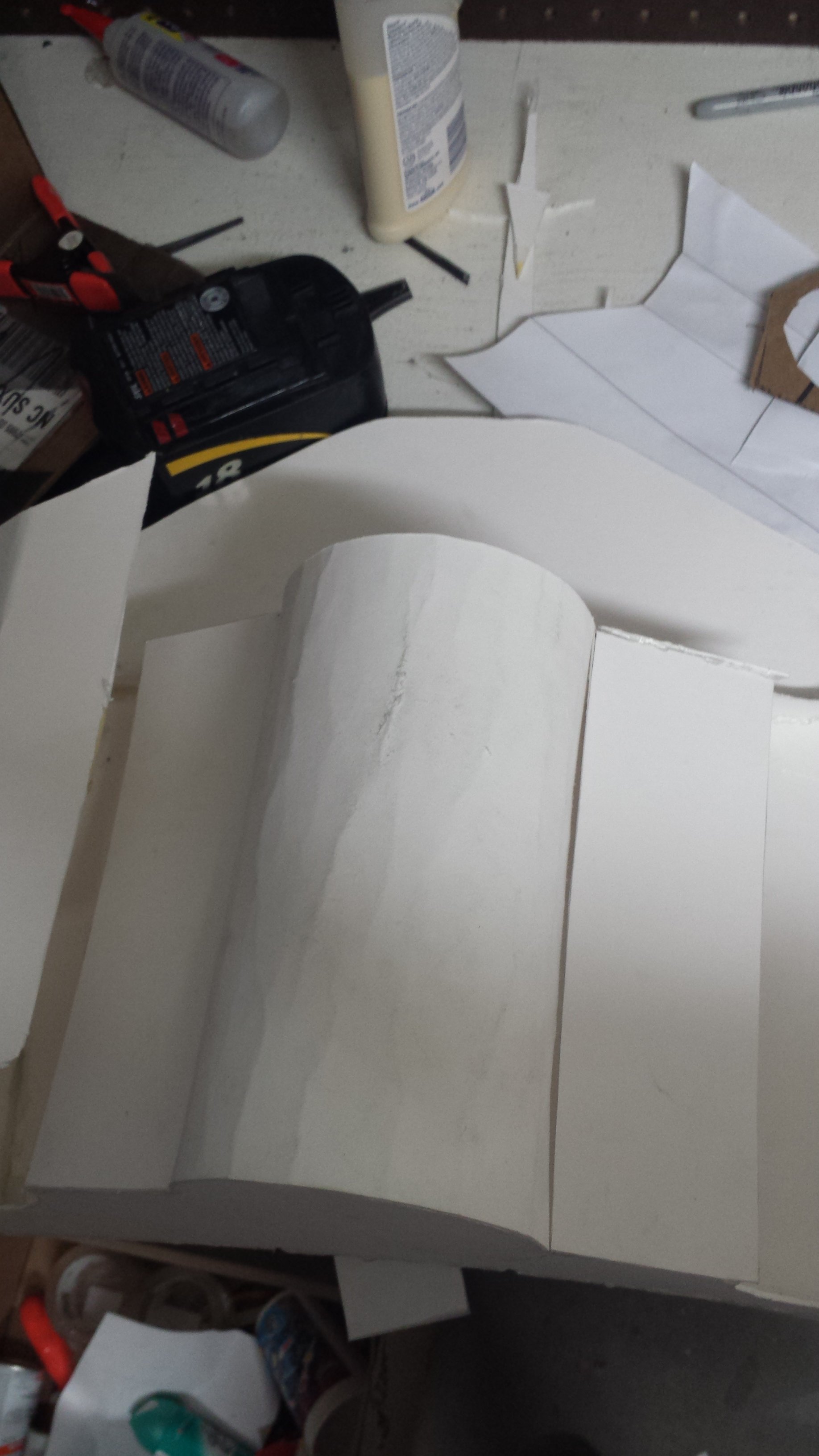

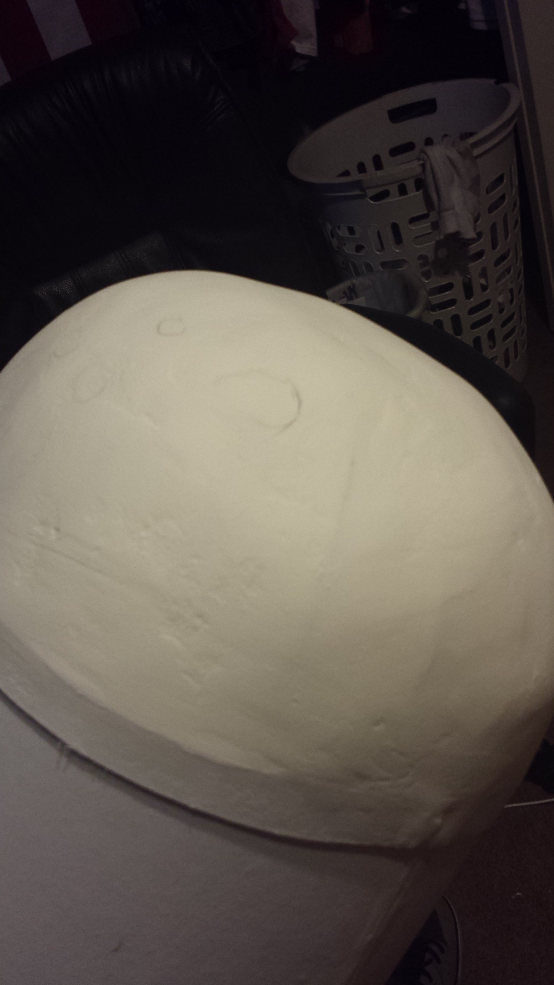

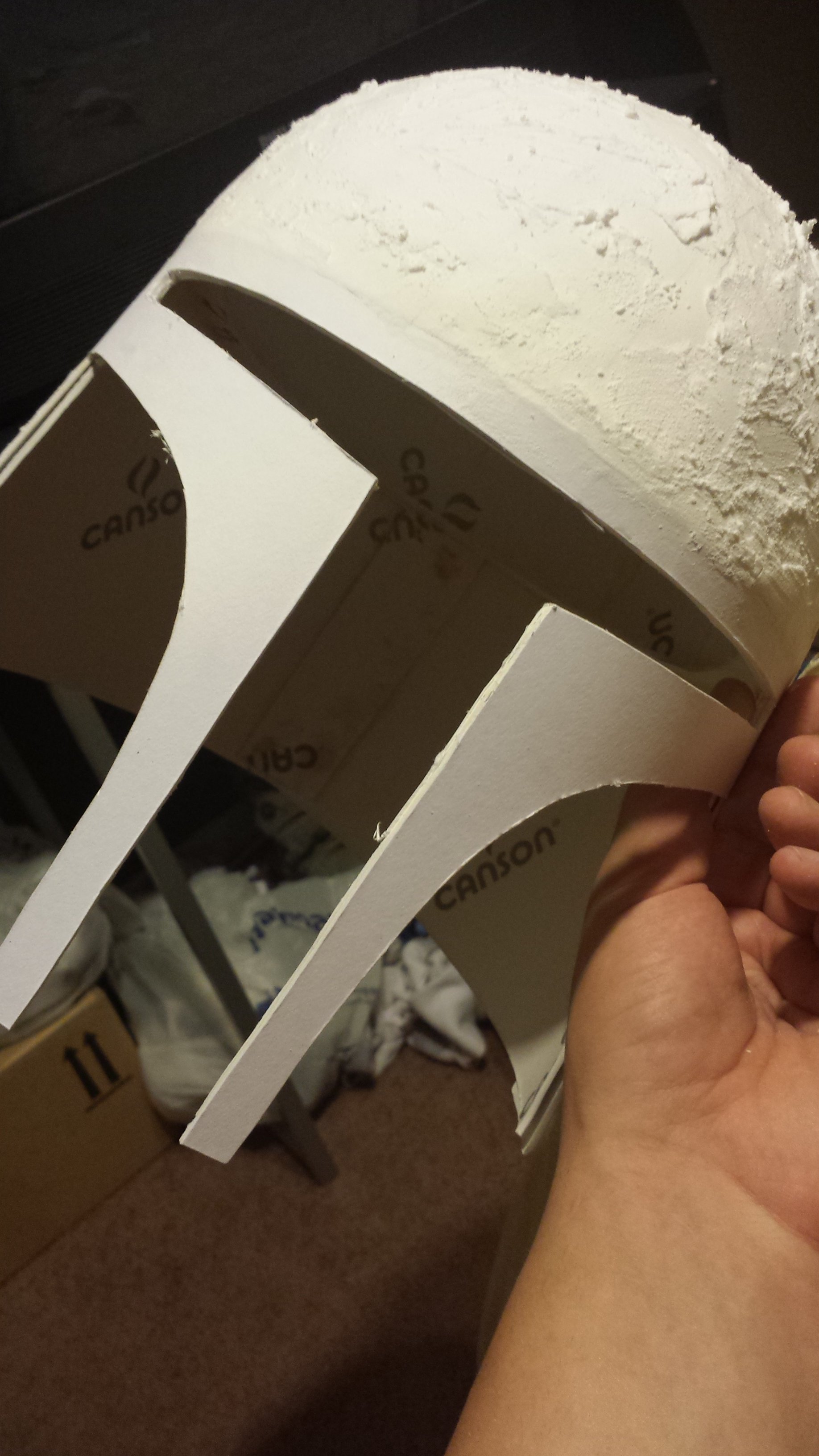

So last night I did some more work on on the bucket.
I sanded the filler down and added more to some spots. Re sanded that. I think I have a few more to go before it looks as good as I want it to.

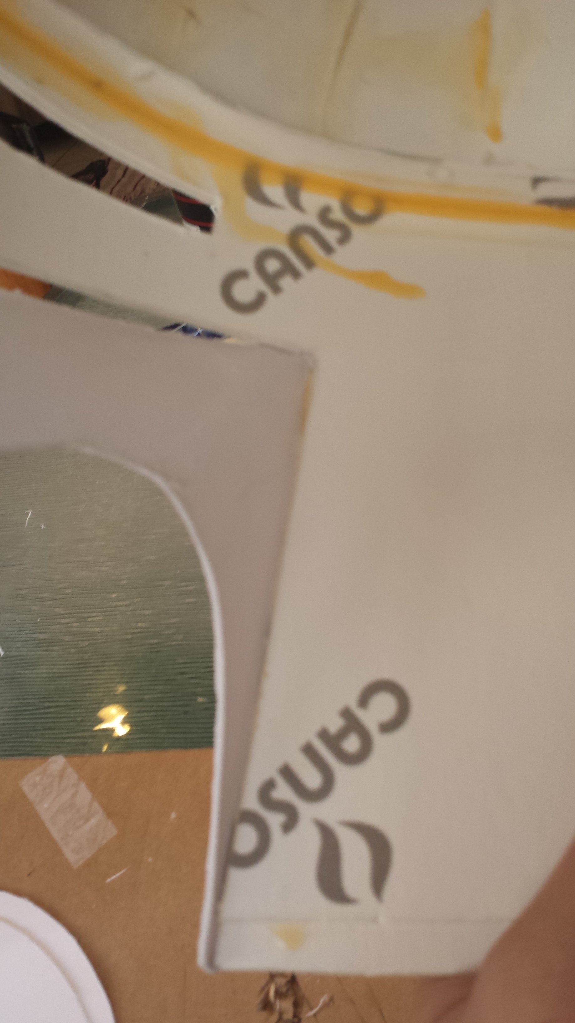

Side note: I used two different types of matt board on this project. The one I am using currently is so much easier to use. It has no paper like substance on the back of it making the cutting out so so so much easier.

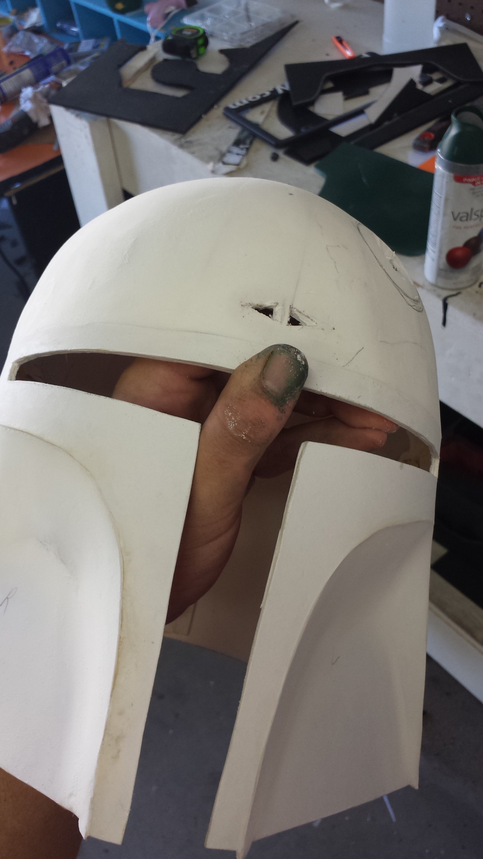

I also cut out the cheek sections, the cheek back plate, and formed the cheeks. This is by far the most difficult step that I have had so far. Figuring out how to bend the form appropriately was a nightmare. But I think I finally figured it out. Here are some update pics of what I have.

I have the armor finished, the gauntlets and knee pads still to do, the jetpack cut out but not assembled (still trying to find a good how-to on Wof's templates on the jetpack and gauntlets) and the helmet is almost ready for painting. Just the range finder left to complete.

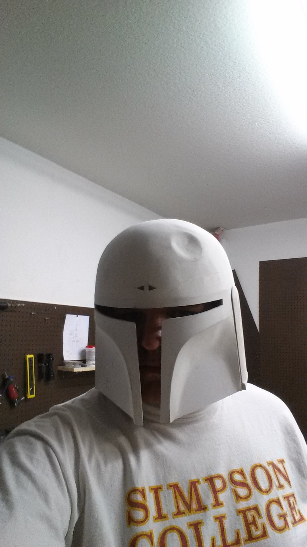

Anyway here is some of the progress that I accomplished on my last day off for awhile here:

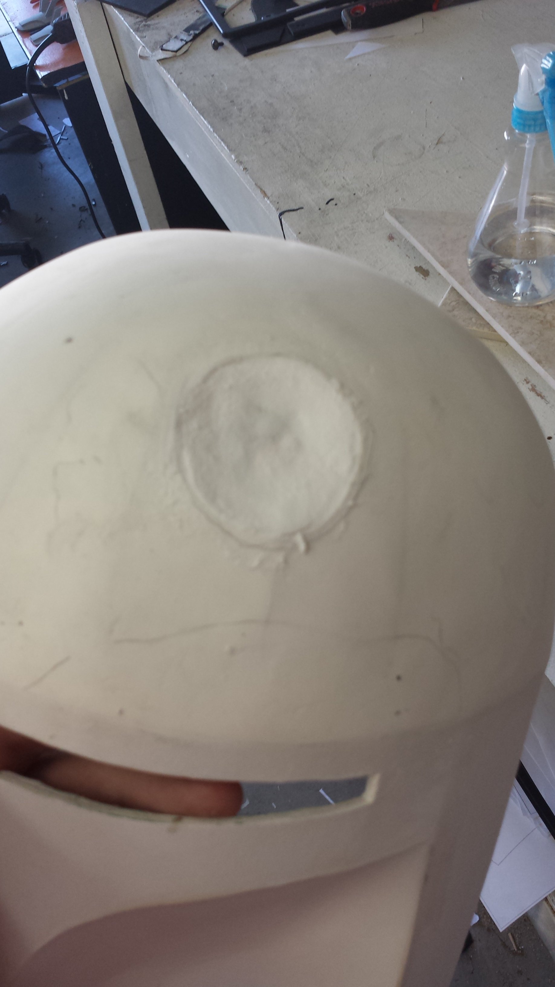

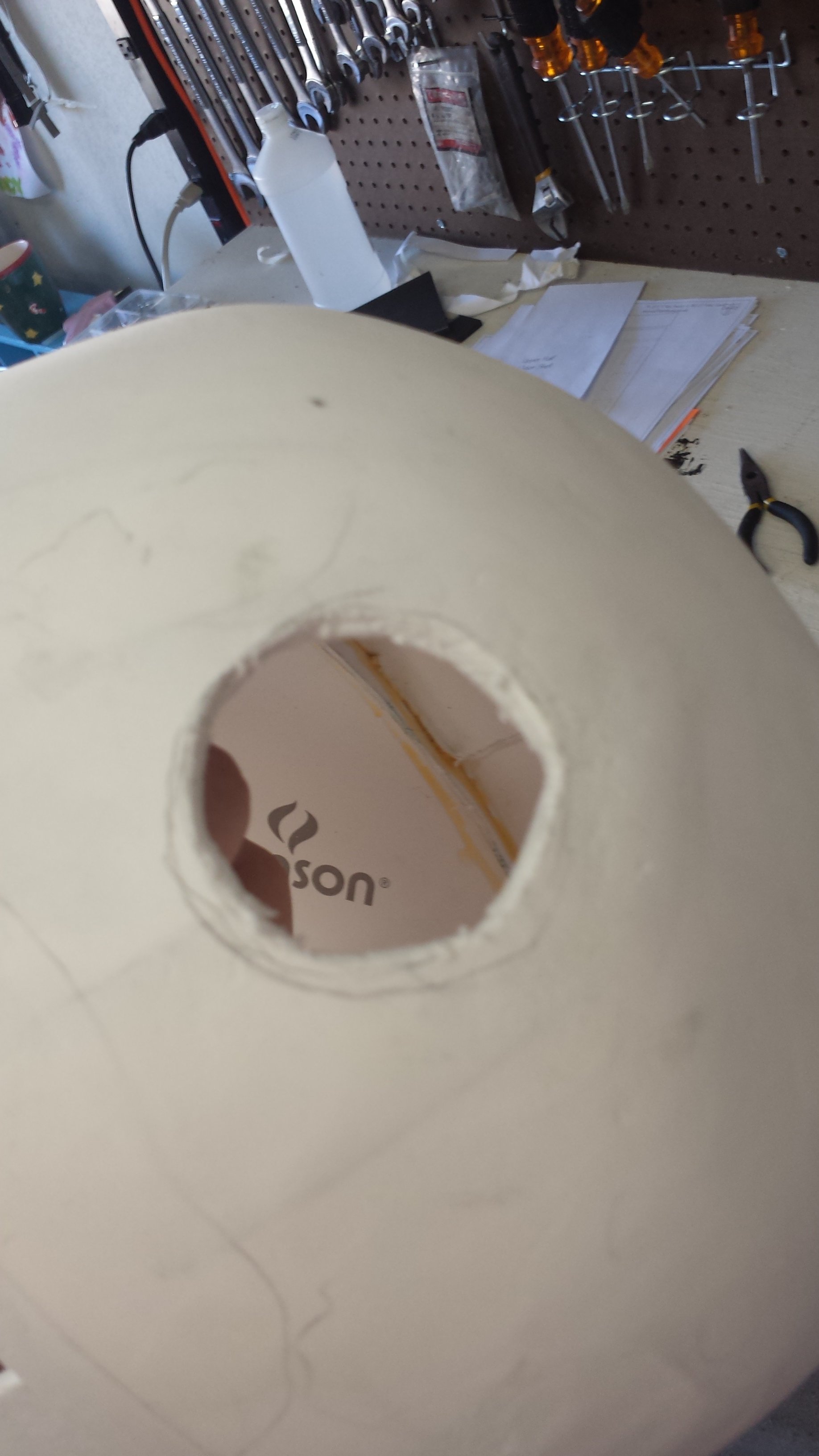

I cut out the hole for the dent using a drill and razor blade to give it a good edge. Next I hot glued a cardboard back to the bottom of the rather shallow hole. I then added my wall filler, which I have yet to sand and reapply. The arrows are going to be toutchd up as well then painted black eventually.
As always any comments questions or criticism is appreciated

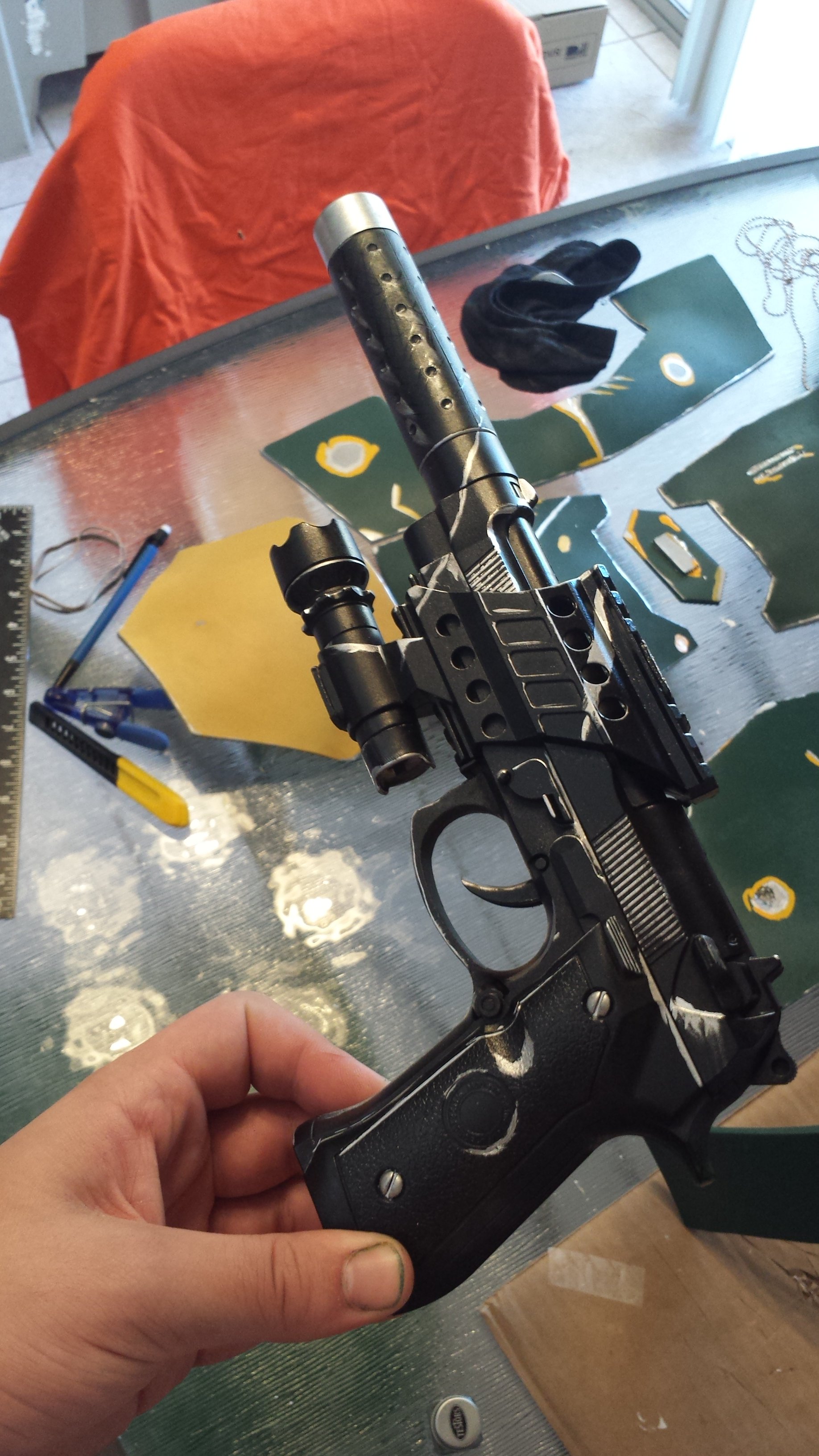

So last night I did a little of the detail paint work on my armor and sidearm. I used testors enamel silver, steel gray, and yellow.
Let me know what you think. This stuff is really starting to come together!
