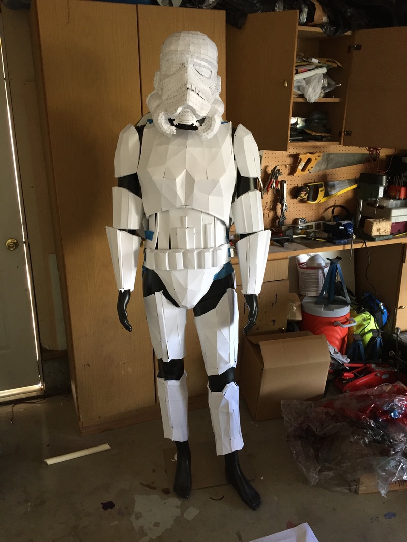

Here is my current project (I know its not Boba, but just to show you how this can be done)
