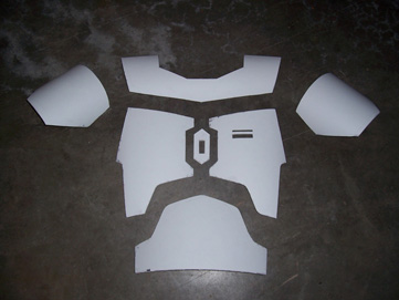

i'm on my way with my first set of armor. i've got all i could cut out of the trash cans last night. i'm going to attempt the cod piece since i had some space left on the smaller can. ran out of space for the back piece which probably wouldn't work well out of a trash can anyway. next step will be cleaning up the edges, denting and sanding for primer.
thanks for the positive feedback everyone. i plan on spending a few hours on the armor tonight since the wife won't be home to hassle me. i'll post pics tomorrow of the progress.

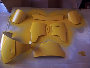

i got quite a bit done in the last week. right now, the green paint is drying on the armor, after work tomorrow i'm going to wash the mustard off. the shoulder bells are pretty much done except for the fine details of scratches that i'm going to do with a paint pen. should i weather them some more? i threw down some flat black and a few sprays of colonial red. boba had to get some blood on him at some point i figure.

here it is with the armor painted green. there is a very light misting of black on there, but almost not visible. it was a little more difficult getting the mustard off than planned. i didn't reapply after the yellow coat so that had 2 layers of paint on it. it isn't exactly the way i had it masked, but pretty dang close. for my first try, i'm quite happy with it. now to the tedious scratching and weathering. i would appreciate any constructive criticism. i'll try to get a real light pic tomorrow, i just finished this now, after midnight. i had to watch the vikings win!!

for cutting the armor out of the cans... first i used a skil-saw to trim them to a very rough cut out and something smaller to work with. from there it was a ruler and utility knife. i made a few cuts along each edge then snapped them off individually. like jimmy buffett said, take your time and don't rush! and thanks for the positive comments, it really means a lot coming from everyone on tdh.
