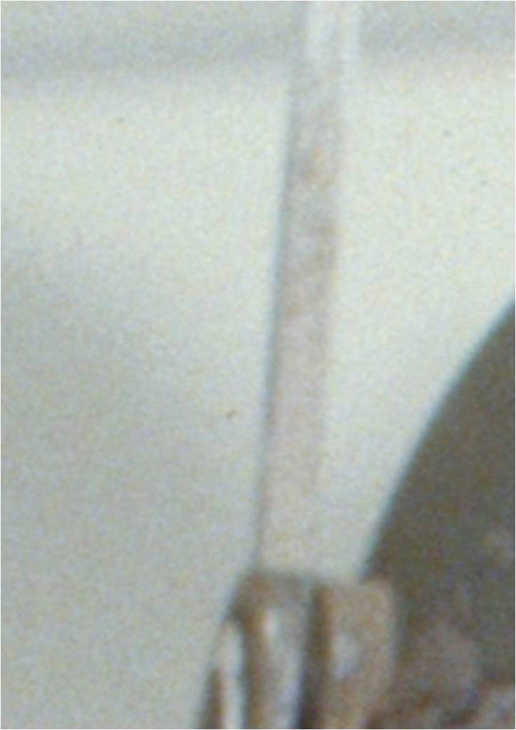

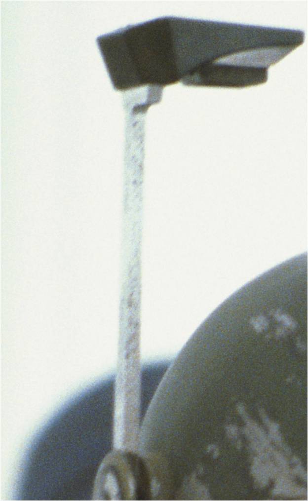

Here is a screen shot:
The pictures are very grainy, but I am seeing yellow splotches in both of those. Now in the second picture, I can see some red on the right had side (as we are facing), but on the lower part of the stalk towards the right, I am seeing yellow again. I see it in both pictures. Am I going crazy?

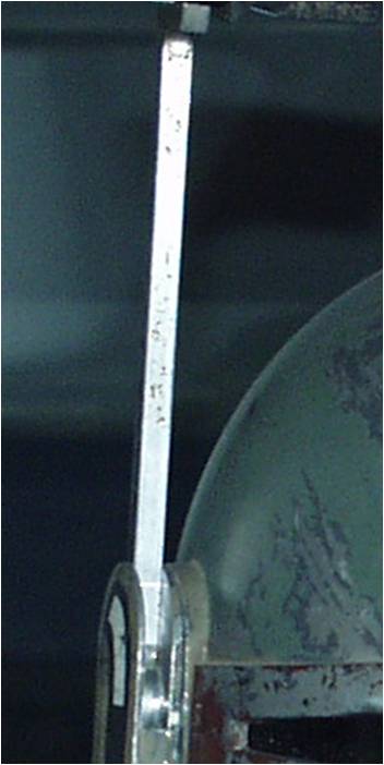

I have tried to consistently use the ESB pictures to determine colors and wear. There have been some definite changes between the ESB and SE version. For instance, look at the RF stalk from the ESB pics. Most of the wear is on the front of the stalk in ESB. In the Art of Star Wars, the weathering is primarily from the side and it looks like it came from a misting that happened post-ESB. I am shooting for a much cleaner version.
Those pics are great for shapes of paint chips, but there has been a lot of fading and additional wear since the ESB.
All of the rust colored stuff in the grainy pic you posted is visible in the AOSW and C4 gallery, It was painted in the same style as the PP3 which we also have very good pics of neither have "gold" as you call it....nor does it appear to have ever had gold on it. There IS weathering on the side of the grainy pic you posted. If you believe that or not is up to you.... I do not believe there was misting that was added...as the PP3 helmet and the ESB helmet both have the same rust color misting applied to them as you can see in the pics youre referring to also.
Sorry to use the term "gold." How would you describe the color on the front of the first inch of the stalk in the two pictures I posted?
That section looks pretty clean in AOSW. I would chalk it up to graininess or a reflection, but those were two pictures taken in two settings under different angles that show this.

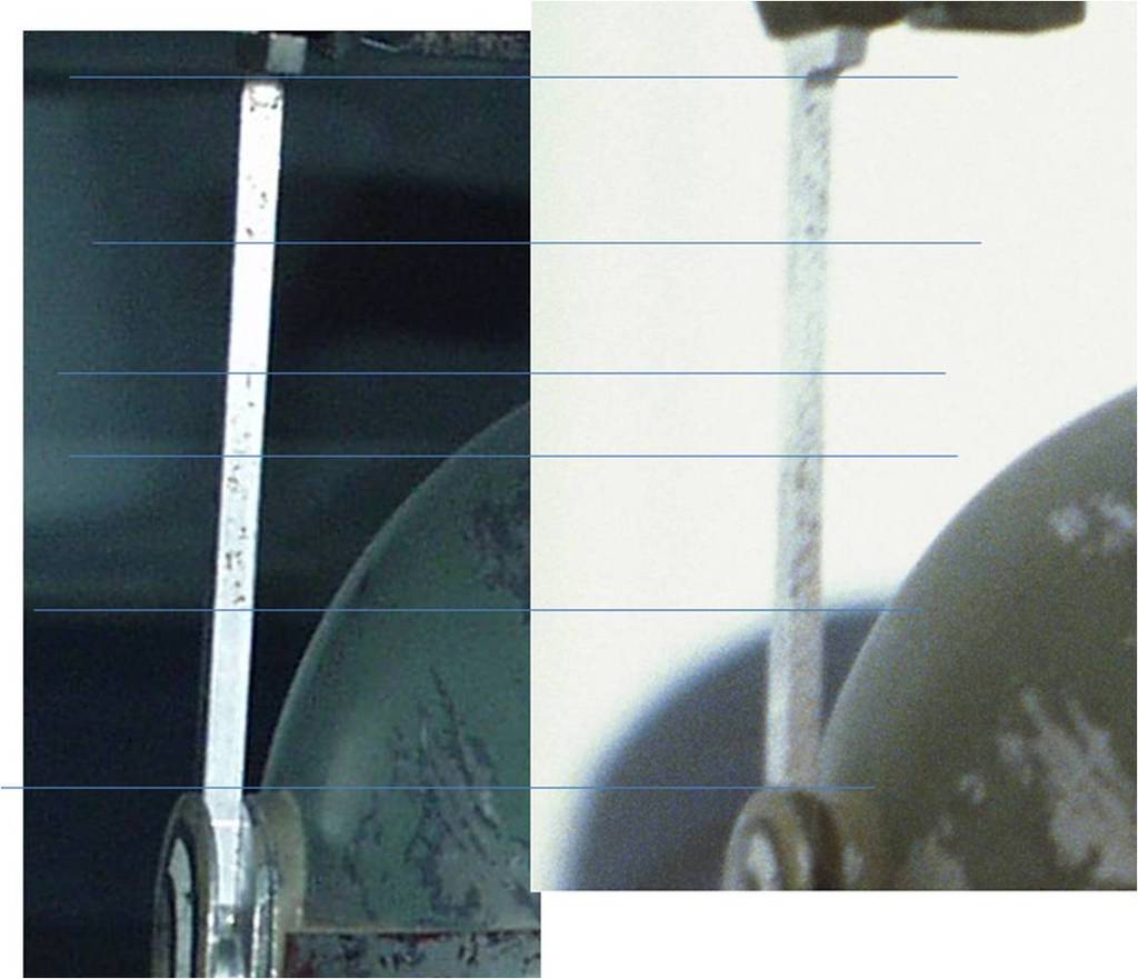

Here is a side by side of two pictures. Some parts match up well. Others don't. Maybe it is just reflection. But it seems like maybe there are some diagonal scratches up and down the front of the stalk in the older picture. But again... a lot of grain there.
That's it! Thank you. I wonder why it doesn't show up in the above picture. I have some leather on hand that I used for the knife/ chemical mixer shin tool.
