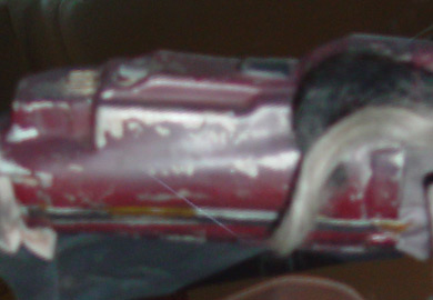

ESB Left

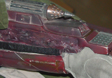

AOSW Left

I haven't looked into it enough to know how exactly it works, but it seems like on the left gauntlet, the gauntlet bottom velcros over the top in ROTJ, and goes under in ESB. I'm sure there are better photos from the exhibits, I just grabbed what I found on the online ref gallery.
