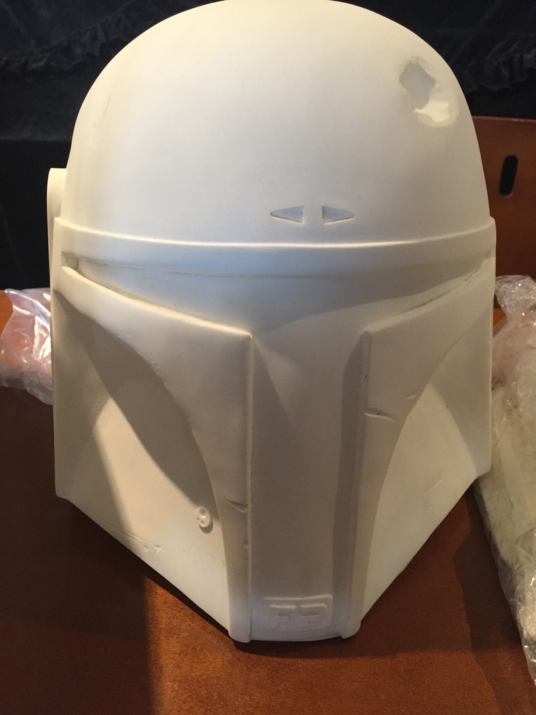

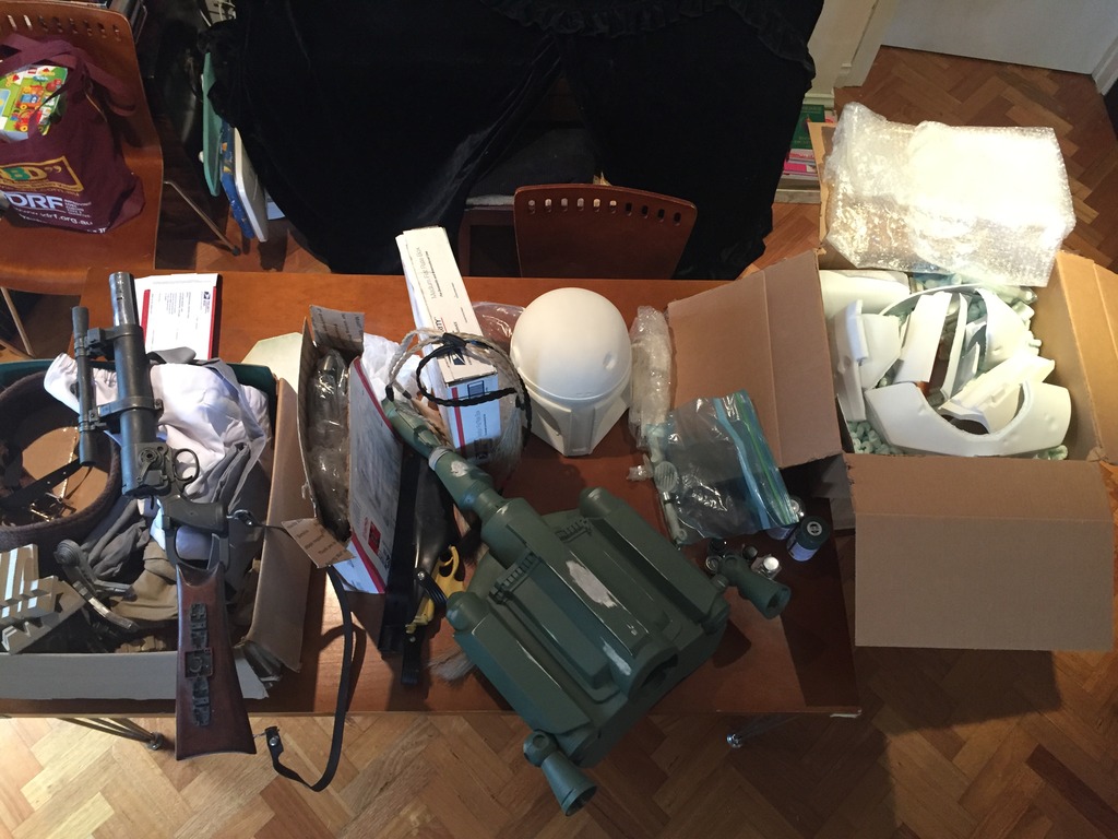

Here are all my parts in their current state:
The first question I have about my build is the Helmet. It's a Fett Pride GMH. I had a look for a build thread, but couldn't find one, I found a great Youtube series on how to paint a ESB lid, however, the buckets used in the series are different to mine, can anyone who has worked on the GMH point me in the direction of a good build thread? cheers!

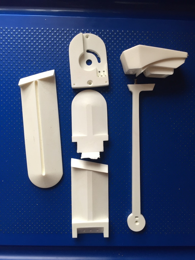

Also, I have some questions about the parts that came with my GMH.
The range finder is a complete cast, and I thought it would come with the see through part, how do I make that part look clear? Is it even possible? Or do I need to buy a rangefind kit from someone else, has anyone put one of these together before?

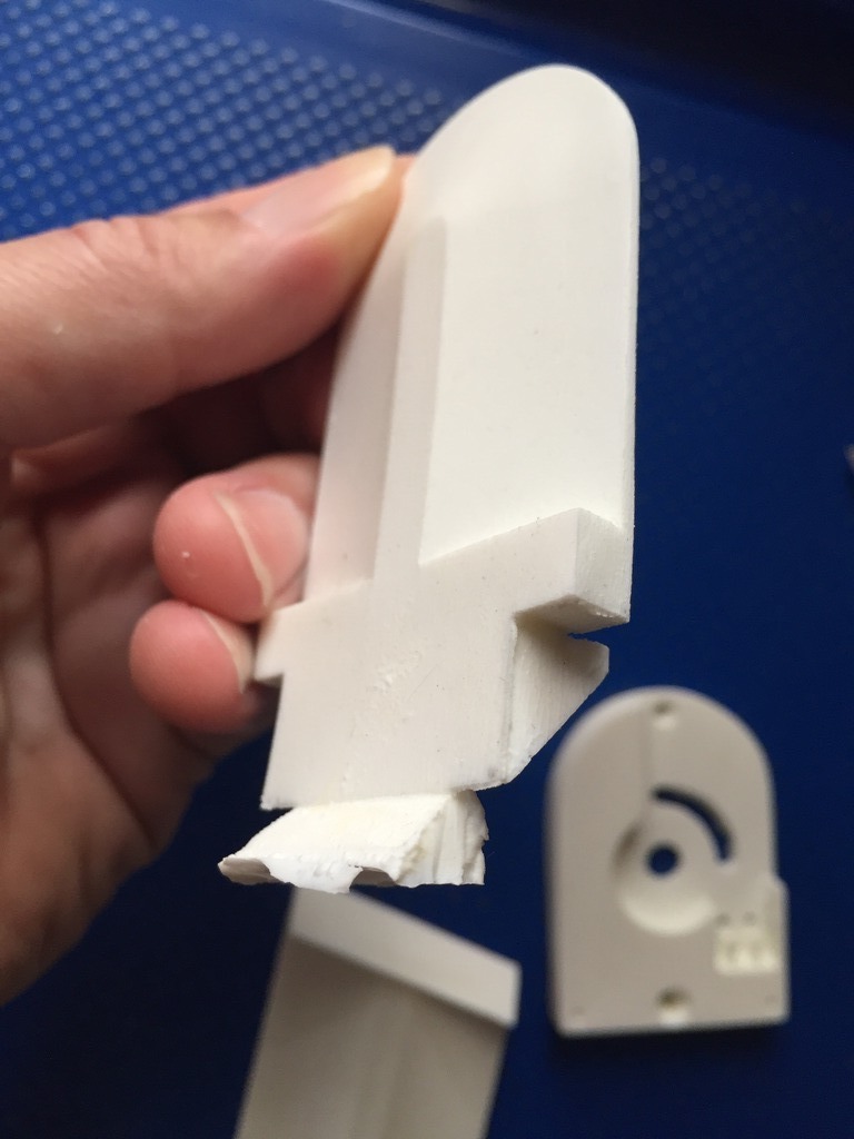

Also, whats the deal with this ear piece, do I just dremel/sand this piece off on the bottom?

I am getting ready to ship a new GMH to Melbourne in a week or so. I will see if the fellow member there would be willing to ship you a spare range finder kit if I put it in his box. PM me for details.
Is that rangefinder all one piece?
Dremel off that bit on the bottom and contact @Wasteland or @Skyfire about getting a new rangefinder topper.

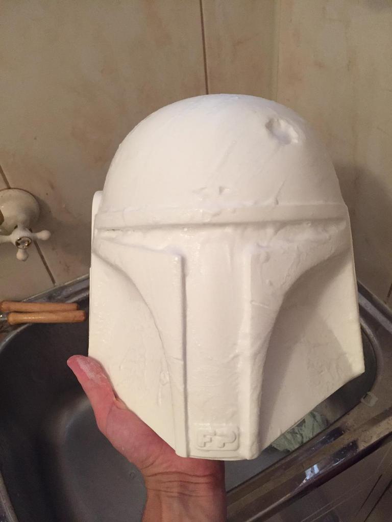

Ok, so I got 2 hours to myself this arvo, so I thought lets get back to the Fett. I washed the bucket:

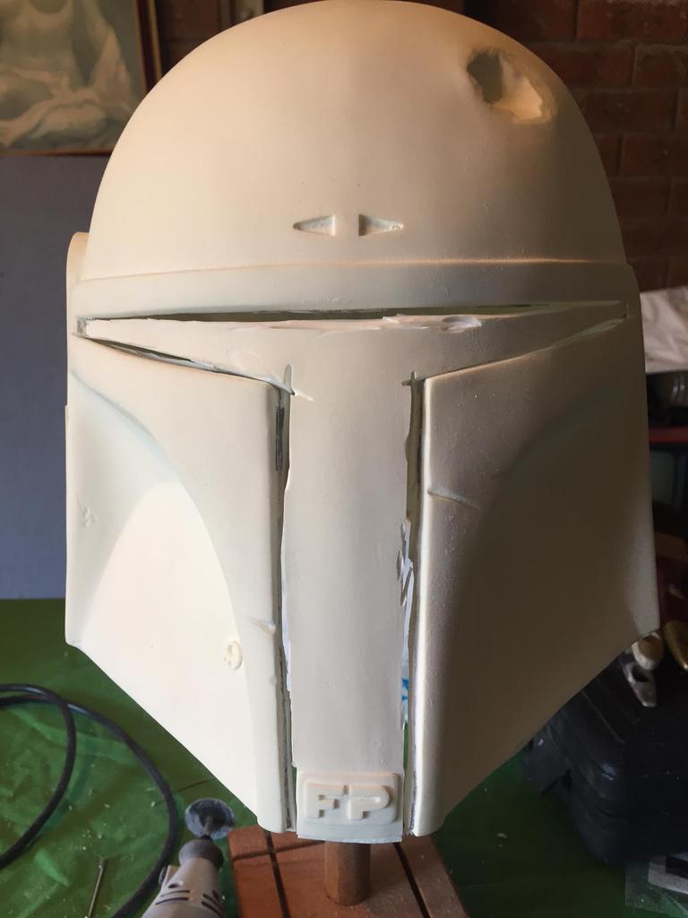

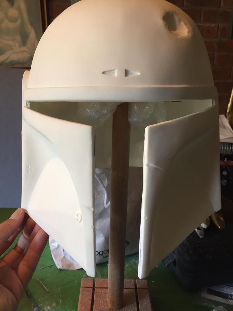

Got out the old dusty Dremmel, marked out the visor, and cut that sucker out!
I then sanded it back a bit to get the edges smooth

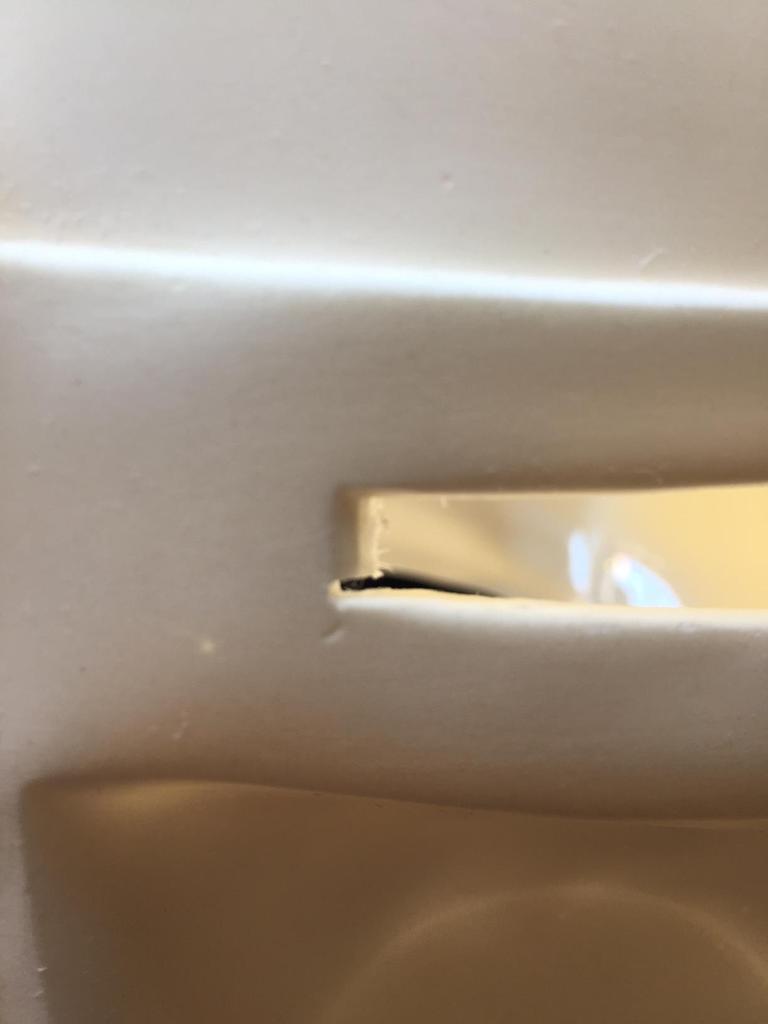

But I did stuff up the very edge of the visor hole, what should I use to fix this? It's a resin GMH, so what kind of bog would work best?

Hey guys, can anyone show me exactly on the GMH where I have to fill with body filler to make it ESB accurate? I'd hate to fill in a scratch/dent thats meant to be there! I've searched on the forum but I can't see anything, please help. Also, can I use Primer Filler on the resin GMH or do I have to use body filler?
All the scratches should be filled, because the GMH is a descendant of the Pre-Pro #2 helmet. For the ESB scratches check out the end of the first post of this thread ==> http://www.thedentedhelmet.com/showthread.php?t=41899.
Thanks Raf!!! I'll fill all those spots except the ones marked in the photo. There is a scratch on the top of the dome as well, I'm assuming that needs to be smoothed out yeah? Cos the photo only shows the front of the bucket.
