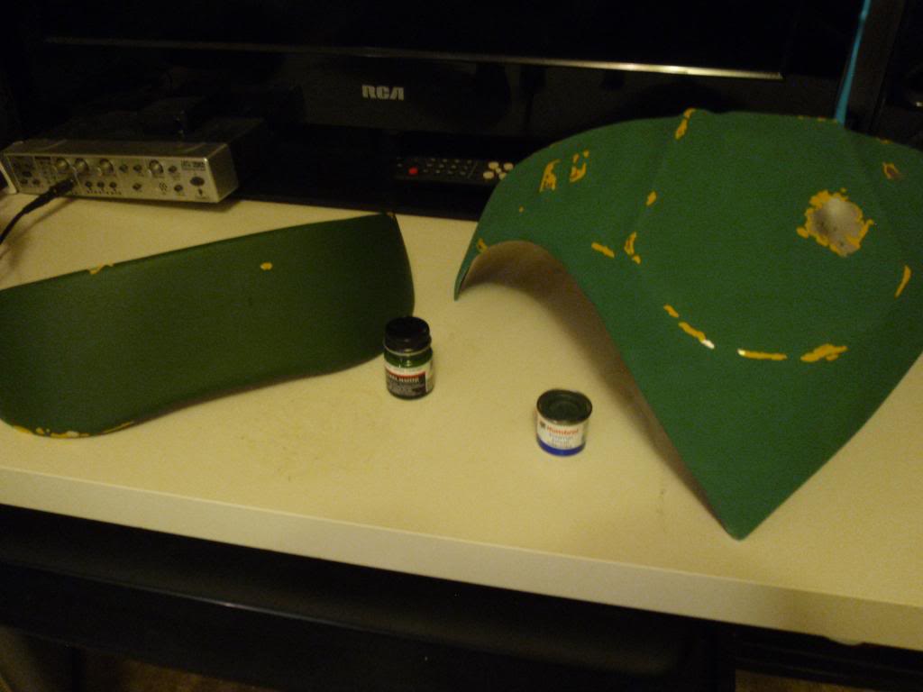

How many tins of green 76 will I need for complete coverage of all the chest/back/cod?
Comparison...
The codpiece is Humbrol 76, and the buttplate is Model Master Medium Green FS34102. Which do you like?
Should I consider a 3rd color, or go with the medium green (buttplate)?

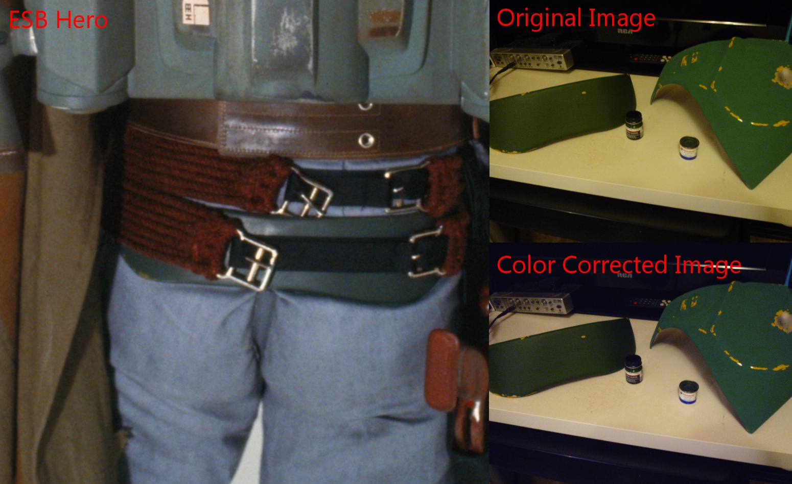

Judging by your image, there is too much yellow light (possibly from the camera or the phone) and those colors looks greener than they are in reality (?). I color corrected your image by reducing the yellow and the result is closer to the ESB color:
Maybe a bit of blue might solve your problem, but I highly recommend to do some color testing.
