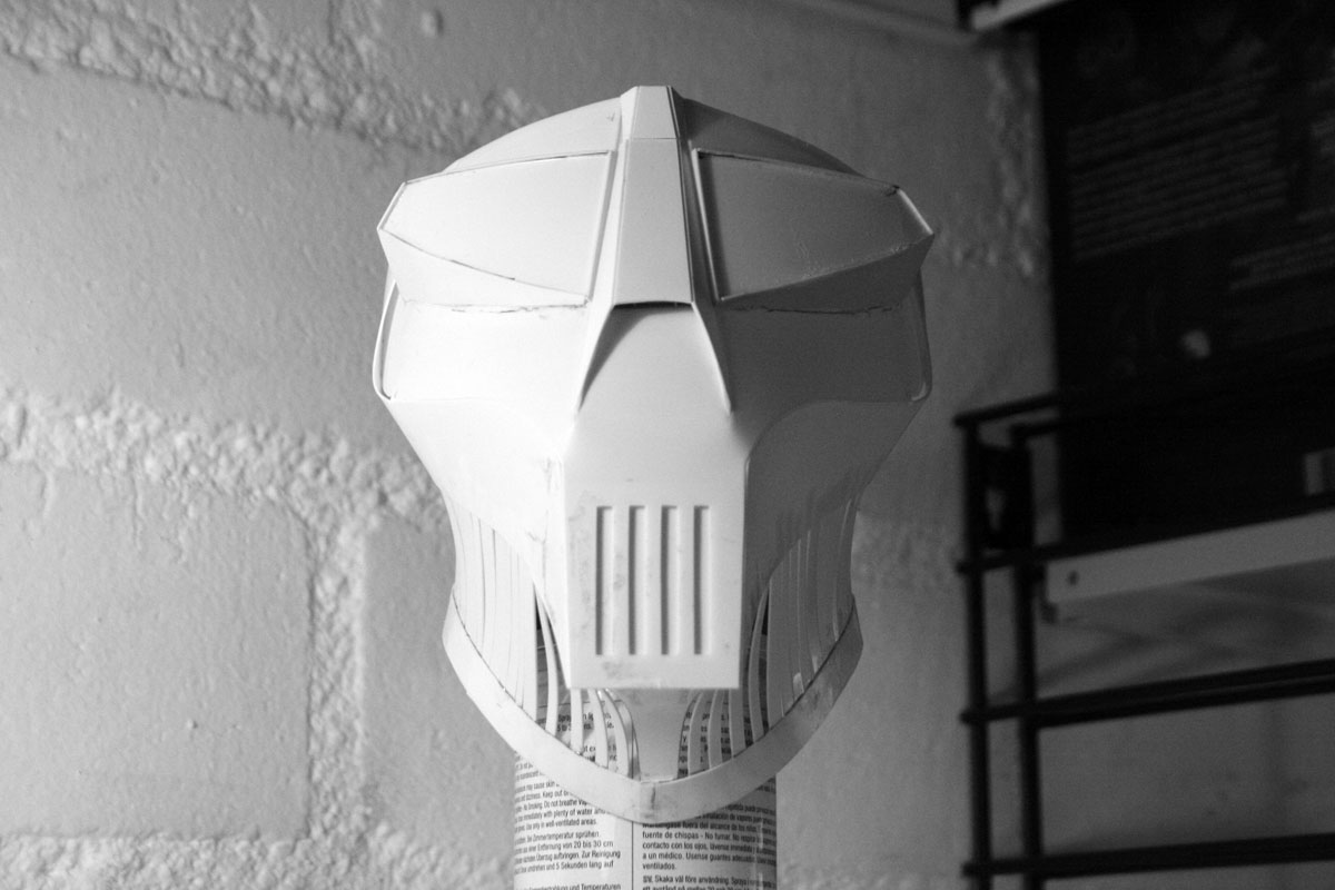

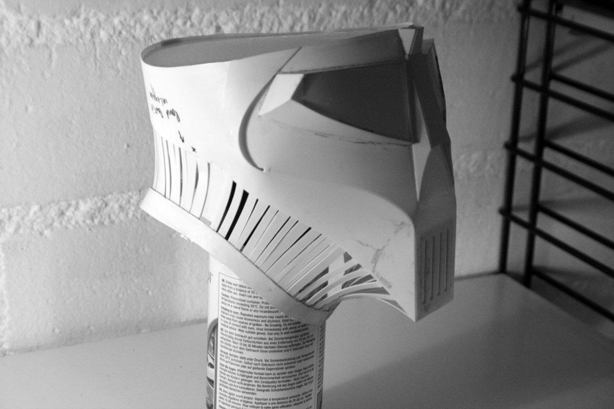

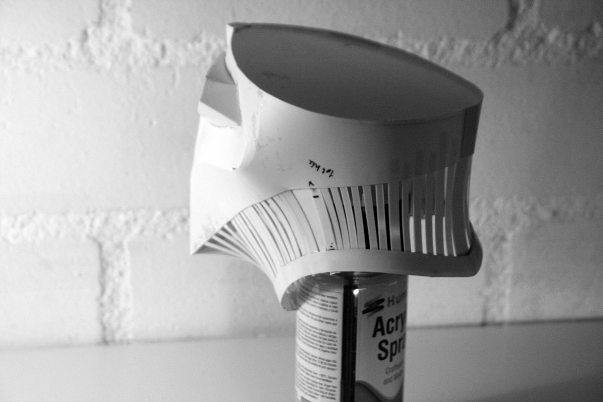

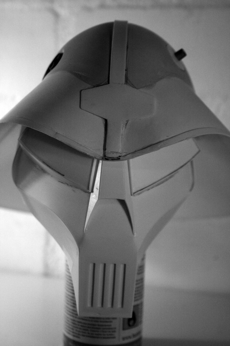

Nuts, a little set back. the styrene I used was too thick and folding lines started to tear open by the tension. Now I got a plate half that thickness and hope it will go better/smoother.

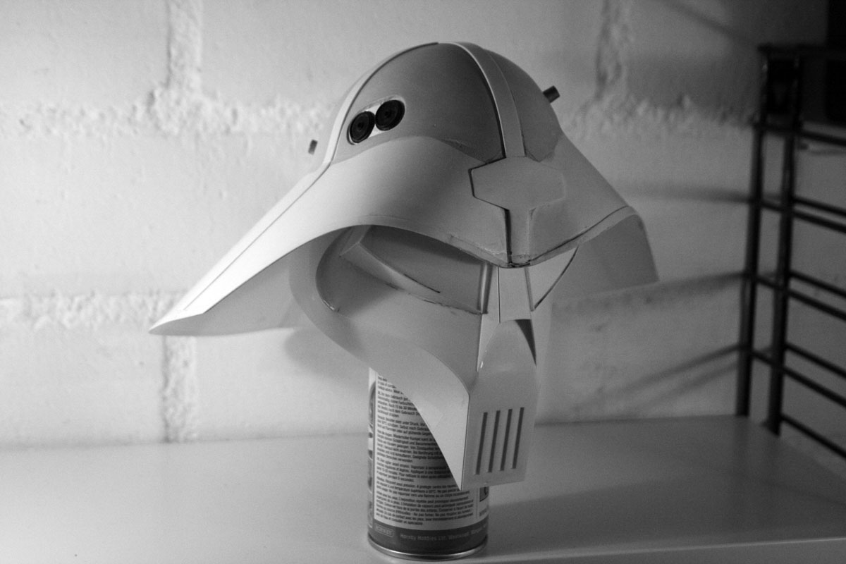

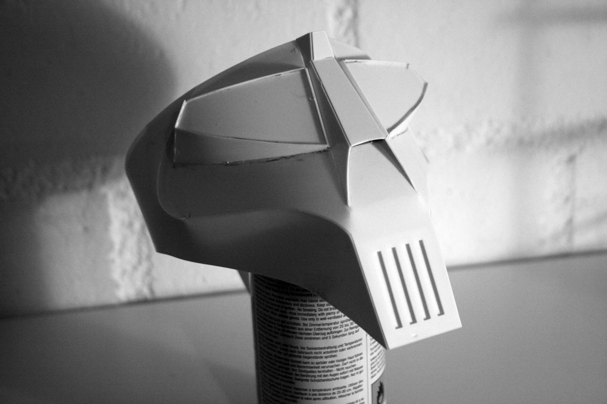

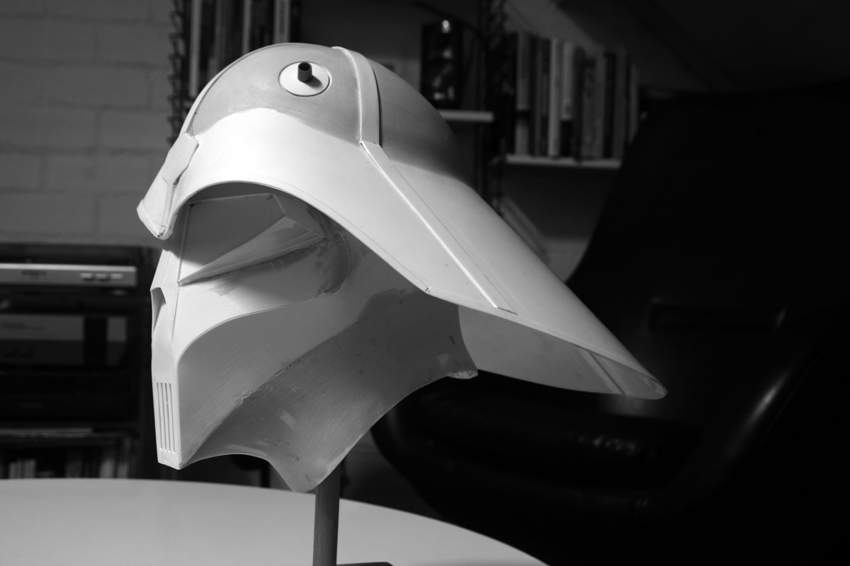

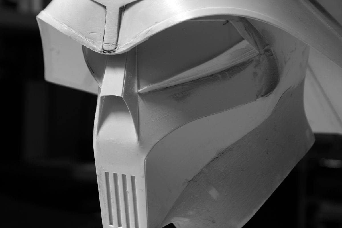

Sanded the first layer of filler on the neck part of the mask, still needs some sanding and extra filling here and there. I think I will also make the round collar/shoulder piece, that would give the model a finished look.
amazing build! I'm loving that these concept sketches are starting to surface and that people are taking an interest in them. You sir, are doing a fantastic job. I just have one question....what are you using to glue the polystyrene? I'm having trouble finding glue strong enough.

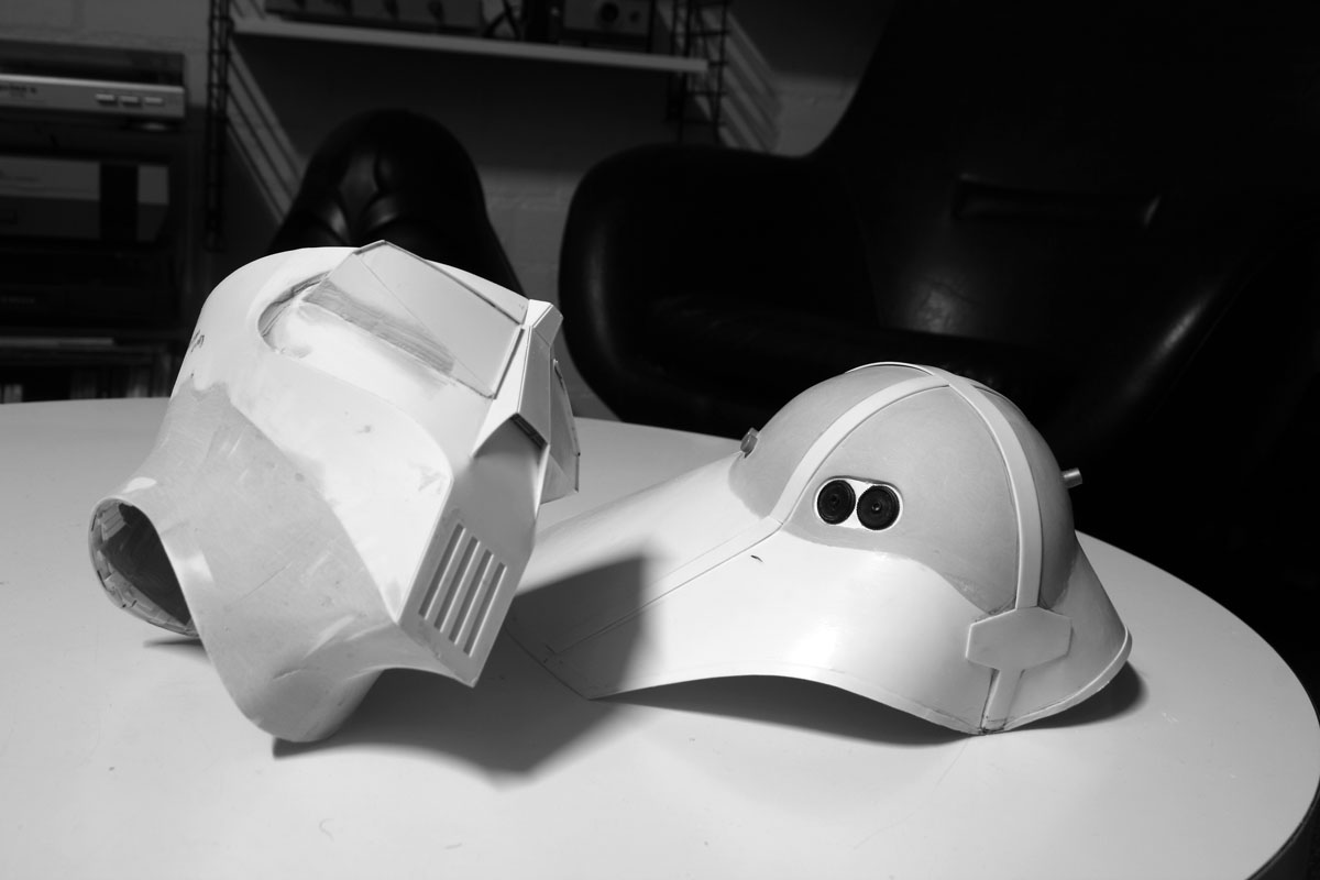

not sure yet if I make the entire costume, for now I plan to make the shoulder piece.
- - - Updated - - -
I use both Ghost, the one with the needle is good for small and detailed pieces and the one with the brush good for large surfaces.
