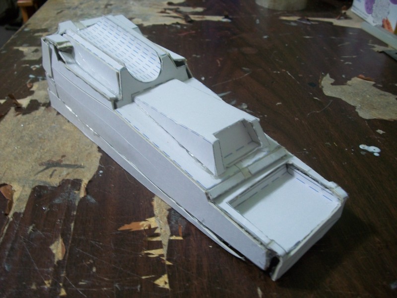

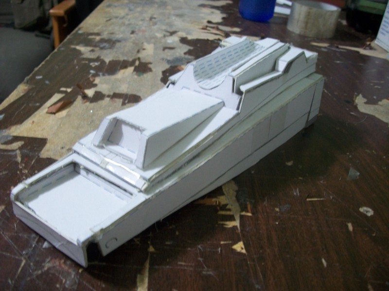

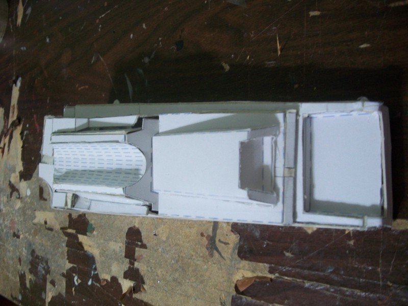

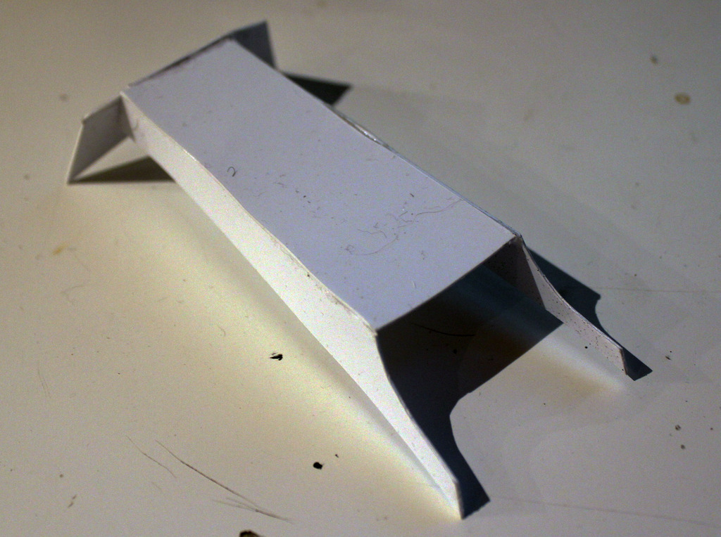

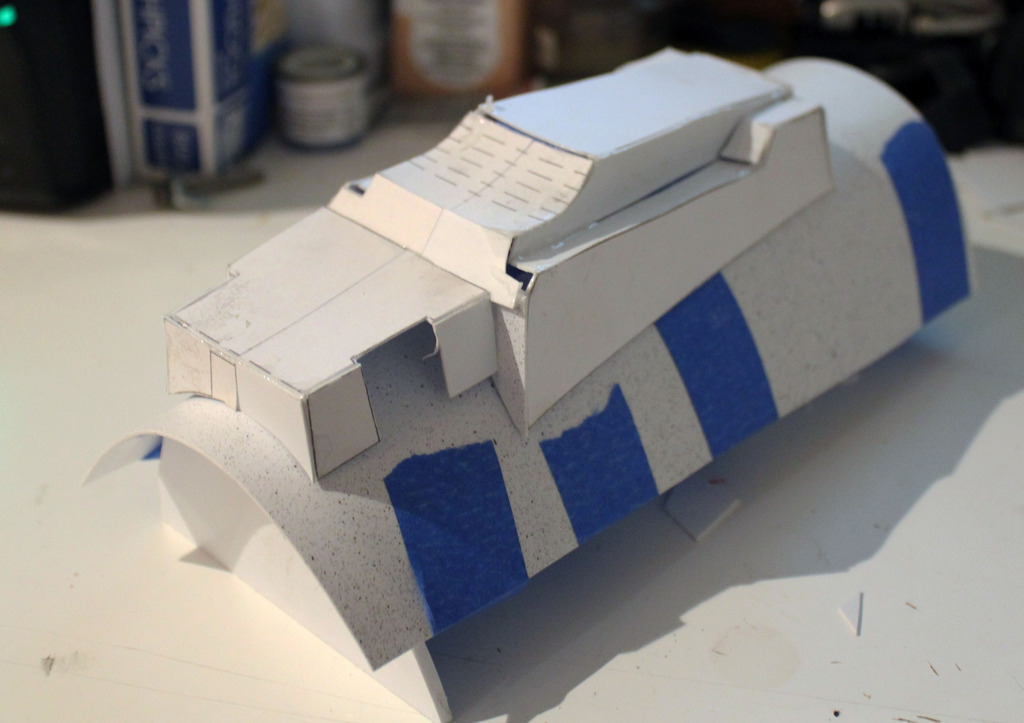

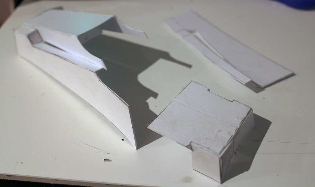

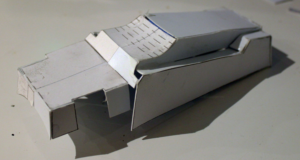

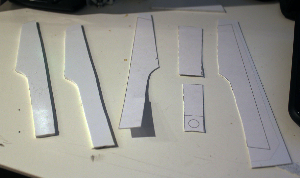

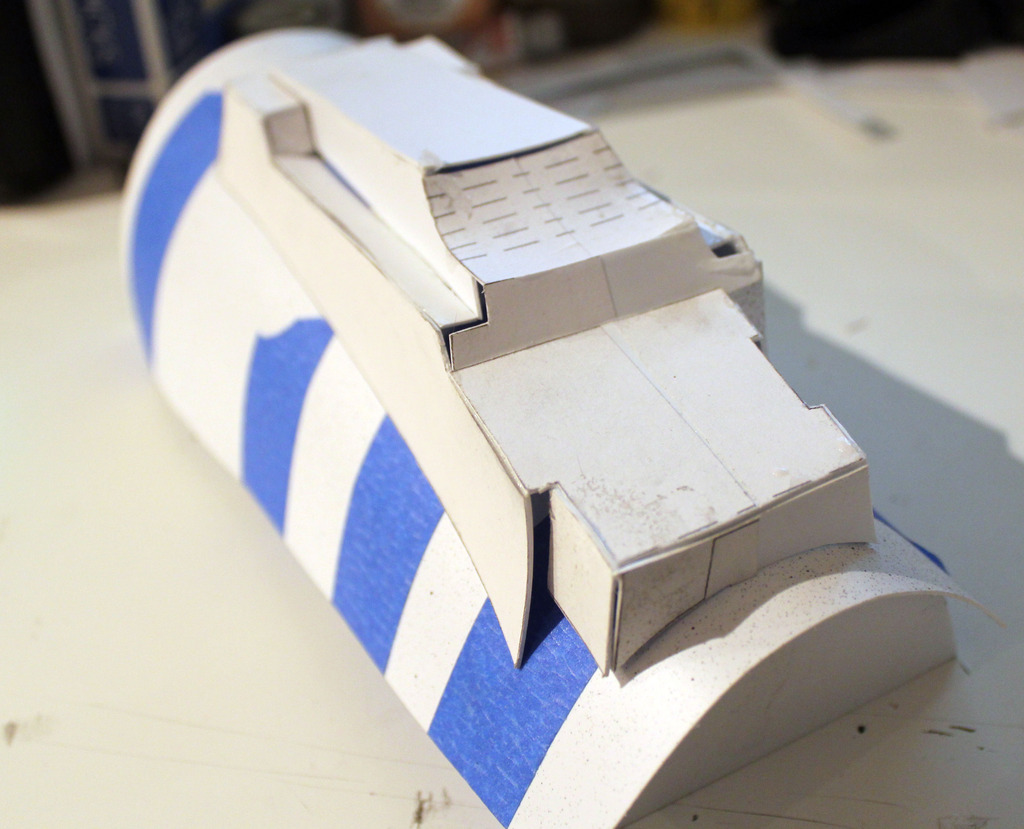

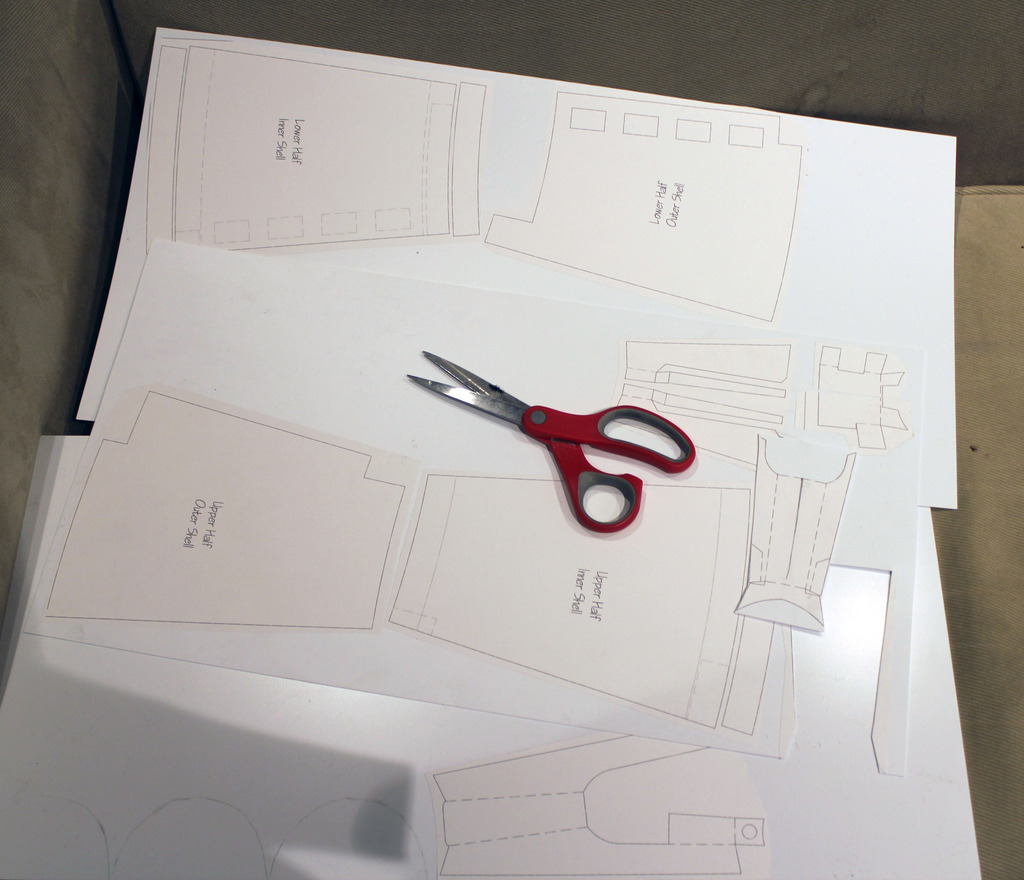

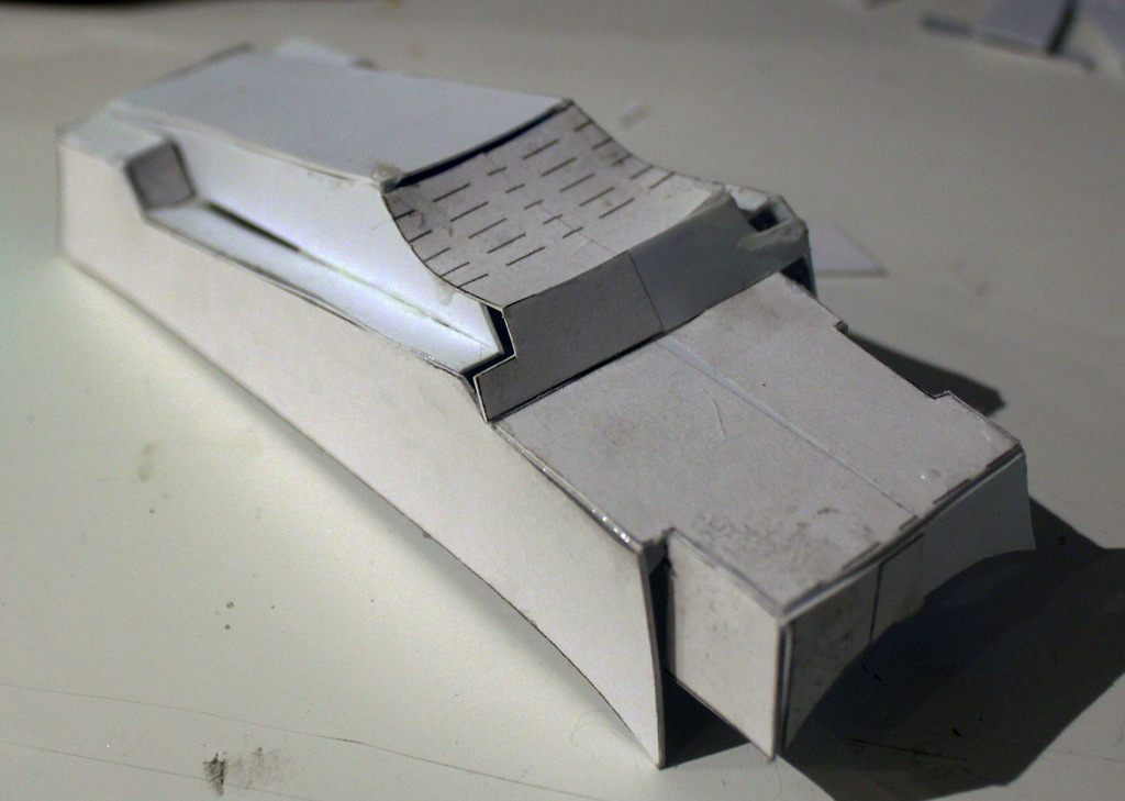

While i cant really work on commissions during the week, i CAN cut up cardboard while watching TV. :) I printed out the WOF templates and modded them as i went along, to get the 10" length down to 9.5". I couldnt print them smaller as they would have become more narrow and the keypad wouldnt fit. So with a little hacking i think i have a good base. Like when i did my Fett helmet, i will work over this with bondo to get the correct shapes. It looks rough, and possibly a little off...but i think it will work well for what i need. All i needed was a good starting point :) Once i get it as close as i can to the screen used gauntlet, i will take an inexpensive mold off of them, and further refine it. Then i will make a final mold. .....and yes i do plan to offer these once they are done :)

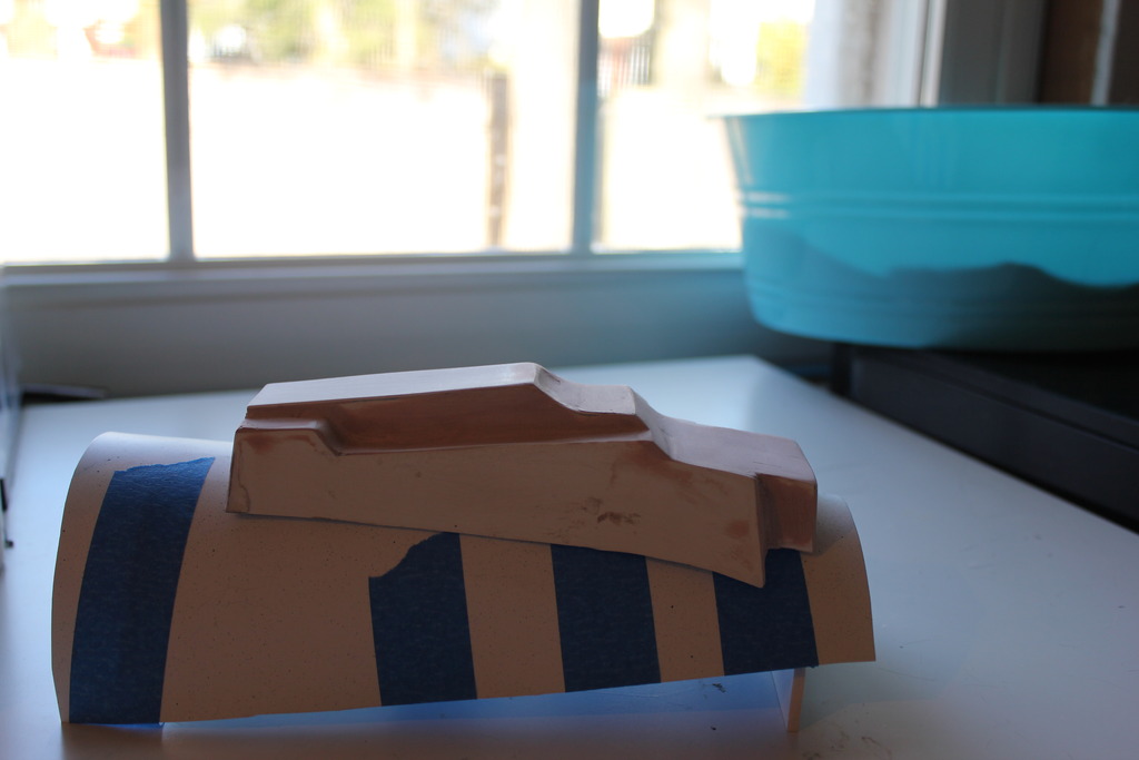

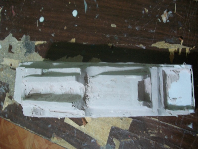

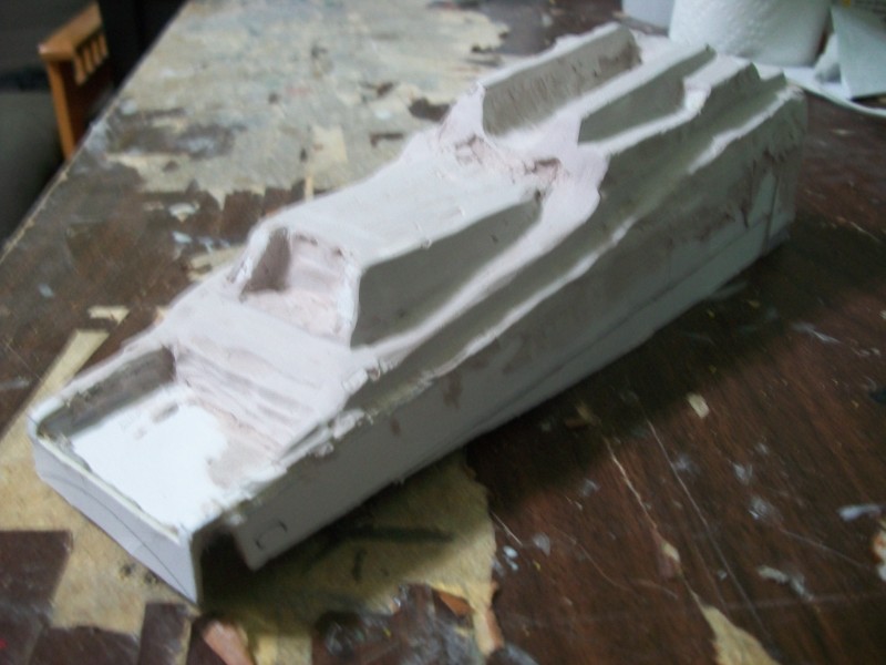

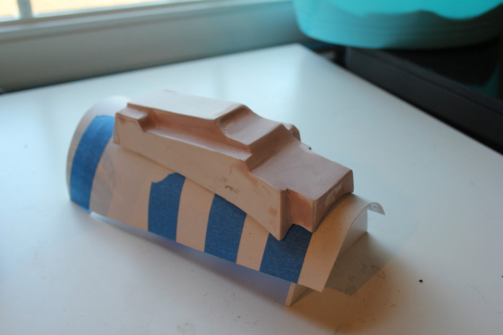

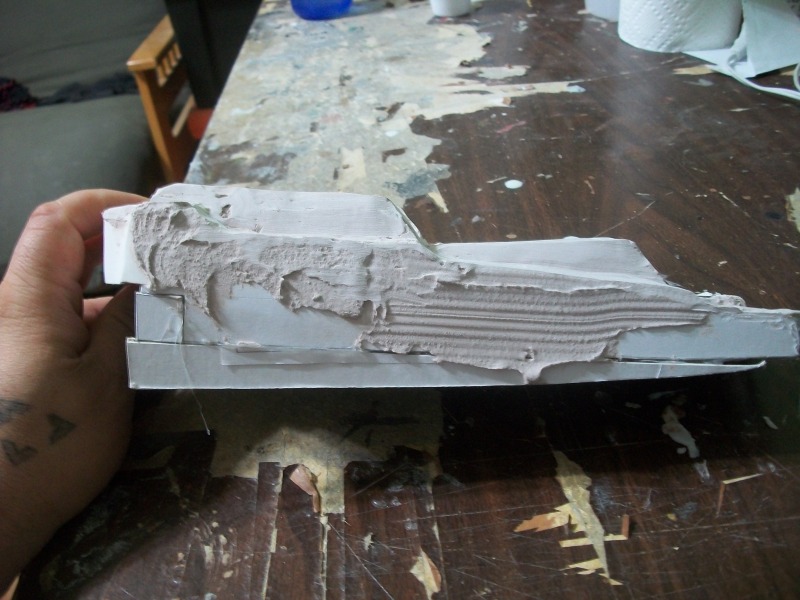

Got more of this bad boy done yesterday after work. Just layed down 2 layers of bondo and sanded with the sanding barrel on the dremel. Its really starting to take shape now. Obviously still needs work..but ill probably get this part done over the weekend, in between commission work :)

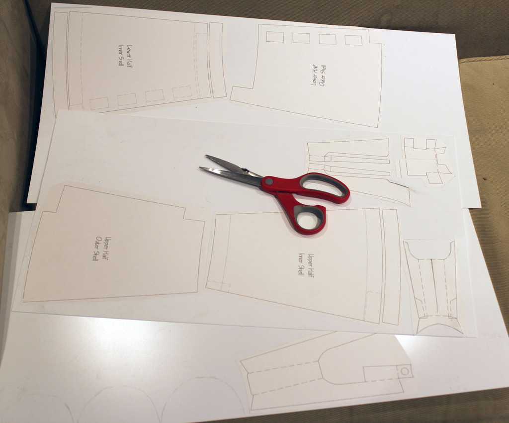

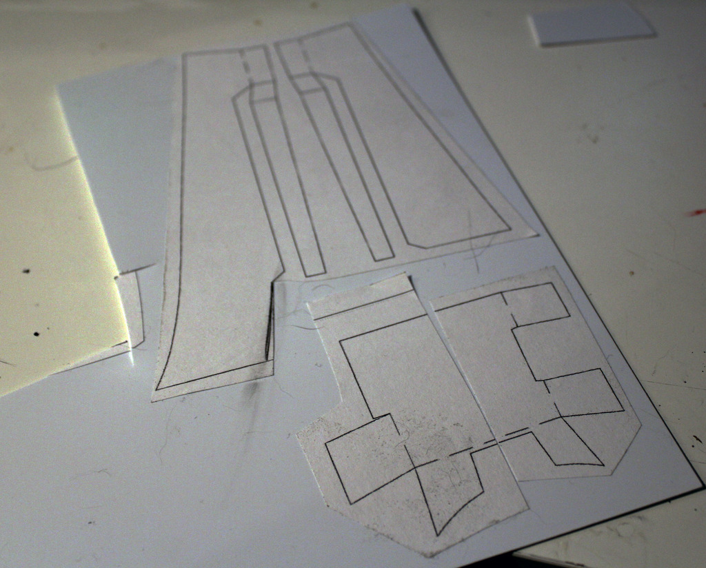

So i decided to start with the right one this time....i glued the templates to some .030 styrene.

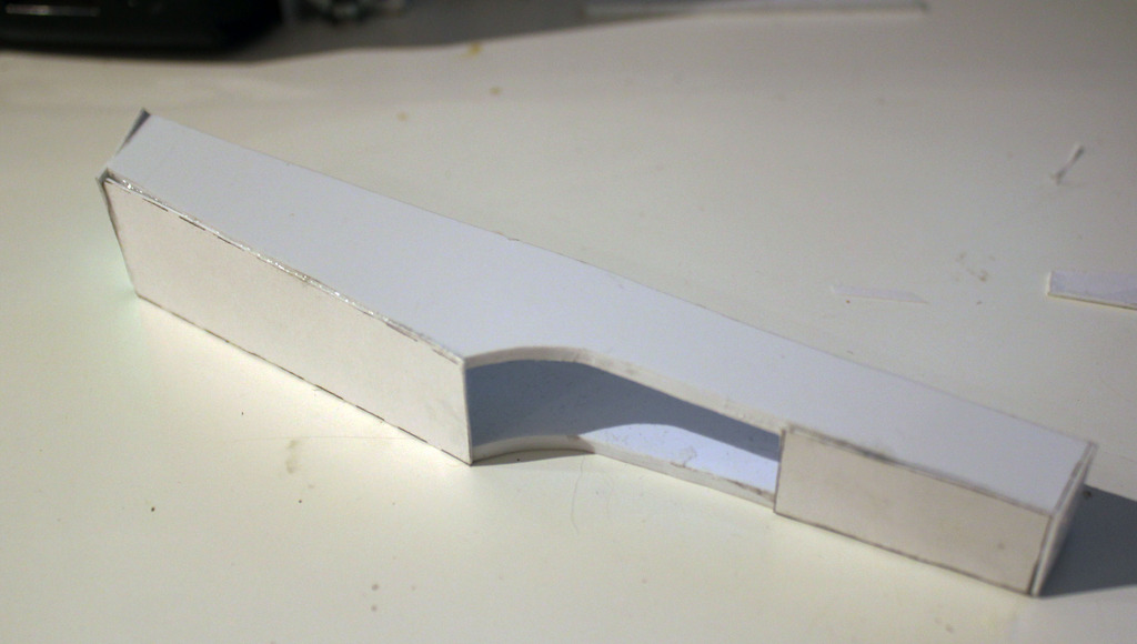

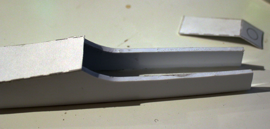

I assembled the whipcord housing. I did this by making the top and bottom from 1/8" thick styrene, and the rest was .030 styrene. I overcut one side, but it wont matter as i will fix it with bondo before i make the mold for it :)

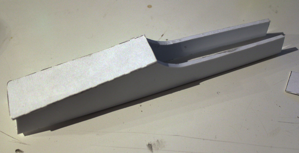

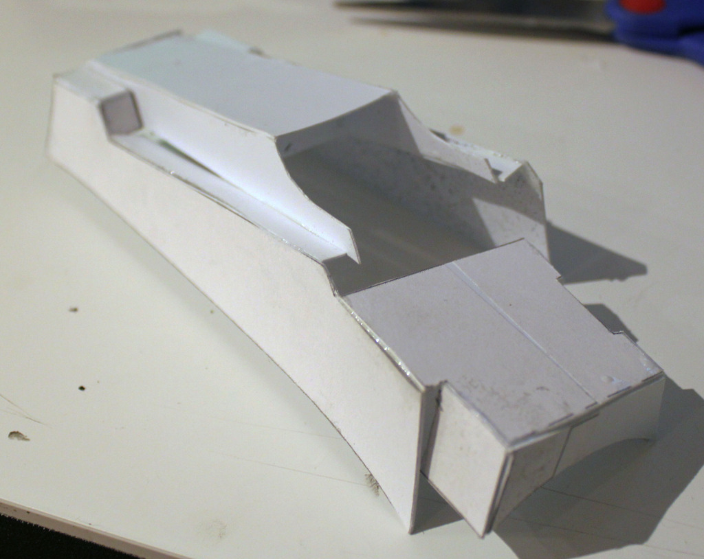

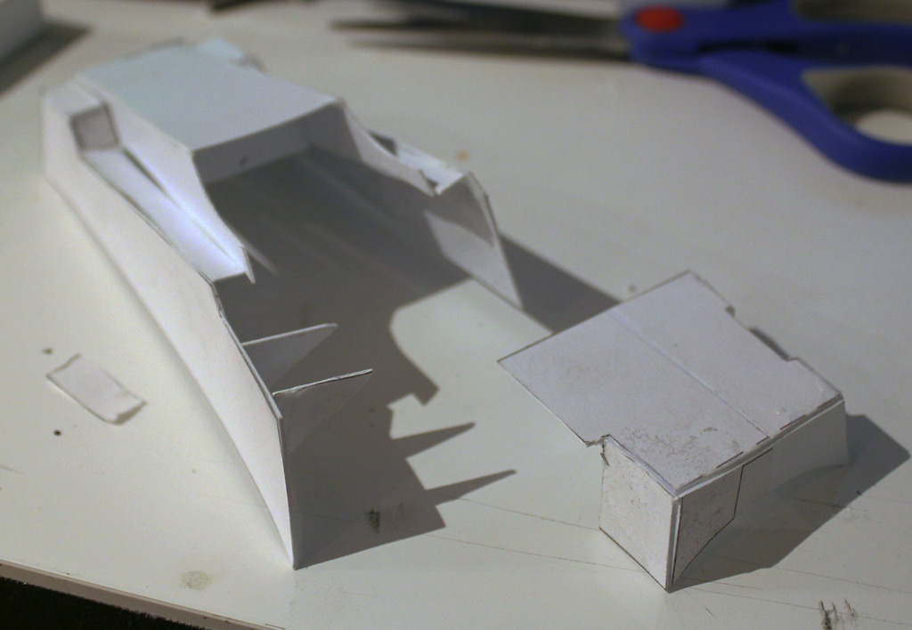

I then moved onto the top portion of the Right gauntlet. Keep in mind, i am building this to take molds from so im not concerned with if this exact piece is wearable. Also working with the thin styrene i ran into a few small issues, so this may look a bit half-fast, but i will be fine tuning with a little bondo and i think it will work out fine :)

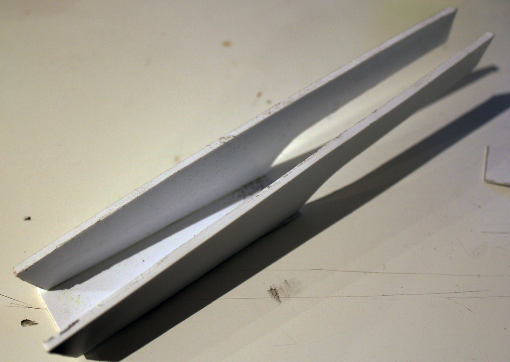

First i did the upper most part, pretty straight forward..

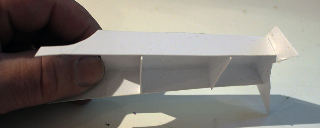

i added supports into it to keep it sturdy
I then moved on to the flanking parts and the foward "box"
I then added the "swoop" on the uppermost part, which in hidsight i should have done earlier lol

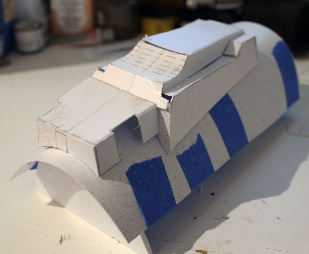

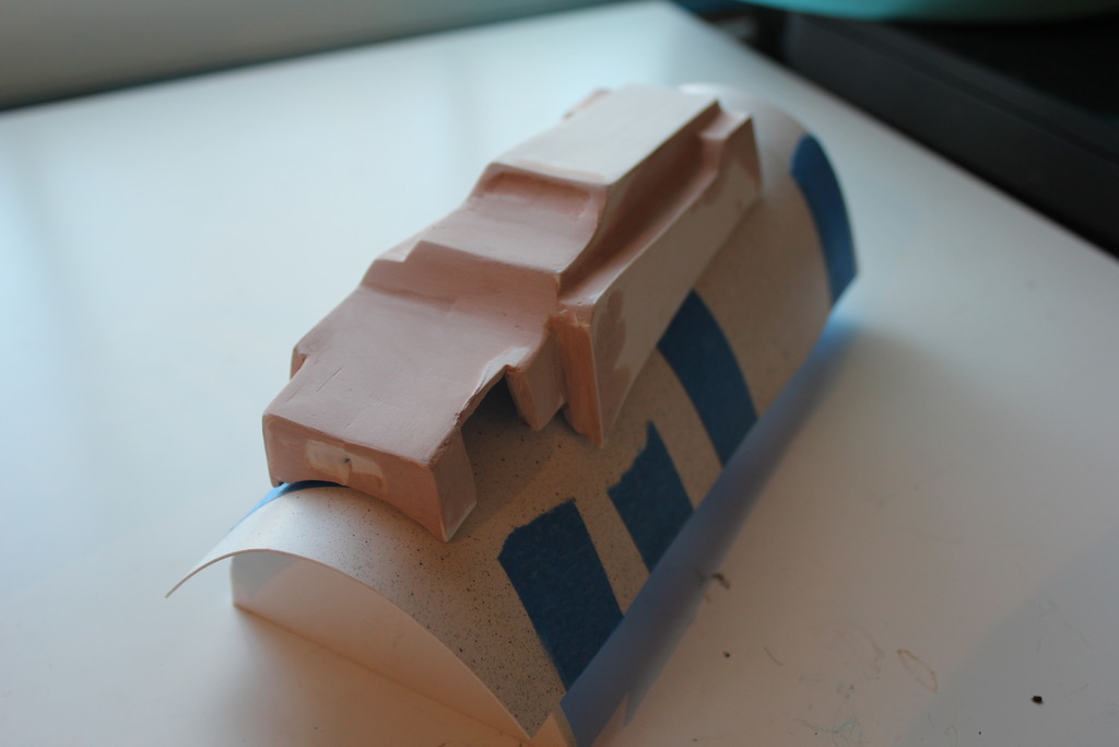

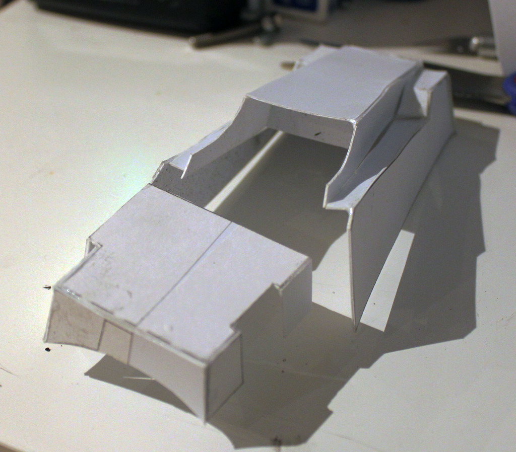

So here is where im at. I put this on a temp base as im going to make one from insulation foam (that pink stuff that comes in sheets)

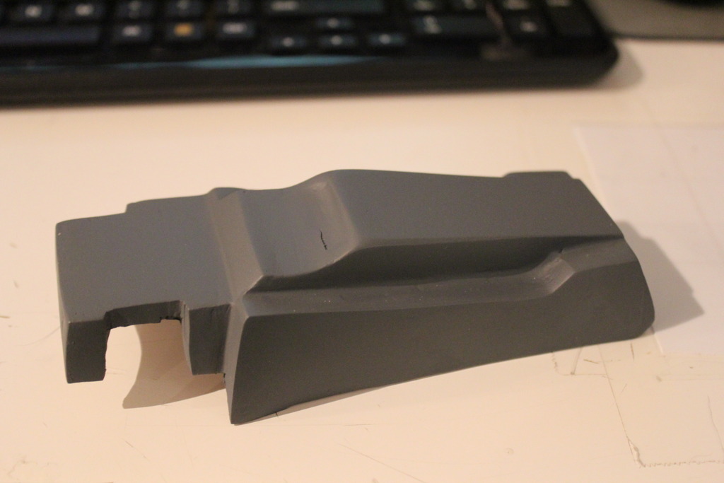

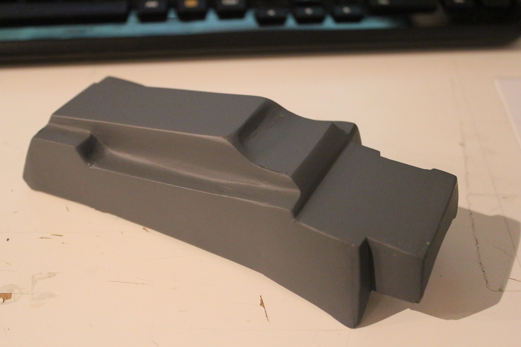

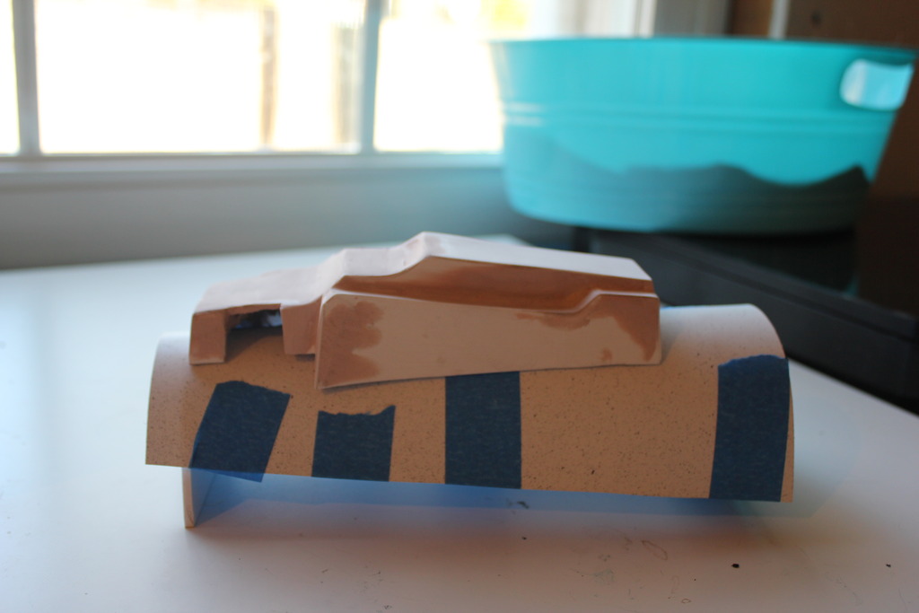

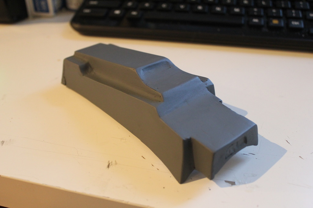

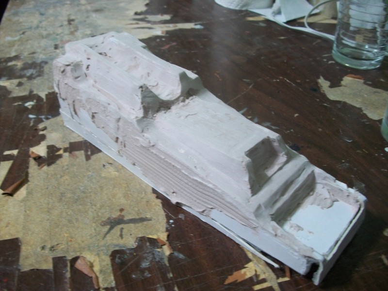

Ok so i did a little bondo work on this and got it to this point.

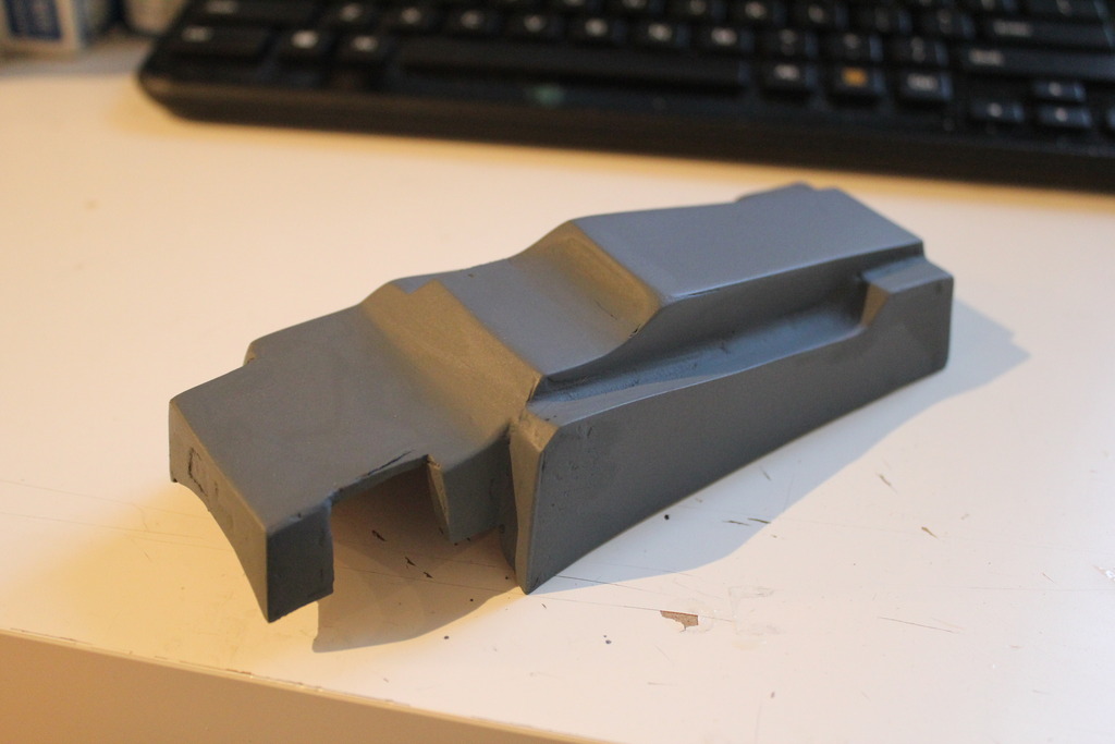

And here it is with primer on it. The primer really helps point out the fine details that need cleaning up :)
There are a couple of things i need to fix but for the most part this section is complete :)
Ok..so i lied lol. Looking at the cervantes gauntlets that im using for reference and measurements, i needed to make a few adjustments. I actually had to chop this down a little bit in 2 places. right behind where you put the darts and thge middle of the forward most section. In total i took about 1/4" off.
Now my measurements and dimensions match the cervantes gauntlet very closely.
