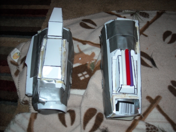

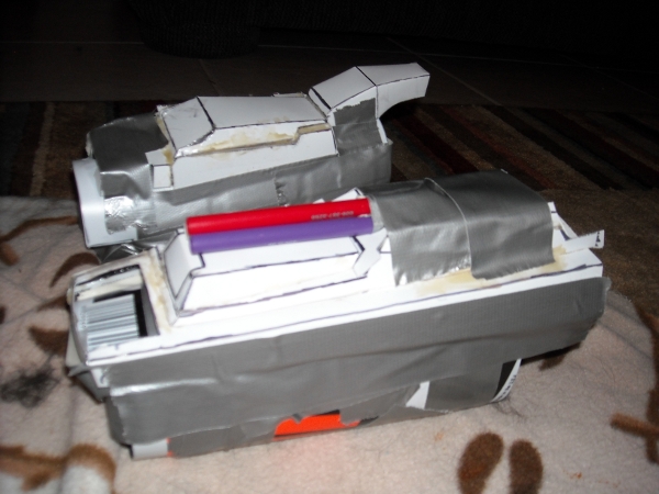

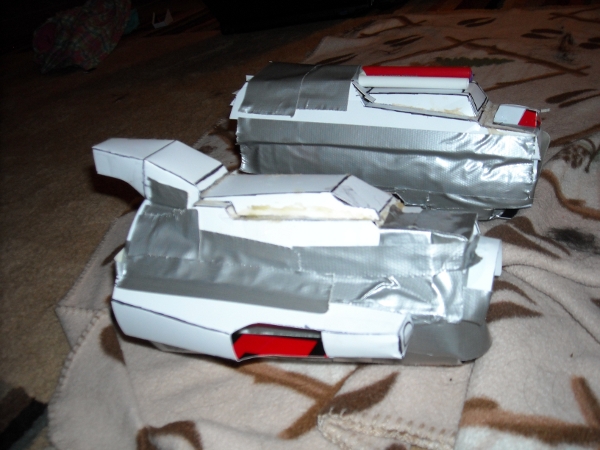

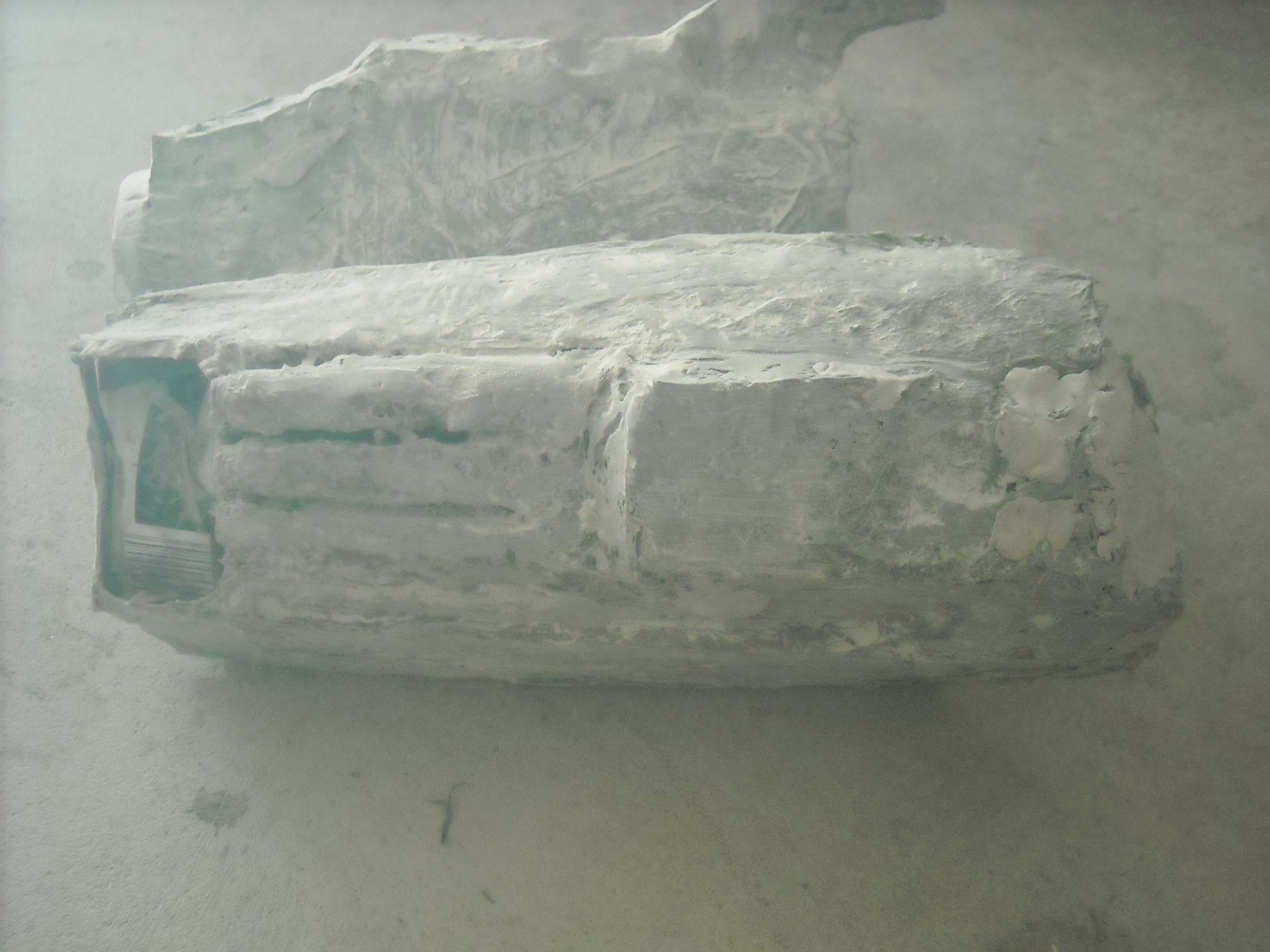

I have gaunts! well... sort of... they're still awaiting some bondo-glass application and paint, but they're assembled, preped and ready to glass! Here are some progress pics, and yes they're being held together with duct tape... goofy I know, but it's the only way I could get the shell to hold it's shape, and It's actually a lot easier to position the other chunks that way. They're not the best, but they'll work for now. Still not sure if this is how my tri-shot will be situated in the long run.
Kal
Okay... yet another update! two in the same day I'm on a roll... I have encased my gaunts in bondo-glass... which once it cures will leave me with a pair of fiberglass gaunts, that will only need a lil TLC with a dremel and paint... then they'll be done. I did change the config of the tri-shot. It's now lower on the body of the gaunt, I relocated another portion of the original frame to above the tri-shot and enlarged the barrels by wrapping duct tape around the cylinders of the ink pen bodies that i used. I'll also be resketching my armor to include some concepts regarding the addition of a piece to the helmet inspired by Mereel.
Kal
Thanks! He he me too...lol seriously I cut all the pieces from some for sale signs I got at the BX for 50 cents... Used loctite and bondo gel to fit the pieces to the shells, and then reinforced everything with duct tape prior to glassing. As for shaping the shells, that took forever to figure out, but I connected the top and botom halves with a slight bend, then headed them so they'd bend easier. After that, I squeezed the shells until they were in the shape I needed, then... I put duct tape across the ends to hold the shape, then I photo'd them and glassed 'em. Still have to dremel the excess glass off and fix the detail back to how it should be, then I'll post more pics. I did find a much better way to do the barrels than what is shown.

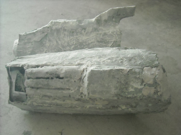

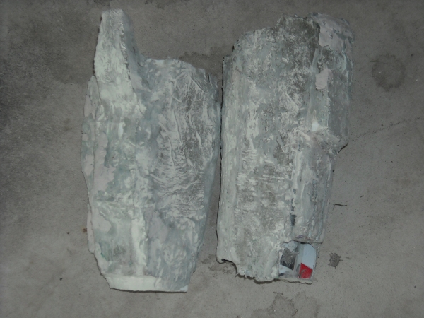

Okay... gaunts are glassed and sanded! They look fairly decent... BUT, I accidently dremeled a lil too far into the gaunts and knocked a few small holes in 'em. I have some quick hardening epoxy putty I am thinking about using to fix these holes. Any tips? I also have another dilemma... when I finished sanding, I found that there are lots of small fissures and pits in the fiberglass that cannot be sanded out due to various issues with depth and such. Any tips on that? I'll get some pics up shortly... waiting on the camera to recharge. Once I've got these issues figured out, I can paint, attach hoses and I'll be good to go, minus the helmet, groin and soft parts.
Kal
80 grit sand paper ner vod. Just sand em down then pack more bondo on the low spots then repeat. :( Takes forever, BUT, it looks really nice in the end. :D

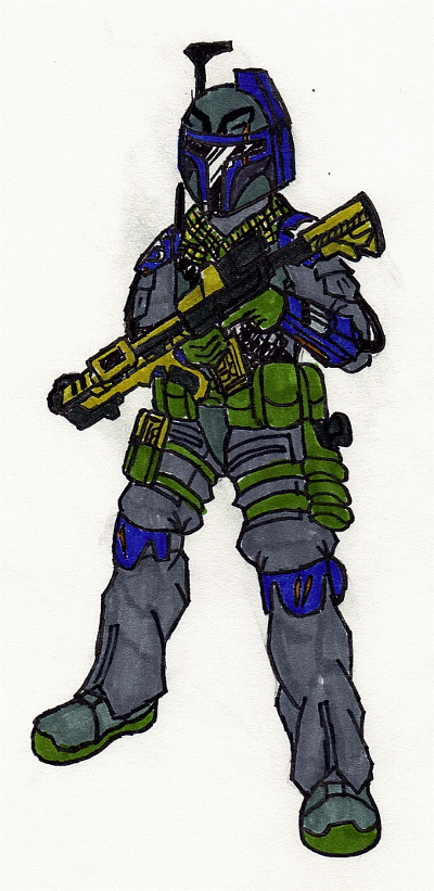

Thanks vode, here's the really sad part... I'm only halfway - 75% finished, but I am already thinking of upgrades I can do to my kit, ways to improve it. Here's another idea of mine, actually did the shemagh in the right colors this time too. This is however, not the official version at the moment.
