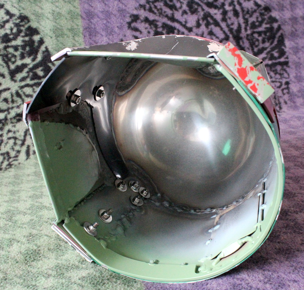

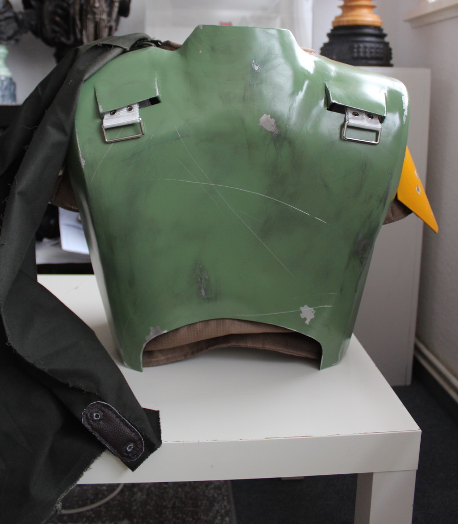

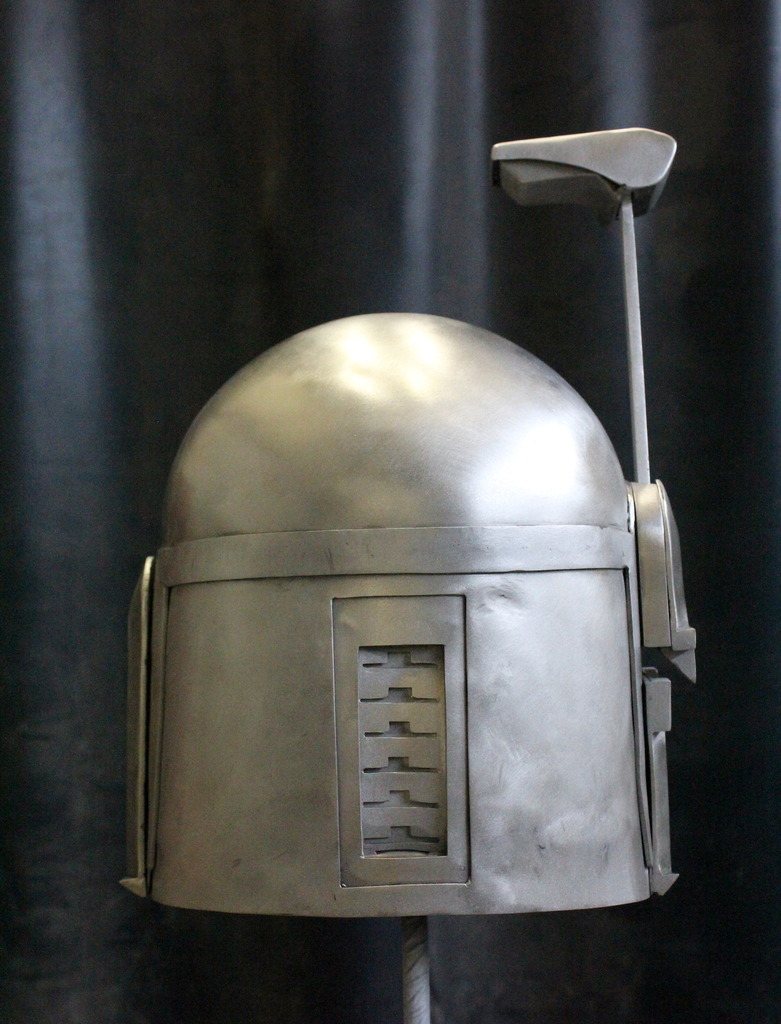

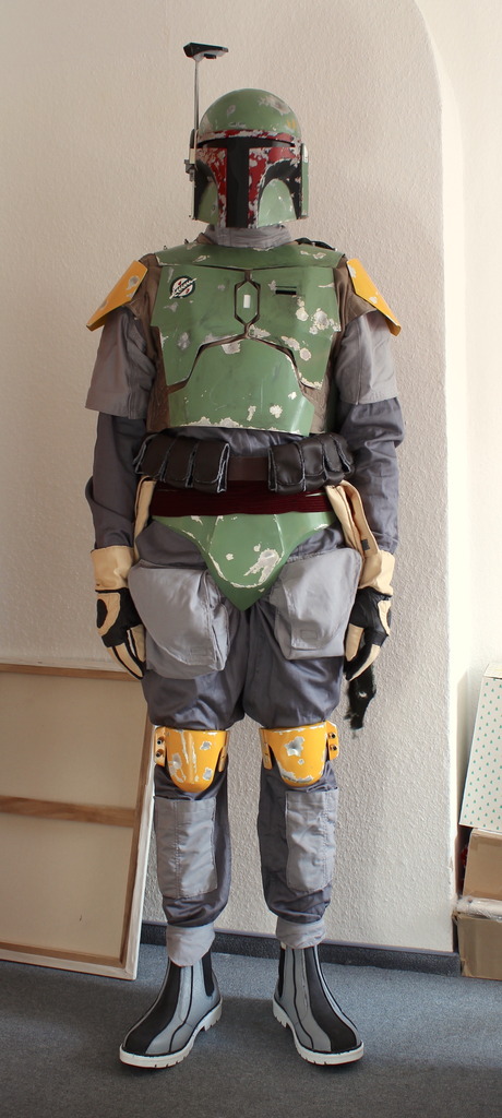

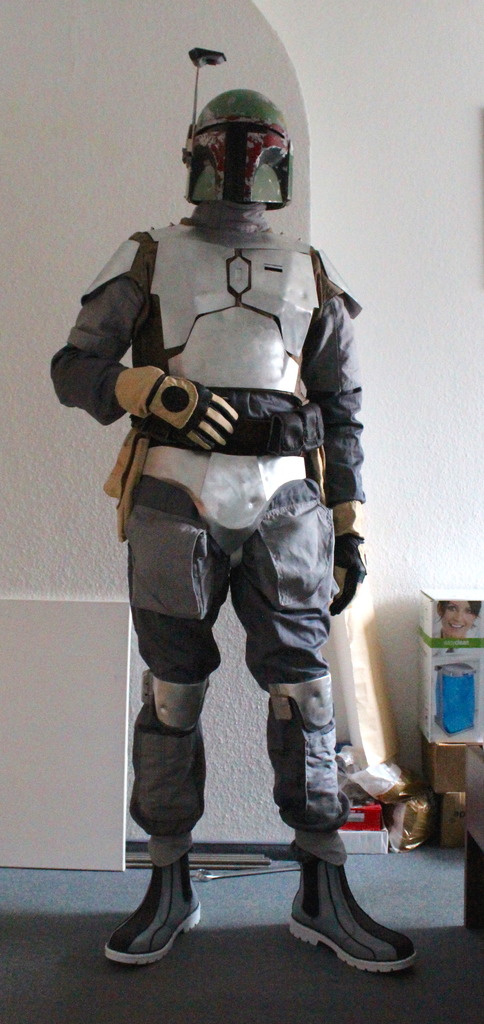

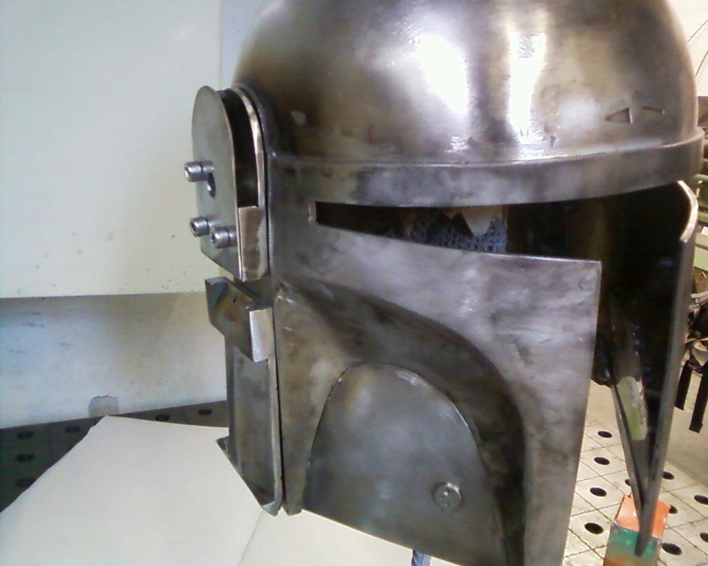

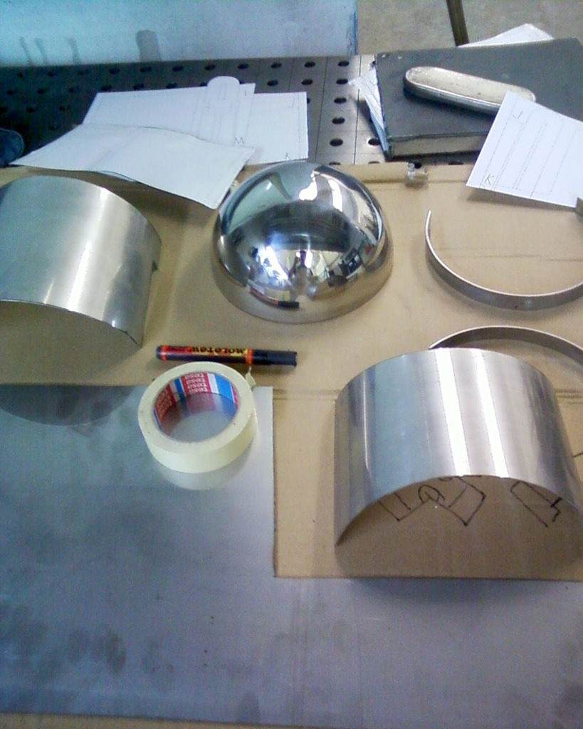

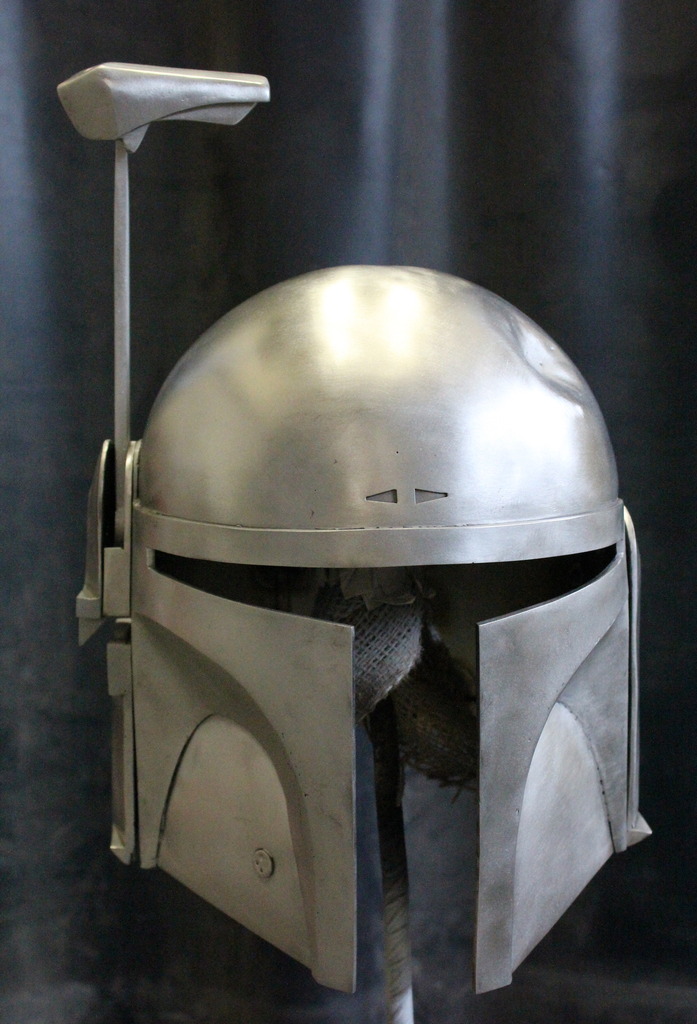

My attempt was not to make an 1:1 original Suit, but a (cheap?) mixed Suit that should look a little bit like the Pre-Pro suit with some details out of both of the movies. And I wanted it to look a little real life so I used stainless steel for the helmet and aluminum for the armor to give it a heavy look and make it feel like a real armor. so here are some pictures of the progress I made until now:

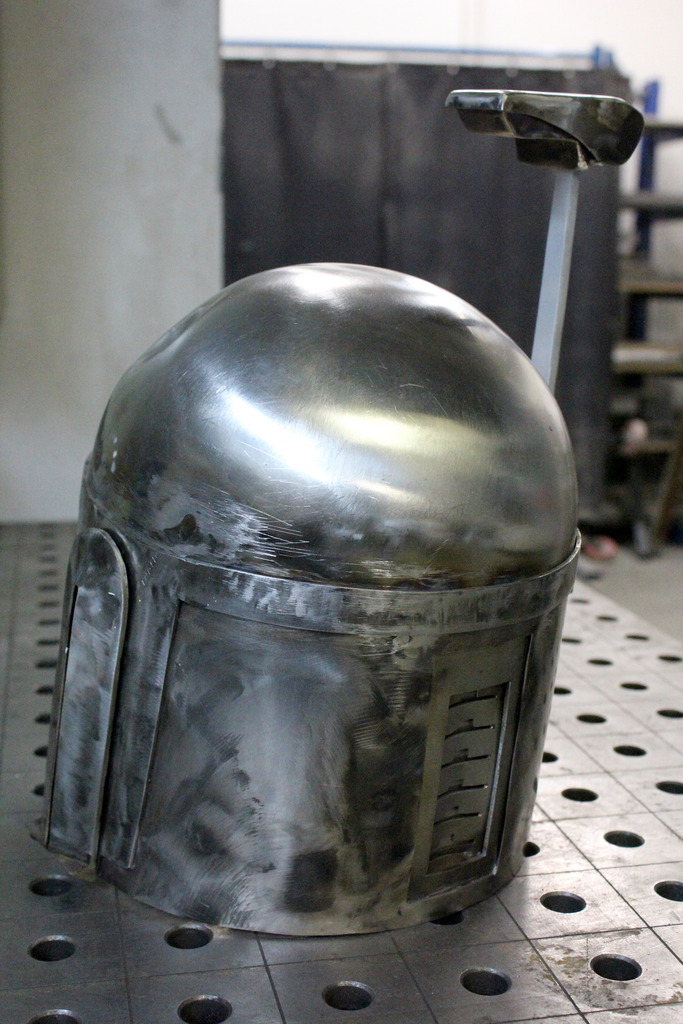

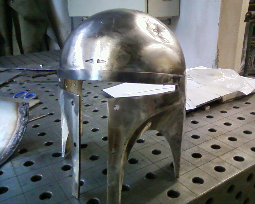

first I bought a bowl as base for the helmet...

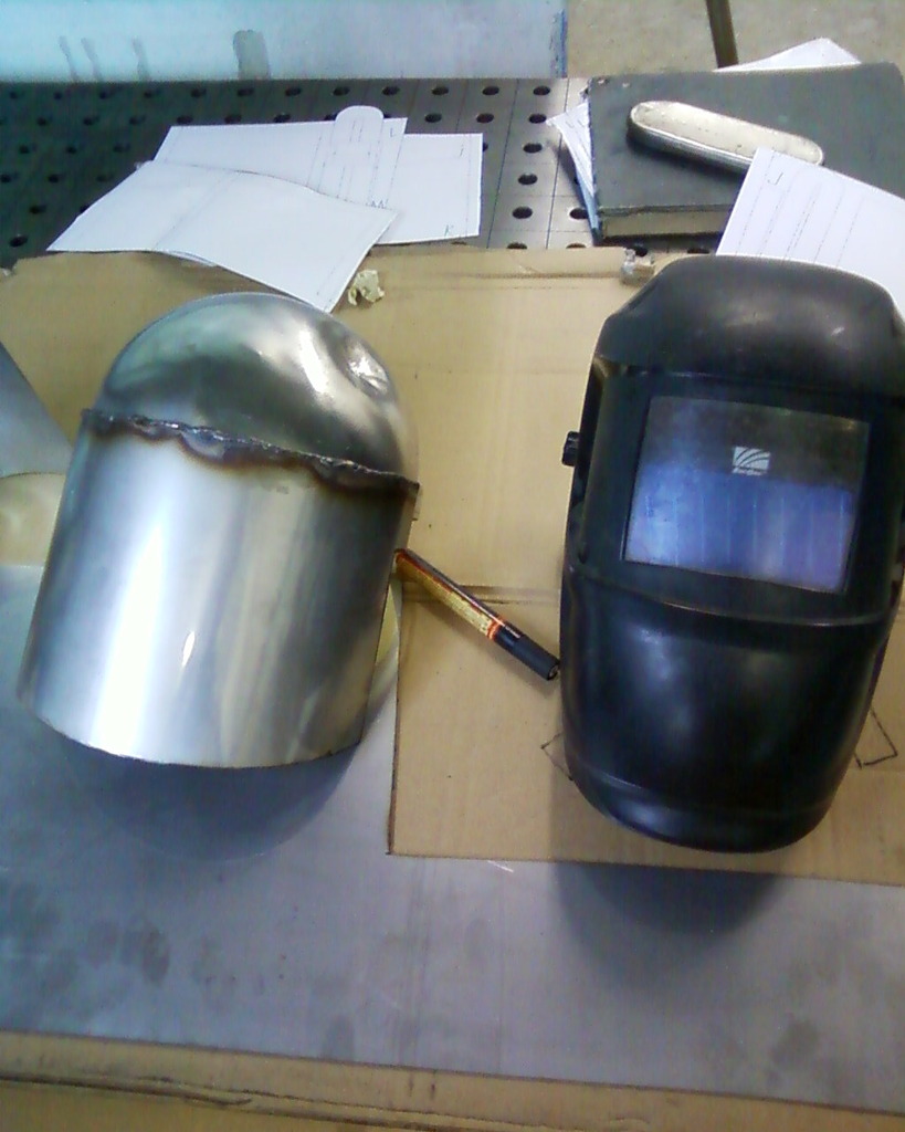

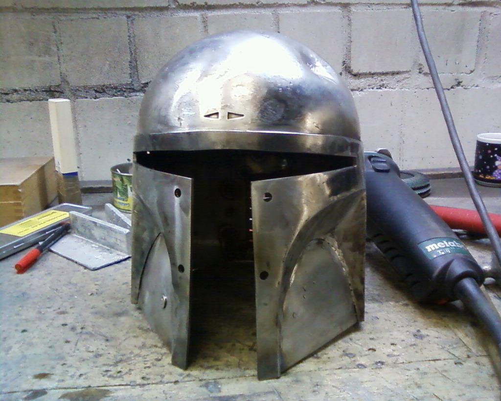

than I cut out all the parts of a sheet of steel and welded everything together

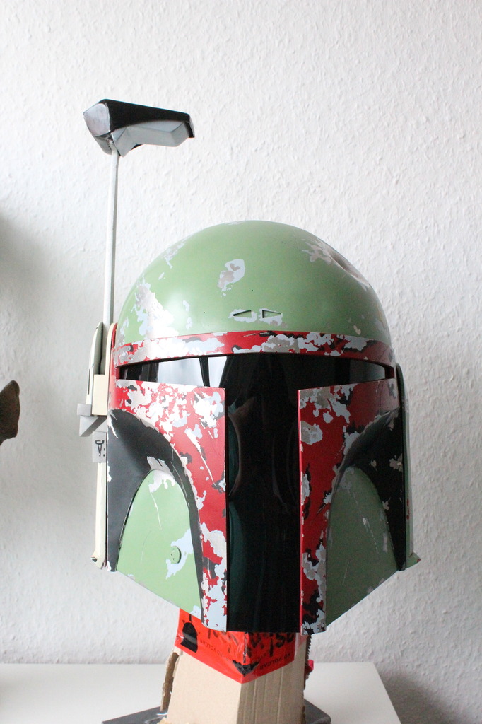

than painted and weathered...
and with a padding added

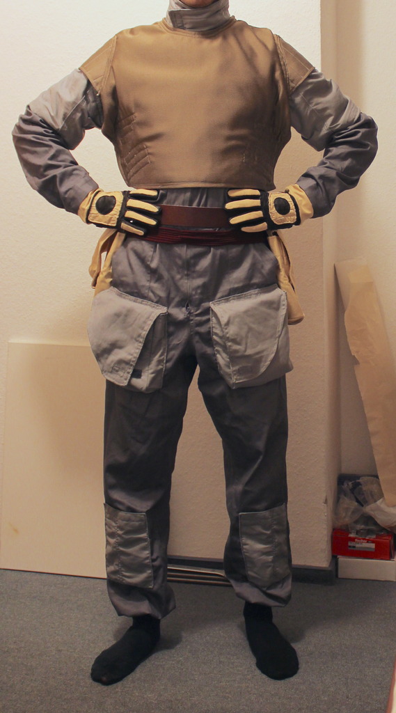

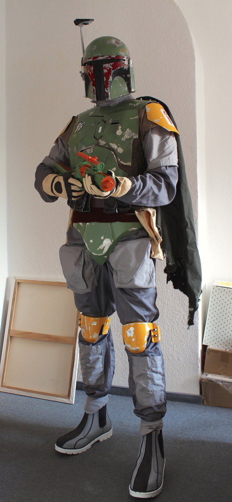

than I started the costume with buying an overall and attaching the short sleeves and the pockets

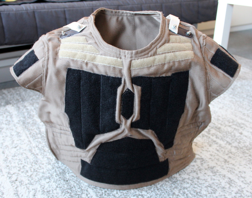

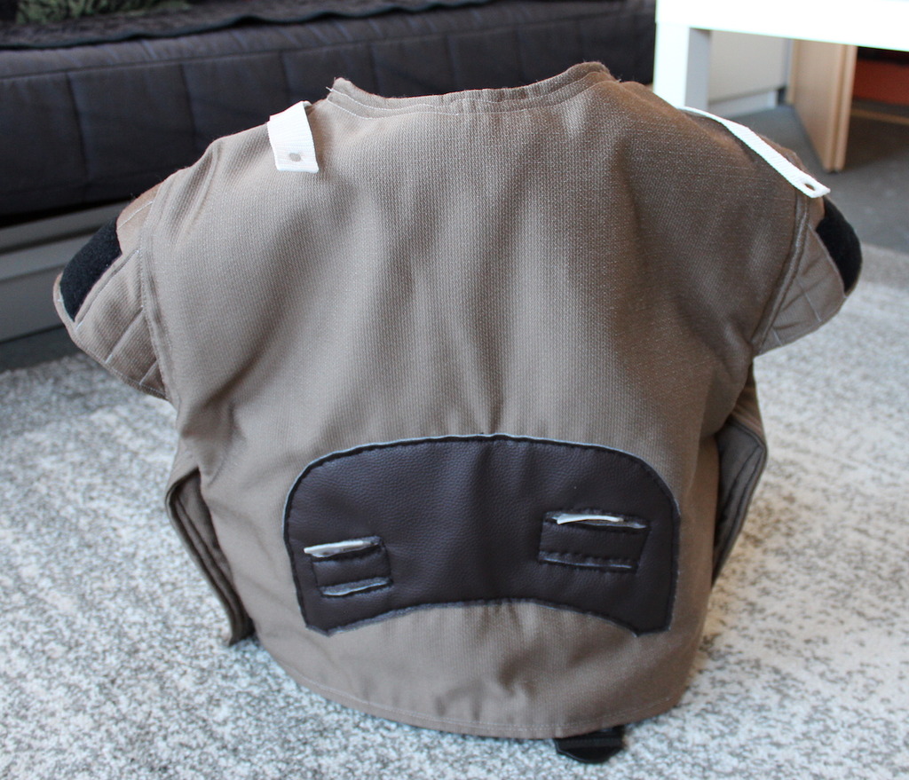

the flackvest and the other softparts were sewn by myself, cloves are modified brown leather gloves and the belt is just a brown belt...

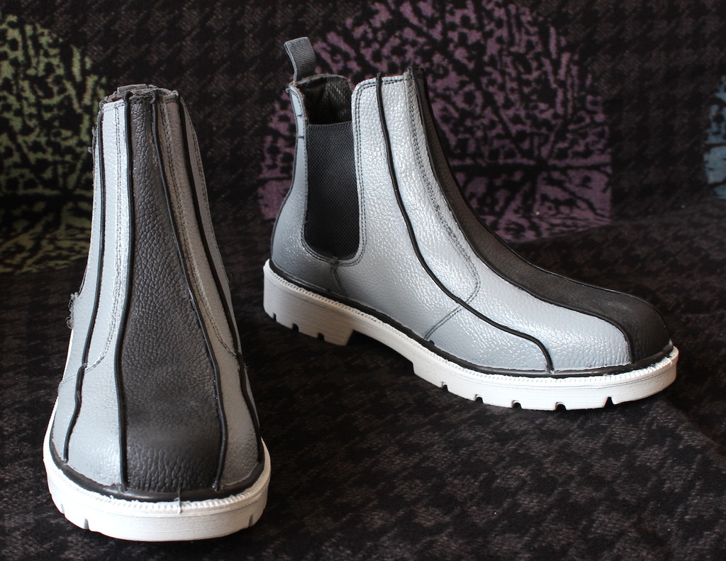

modified shoes:

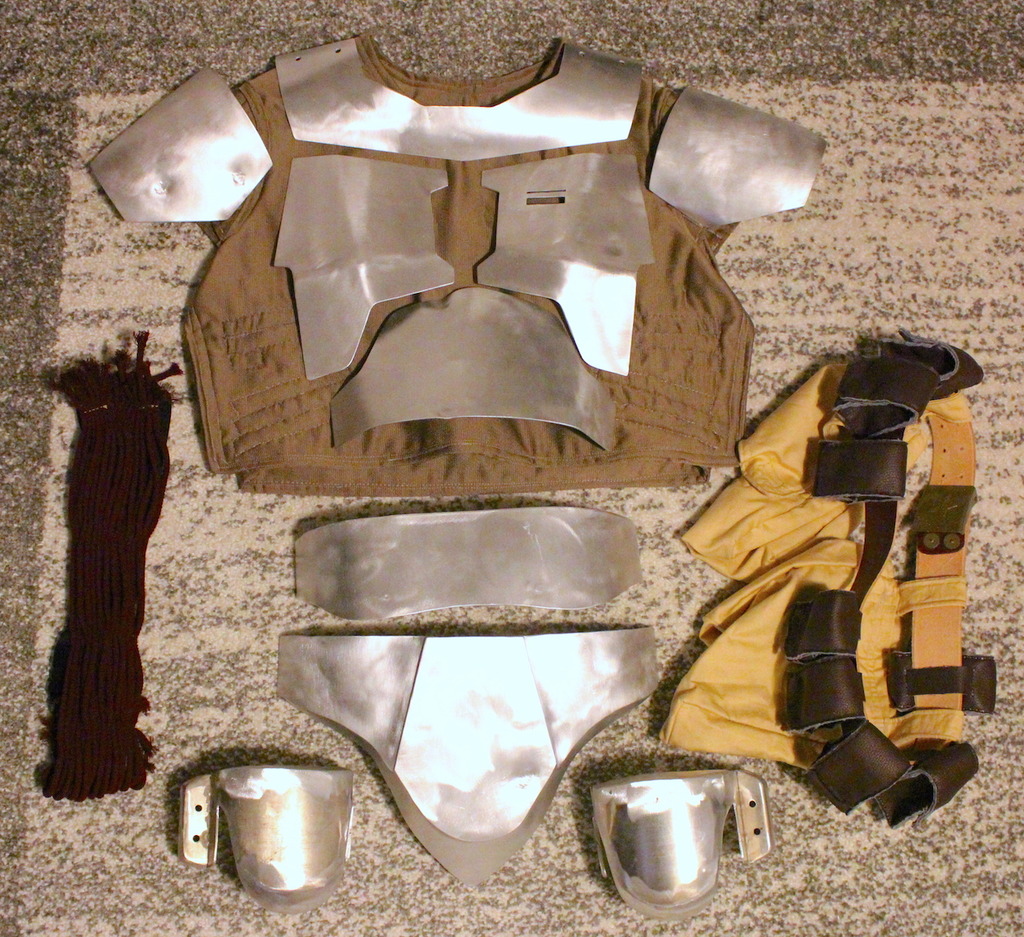

and the welded aluminum parts:
I attached them with some velcro

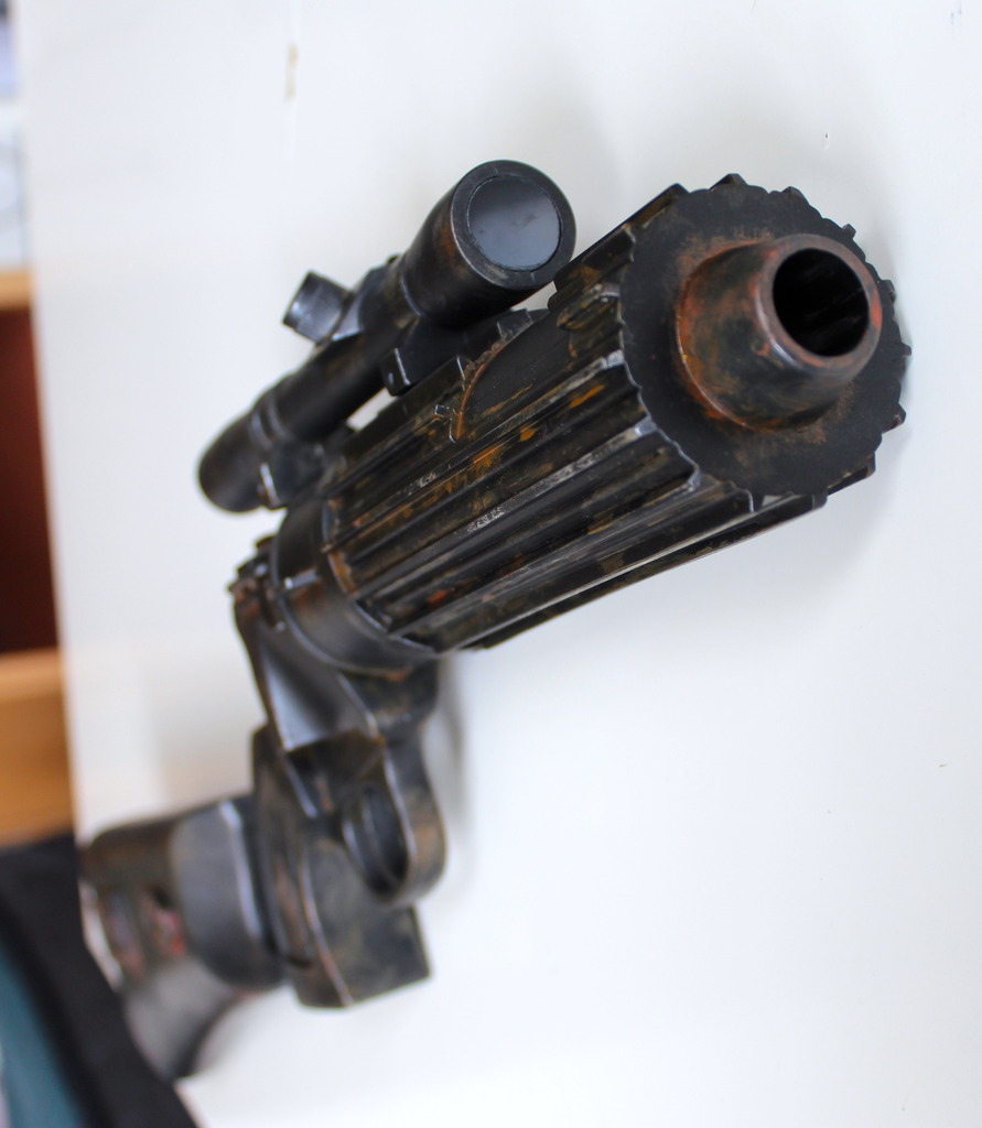

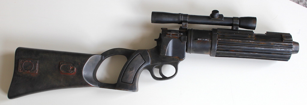

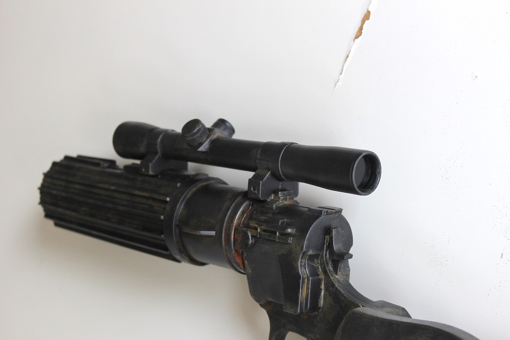

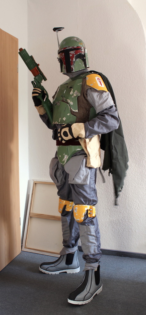

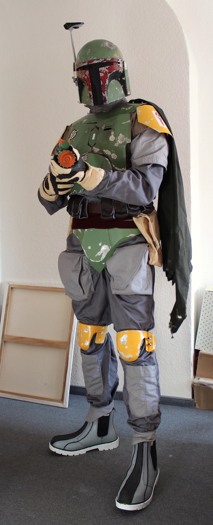

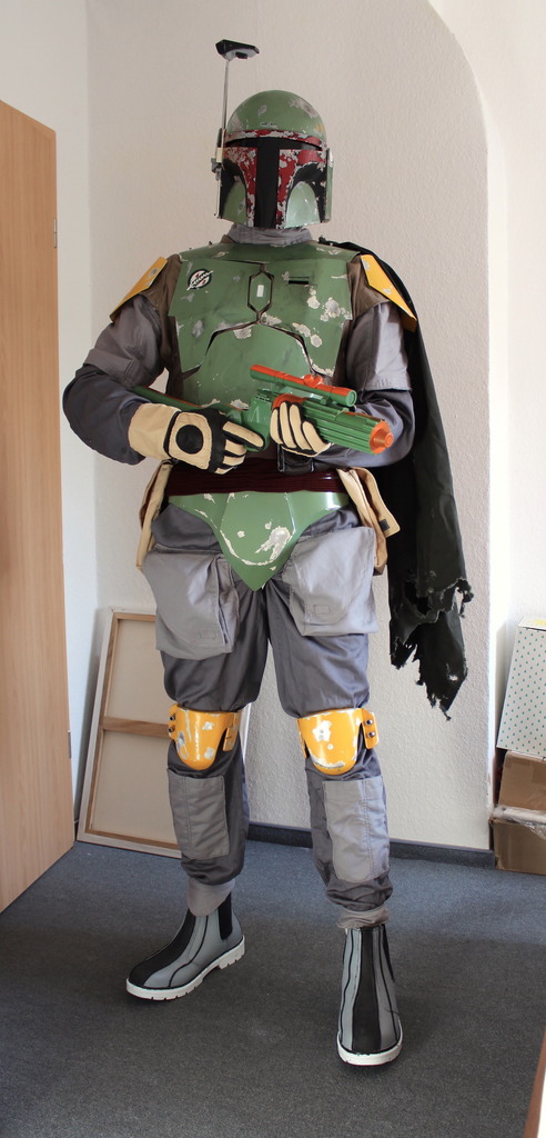

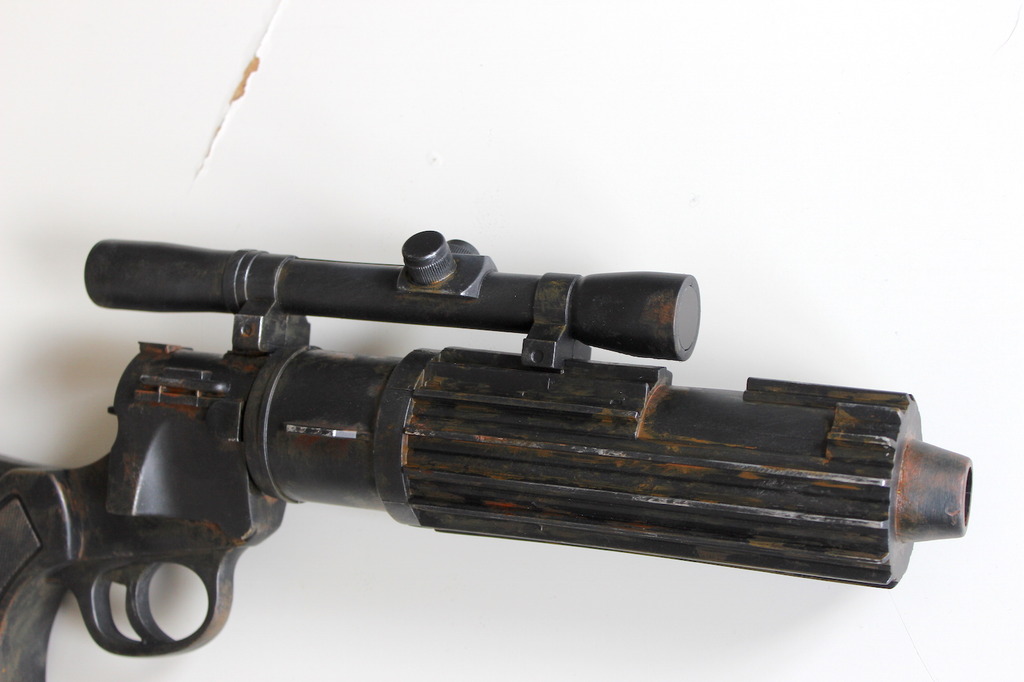

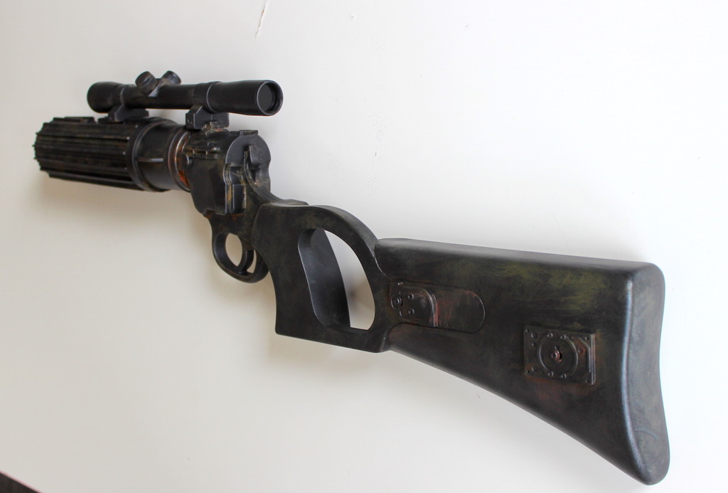

and this is were I am now. almost finished but I still have do make the gaunlets and the nipples on the shoulders are also missing. I also bought one of these cheap Rubies EE3 Blaster and modified it a bit. not perfect, but for the price not too bad I think...
pew pew

The helmet and metalwork looks incredible. It must weigh a few pounds? It would certainly help stop a real bullet :D
BTW: How thick is your body armour aluminium/aluminum in mm? I'm looking to do exactly the same as you (except self build the helmet in cardboard/plastic)

I think since you've got such talent with welding and metal work you definitely should make a more size accurate blaster....the Hasbro is great for a child but its very small for a adult.

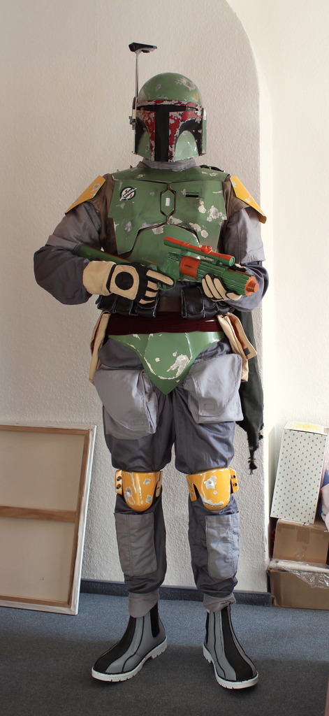

thank you, well, I hope to finish it for the rogue one premiere this year, but without any jetpack I guess. the helmet weights around 2,5 kg so its pretty heavy... but still wearable. but I wont try a real bullit test:cool

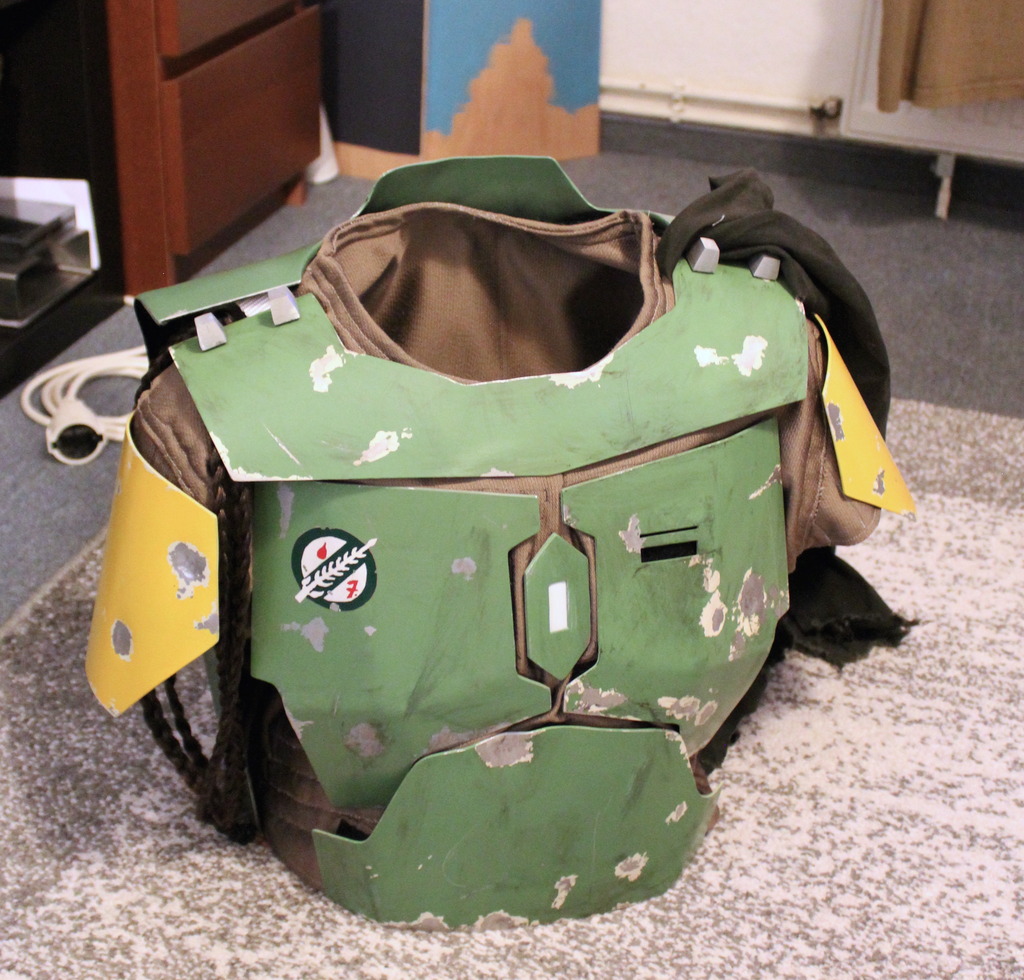

for the armor I used 2mm Aluminum sheets but cyberpyrot here on this site is doing an armor in aluminum too with an 3mm ones. also looks pretty nice and a little bit more massive I think.
the blaster is a rubies mod and yes, its definitly too short but feels still good in my hands. filled the whole thing up with resin so its pretty massive now. when it came to the blaster I first thought about casting one in aluminum and maybe I ll do something like that one tay...
Fantastic. I'd love to see the result for Rogue One. I'm using 3mm aluminium for the armour and I think Cyberpyrot is using around 4.5 or nearly 5mm but I'm hoping to round my armour to make it look thicker (by filing the edges in a curve shape as I can see in many other ABS or plastic variations of the armour that has been molded in 1 or 2mm ABS/plastic). Cyberpyrots' armour looks amazing I must admit and he doesn't have to do the rounding to achieve the extra thickness. I haven't got a lot of tools to weld so I'll be getting creative :p

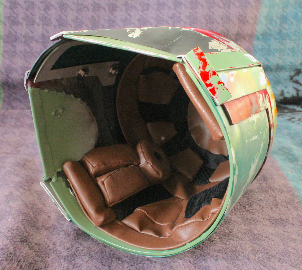

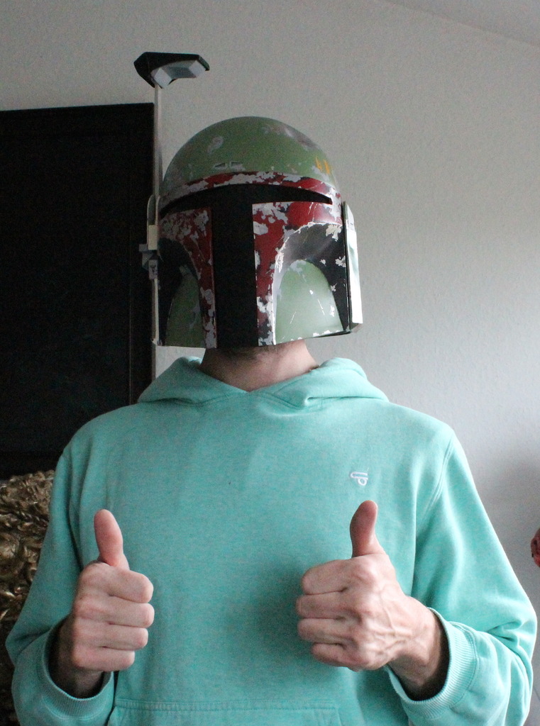

I love this build , it has a touch of realism in it using metal . I particularly like the padding inside of the helmet . That's a nice touch

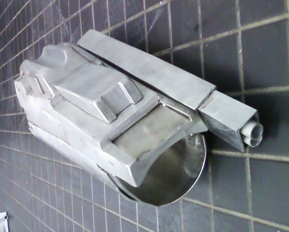

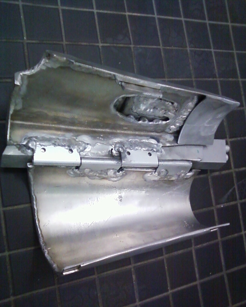

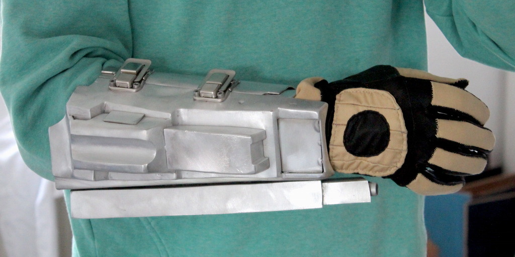

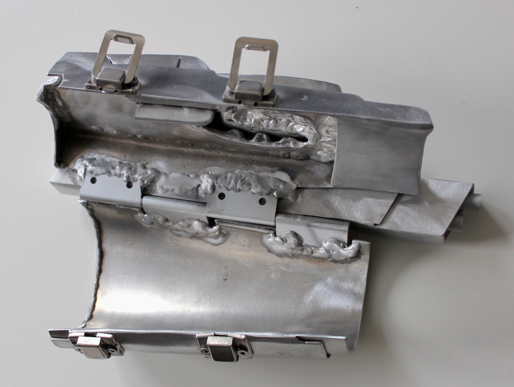

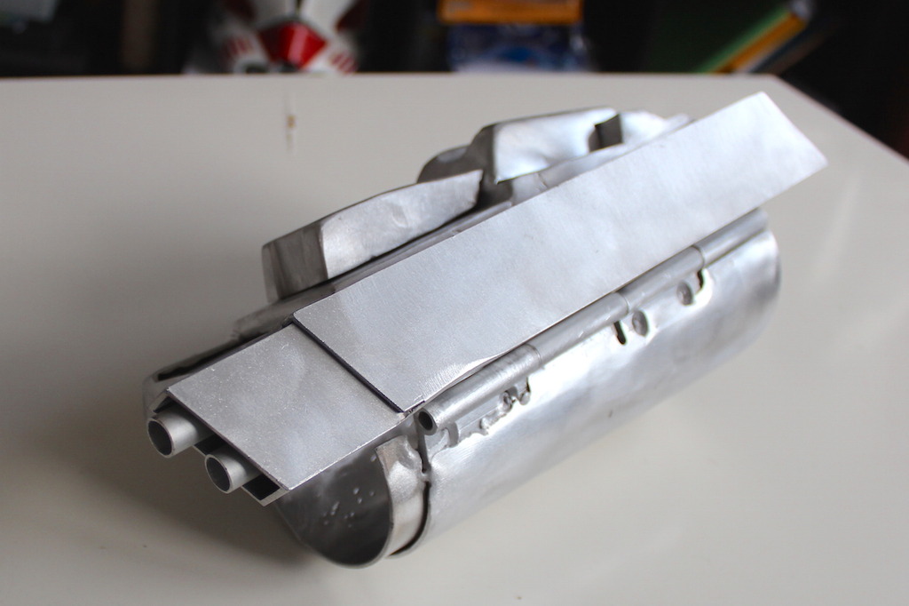

thanks. yes, the gaunlets have a really complicate shape. I want to weld everything and use aluminum hinges to weld them in. hope it will work. the convex forms are no problem, but the concave structures I may weld from the inside and fill with some bondo than. I first thought about curving the edges but just was too lazy. I also thought this could be a little bit contra productive for my attachment using the velcro. I m really looking forward to see your progress than. think aluminum is a good material to make a more durable armor.

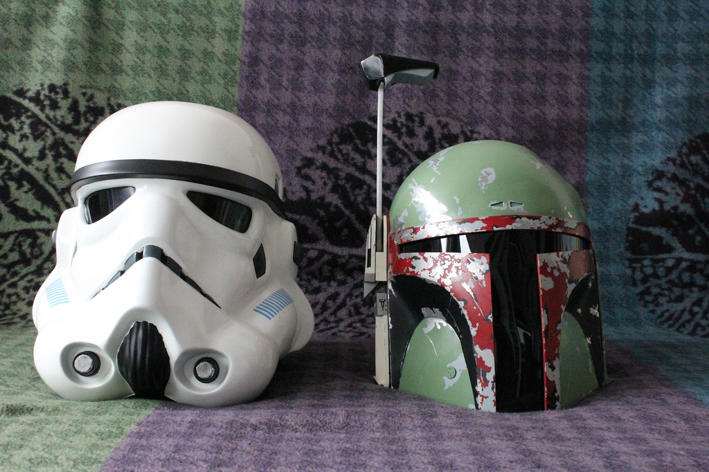

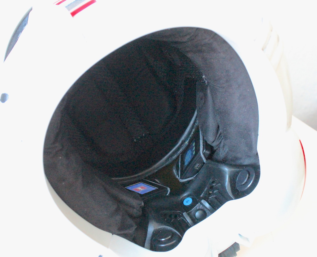

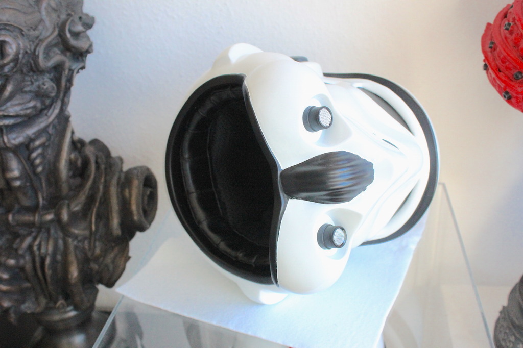

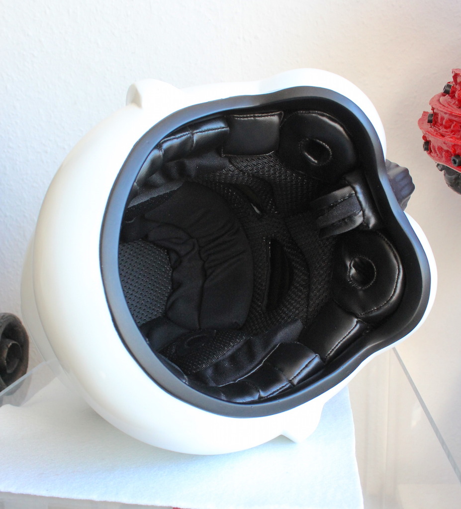

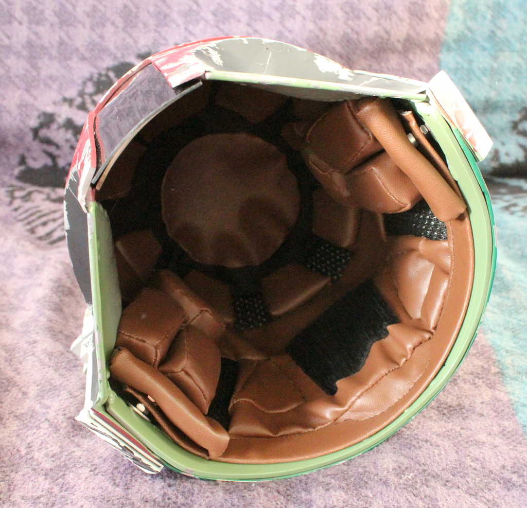

thank you too. the padding is ok for me now. well, its a kind of compromise because the helmet is pretty tight on my head, even if my head is already small though. so I had not really much space to put a good padding in. I m more satisfied with my TK and clone helmet padding which have a nice touch of realism to me. always wanted a TK helmet as a child and always had some image in my head what one of these should look like inside. this image was not really the ones the star wars compendium offered me later I must say. here are some pictures of the other helmets interior I made:
TK Helmet
and the shocktrooper helmet

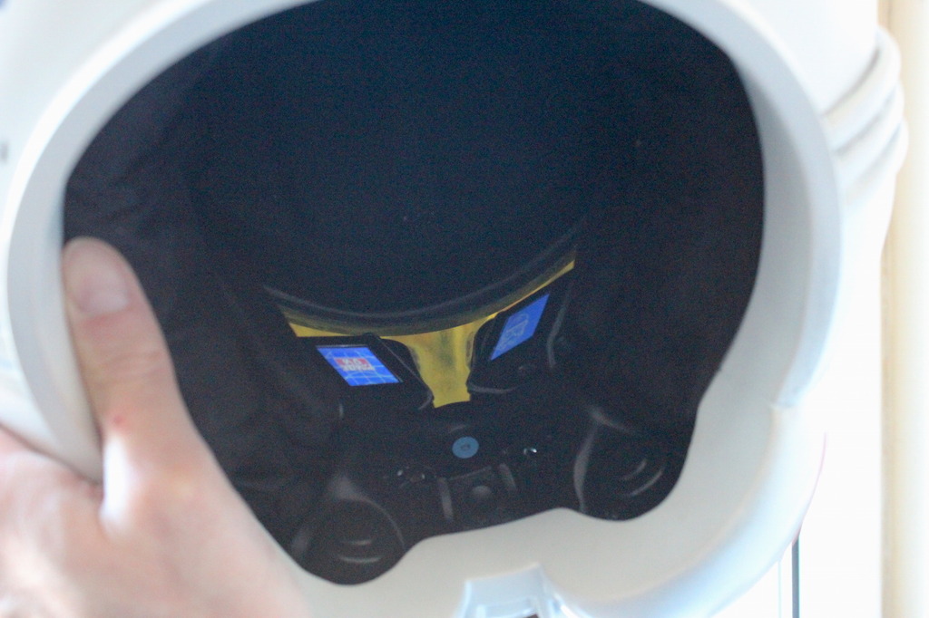

Wow ! Those pictures of the helmet interior are awesome . How to you create them?
full threads are on the RPF:
Shock Trooper, Finishing my PUR Resin Model
Rubies Stormtrooper Helmet modification
Aluminum cast Clone Trooper Helmet
the padding I sew by myself, not too hard to do if you´ve got some few sewing skills. the mouth piece and lens frame I ve sculpted in clay and made a cheap silicone mold from them. for the resin clone helmet I used also some PUR resin to cast it. the round pieces in the area of the mictips are actually door stoppers. and the little screens are cheap digital pictureframes. they work great for me because as a child I always thought there would be some kind of screens inside of such helmet.

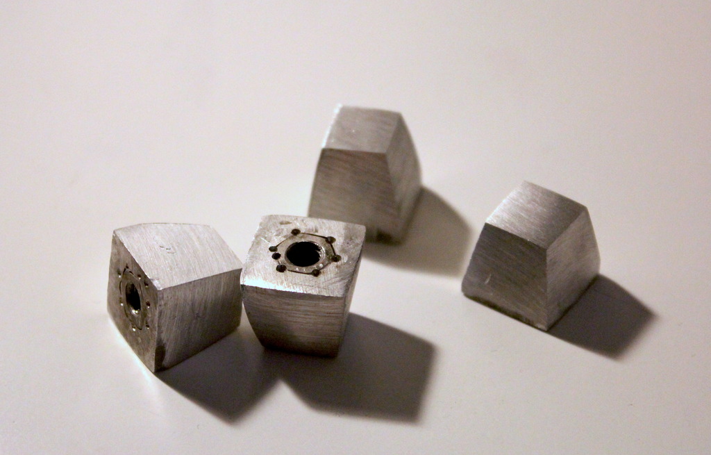

finally made the collar studs today. just drilled an 8 mm hole into aluminum cubes and hammered some steel nuts into it. the nuts were a little bit bigger than the hole. for safe I ?floated?...dont know the english word for it... the aluminum around the nut a little bit to fix it. but I think the nuts would sit pretty tight in it without that too. maybe I will have a chance to start the gaunlets this week.

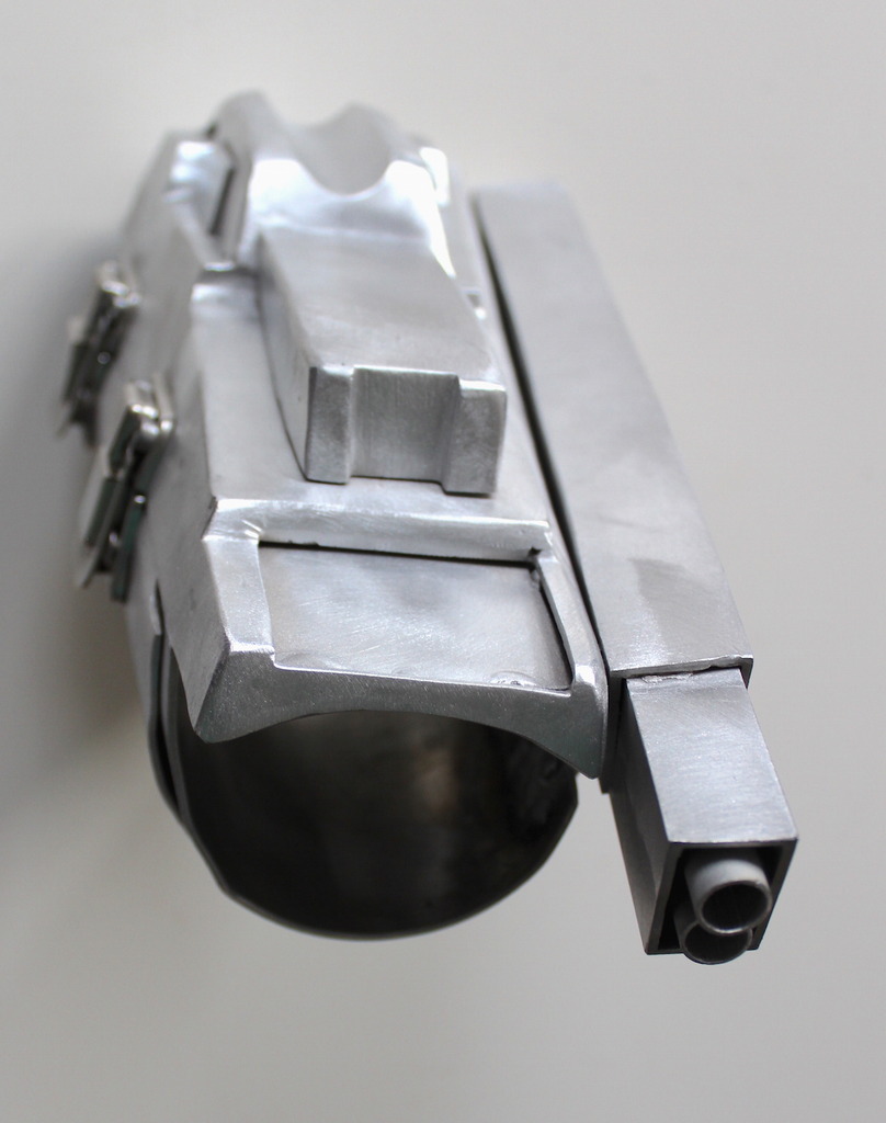

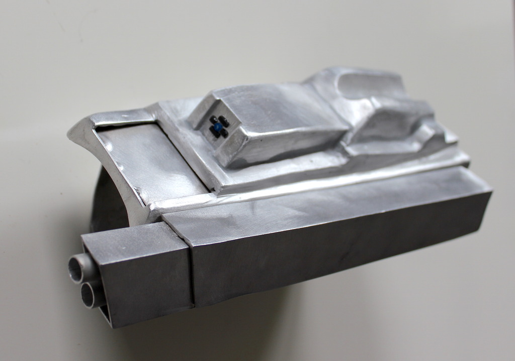

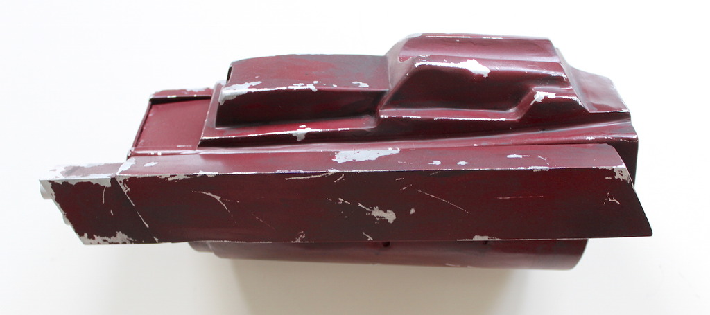

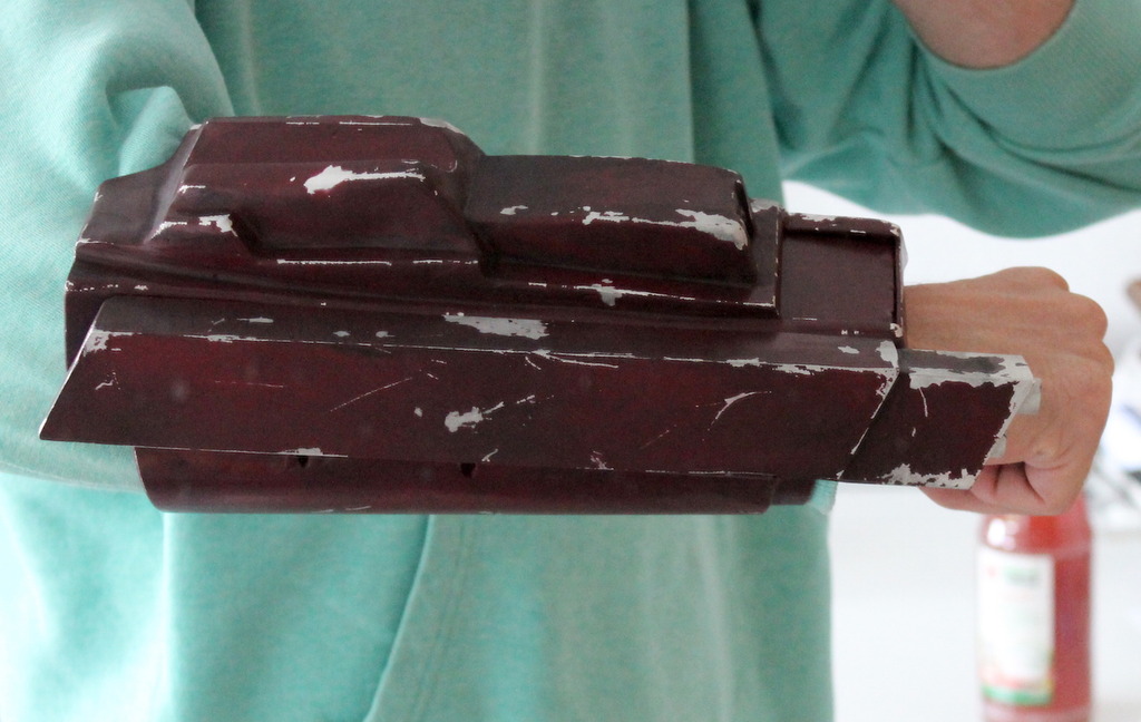

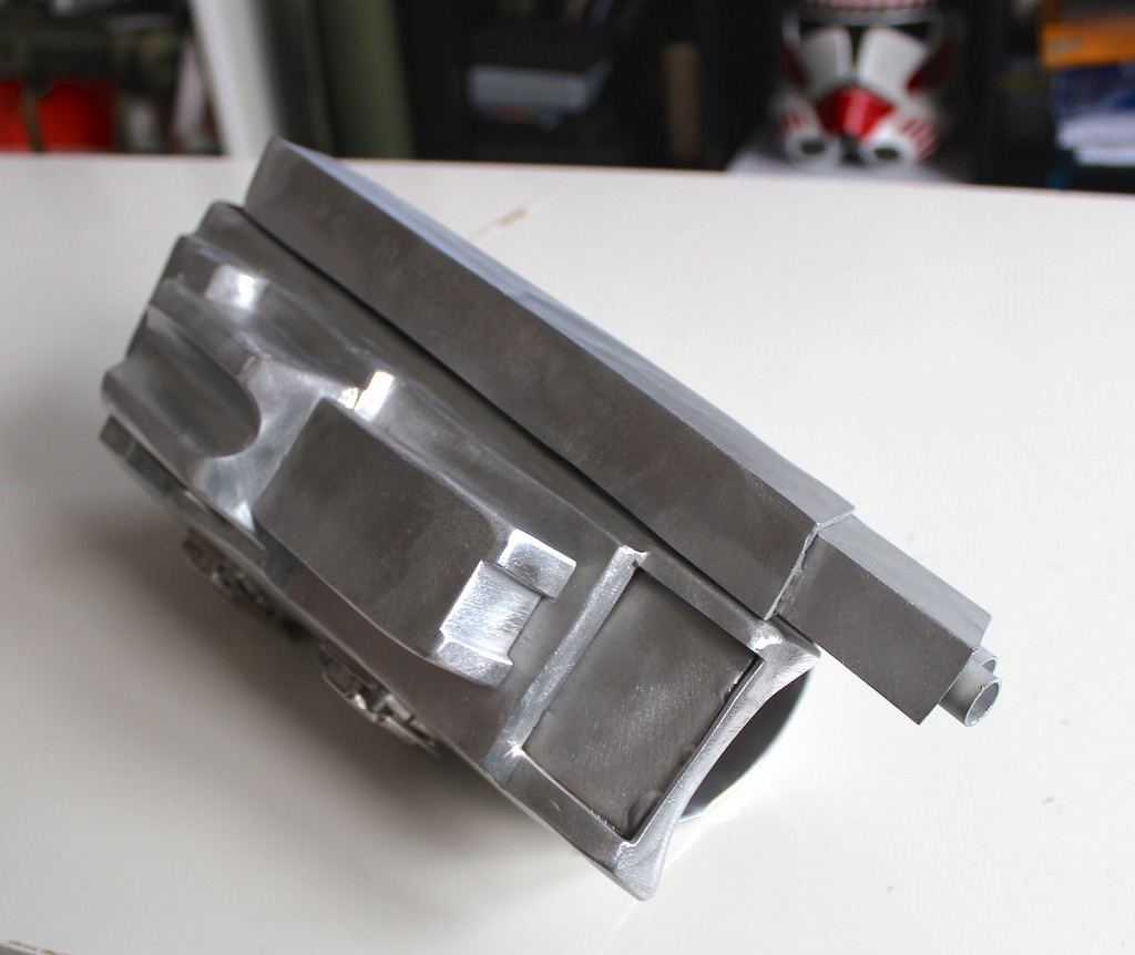

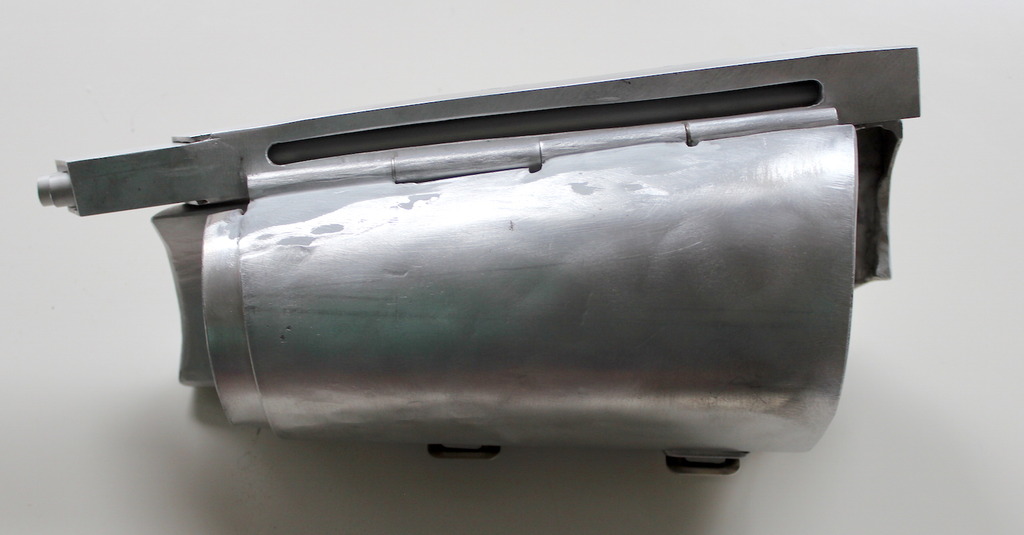

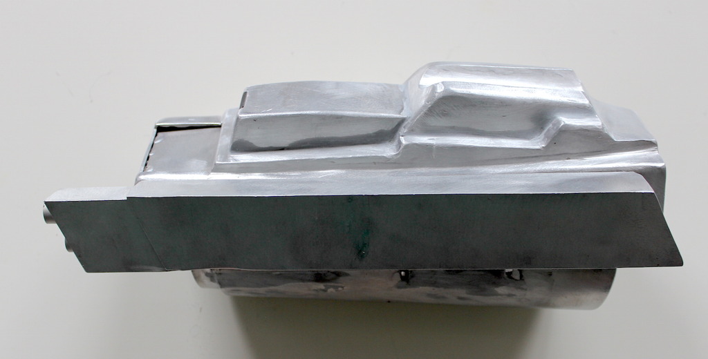

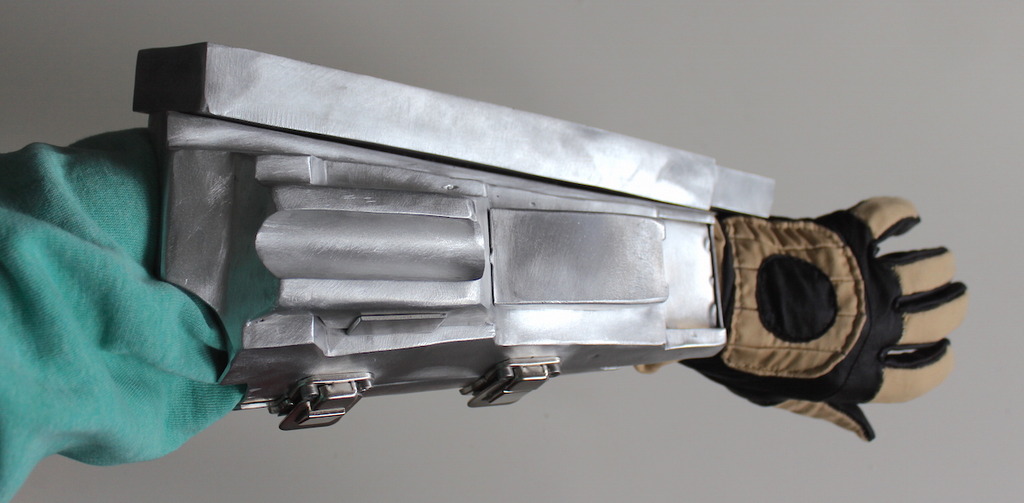

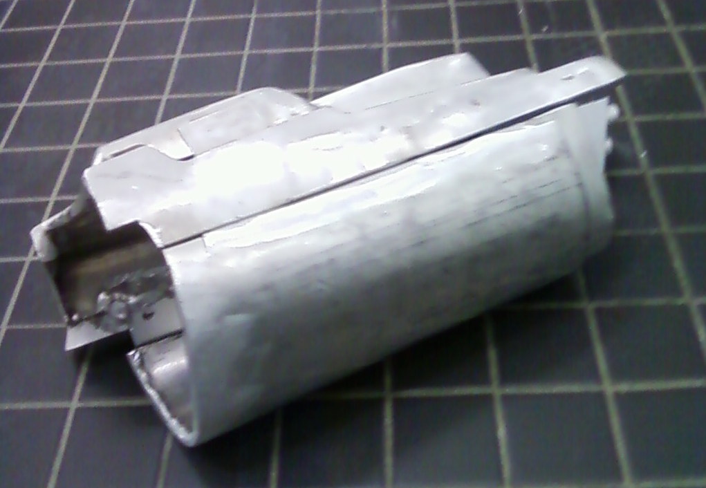

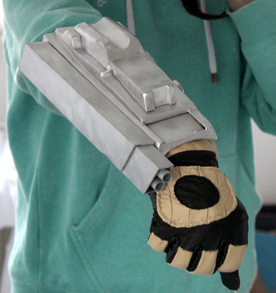

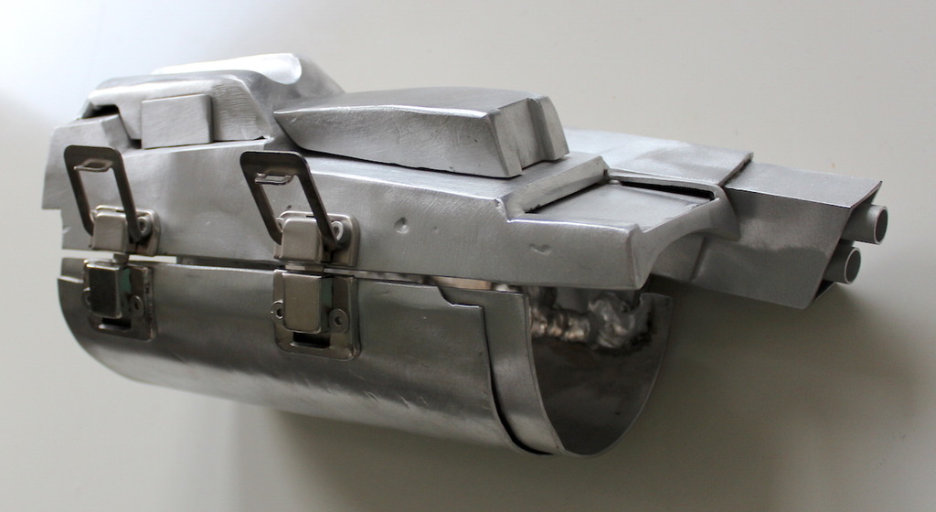

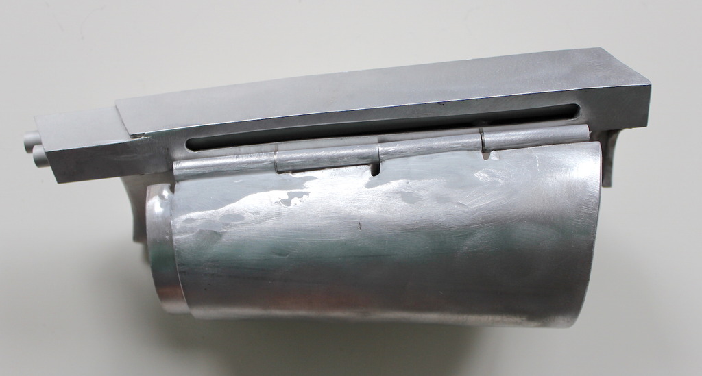

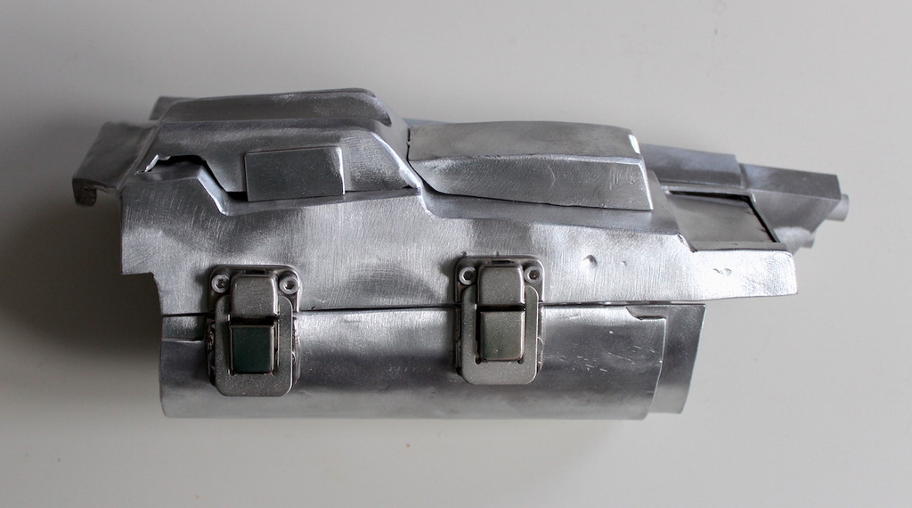

here are some bad photos of the left gauntlet I almost finished today. just a little cleaning here. the locking mechanism is the only thing I ll have to think about a little more. bought some clip locks, but now I think they are a little bit too obvious. maybe I can find some smaller ones. anyway the aluminum work is done. next will be the right gauntlet than.
Looking good you got me beat.
thanks for this compliment:), but I think your armor is much closer to a screenaccurate one. awesome work you made. did you already made the left gauntlet too? pretty complicate little thing to weld I think.

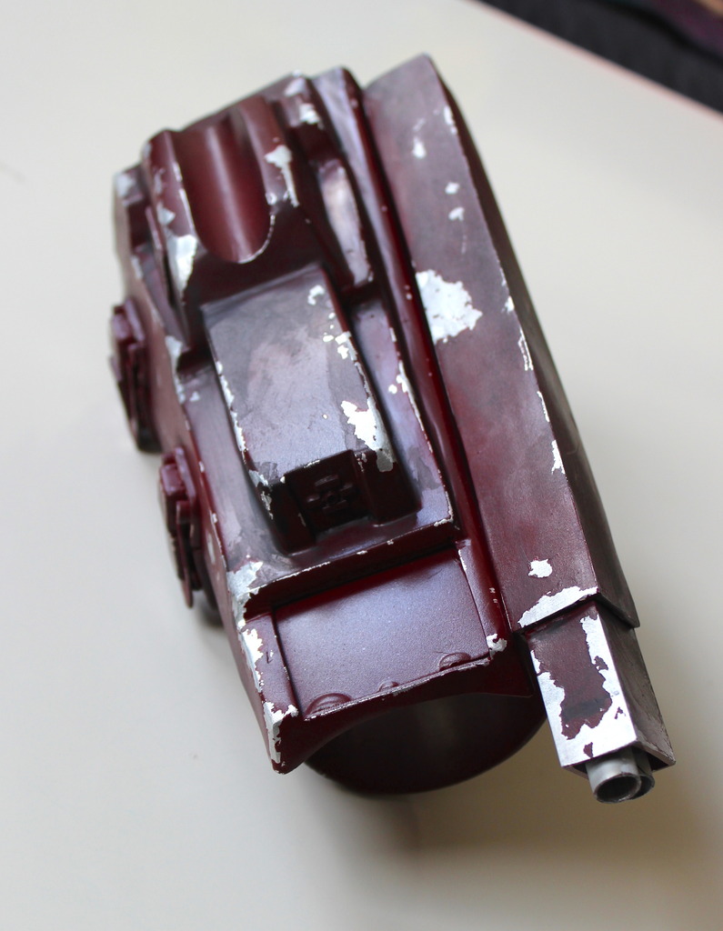

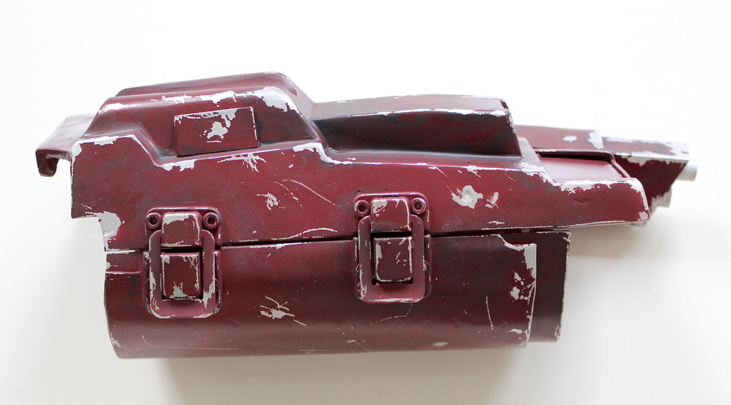

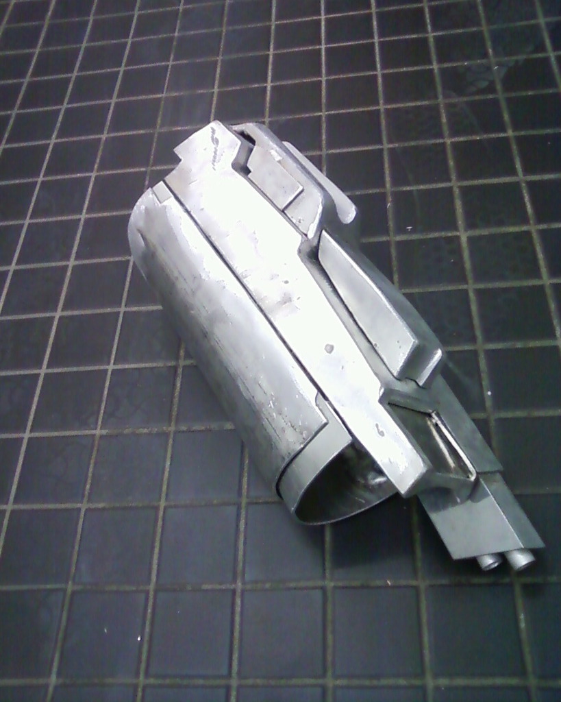

here are some better pictures of mine. I added some new cliplocks I found. pretty happy with these. they are making the whole thing a bit more funktional. not accurate but more to my idealised image of an armor. after a little bit of filling and detailing I can start painting and adding the keypad.

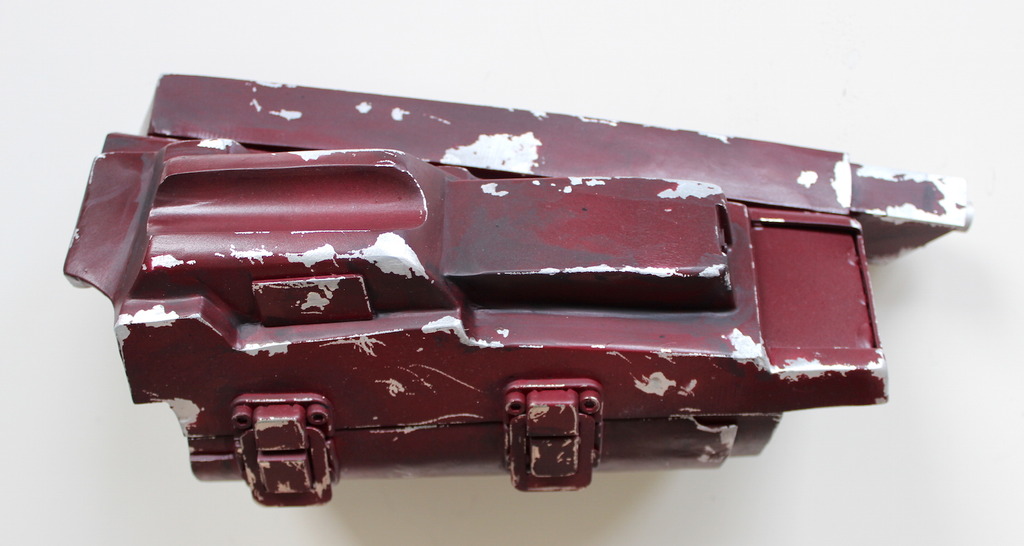

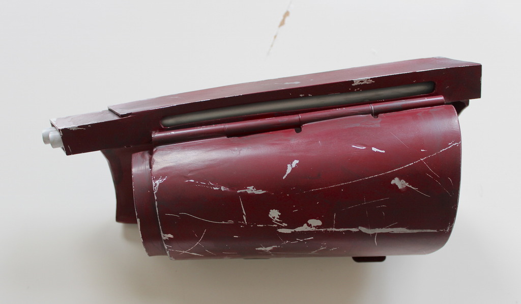

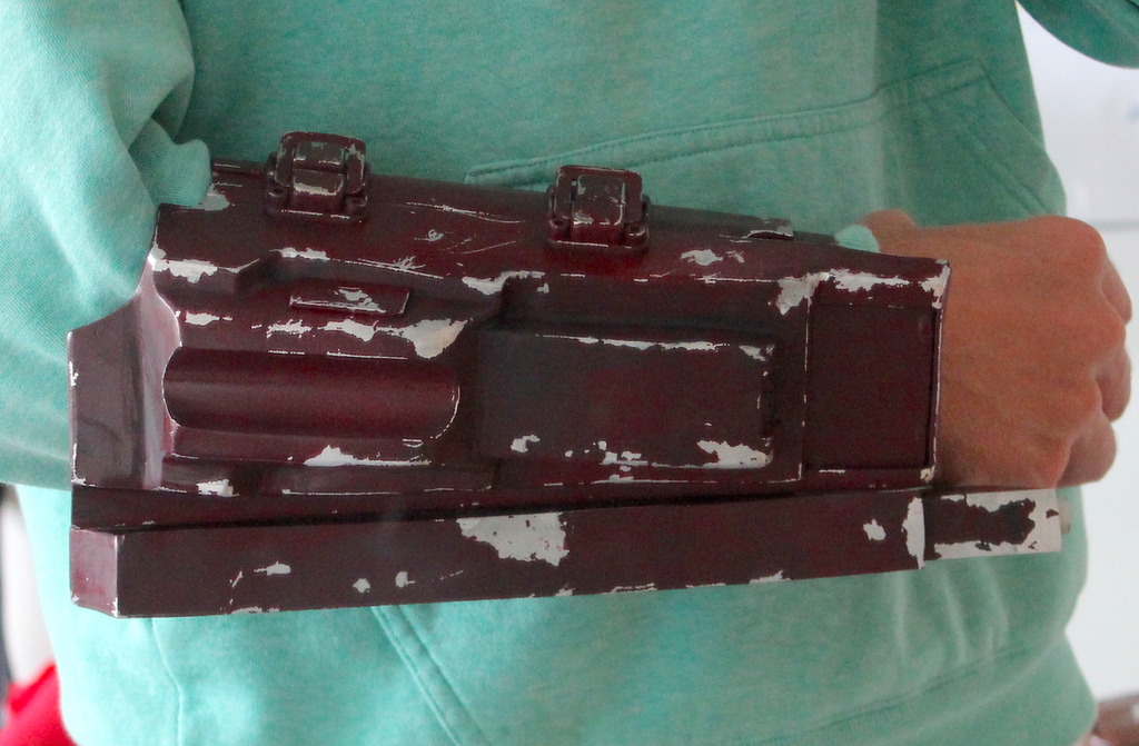

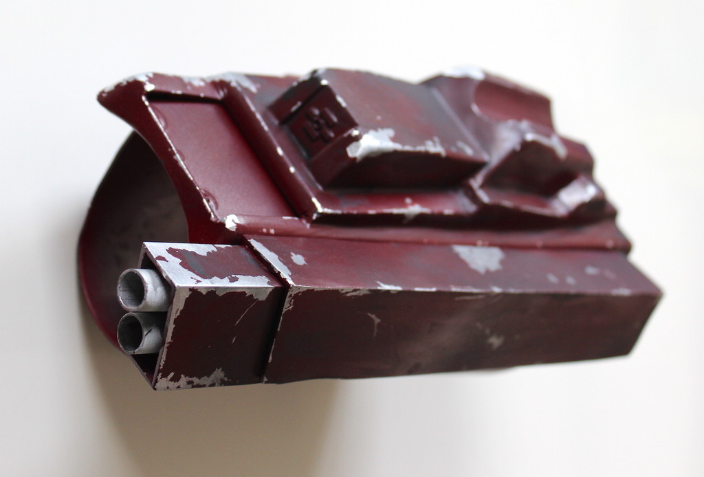

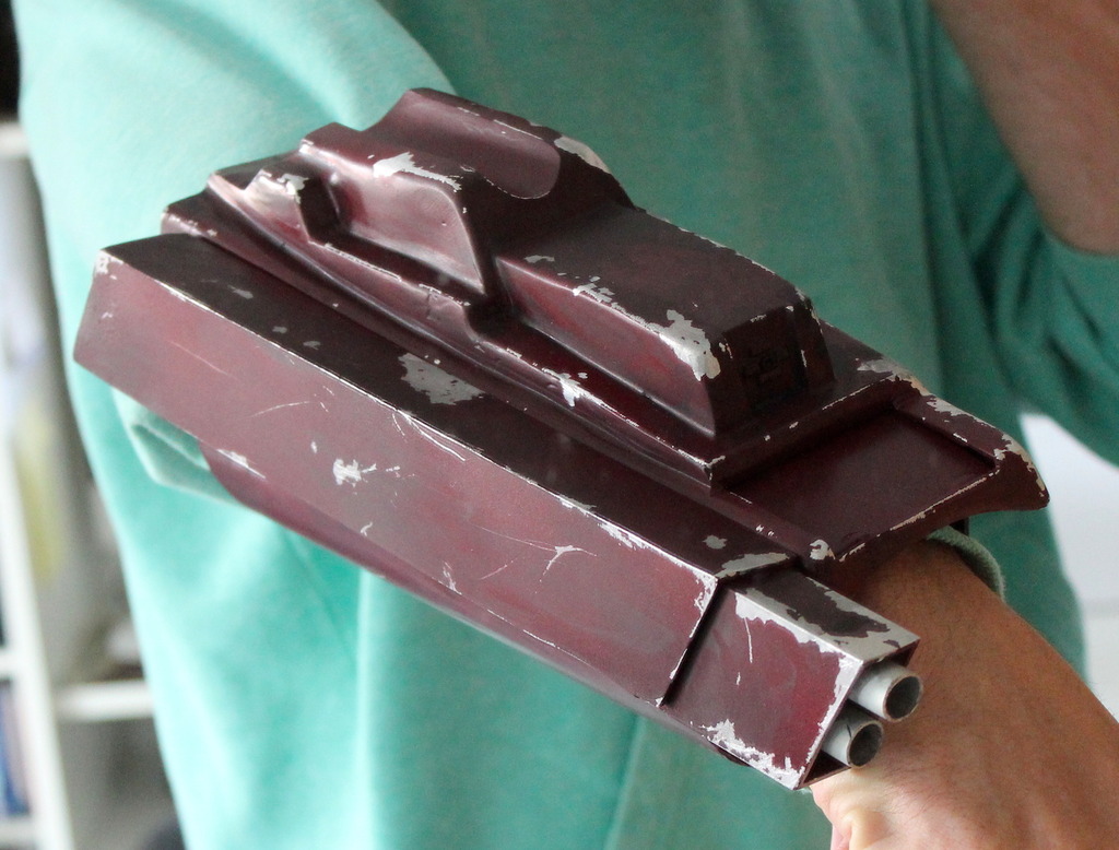

here is some progress. after filling and sanding the left gauntlet I made it to paint it this weekend. I also weathered it. the weathering was some kind of fun with the aluminum. I did not use a primer so you can add scratches and chipped paint easily by using some piece of metal and do some real scratching. the color goes off easily than and it looks natural.

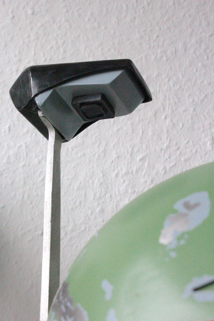

next thing will be to find the keypad and add it. and the gauntlet will need a rocket too. but maybe I ll start working on the right one before doing the rocket...
That is a thing of real beauty. I love the way it looks real-world and knowing it is made of metal makes it even cooler.
I don't know how you did that in metal but it looks amazing. The weathering is also great looking.
Well done alienbuilder. I certainly wont be able to top that.
Awesome work!
Well done @alienbuilder. I certainly wont be able to top that.
Awesome work!
thanks a lot. well, its really cool in aluminum, but I think not 100% accurate. for me it looks good, but all of that is just bend somehow and welded together. I m also using the cardboard templates and and they work well most of the time, but you ll have to improve from time to time. the gauntlets are such a complicate form, all the bending of the aluminum results some changing in the measurement. well, its not too hard do make these, but you need some place for welding aluminum.
