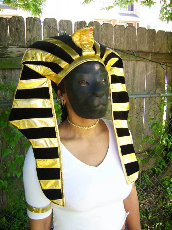

Here are some examples...
I whipped out this mask for my wife one afternoon, starting from a cast I'd made of her face, for a party that night:
(There's a thread about it on www.tk560.com:
http://www.tk560.com/phpBB2/viewtopic.php?t=567)

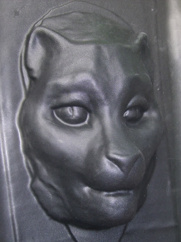

Another couple of craft foam masks,
The one on the left was my first try at 6mm Foamies, without a high vacuum system and probably without cooking it long and slow enough. It came out disturbing-looking; I like that.
The one on the right is 2mm Foamies (or Funky Foam from Hobby Lobby; they're pretty much the same), also with just a vacuum cleaner for suckage.
