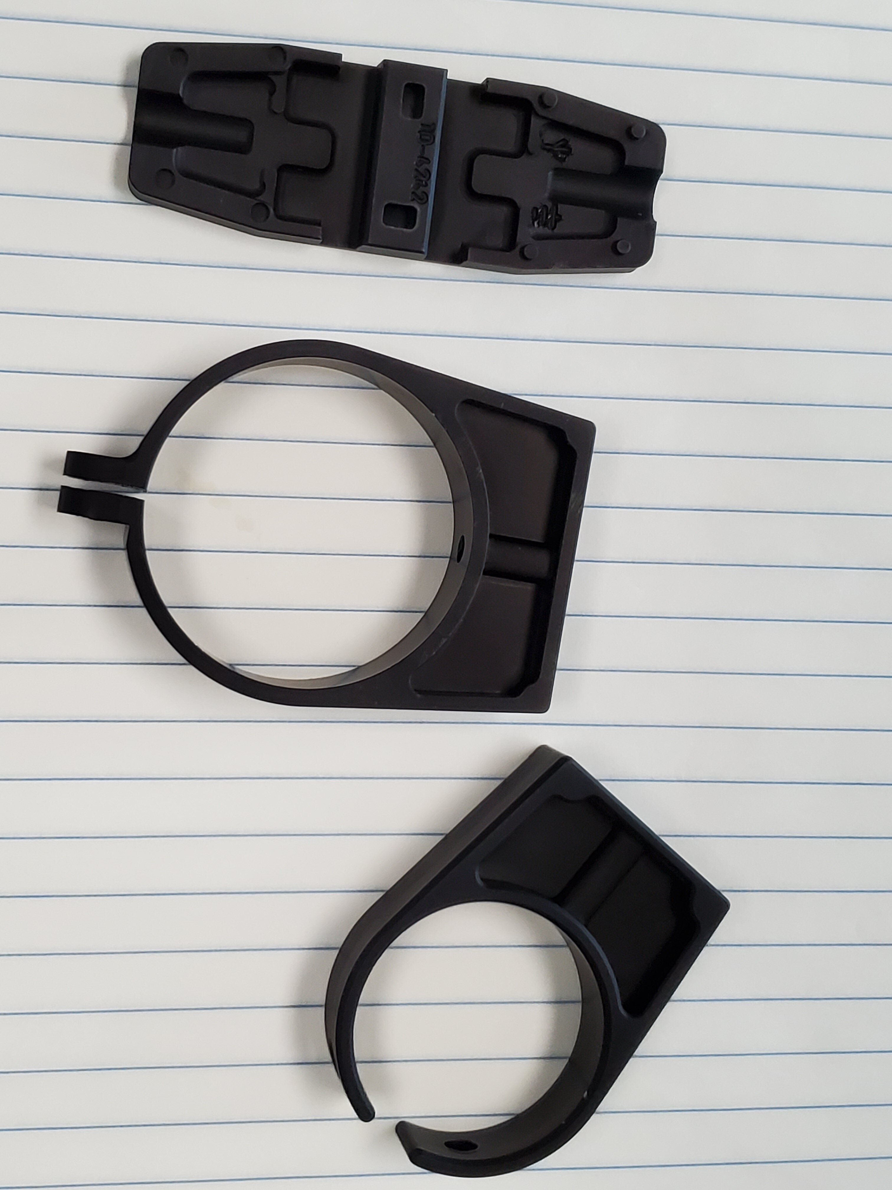

OK, everything fixed and new scope ring mounts made. Still have to do the part the scope mounts to, the U'ish part that fits over the tops. I have stock and a plan. lets see how it works out.

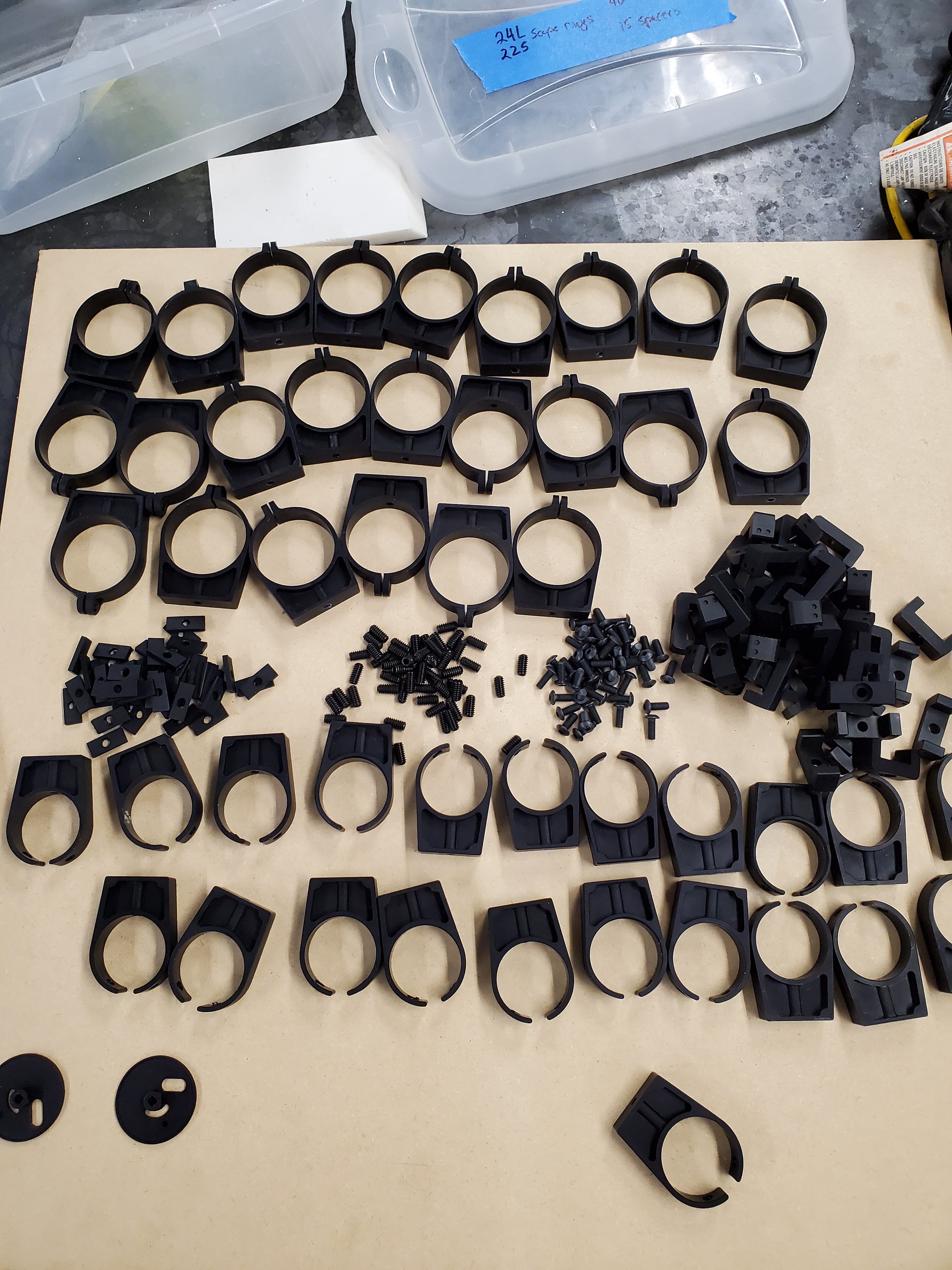

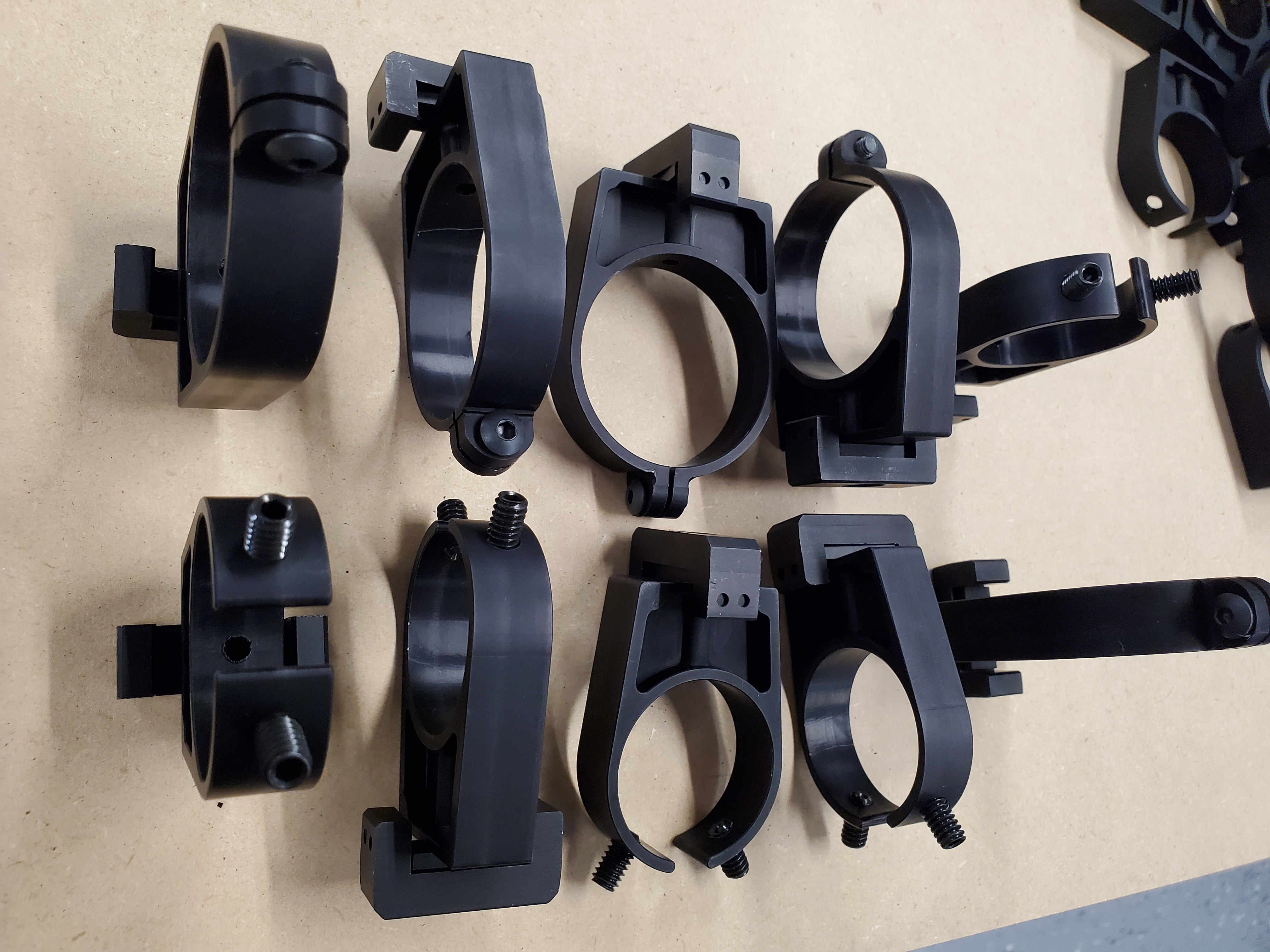

Getting really close. A few manual parts, split the large ring clap part, drill tap the small rings for the set screws.
and then a bucket of parts go off to be anodized.

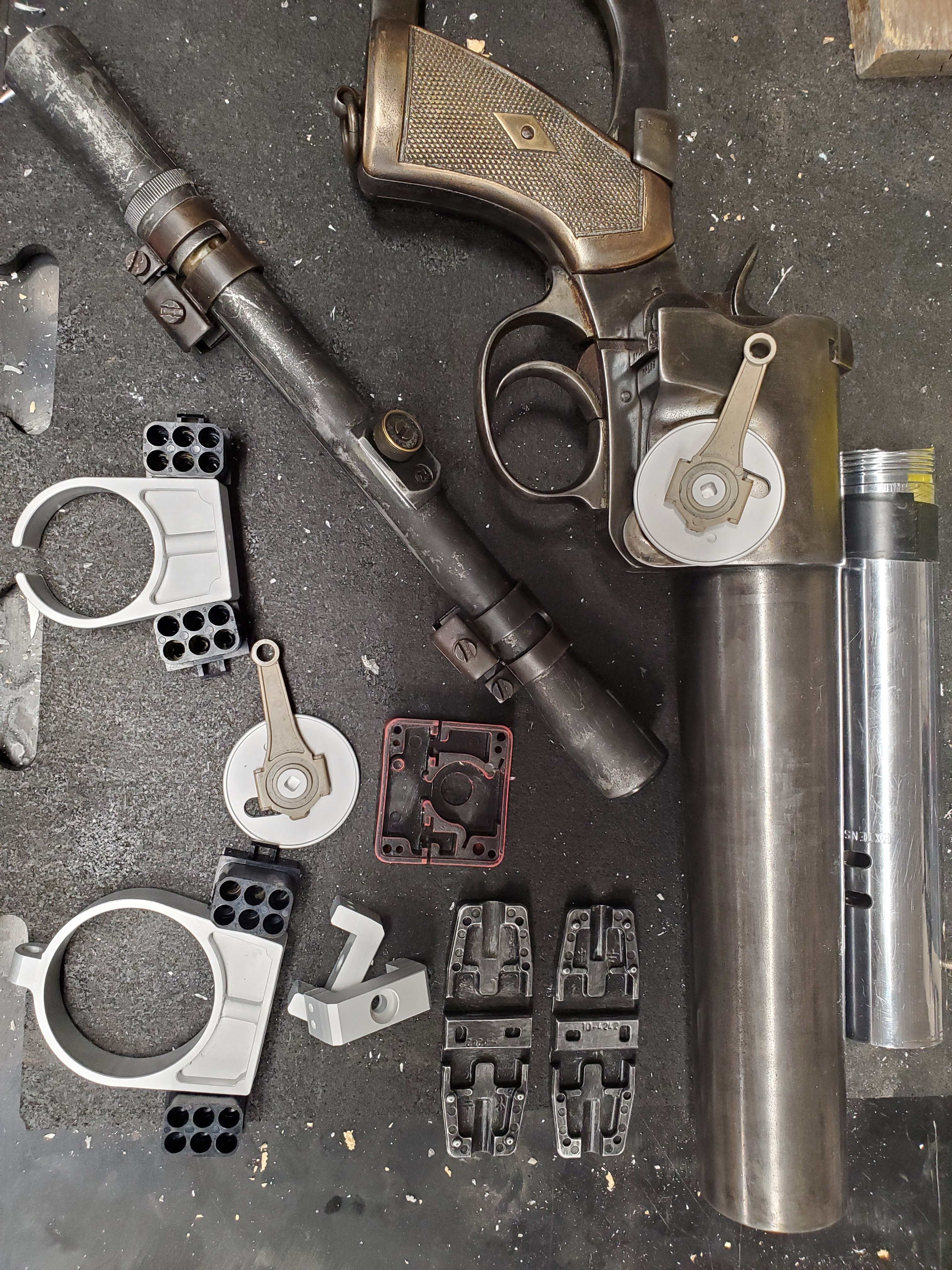

You've got to sort that scope out though.
yea, it's close but not quite right. have some feelers out looking for a more correct version. I may atleast machine some caps to give the adjustment knobs a more correct look, I may even be able to modify the base some to achieve the correct look.
Another consideration might be to try to obtain one of the 4x15 versions of the scope, which will be a lot cheaper than the 4x20 model. Then you could cut it down and stick an objective bell on the end.
It's not perfect but I may have found a good 70s era 4x15 with at least the correct site adjustment. Making a franken scope now until I can find something better.

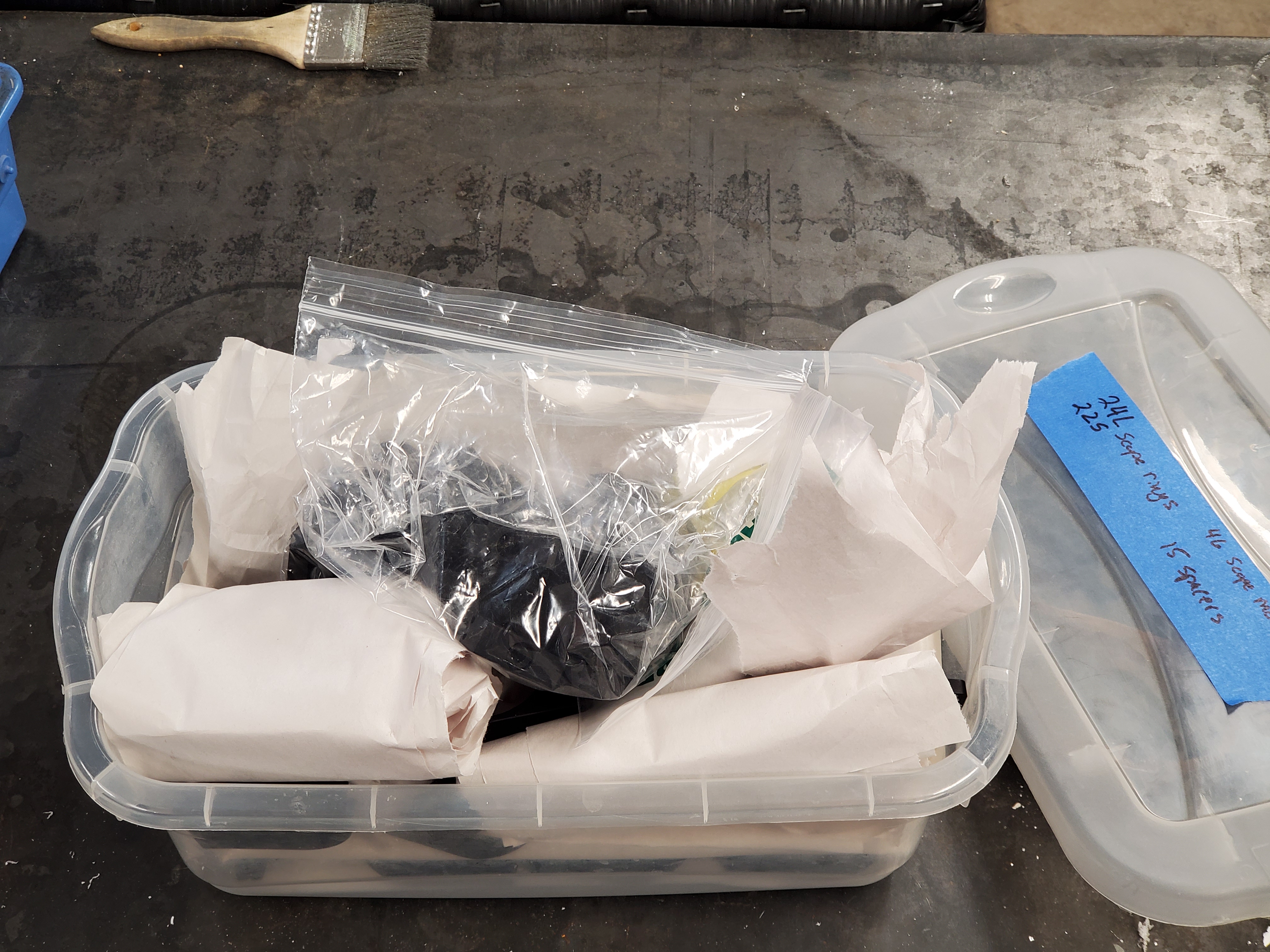

Just dropped of everything to be anodized. should be about a week. should also have another video for this and the split plugs.

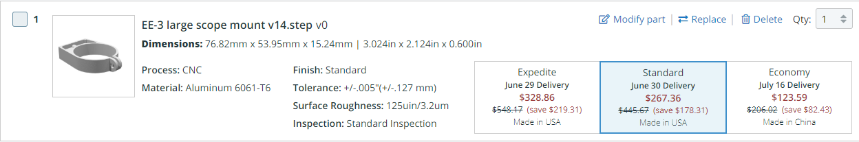

Just to get an idea, I got a quote to have these made from a normal machine shop, this is same material and no anodizing.
Most importantly, this is for one of the 6 parts that make up the set.
I will be significantly cheaper than this.
