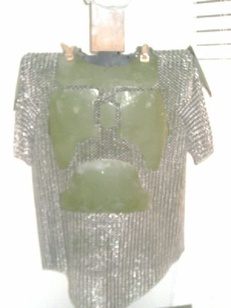

Question? Your Mondo Chainmail shirt, just how heavy is it? So far I have made a vest, 16ga steel, 4-in-1 weave, and a shirt, 6-in-1 weave mix of 18ga steel and 17ga aluminum. Both are somewhere between 20-25lbs. I had no problem wearing either of them for the first 12-13 hours or so. After that they did start to chaff my collar bones a bit. Actually your pic is similar to some of my first thoughts on combining to two armor styles. What metal, in what gauge, in what weave did you use?

I used .072 thick stainless wire with an OD of .459 in a 4 in 1 pattern with a mix of 14 & 16 gauge plates over top. I don't remember the exact weight, but I think it weighed in close to 40lbs. After marching in a parade and party after, that thing felt like I was dragging an anchor.
I had a fett inspired helmet made, but the smith that made it was sloppy and cheaped out on me. Not only does it not fit, its offensive to all Fetts.
I test fired a crossbow at the armor and while it splits the rings open, the bolt shattered on the plate.
