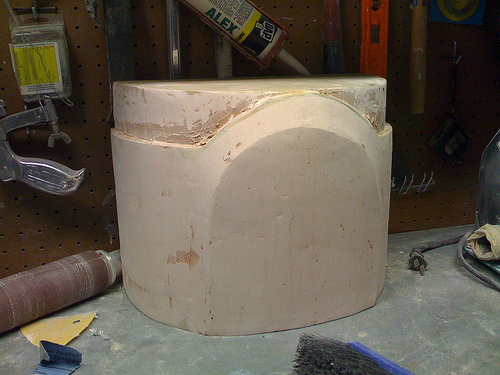

so here's the REALLY rough shape of the belly:

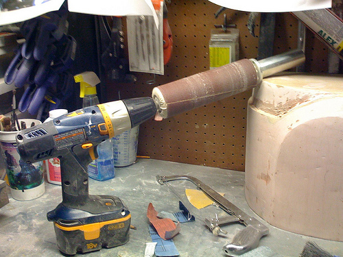

it is a BIG stack of MDF and a lot of bondo. i smoothed it out using:
so fast! that thing just TEARS through the bondo... think of the little dremel sanding drum, but scale it up a LOT. it's nothing you'd want to do picky work with, but it sure gets the job done for large flat areas!
additional sanding services provided by:

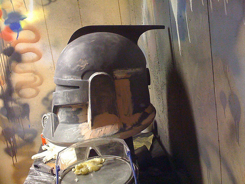

and while i was at it, i did a bit more tweaking on the helmet:

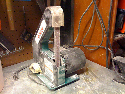

a big piece like that is too heavy to move around the stationary belt sander i have in the garage, so this was a total win.

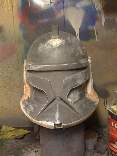

here's the new helmet sanded out... it's now at the point where i'm doing small filler spots, smoothing, etc... i still need to carve in the vent slots, but i want the thing pretty well smooth before i do that.

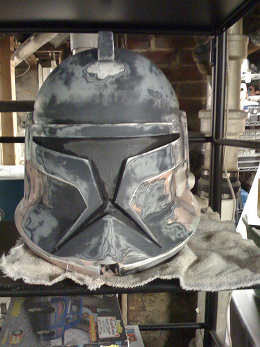

this was rinsed a few minutes earlier, after a messy round of wet sanding. the way the water is drying on the visor looks pretty neat. also neat is the layering of primer. i alternate coats of light grey and dark grey so that i can see if it's a nice even coat. when doing fine sanding like this (320 grit wet), you end up with some pretty awesome patterns.
