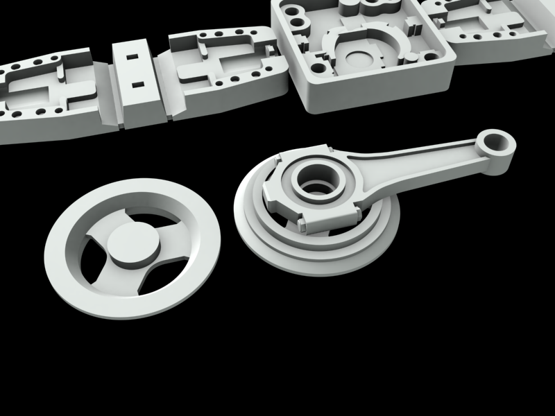

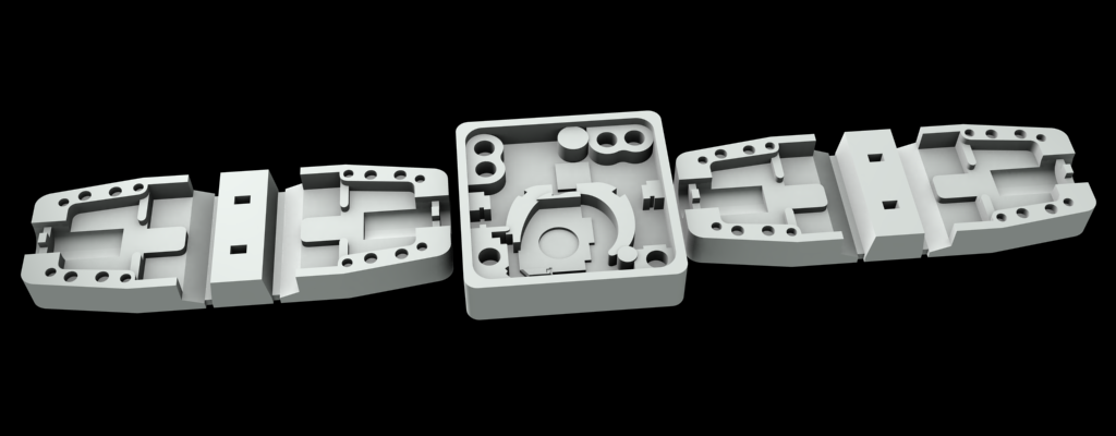

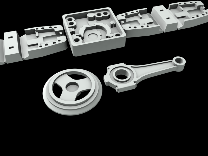

Hello all! Haven't posted here in a long while, been over at Mando Mercs mostly. But I was hoping to get opinions here for this project. It's just preliminary testing, but I also hope this to be a good source for anyone else wanting to use this process. I hope this is the right place for it, if not, oh well guess it'll be moved anyways lol
After having built a few models for a guy over at FX-sabers, I figured I could do the same for own mando and fett costuming. It would get excessively expensive to make everything with 3D printing (especially depending on what material is used), but I figured it'd be perfect for at least some of the parts and greeblies.

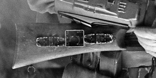

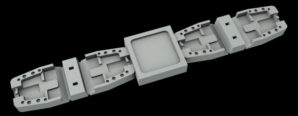

Anyways, I'm starting to work on some models for Fett greeblies, and I wanted some opinions for accuracy's sake. This is the stock piece for the EE-3 ESB boba rifle I used WOF's templates and other references. Again, this is just preliminary tests.
P.S. for those curious, I'm using 3DS Max. Not exactly CAD, but it works wonders regardless for prop making too.
I am no expert but I believe the 2 end pieces are slightly offset and there are some details inside the square. I think the square is bigger and has slightly thinner walls and more depth.
I would work better as 3 parts - as the gun stalk is not a flat board.
Looking at the screen caps again, you're right! Thanks for the catch. They are separate, just butted up next to each other.
On the point of flexibility, the material I'm going to use at shapeways is called "white, strong and flexible". It's not a flimsy flex by any means, but could help when adhering to the curved stock.
They look really great, just one tip. On the side pieces of the stock, one of the holes of the center of the piece must be vertical, do I explain?
