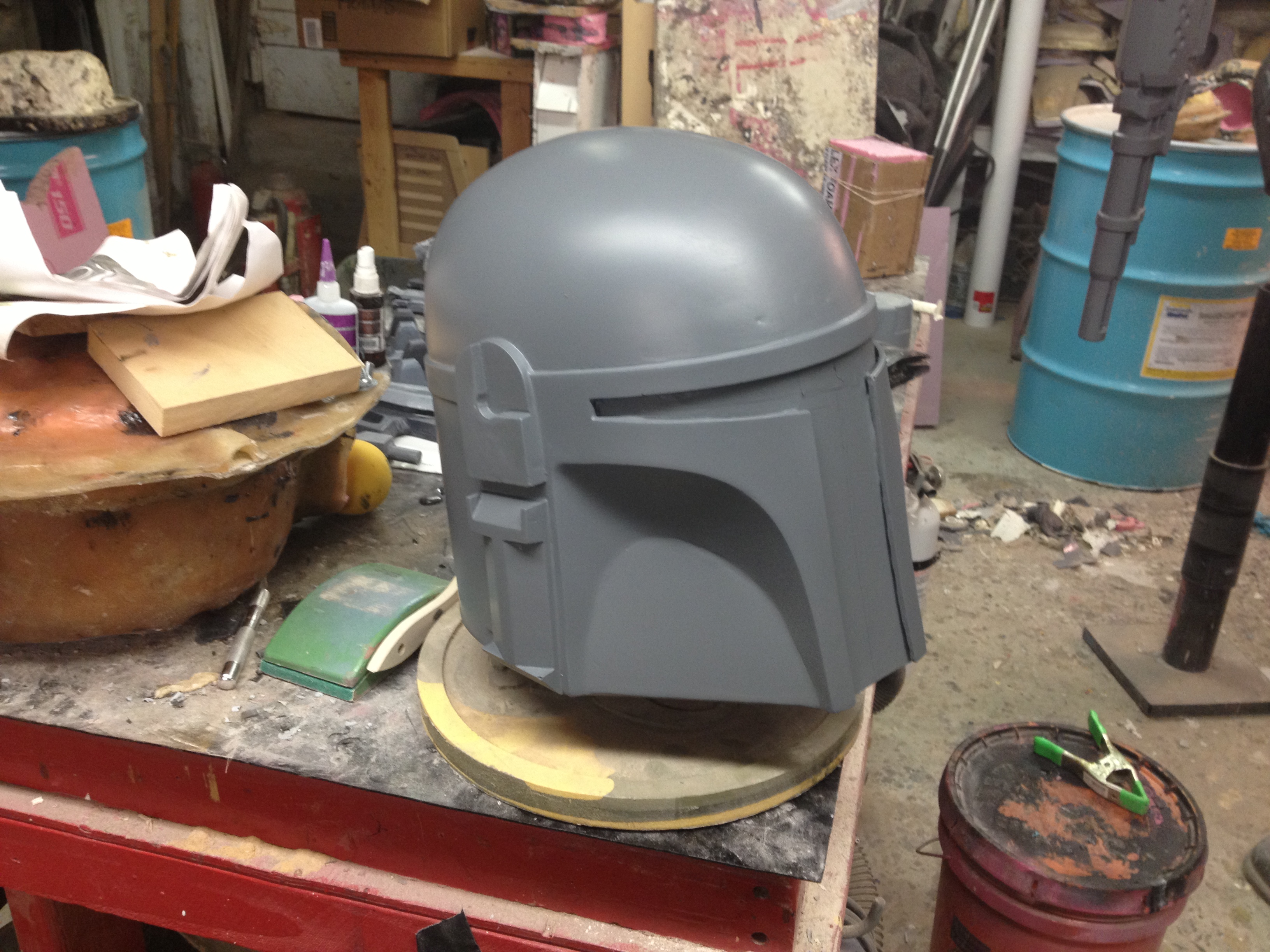

Thanks Ghost. The silicone is from Smooth-On. There are less expensive alternatives, but my friend Shawn is better educated as to what works best and what the differences are. I just "borrow" whatever he has for my projects in exchange for helping him with his projects. The process is actually pretty easy, but there is a considerable investment in the correct tools and materials.
As to the mold making, after the prototype piece is completed, it is coated in a print coat of silicone. The print coat silicone is thick like maple syrup and will coat the prototype, but will end up pretty thin. The next three layers of silicone were the same material but mixed with a thixotropic additive (I'm sure I spelled that wrong, but I can barely pronounce it half the time). These layers go on pretty thick, like cake frosting and add thickness to the mold. I've been told that the final mold should be about 1/2 inch thick.
The fiberglass mother mold gives form to the rubbery silicone mold so that it keeps it's shape. I used three layers of fiberglass cloth over each side, with some extra thickness where the two sides bolt together for added strength.
The good news is that I have made the first casting in the mold and it fits my head with plenty of room. The bad news is that my friend Shawn took the pictures of me wearing it with his camera and I have none to post.... Shawn... a little help please... you said you would post these...

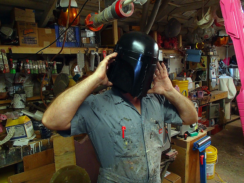

Here's a pic of Matt with the first casting out of the mold:

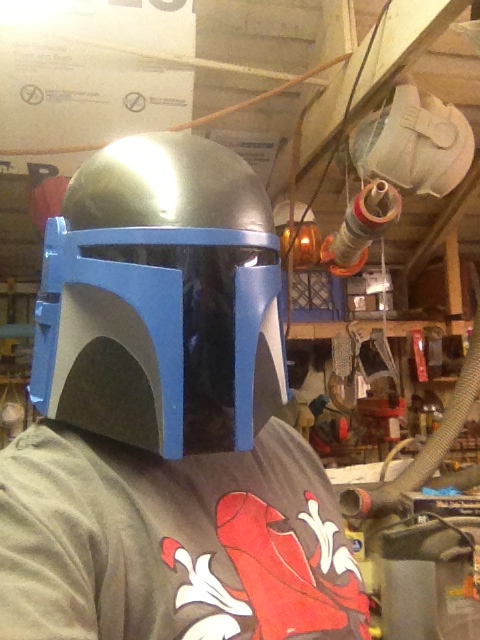

Here I am trying it on:
And here's Matt wearing it:

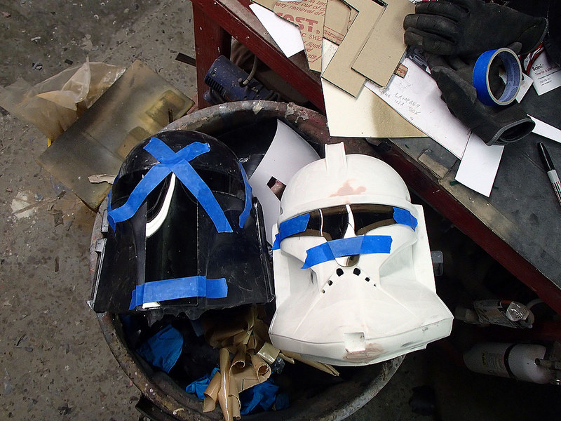

The other night we made the T-visors for the helmets. This amounted to cutting pieces of smoke tinted 1/8" acrylic sheet into the right shape, then cooking them in the toaster oven until they were nice and pliable before taping them to the face of the helmet to get the right curve:
It's the sort of thing we were suddenly doing a lot of:
Once the visors were formed, it was a quick matter of gluing them into place:
Then it was a quick sand, wipe down, prime, and paint:
Which was repeated a few times:
Matt's very proud of his helmets:

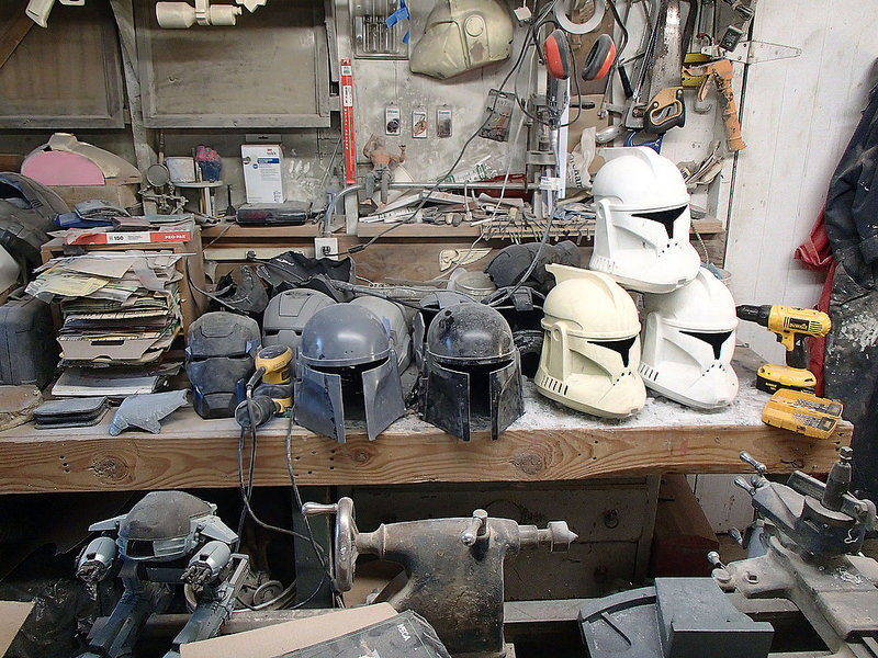

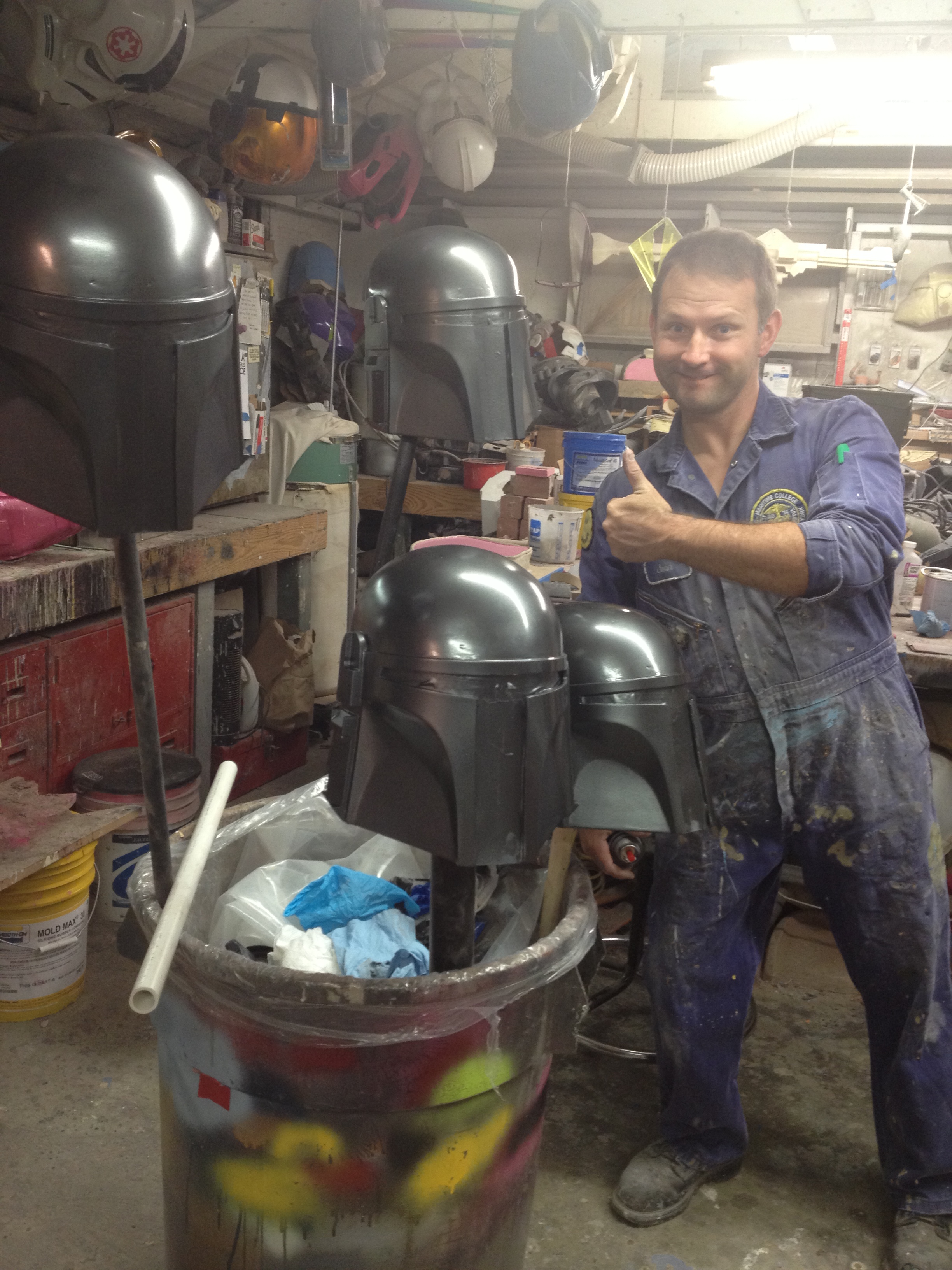

So I've been out for a while... That's what happens when the kids have birthdays, Shawn gets a paying project in the shop, and jury duty... Oh the joys of jury duty! The good thing is that we have made some progress out here on the helmets, and even got 4 of them into their base color. Shawn may very well have finished paining them today while I was at work, but hopefully he spent his time making some money and not just avoiding those other projects. Here are some of my "small pictures" to quench your thirst:
Shawn trimming out the neck.
Sanded and ready for primer.
In primer.
4 helmets in their base color.
Sometimes I think Shawn is more excited about these than I am...

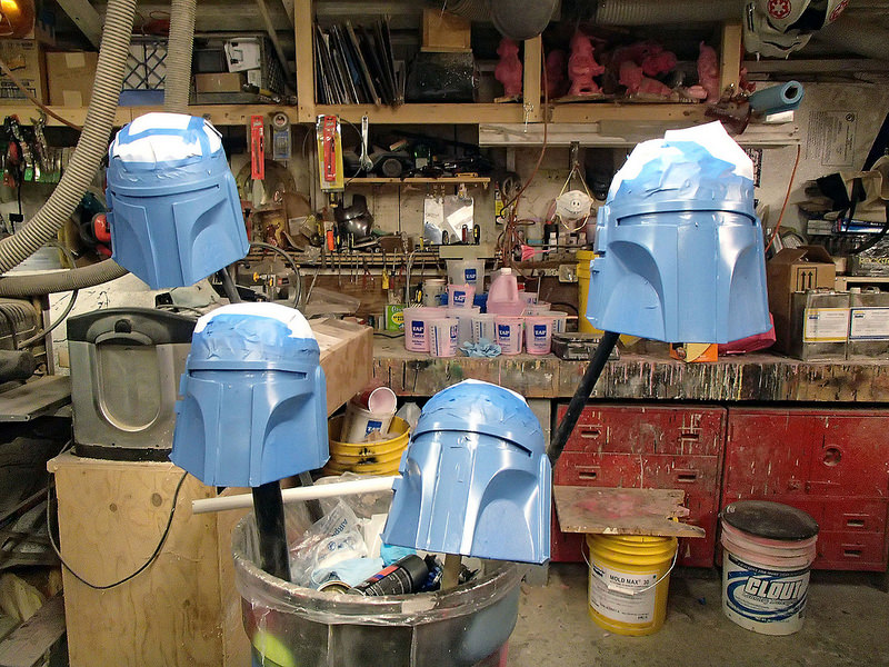

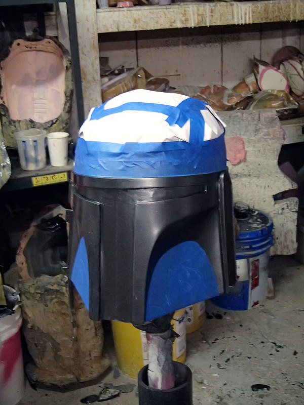

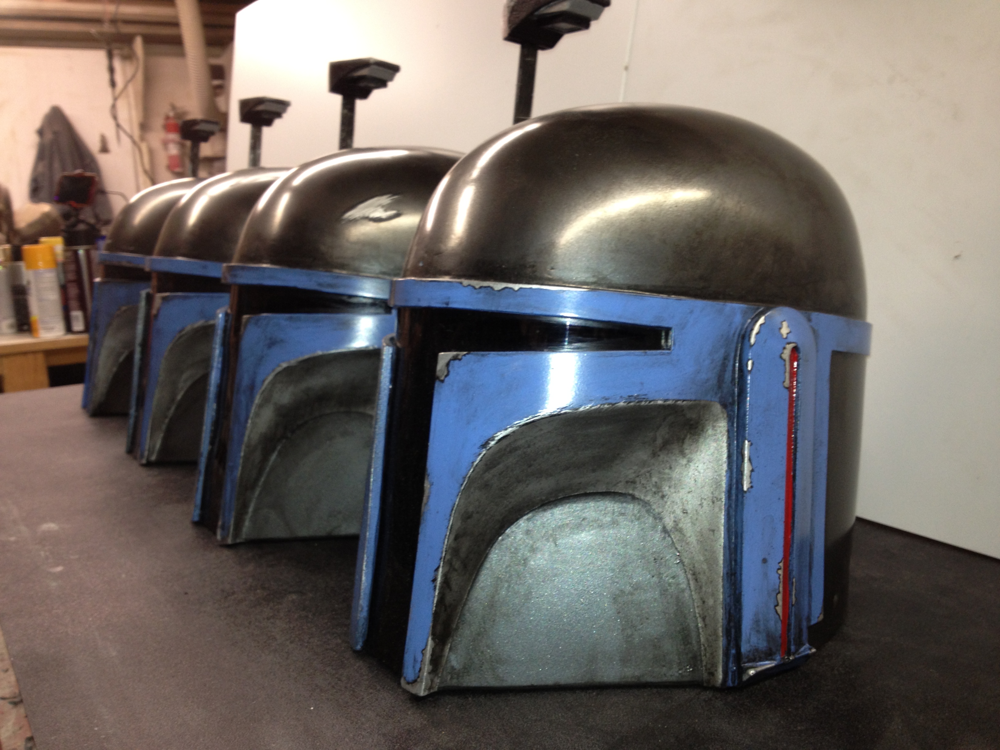

Did some masking last night:
Then made the blue parts blue:
Matt was there, but he hasn't posted pics yet. Today I'll probably do more masking and spray the cheekbone areas.

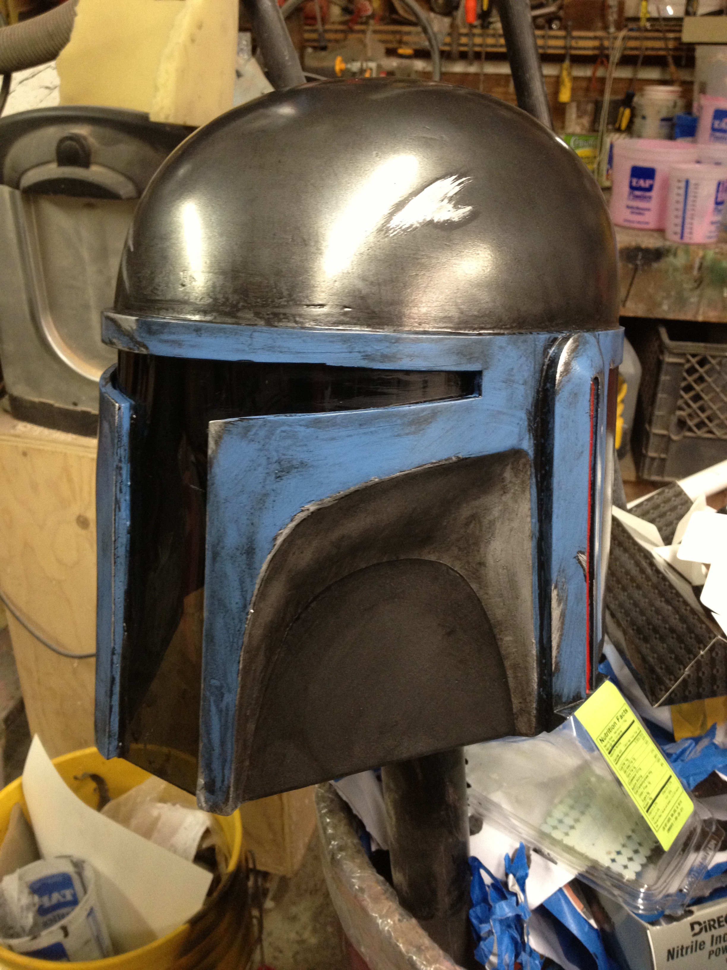

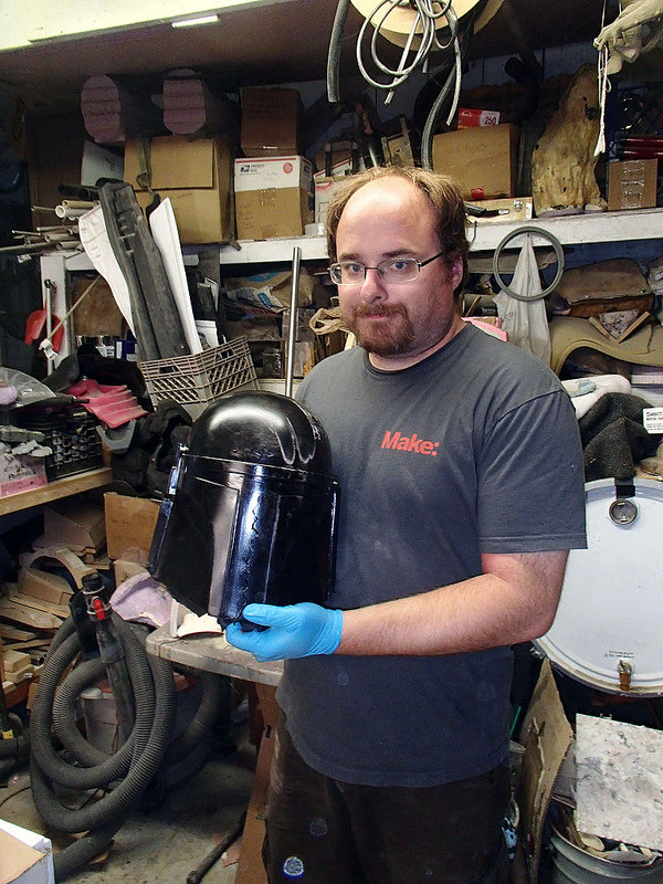

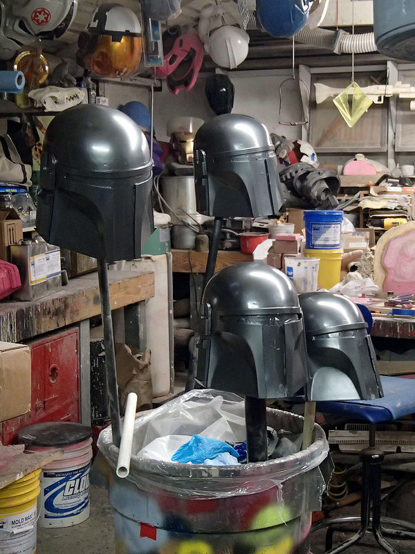

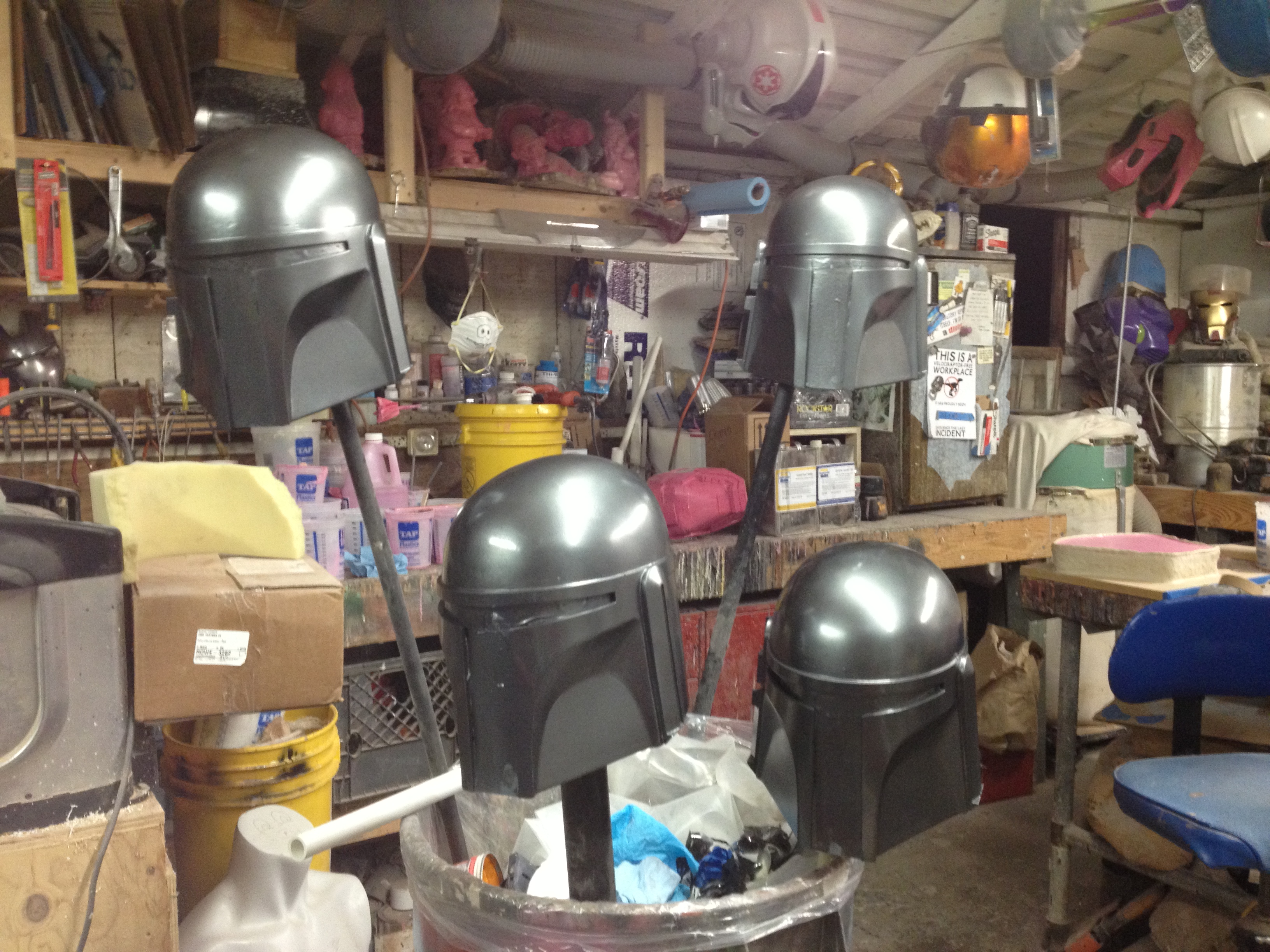

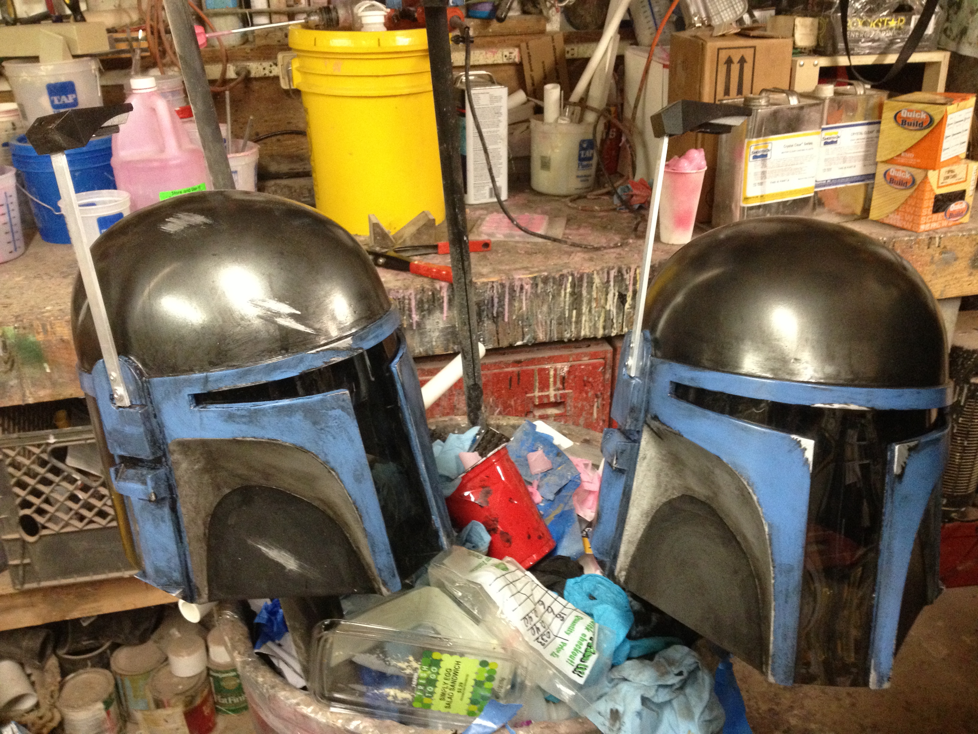

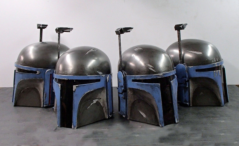

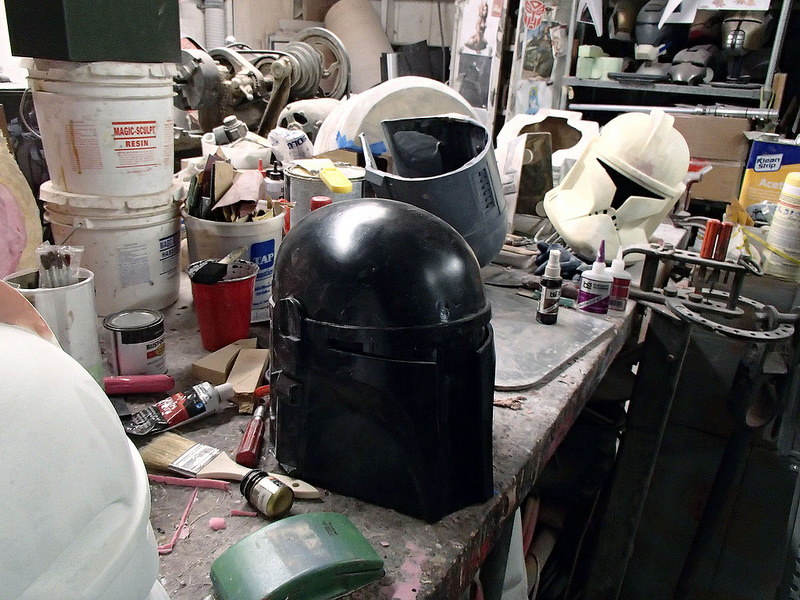

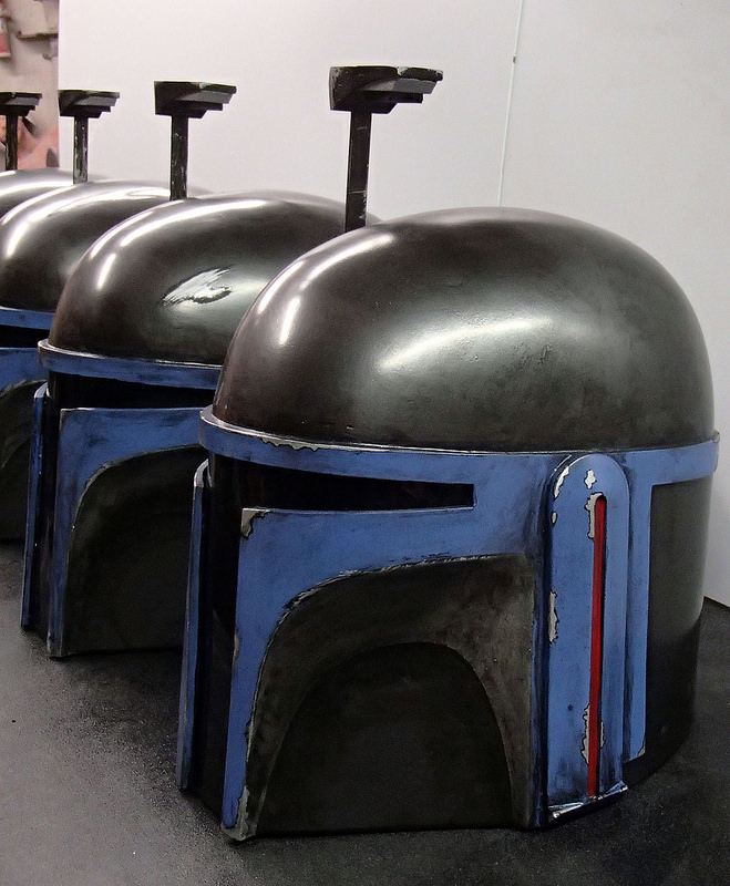

And we have helmets! Shawn and I got some more work done last night and even tonight. The helmets are black washed and weathered. The range finders are installed and its now time to start something new for this project... but enjoy the pictures for now:
These things always look like a bad action figure paint job to me before they get some dirt on them...
Not so toy-like anymore.
Weathering nearing completion.
Not too shabby if I say so myself.

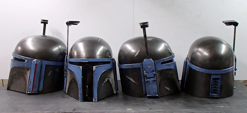

Makes a pretty nice line up.

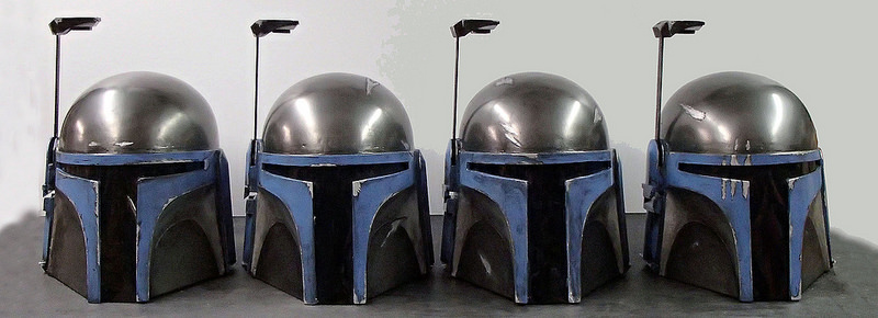

They look alright, but what they really need is bigger pictures (clickable for huger versions):
That's better.
We may eventually get to the epic phase, but let's first see if we can get a dozen or so guys dressed in the finished armor first... I should also mention that these are supposed to be the easy and comfortable costumes for the event, and we'll likely only wear them for one day. We need to get these finished up soon so we can work on the hard stuff...

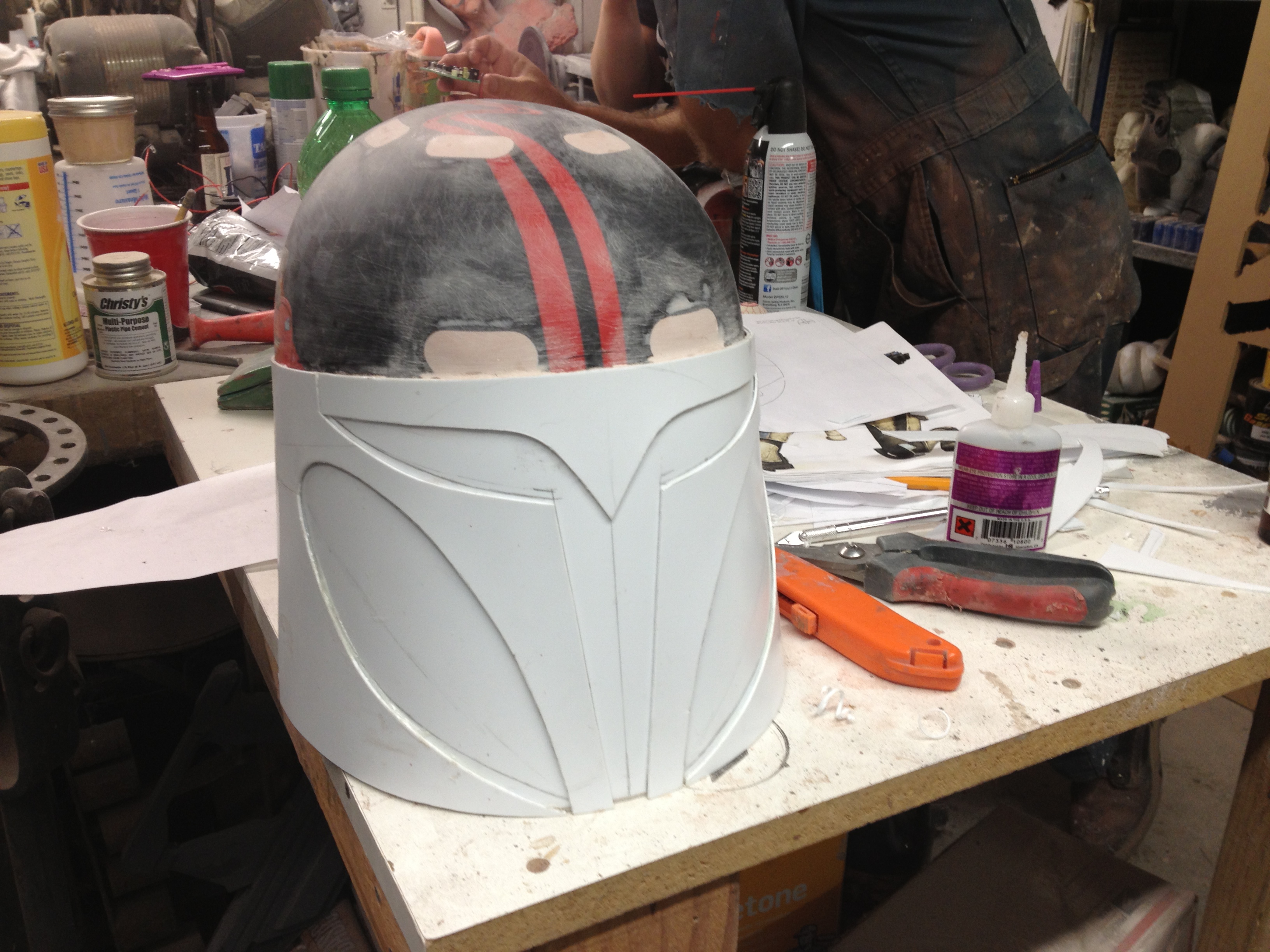

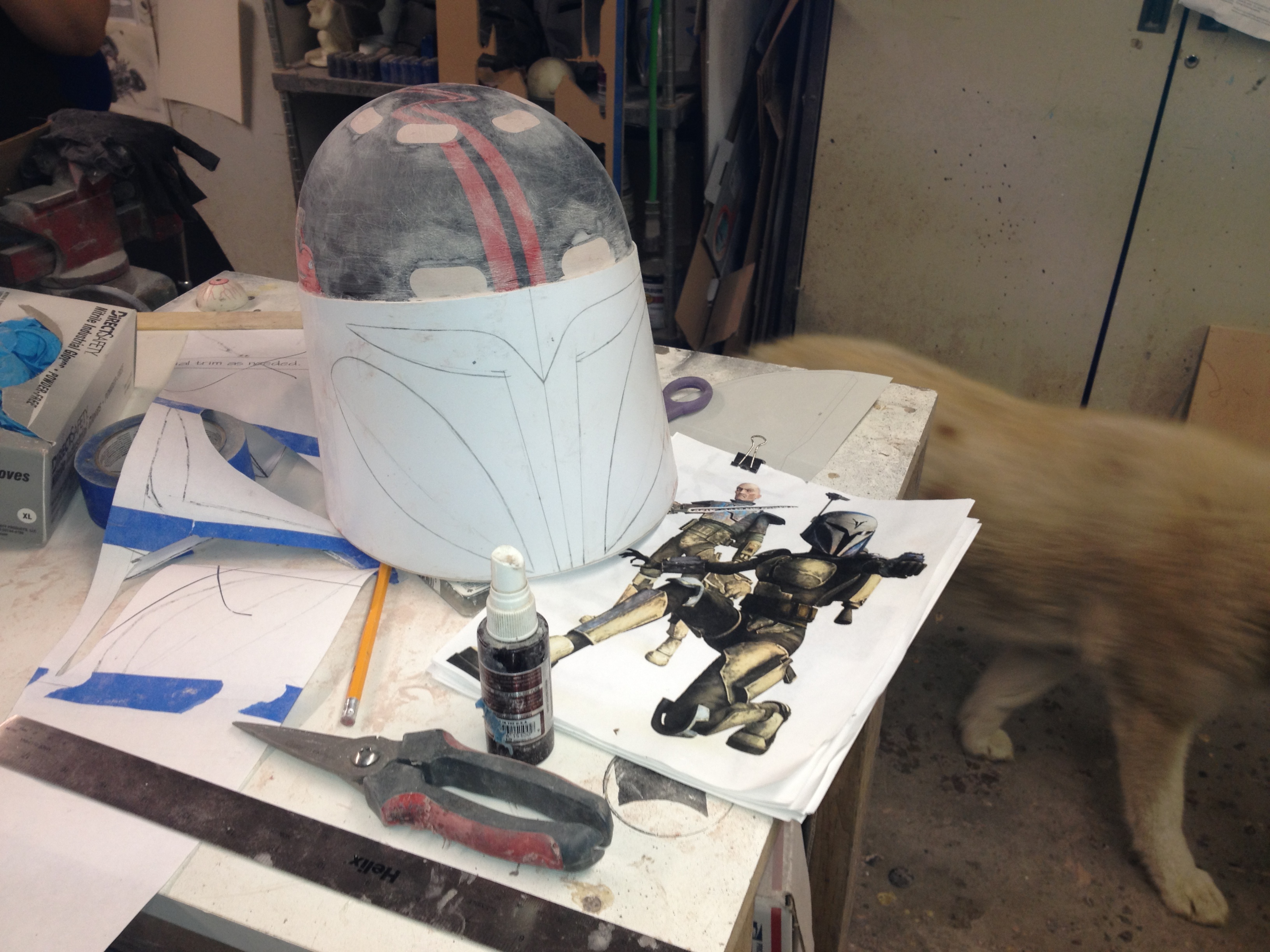

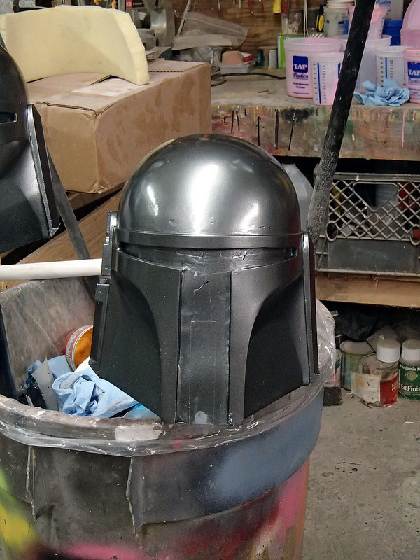

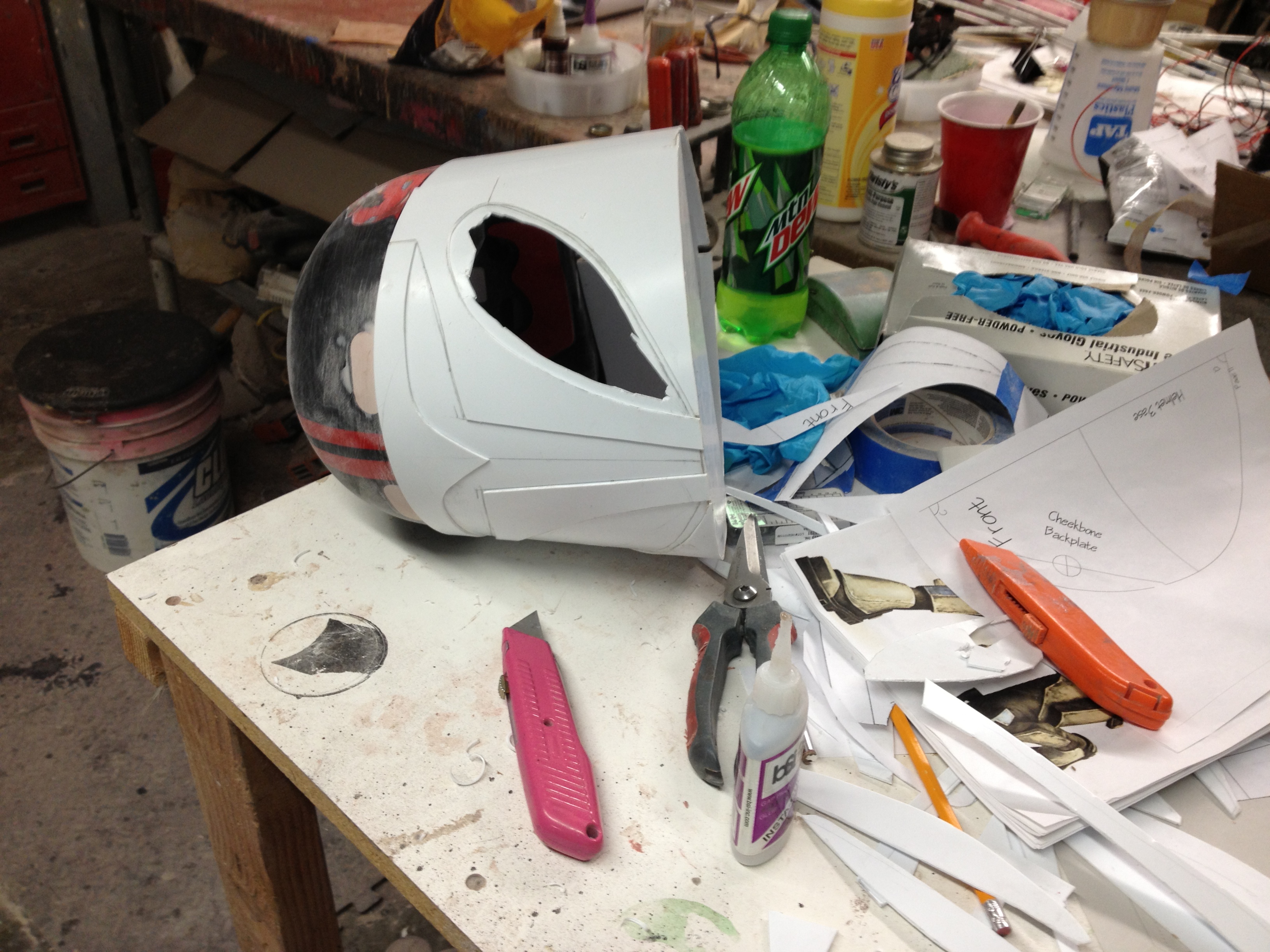

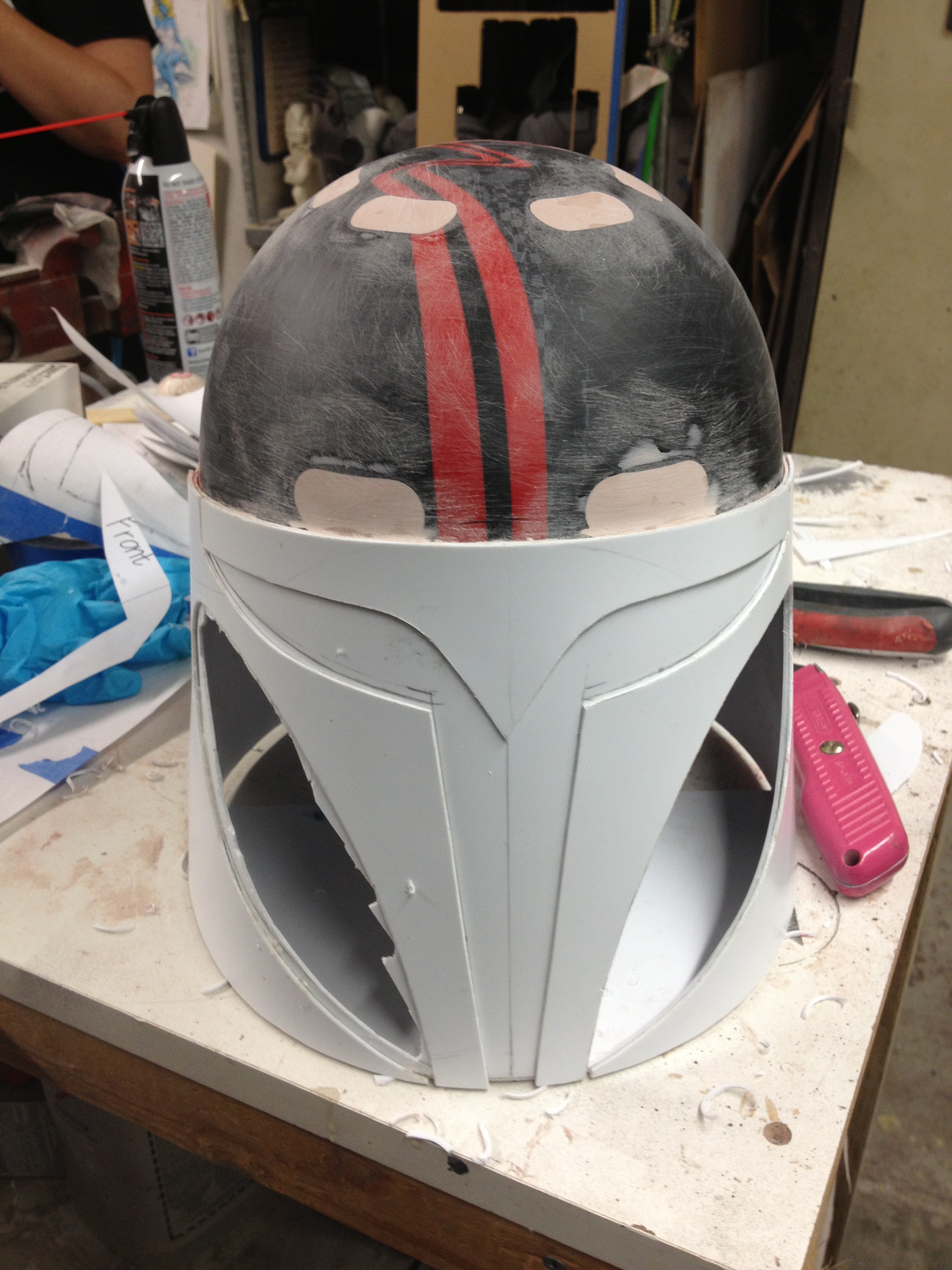

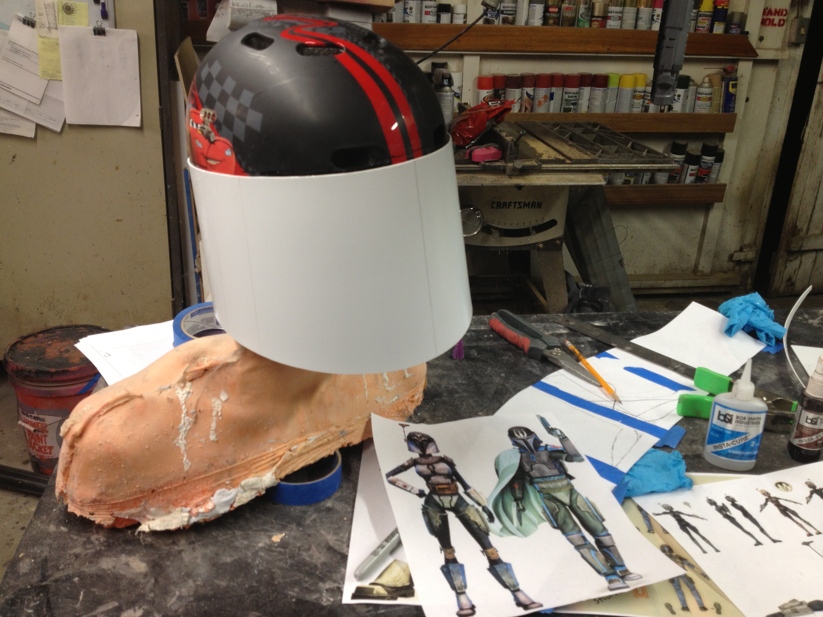

Made some good progress on the night owl helmet tonight. Its pretty late so I'll just leave you with some pictures:
Finalized the lines for the helmet.
Doubled up the styrene to hold the curve.
Started cutting out the cheeks.
Cheeks filled in.
I hope to have it ready for molding sometime next week. As I've said before, I'm aiming for a movie version of this helmet, so I plan on deviating a bit from how it is drawn in the series.
