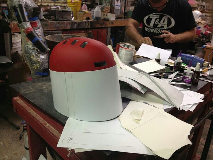

I'm new to the Dented Helmet, but I figured it was time to start posting some stuff. My wonderful wife has agreed to going to Star Wars Celebration with me next year (it really didn't take too much to talk her into this) and our goal is to have a set of his and hers Death Watch armor. While this is not a huge undertaking when you figure we have eight months to get everything ready. I've decided to build everything from scratch. The good thing is, I've built some costumes before and have some great friends to help.
This being said, here are my progress pictures from Day 1:
f58689085137719c6c65915f3a4614ec.jpga2e59169b2b46925568c20113e51d55f.jpg59b225deb3ed6e917d0ae1f8f2c2e51c.jpg1c6b7f4f10da6188eef19e51f94ebd67.jpg35e2dcbefe733b3278e74722b39b6e54.jpg

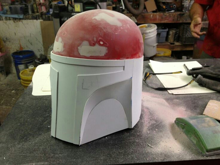

I figured a kid's bicycle helmet would work for the dome. Im not sure if anyone else has tried this.

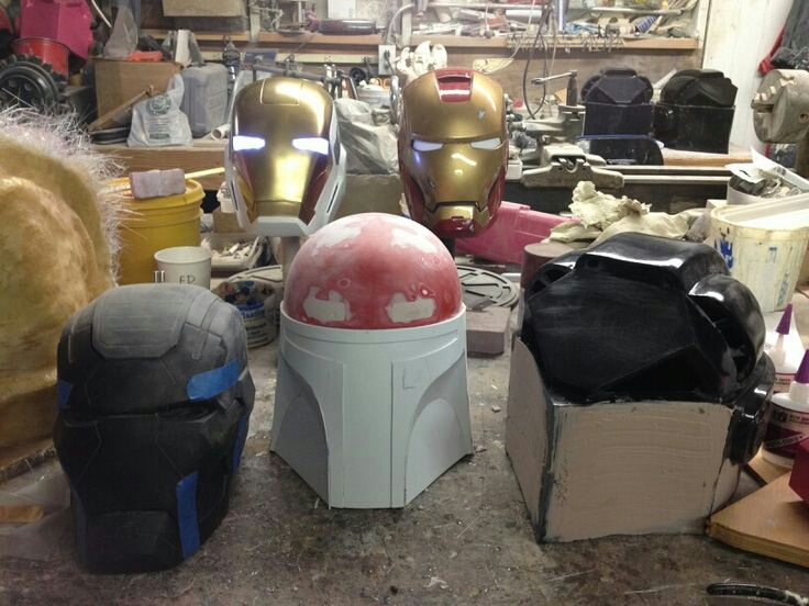

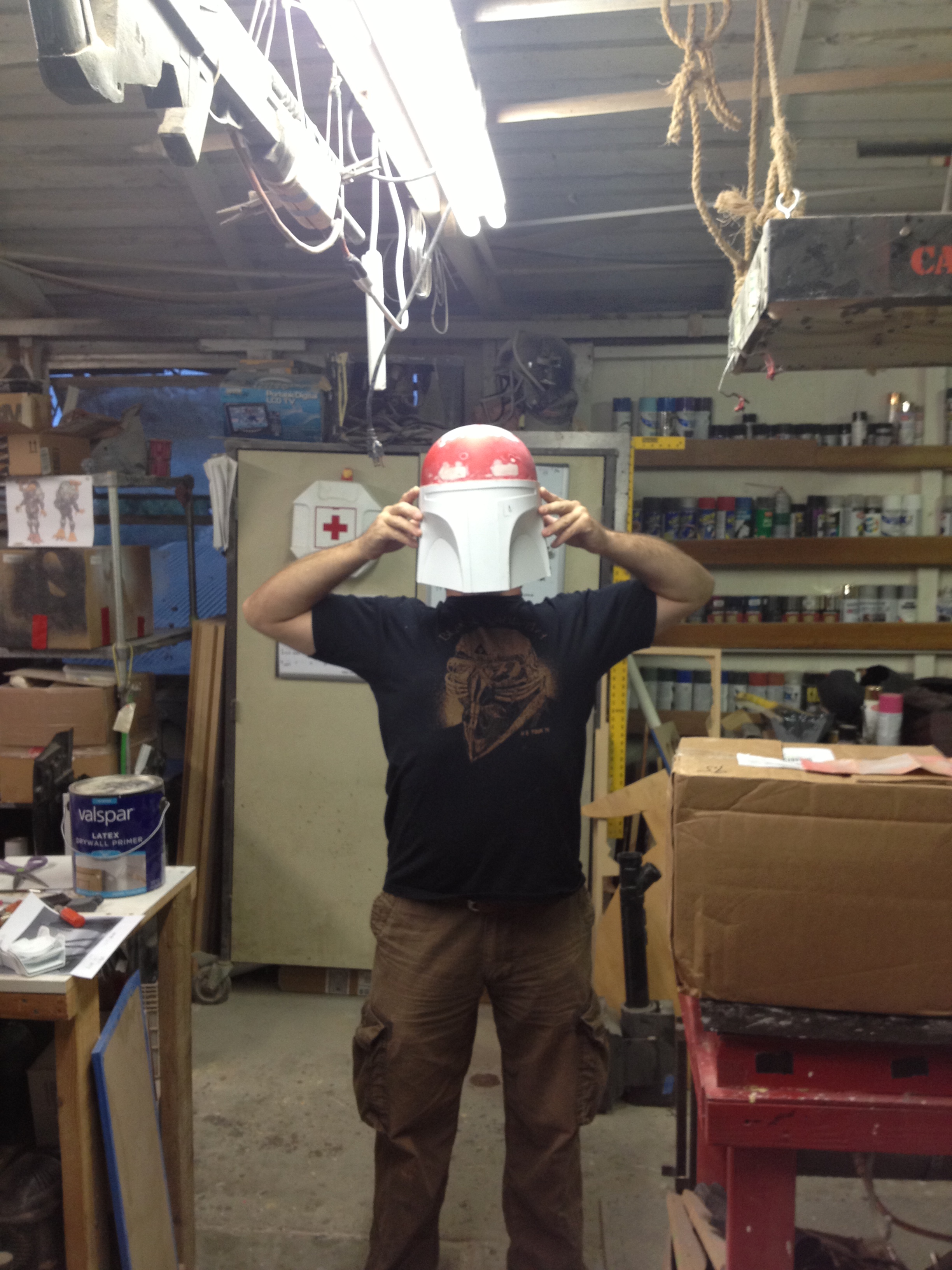

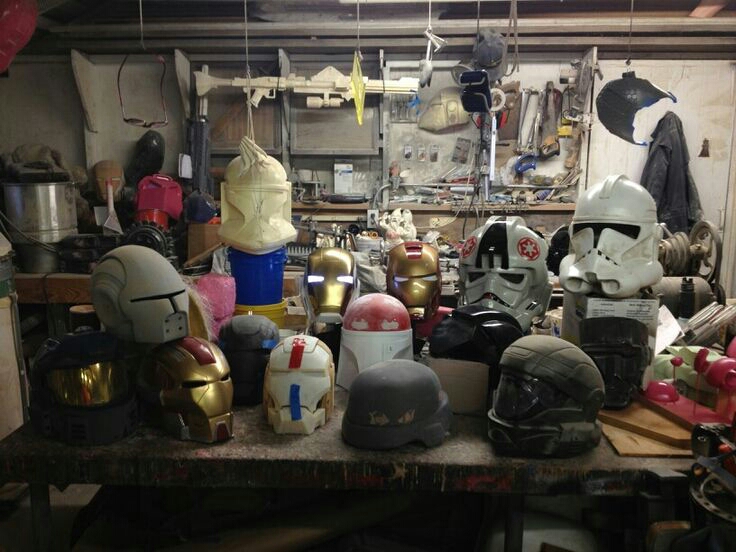

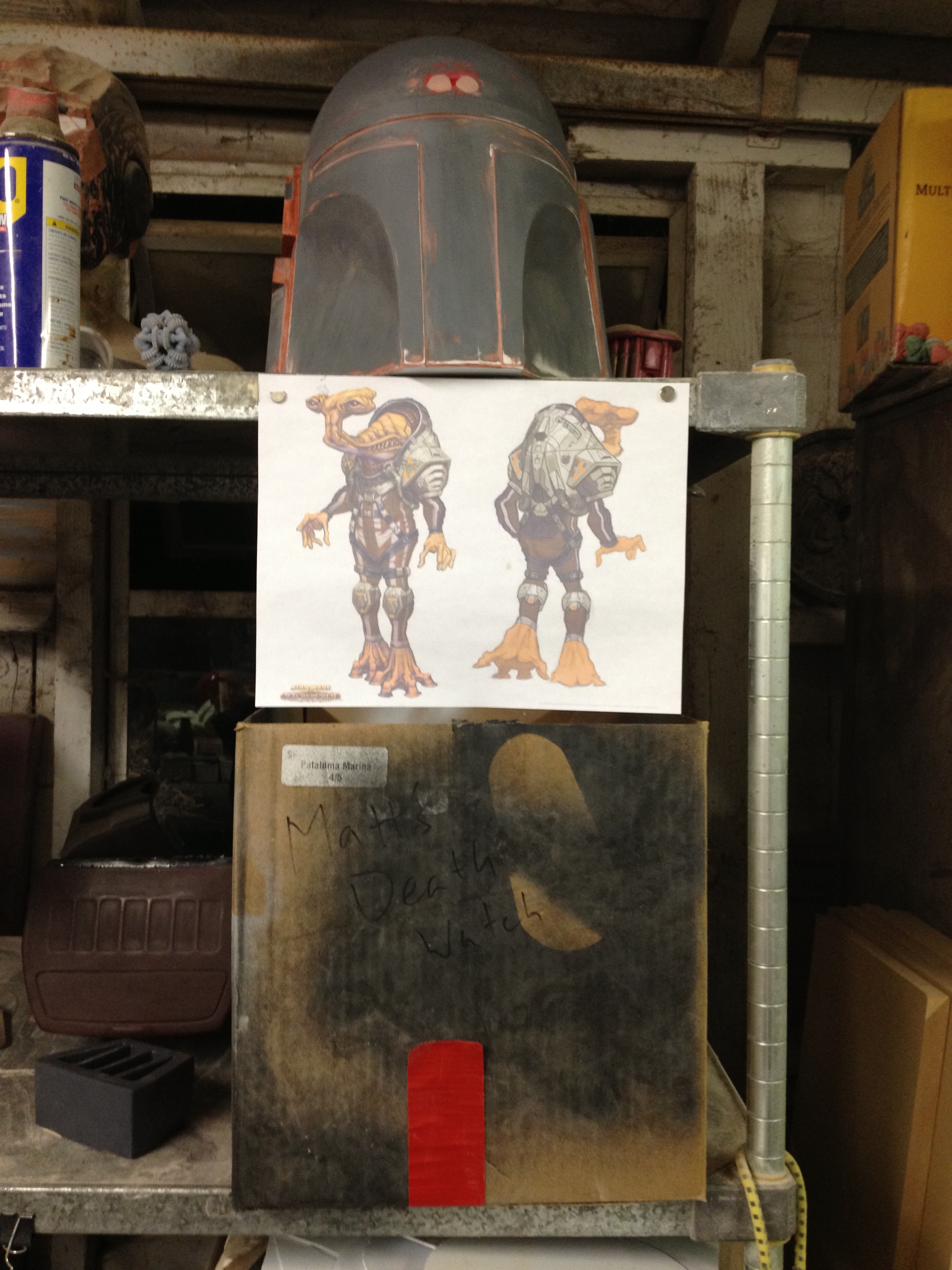

I was feeling pretty good about my progress, but my friend Shawn said we should take a picture of my helmet with a few of the helmets he's working:
But then he said he needed to add a few more helmets:
... but then apparently he was still missing a few:
I think my helmet's still in this picture...

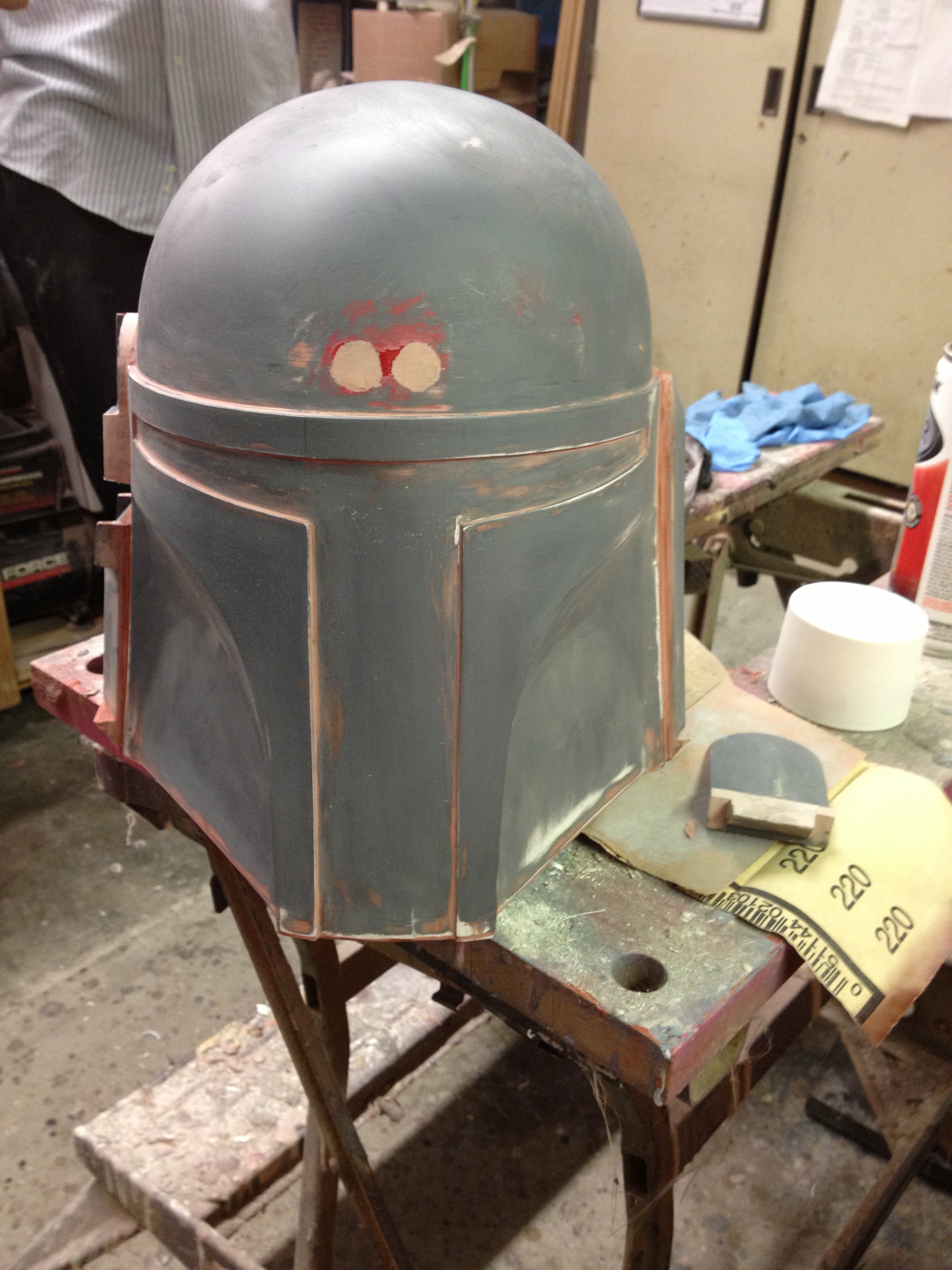

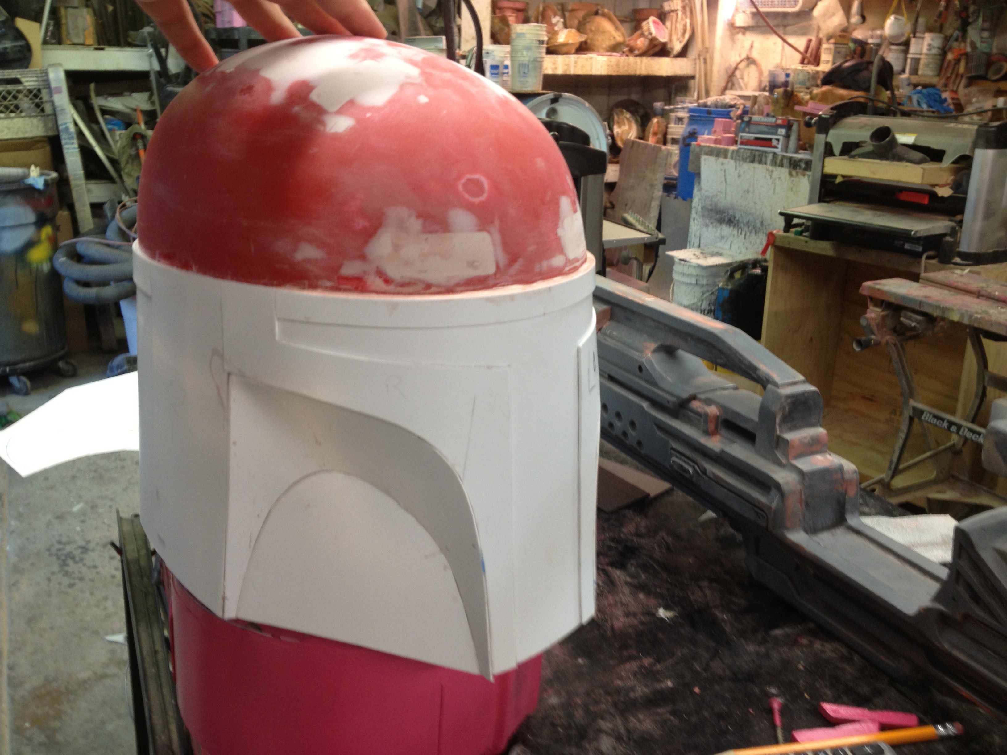

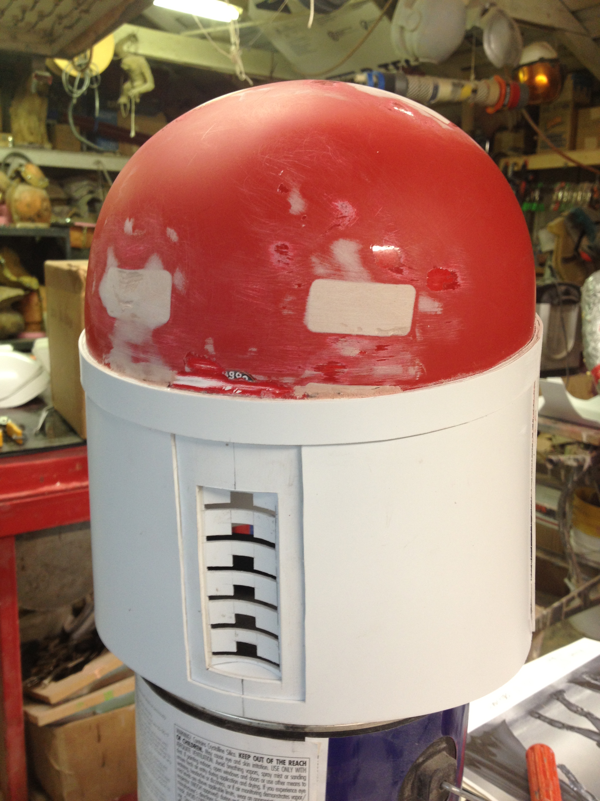

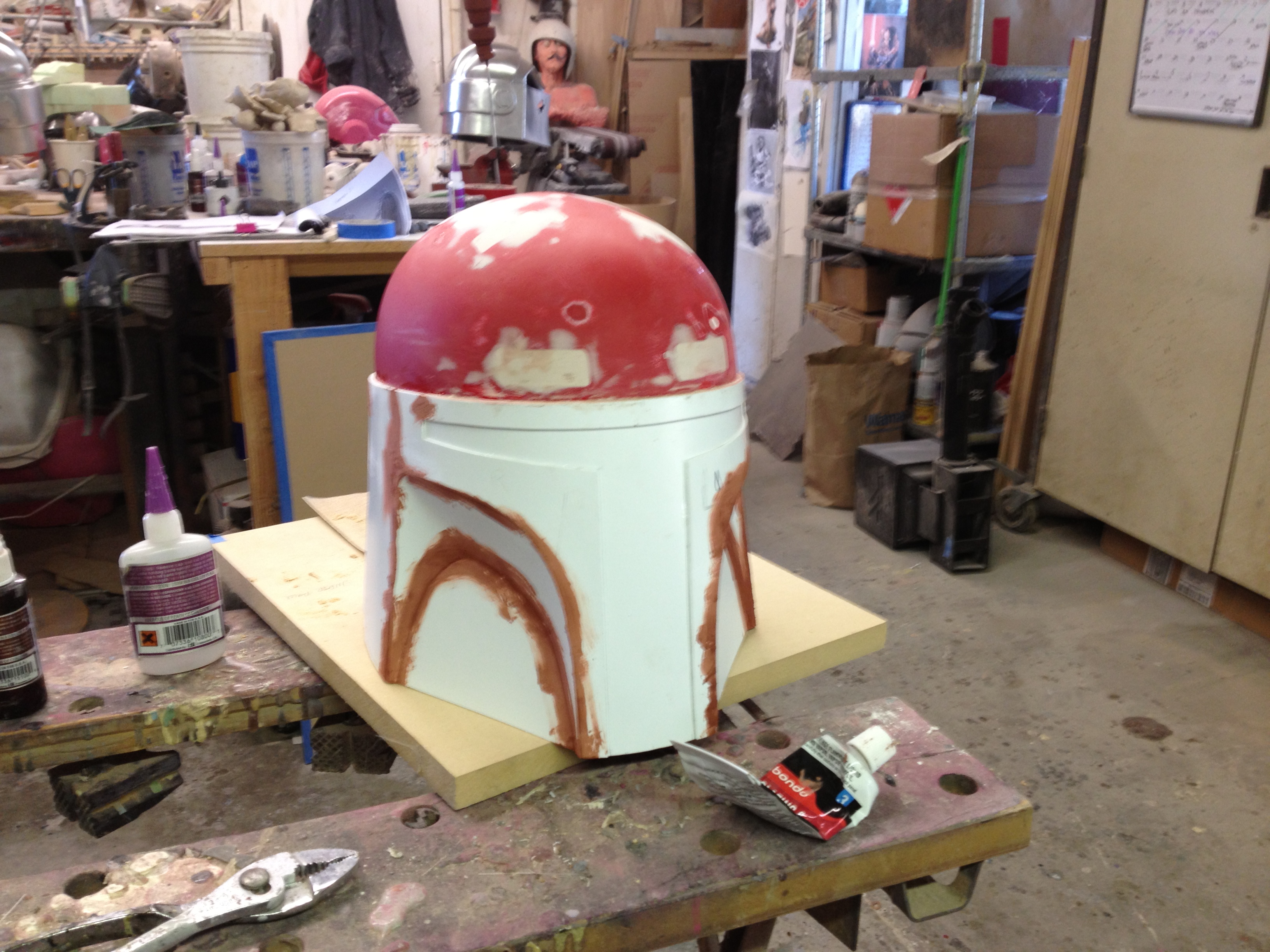

Sanded some more of the Bondo down.

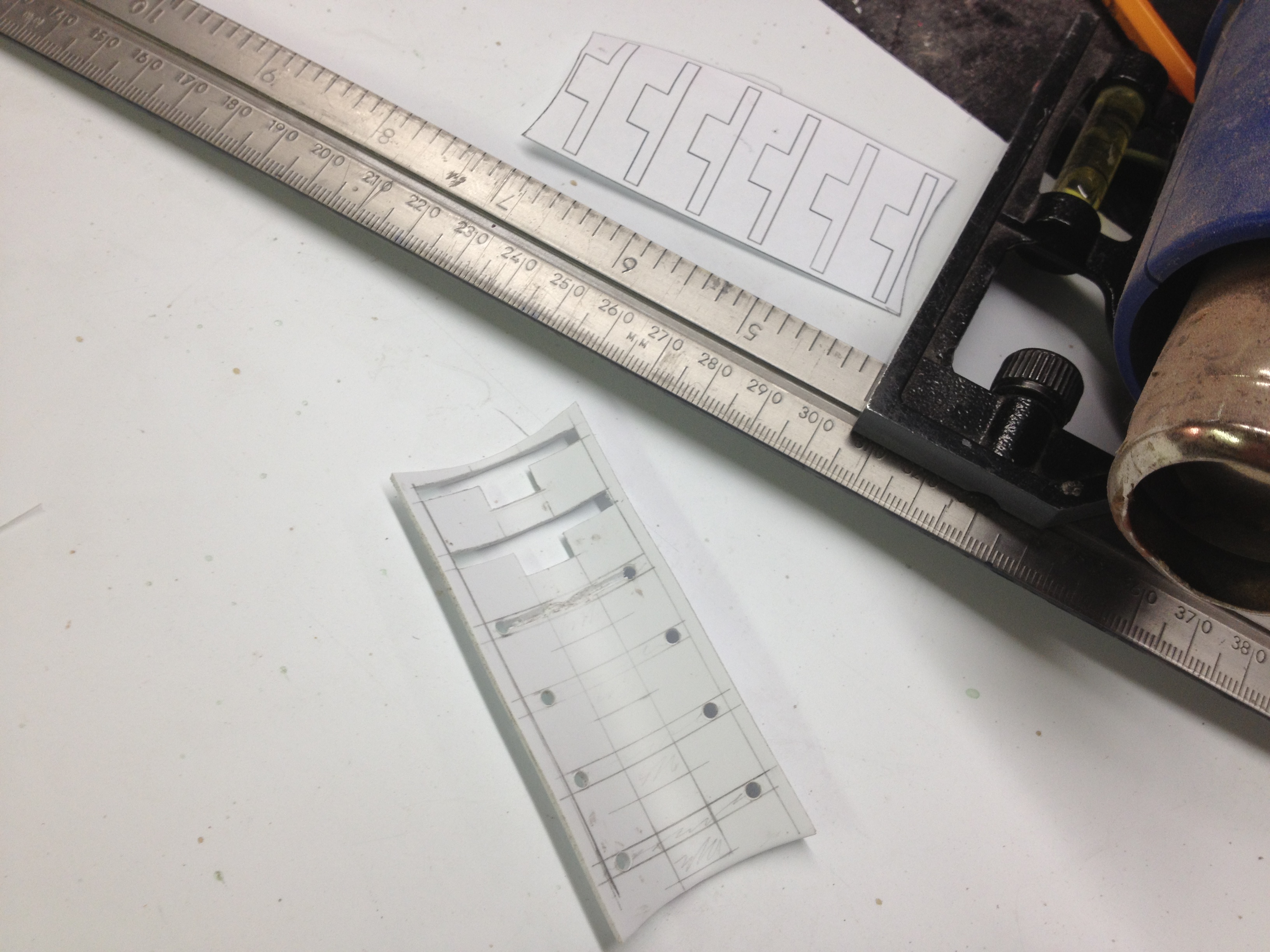

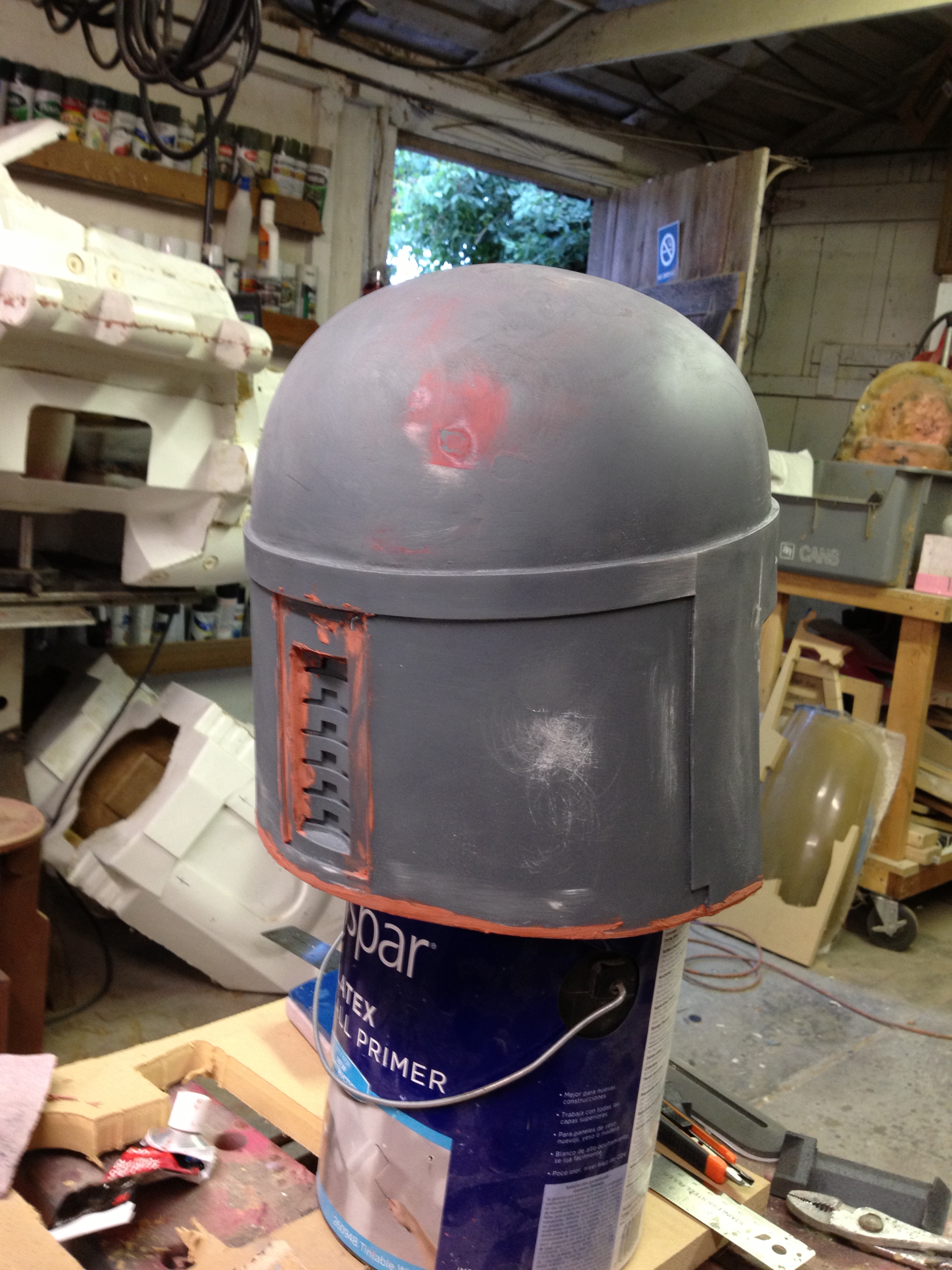

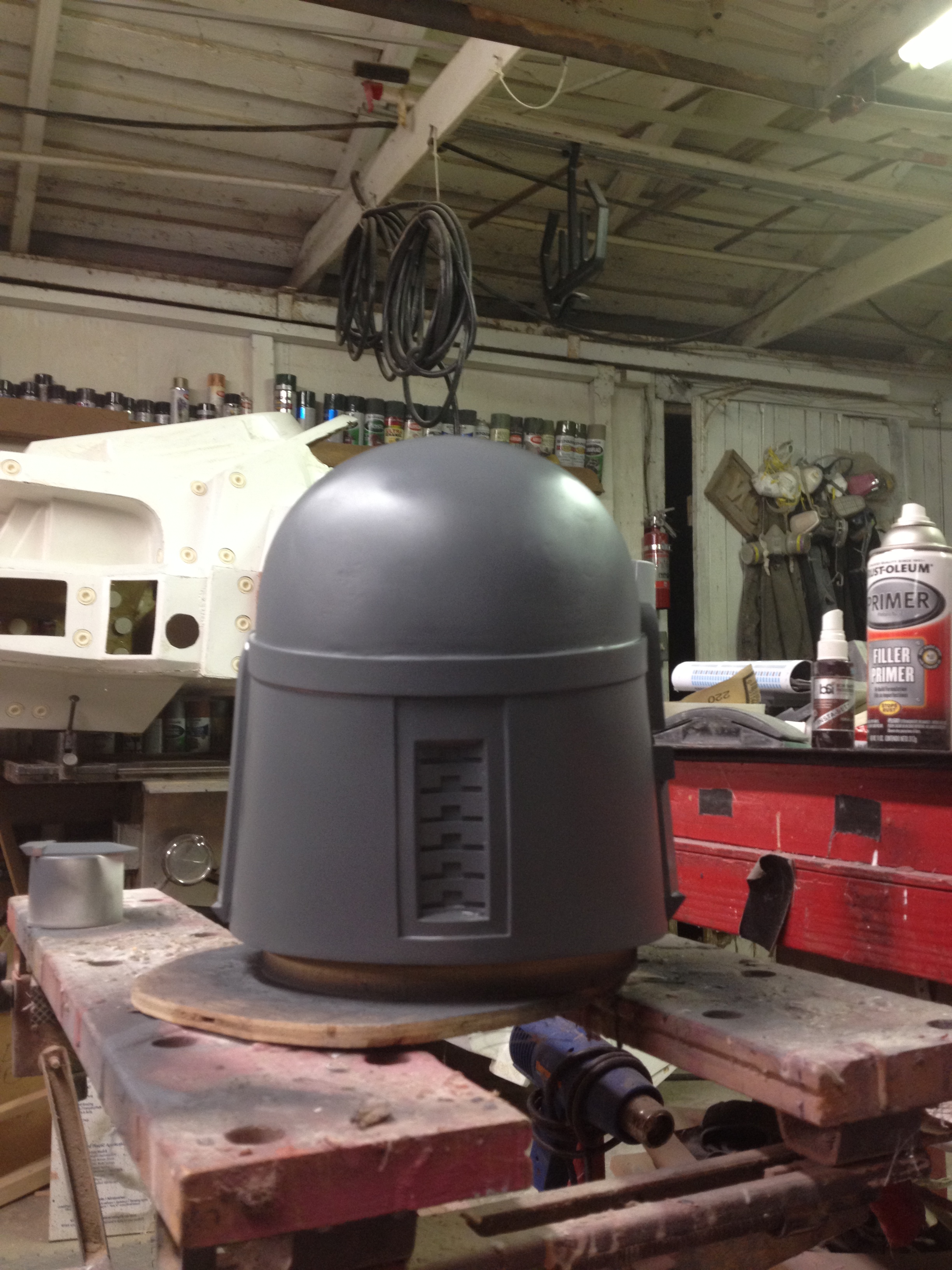

Started on the slots for the back of the helmet.
Still working on the slots. (These will take longer than the rest of the helmet.)
Got the slots done, time to call it a night.

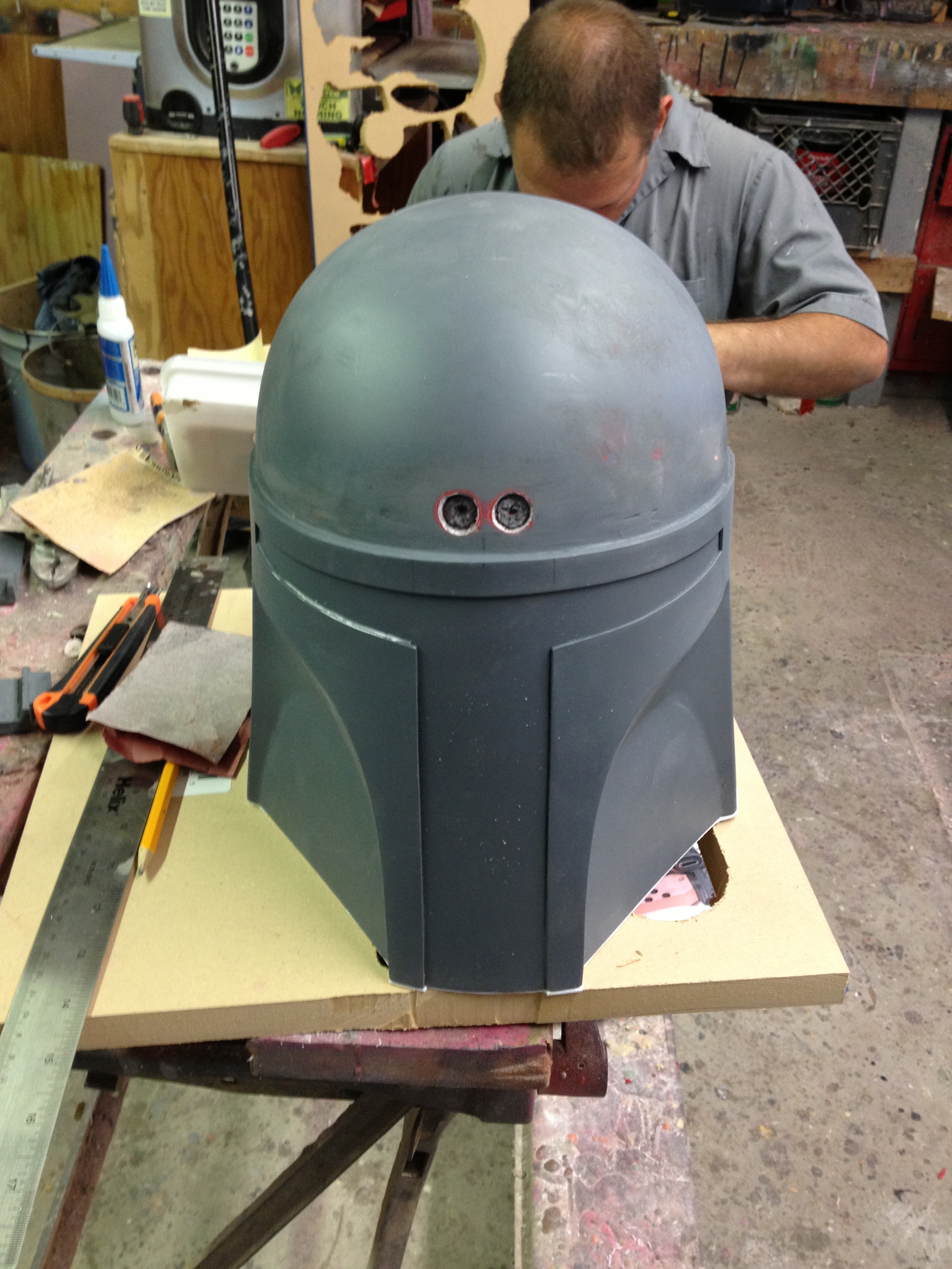

The helmet is really starting to come together.
My friend Shawn test fitting the helmet.

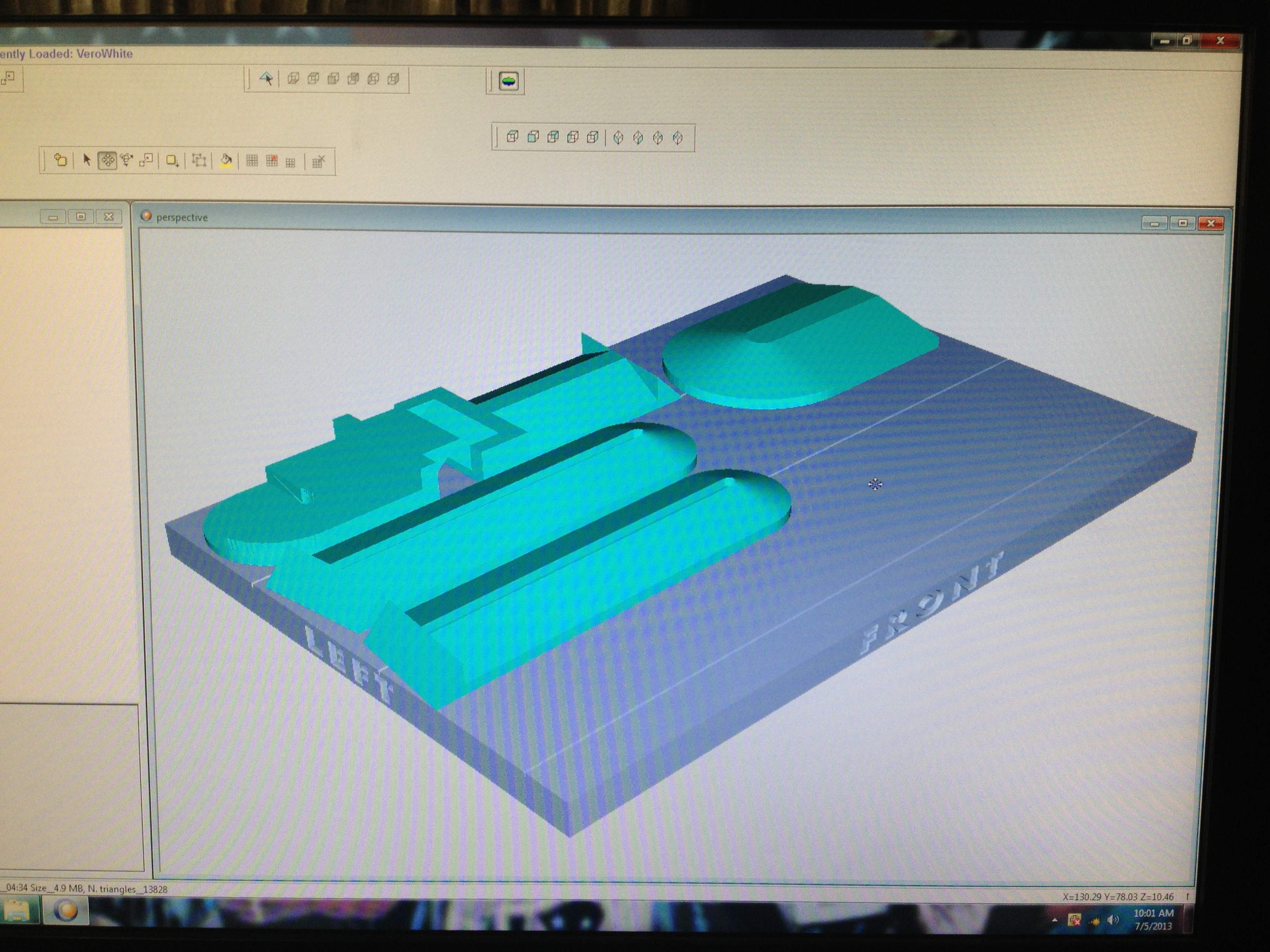

I'm not sure why, but I felt this build needed something digital in it. While I assume that I could have found all kinds of 3D files on the internet (it's a magical pace) but I thought it better to dust off my computer and polish up my modeling skills. It may be worth mentioning that the last time I did any 3D modeling was with AutoCAD Release 10... Needless to say, it took a bit longer than it should have. Regardless of the journey, I was pleased with the results:

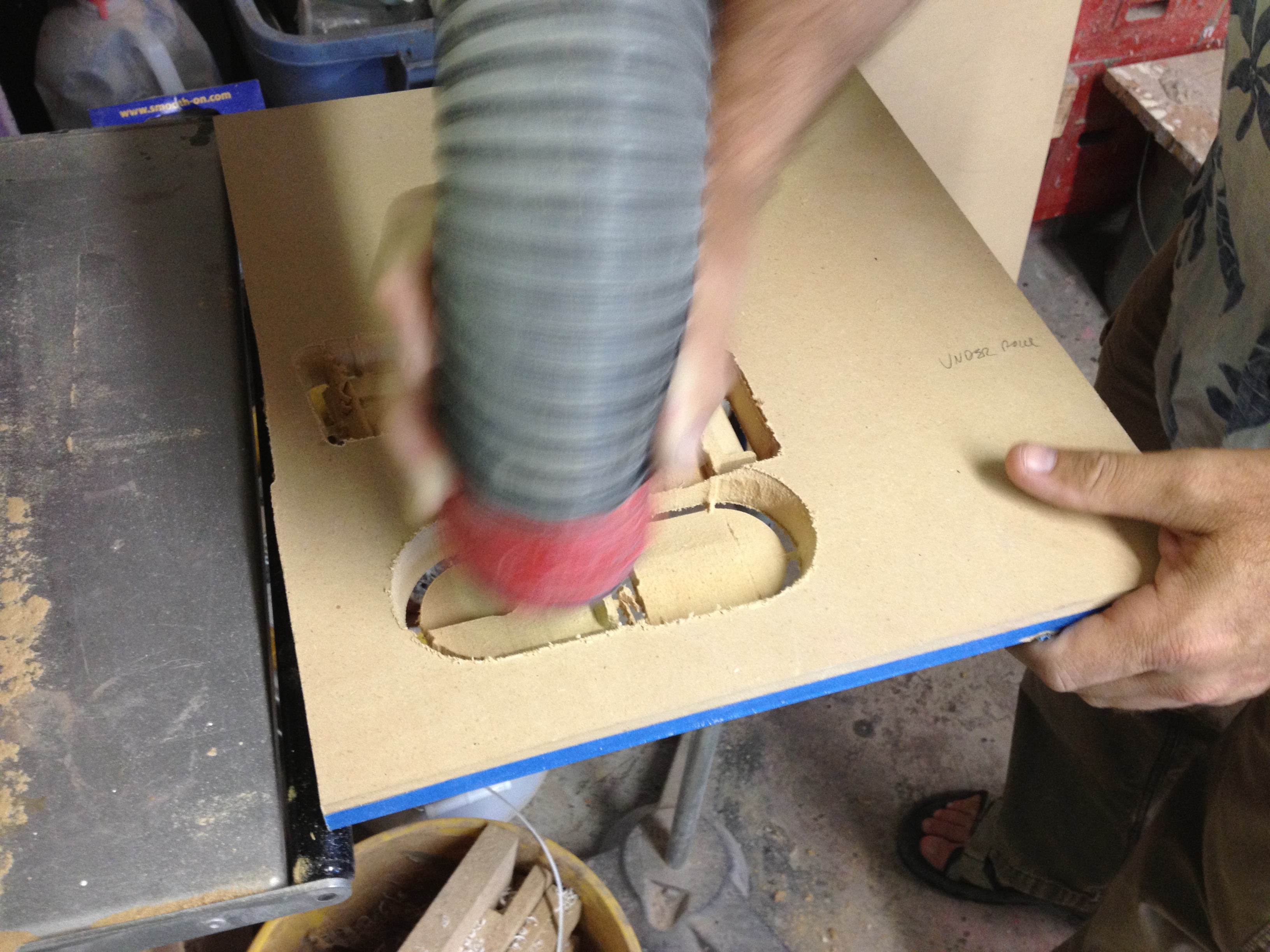

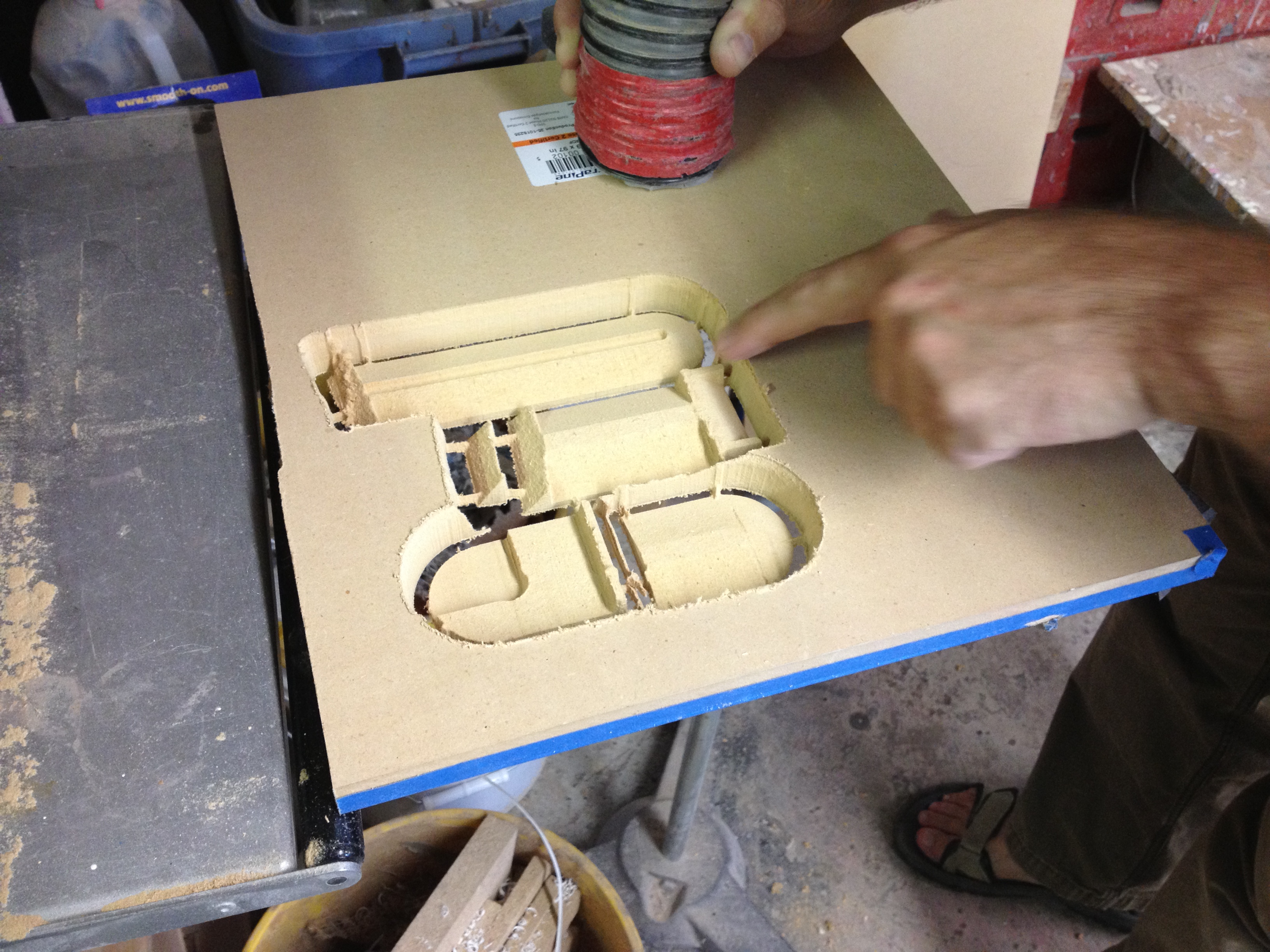

I got an early start this morning and met up with my friend Shawn. He tinkers in his makeshift workshop from time to time (more like 12 to 16 hours every day) and happens to have a CNC machine that made up my parts.
Day Five Pictures:
Day Five 1-9.JPGDay Five 2-9.JPGDay Five 3-9.JPGDay Five 4-9.JPGDay Five 5-9.JPGDay Five 6-9.JPGDay Five 7-9.JPGDay Five 8-9.JPGDay Five 9-9.JPG

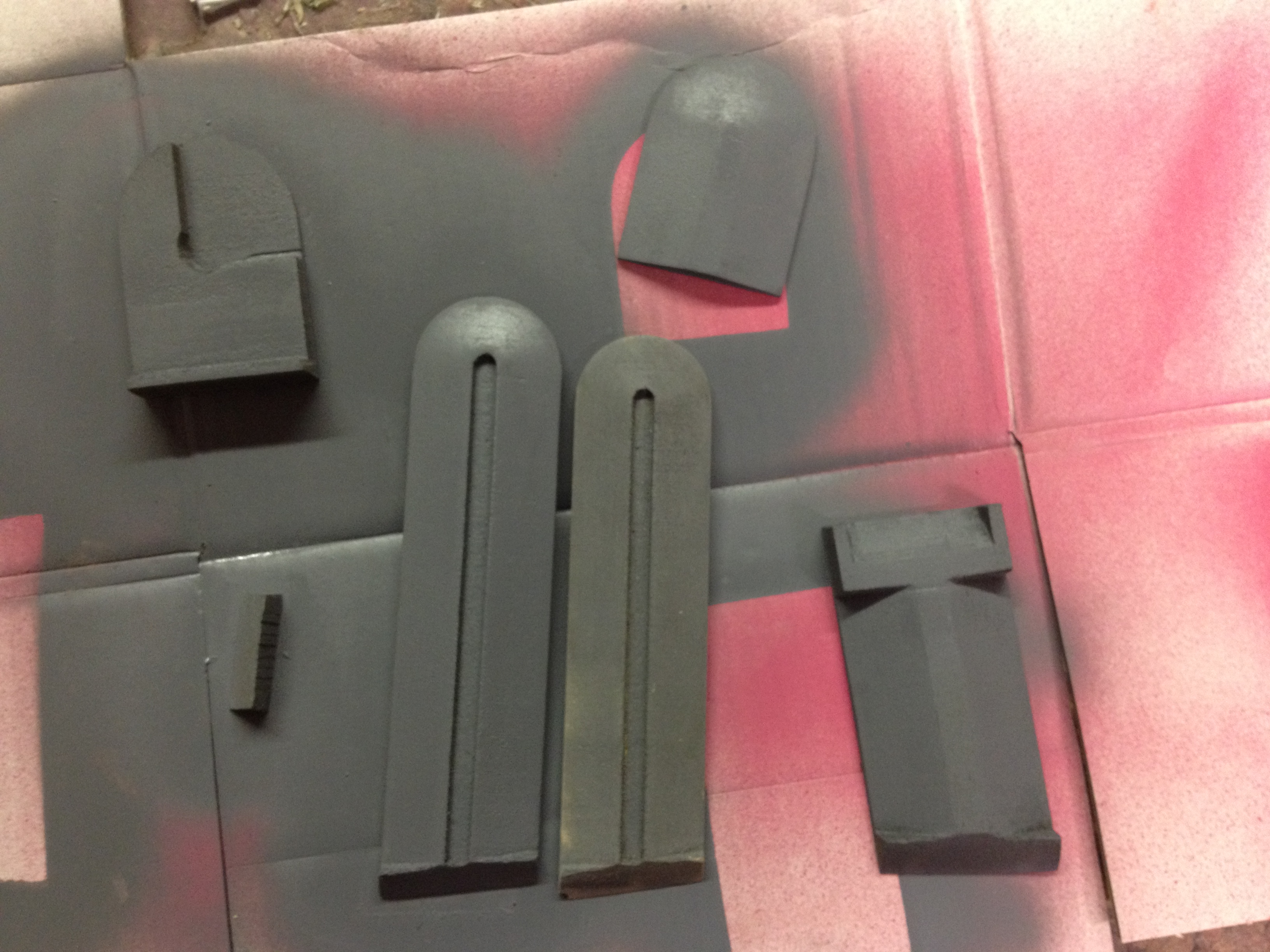

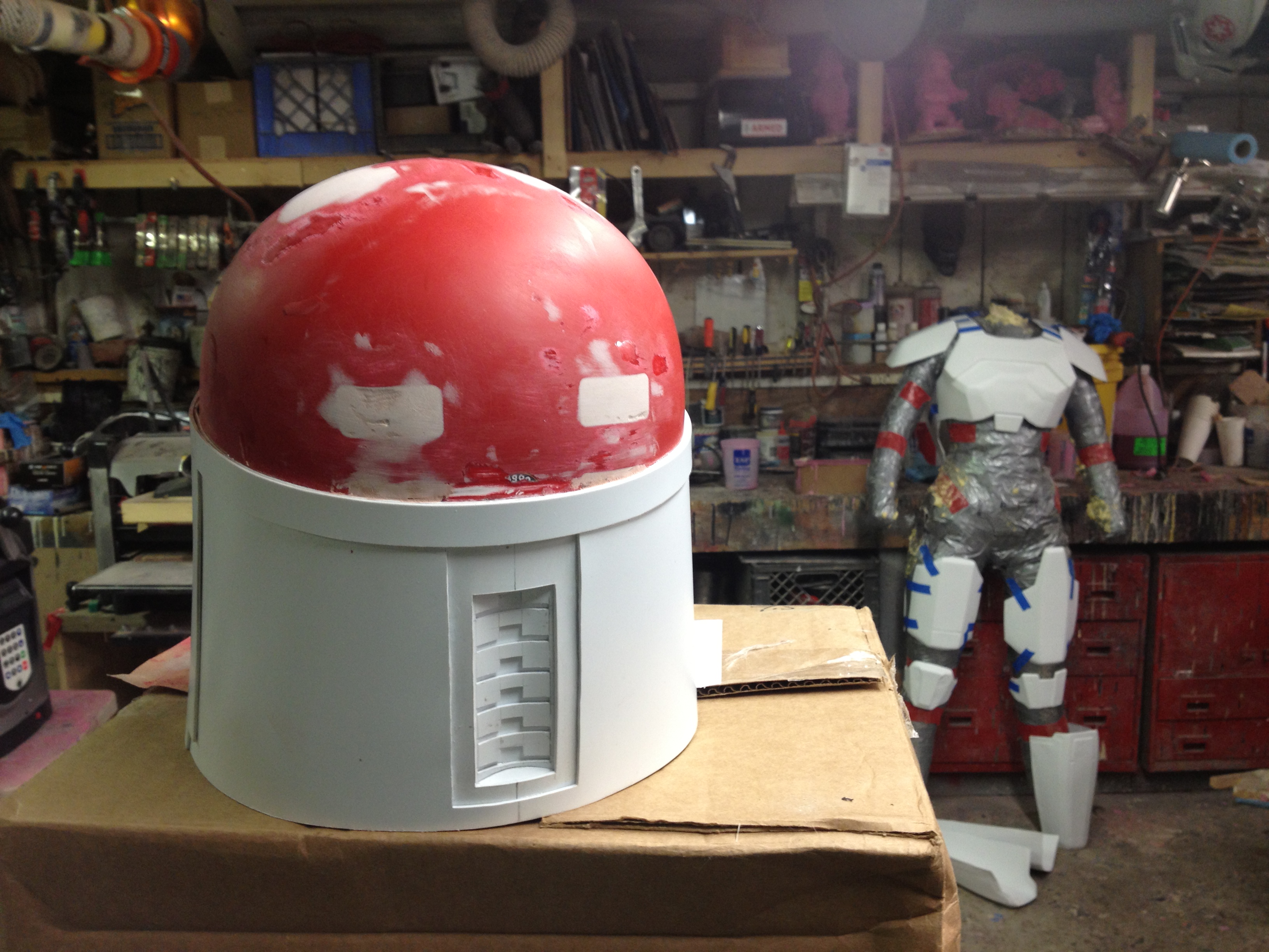

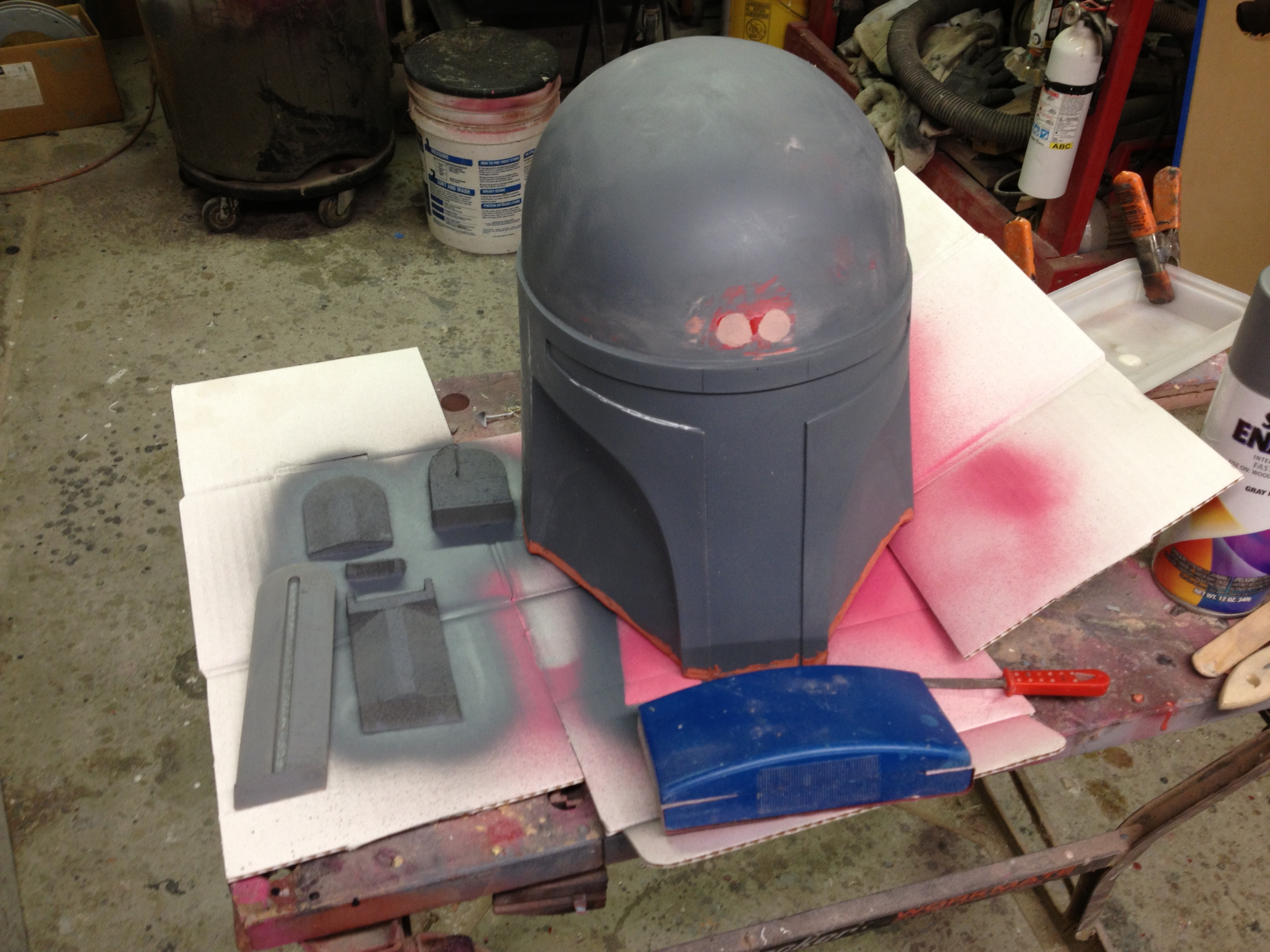

I found a bit more time today to continue work on the helmet. The ear pieces that I cut out yesterday were too small, so my friend Shawn cut some more out this morning. I got these sanded down a bit and sprayed more primer on them. I also got some more finish sanding done on the helmet. I find it hard sometimes to know how done is done when preparing a piece for molding, but since I need to cast at least six of these, its worth the time now to get it just right. On another note, I am quickly approaching the time to start the next part of the build. I'm trying to figure out if it would be best to start the gauntlets or the jet-pack, or the night owl helmet for my wife...

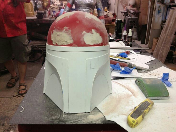

Helmet parts coming together.
You can see the size difference in the left ear piece. I figure I'll save the smaller parts set for the night owl helmet.
Only need to install the ears, cut in the "turn signals", and complete the finish sanding, then I'll be ready to mold.

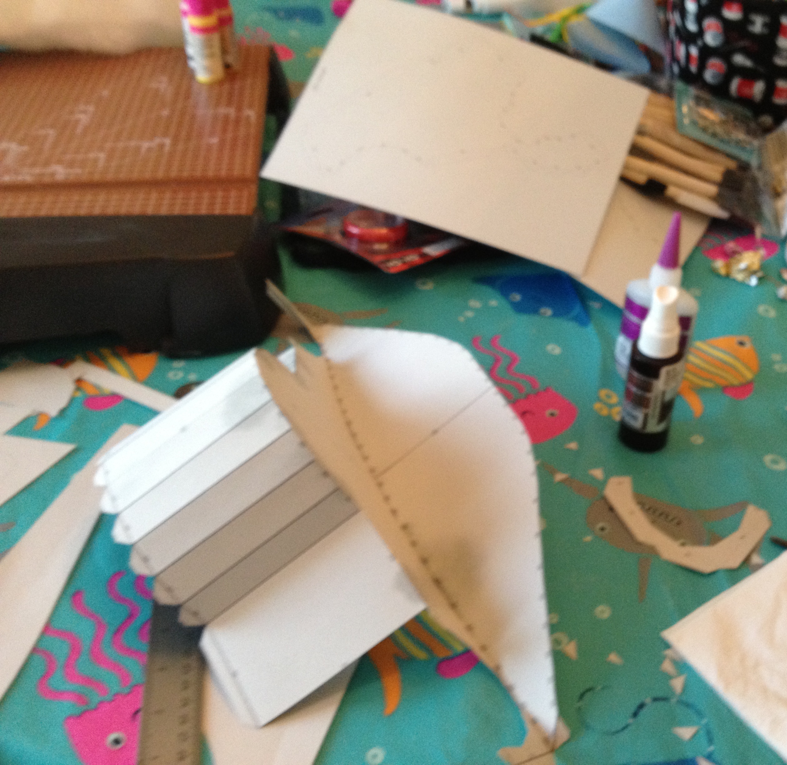

Another day of progress has come and gone. I started a pep build for the arena backpack today. The size seems pretty good, but I didn't find any build threads showing how well this comes together. I guess I didn't really look too hard, but who has time to do that when there is so much stuff to build. I really didn't get too far before jumping ship and heading out to the shop to work on the helmet some more. I'm pretty close to having the helmet done at this point, and should be ready to start molding it this next week.
Here's the jet pack, this may be my weekend project.

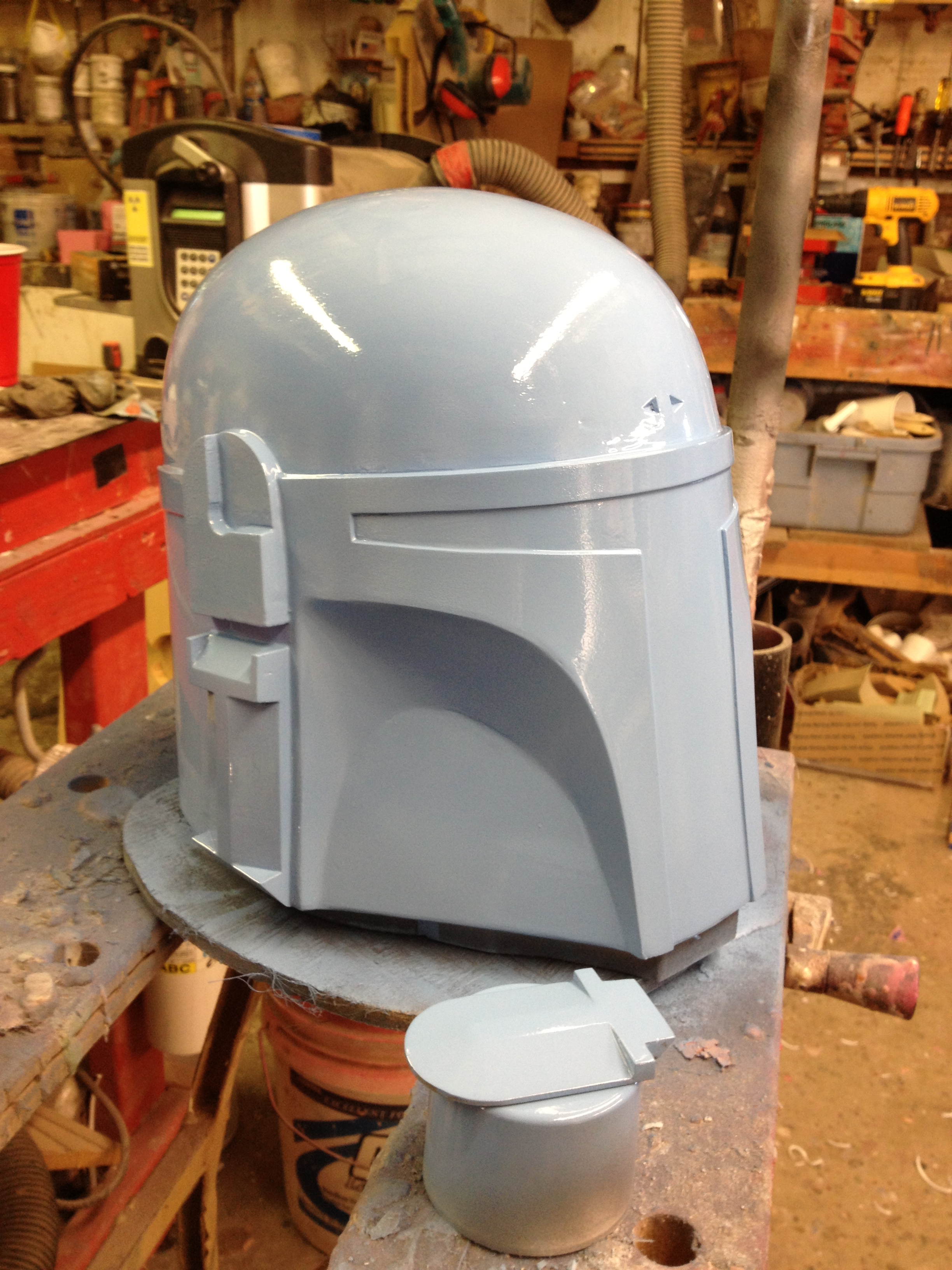

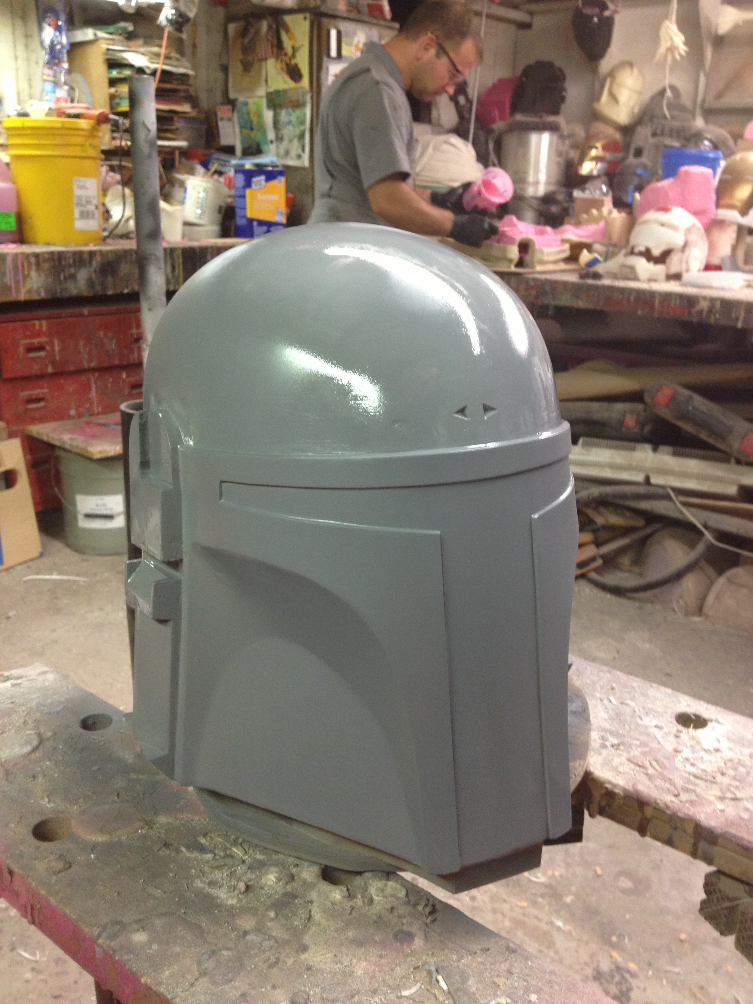

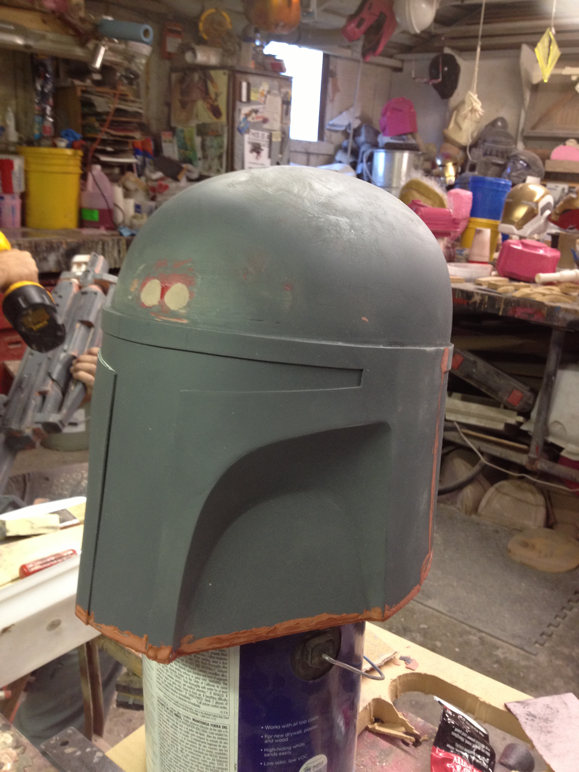

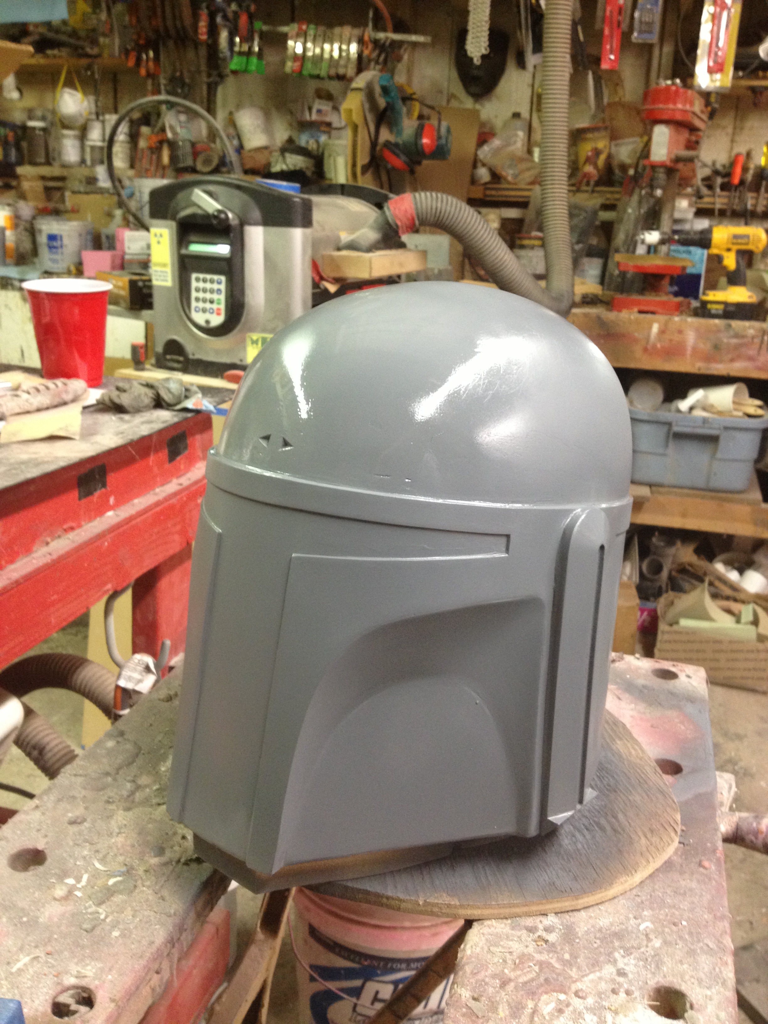

And my helmet is done... almost. I still need to make up the range finder before I can say its really done, but I'm pretty happy with it. I got the "turn signals" cut into the front of the helmet today, finished up the sanding, and got everything put into primer. I figure this weekend I'll give it a coat of some obnoxious color, so long as it is glossy, and get ready to mold it.
Here are day eight progress pictures:
Hurray for turn signals...
Picasso would have been proud.
And here it is all in primer. I had to add the shot from the back as I don't think I posted one of these yet.

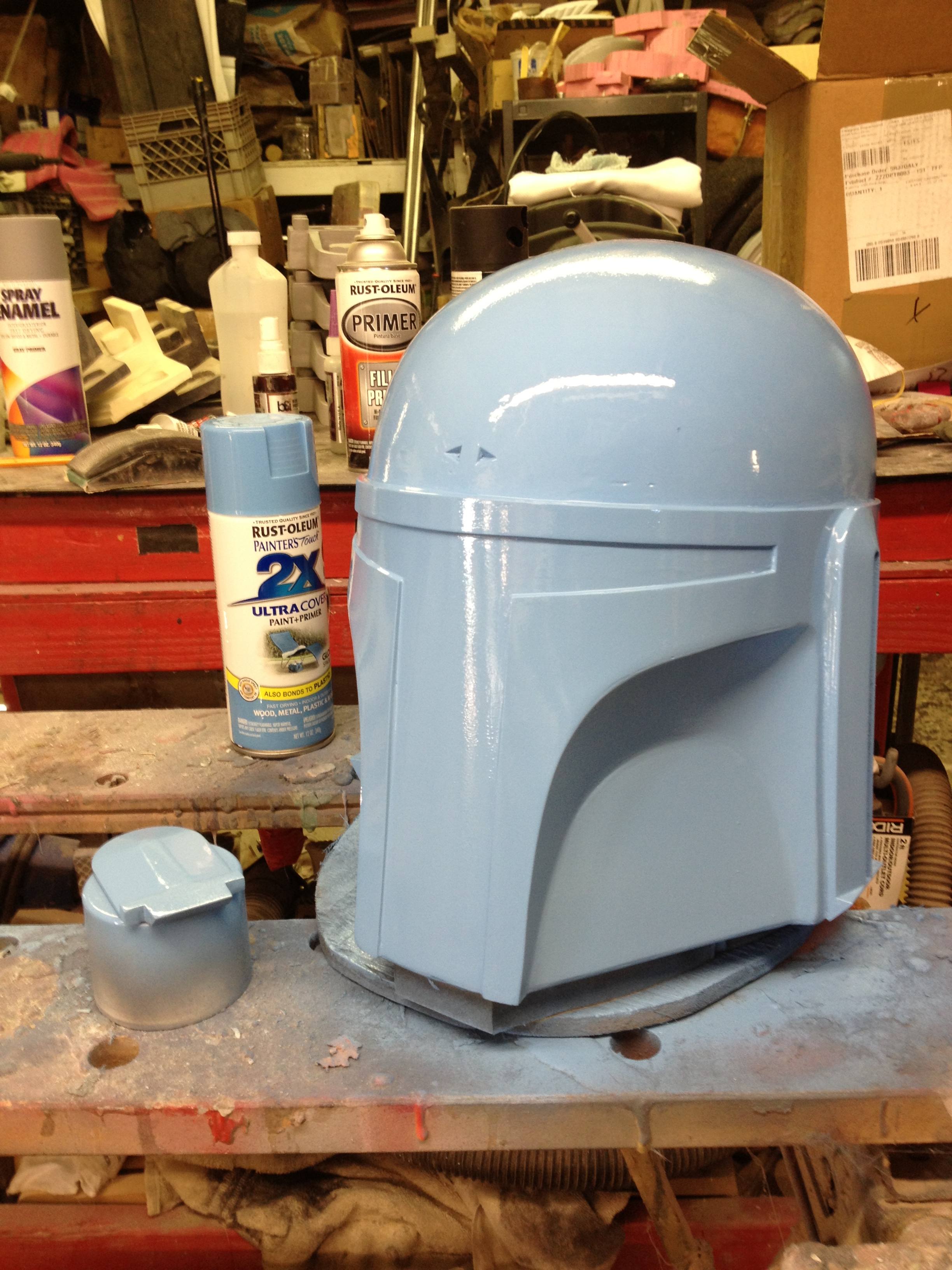

Not too much to write about; I got the gloss coat on the helmet this morning. Silicone is on order. Hopefully I'll be casting some helmets pretty quick here.

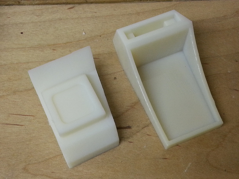

On a different topic, I printed out your rangefinder parts on the Objet30:
