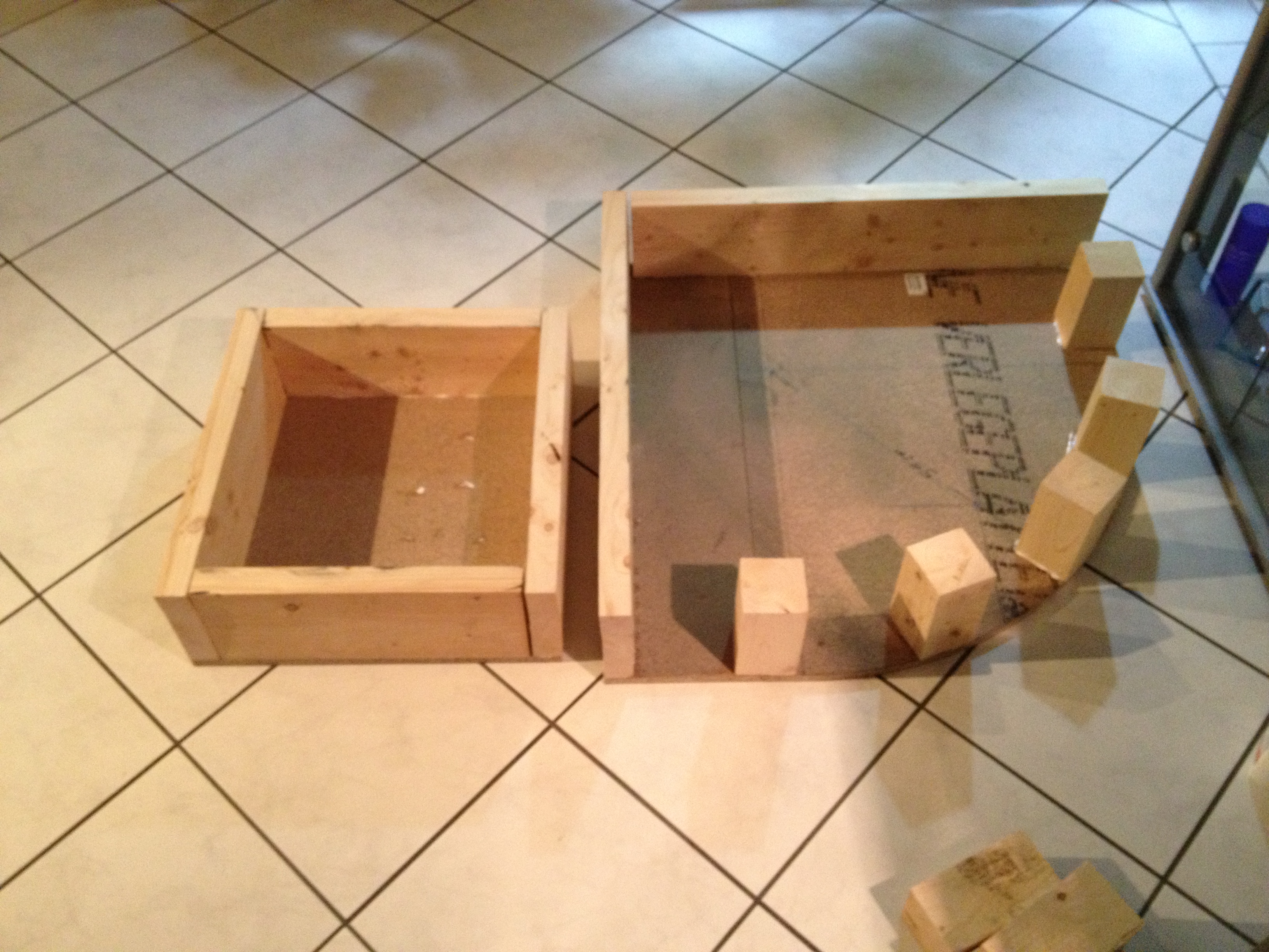

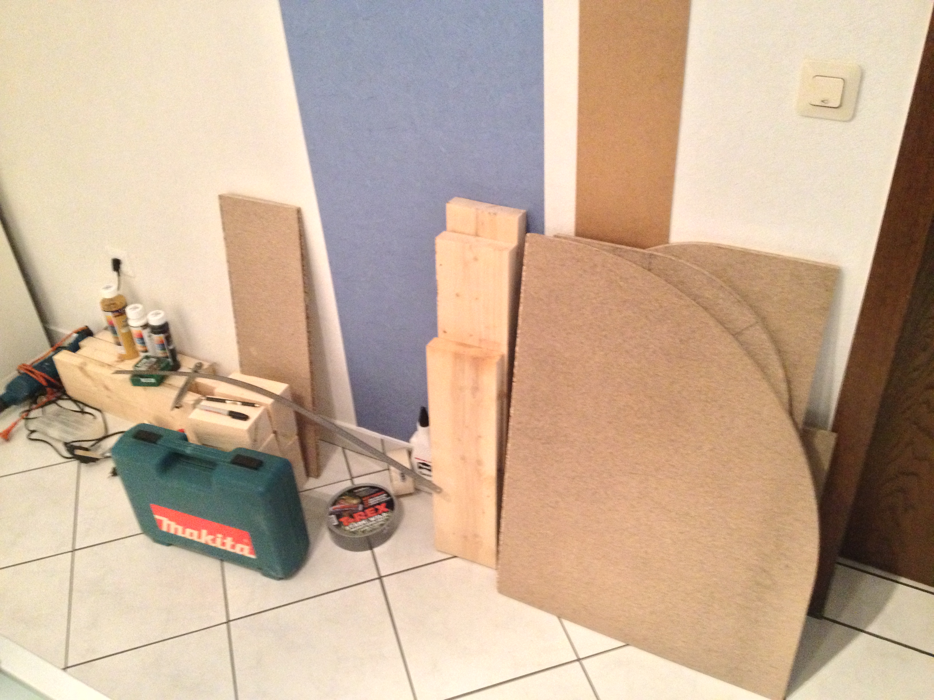

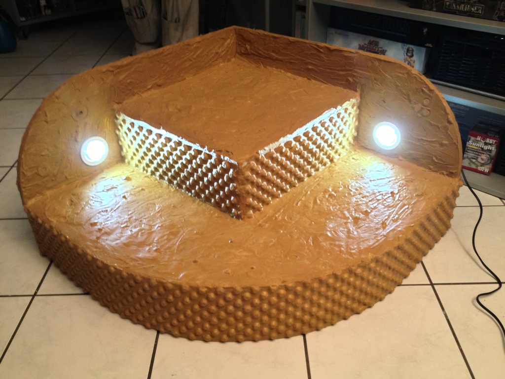

Heavily inspired by Bobamakers Display Stand (Excellent idea and execution - kudos!) I started working on my own today, with some twists to Daz's concept. I had all materials gathered and the wood precut and everything was ready for assemply.
First I assembled the base and the upper step with white glue. After the glue dried, everything was screwed together.

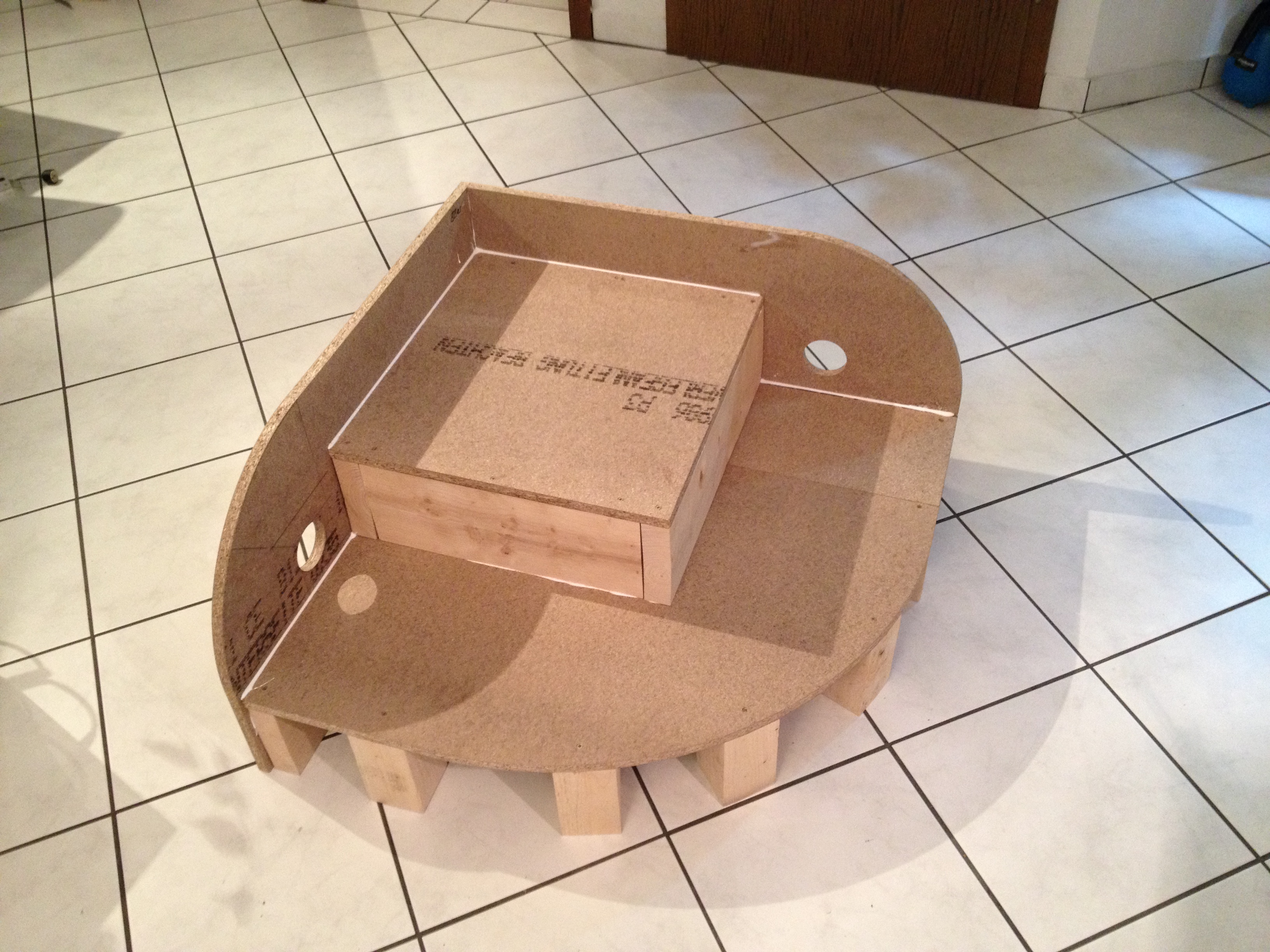

I then attached the sides which have precut holes for ceiling lights.
After that I placed the upper step in the corner opposite to the rounded side of the base. Again - glue first, screws following.
With everything in place, this is the basic shape.
I covered the screwholes with whiteglue and crepe tape and installed the ceiling lights.

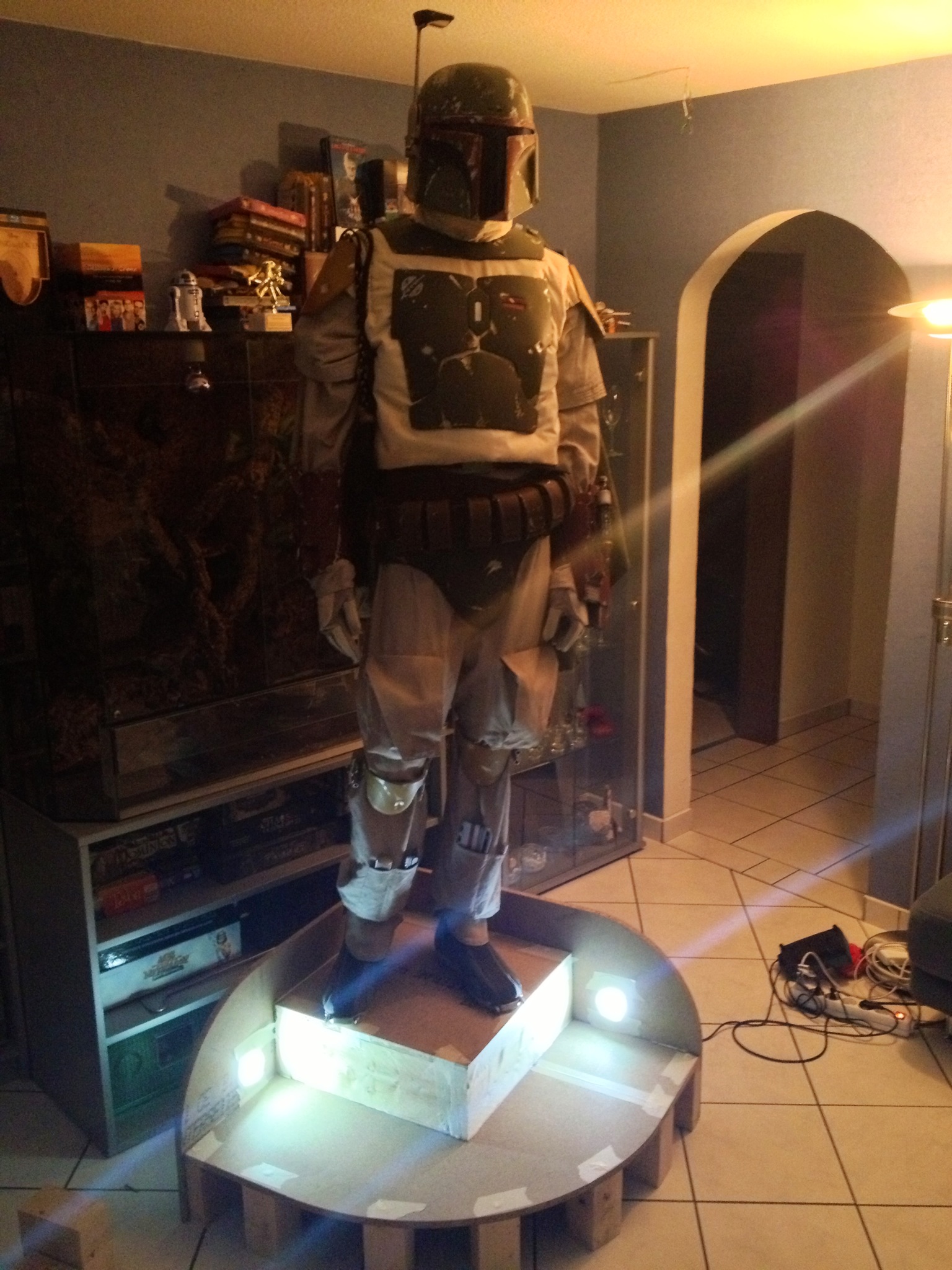

And testfitted the mannequin.
What is now left on my To Do List for the next days is:
- Screw the front cover panel into place
- Install the metal rod that will hold the mannequin in place (which needs to be reposed badly, but that will be another story...)
- Chip the wooden edges with a jigsaw
- Create an uneven and textured surface and work out transitions between the pieces with dental plaster
- Fixate lamps and attach sanded acrylic glass on top of them to diffuse the light.
- Cover electronics of lights and secure cables.
- Paint the whole thing using tinting paint, washes, airbrush and drybrushing.
Hope this will look nice when I am done. And maybe, when the hackjob on the mannequin is done the whole thing will do the armor justice.
Cheers guys, hope you like the progress so far. Happy to hear some feedback, as always.
Tim

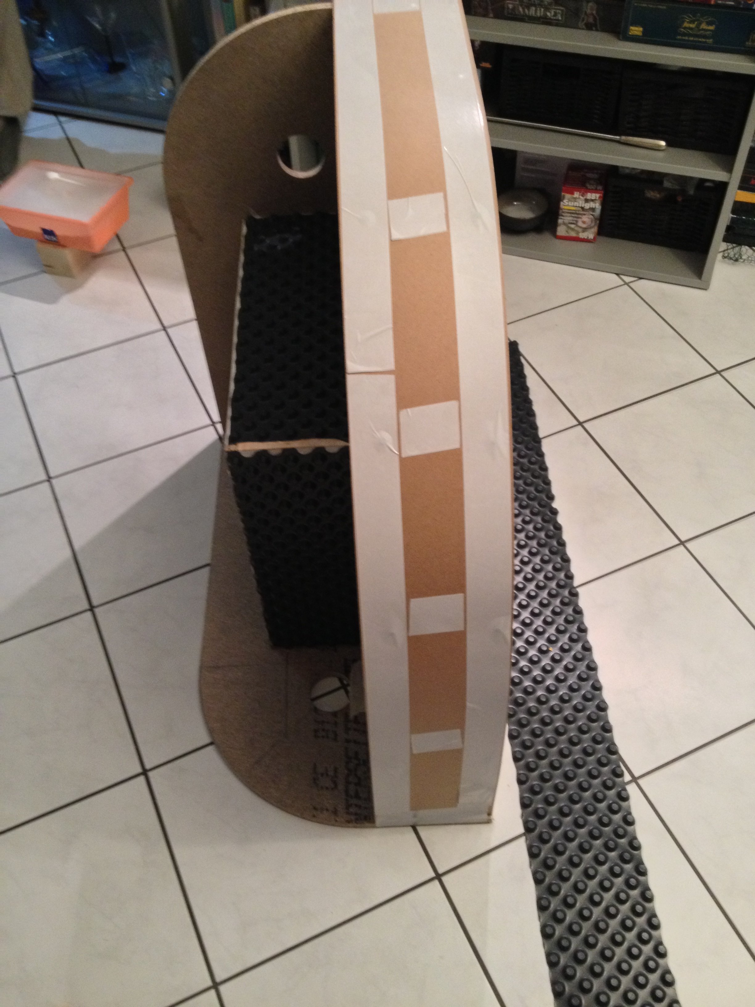

Back at working on this thing again. I screwed the frontpanel into place and a knob foil used for isolating walls was cut and attached via double sided adhesive tape.
Next steps will be the chipping of the wood and then the texturing via dental plaster and a whiteglue/water/sand mixture on the foil. I guess I will have to prime the foil first - so I also got some primer spray.

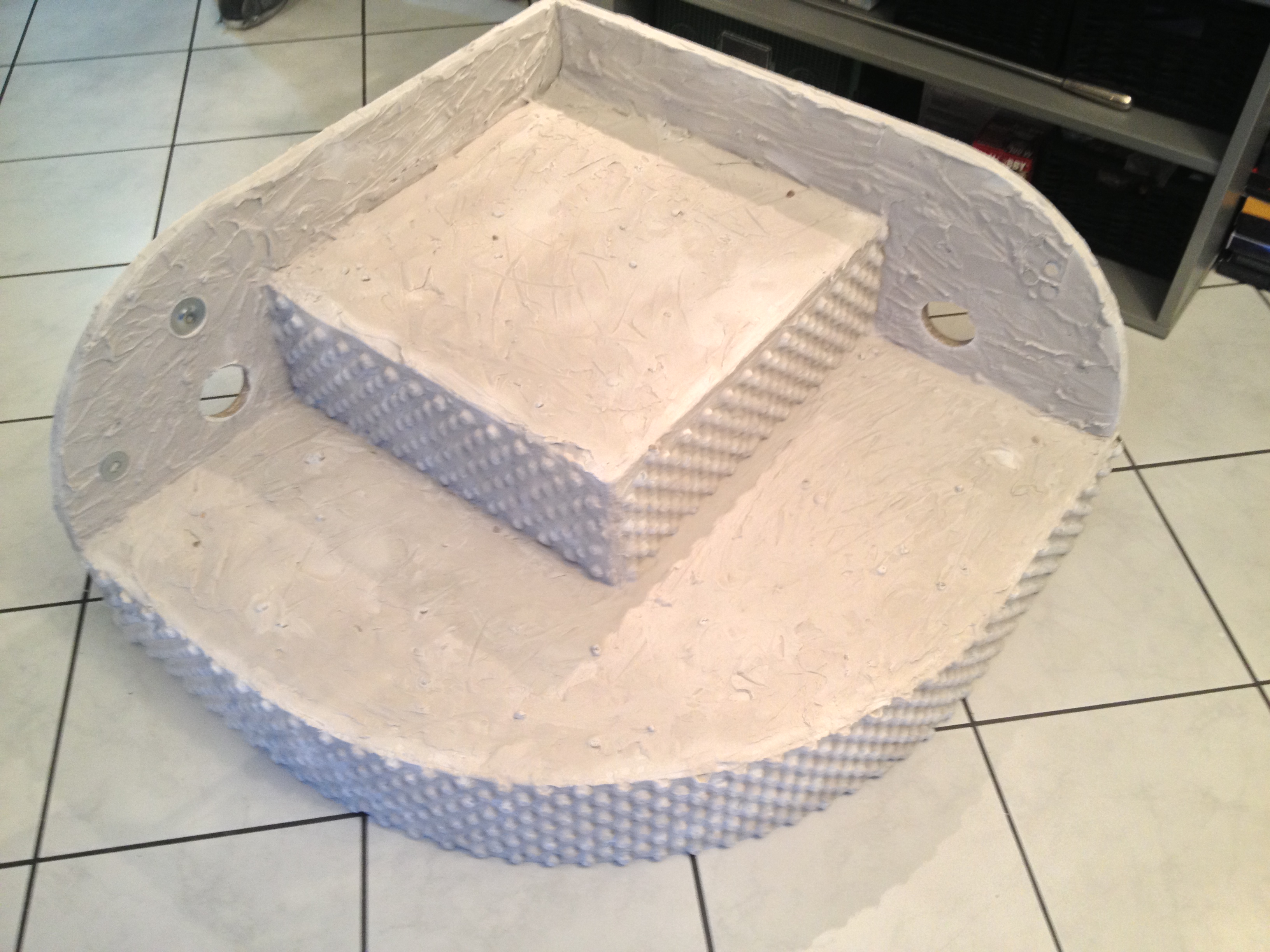

Everything is in place now, and after chipping the wood with a jigsaw and laying down a base layer to uneven the surface and priming the plastic with primer spray i coated everything with epoxy filler.
I also placed some small round metal pieces in the filler on the walls to add something to their looks. While the filler is half cured, I installed the lights as a test and they fit well and I like the way the light shines on the whole thing.
When everything is completely dry tomorrow I will slap some paint on this thing. I still have to install the metal rod that will hold the mannequin in place, but for that I first want to modify the mannequin itself, so I know the final position. Hope my materials to do this arrive soon.
Hope you guys like the progress so far.
Base color laid down. Tomorrow I will start with the washes, the airbrushing and the drybrushing. Also have to glue the lamps in place and color the sockets. Happy with it so far.
Thank you! Still thinking about how to highlight this thing. Need to work outside to do this, but it's snowing as hell here, so I can't continue at the moment. Hope to be able to give you some more pictures soon. :)
Great job, your mannequin is gonna look incredible standing on that. Just be careful, spotlights are very good at bleaching out colour from fabric. Hopefully won't be a problem with your mannequin on the top step.
DAZ
Thank you Daz, it's your work that will look great on it. The lights won't hit the armor directly and I will only turn them on for display purposes anyway, so I guess I am pretty safe. Still not 100% sure on how to highlight this thing. Washes on a stand that large might result in a weird look. Have to experiment a little.
