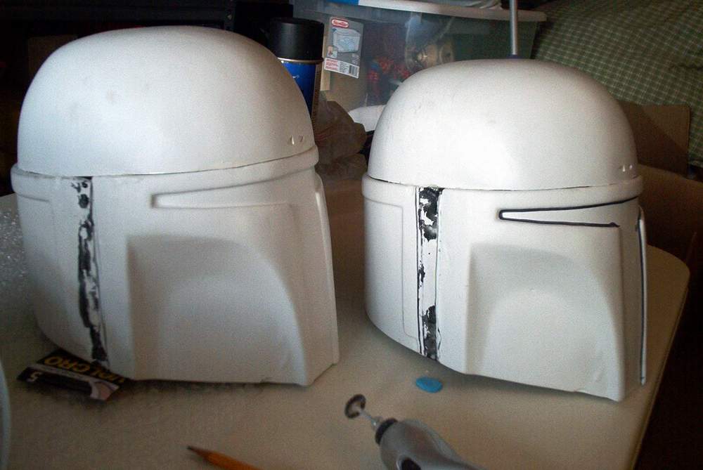

So a guy here is getting married and needs a couple of helmets done. unique situation. Well his delima is h has already bought two kits and tried to get these custom mando helmets done for his wedding and it sems he is having a problem. SO I promised to help him out Here is what I got in the mail yesterday.

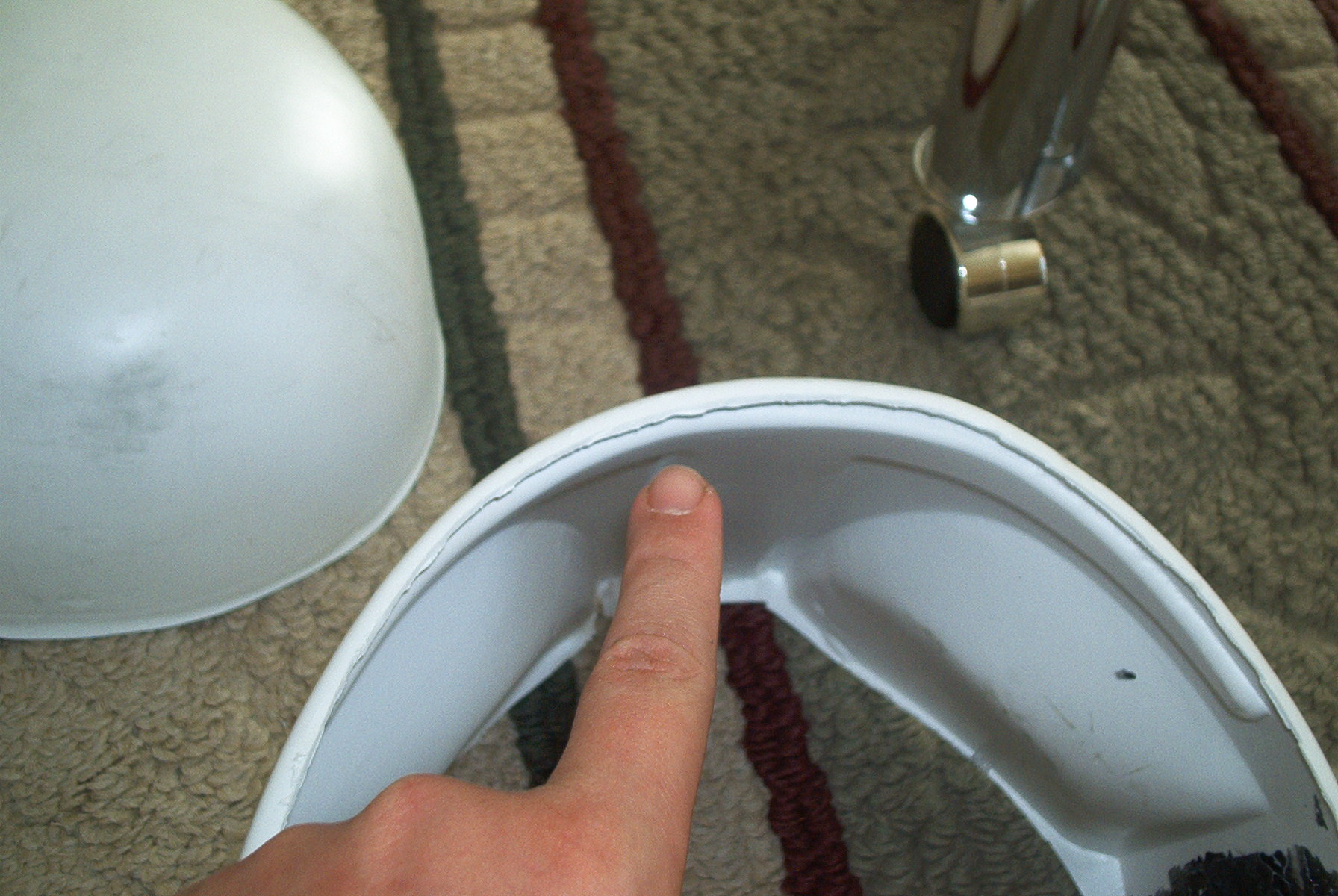

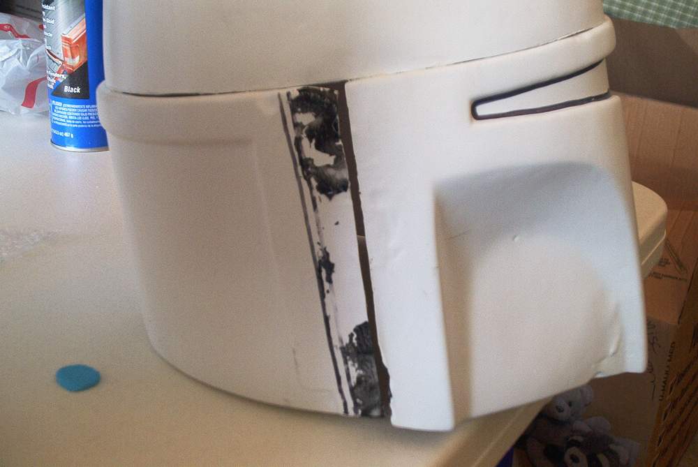

I noticed a couple of fairly common mistakes with this pair of Bradley fett kits. the brow rim was cut from the inside of face and back see where my finger is pointing and the front and the back were trimmed too short where they meet.

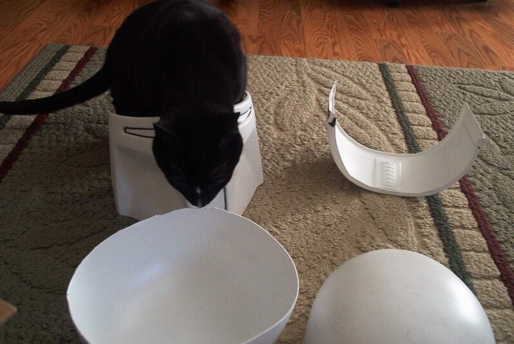

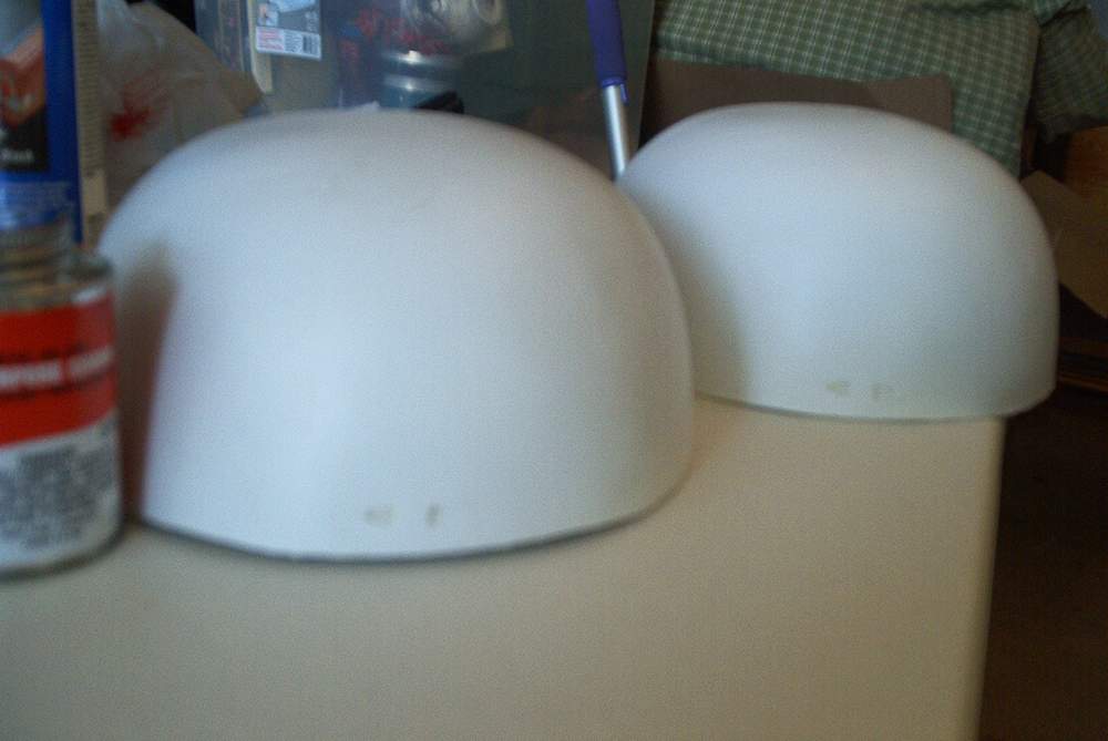

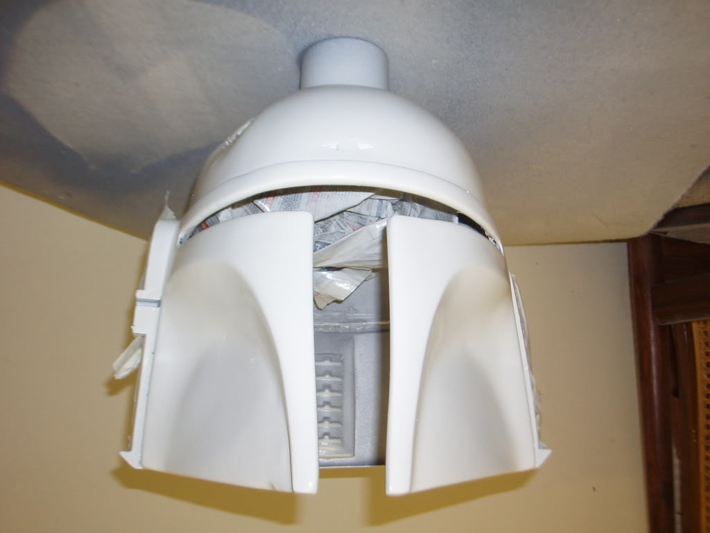

As you can see the dome was crooked as well. See this is Jazz inspecting it. I was very... intimidated by the scope of the Project even though my own 501st bucket is a Bradleyfett. I knew the mistakes that are on it , Only I will notice but still I was really hoping this would turn out well. So I stuck one foot in front of the other and cut out the turn signals first.
Then I used some of the part of the trim from the helmet and some PVC glue to back the signals

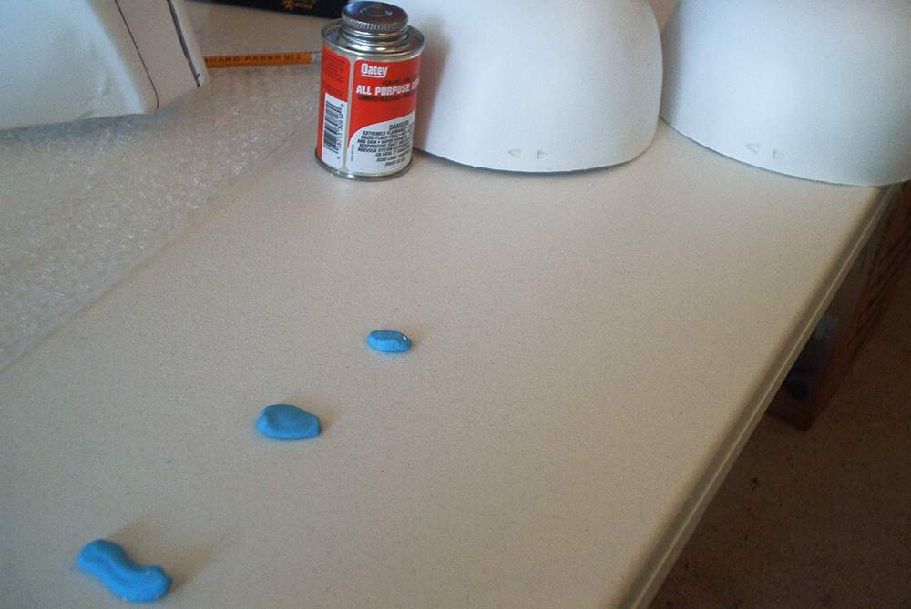

I used waky tack to hold the dome in place whilst I applied teh PVC glue to the edge then fit the face mask to the front. Remember to center it on the blinkers ( arrows on the brow). The glue will take 45 sec to a min to dry. watch for drips as this stuff melts the plastic together!
Do not be afraid if you have to reapply for the edges of the mask to moor them to the dome.
repeat with the back. watch to make sure the brow sticks out a little farther than the dome ( if possible). Remember this is a how to fix thread. There may be spots where ya' just cut it too close and ya' gotta' make do I guess. I had one spot on helmet # 2 above the right brow where this was the case.

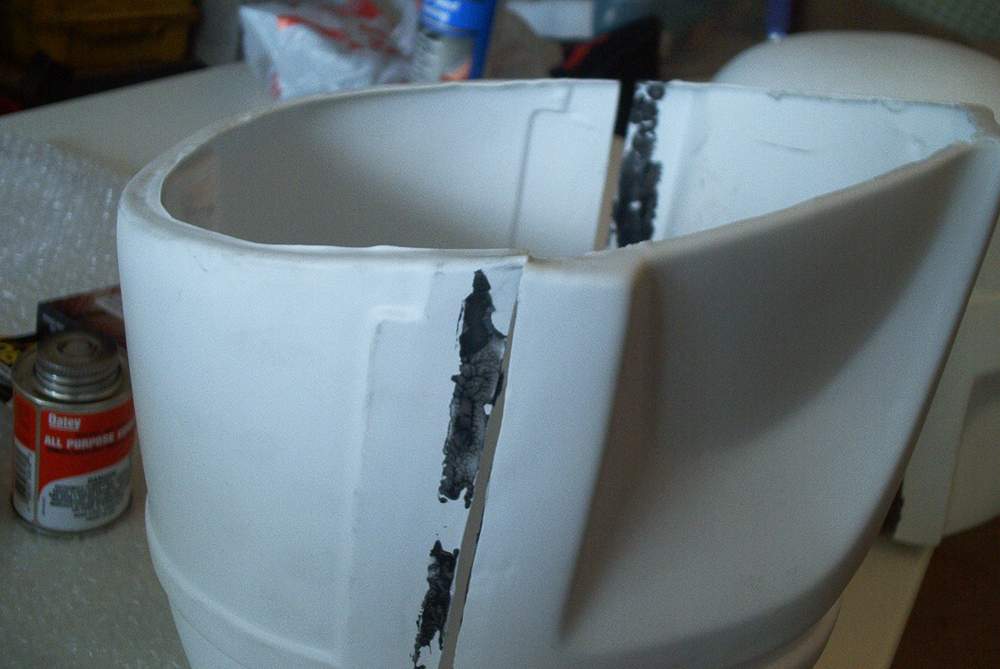

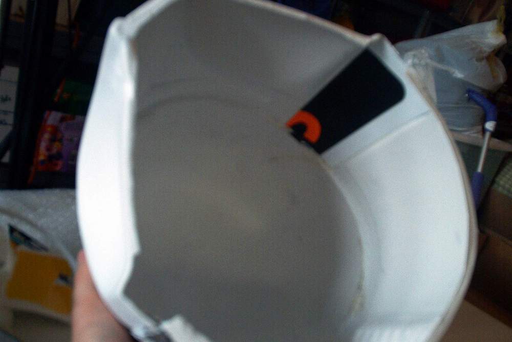

As you can see there will still be gaps in the dome and if the mask and rear are cut too short in the side. one thing at a time. I went and got a NO PARKING sign and PVC glued cut peices to the inside of the helmets ears. This will stabilize the helmet masks to be more solid. Do not use the painted sign as the side to adhere to the helmet!!
Here is a pic of the glues sign/ears next I bondoed the rim of the dome ( from the inside) some bondo il ooze out. Finger smoothit to seal most of thye crackes and fill all holes at this time.

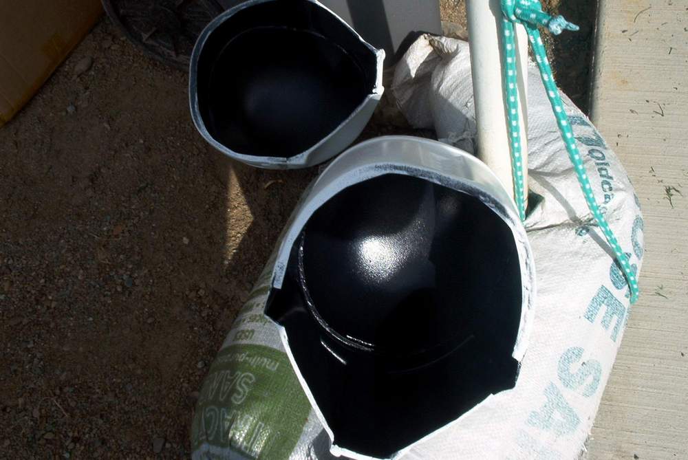

Last part I will get done today. After I Bondoed the helmet ( not pictured just too messy to handle the camera right then). I took the helmets outside. The guysaid he would reimbuse me for materials so here is my secret 10.00 ingredient.
I used a can of truck bedlinder to firm up the helmet from the inside as well as add a nice finish to the inside. I used 3 coats. the helmet becomes a bit sturdier and heavier.
I used the bed liner on the inside of my Bradleyfett, too. Didn't add as much structure as I hoped, but it helped.
Keep those pics coming.
I had no illusions about it being the quarter inch stuff that the professionals use. But it was still a huge improvement and it looks nicer than the white marked up plastic. I ran into a problem with the fiberglass falling out and flaking from my own helmet so i knew that wouldn't do.

I think what was trimmed too short was they trimmed the helmets on the sides. They are supposed to overlap, but I think he took them off to the point where they no longer overlapped, but butted up? If im understanding you right? Meaning that you had nothing to adhere/brace too?

OK, I trimmed mine short but Mark supplied some extra plastic to reinforce (or join) the ears on the inside, well I used it for that and it worked out great. I used bondo to finish the outside which made it pretty solid and filled the gaps. Funnily enough I put your ears on it Stormrider, it is now half painted and they really look great.

Stormrider you are correct about the cutoff. I have heard of more than a few guys doing this though so I figured I would post my second tutorial.

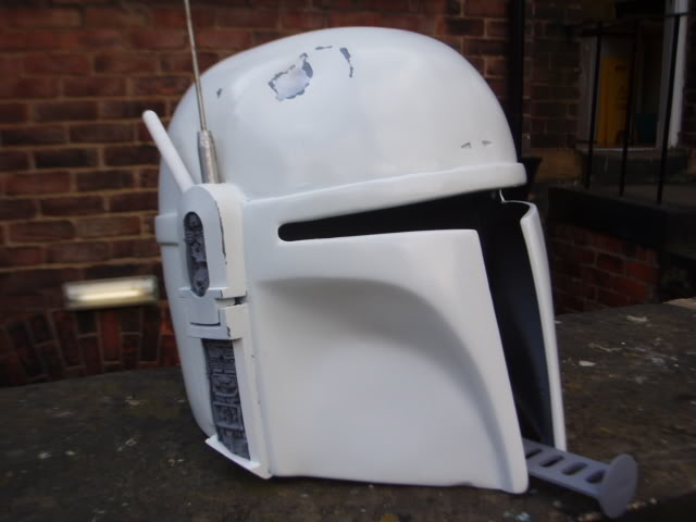

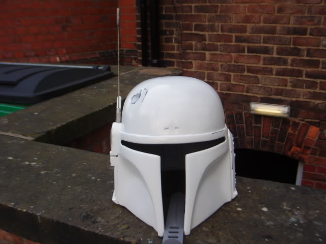

I will post up some shots tomorrow...in fact...here is a quick one I have.
Will post up something on the squared off brow asap...bed time here! I simply sanded the top, bottom and face....I figured if I went through I would use some filler, but I got bored sanding before that happened and it looked good enough.
This is for a custom, with a Pre Pro Supertrooper twist.

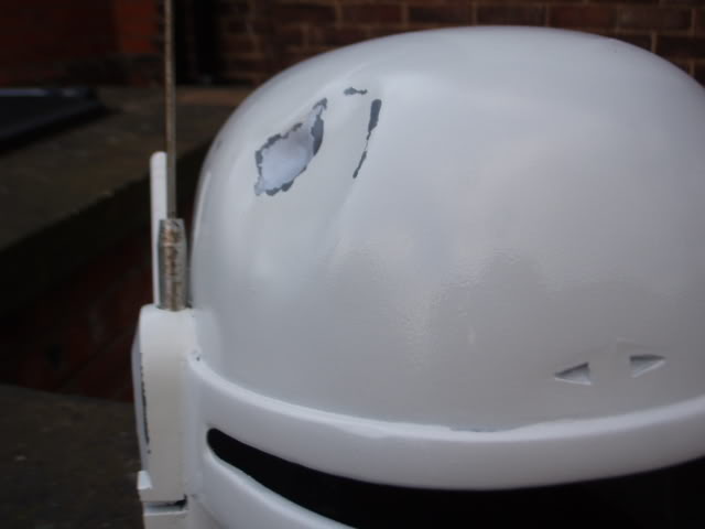

Here are some photos, this is still a WIP. The Dent was done by heating the area up with a heat gun and pushing it in. I went for a FP style double dent. Can't really capture the sanded square brow, but hopefully you cas see from looking front on?
