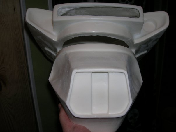

I have a beautiful helmet that is almost all cleaned up. I just have to work on that sort of glob of resin in the upper visor area:
It's really tricky to get at and be able to see what you're doing.

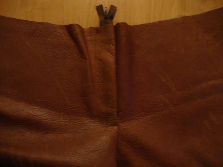

The pants have been a learning experience. I love that about costuming. I sewed leather for the first time with Zam. It's definitely different than sewing other fabrics. And in all the time I've been sewing, I'd never sewed a fly front pant. I'm fairly pleased so far with the result:

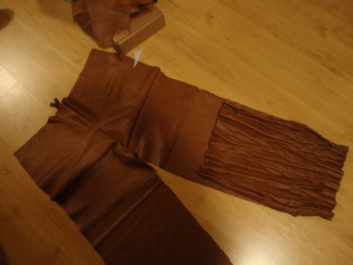

I originally did a mock up for the pants to figure out the panels. However, what I forgot to consider was the fact that the last panel has to be above the top of the boot cover. So I ended up having to reduce the amount of each leather panel to get the spacing right. And of course, ended up with Boushh capris. No good. Thankfully that part is concealed by the boot cover so I'll just add another panel to the bottom.

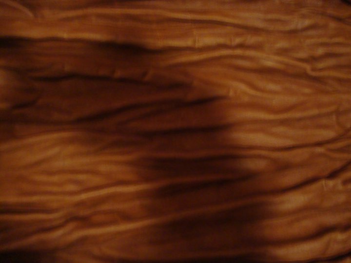

The crinkle part was surprisingly easy once it dawned on me how to do it. I simply cut a section of leather that was about 1.5 times wider than it needed to be. Then I soaked the leather in water, crumpled it all up in sort of a random fan pattern, tied some string around it and let it dry for days. Considering that this piece has been shoved in a bin under other leather for at least a year, I'd say it's going to hold up well.
