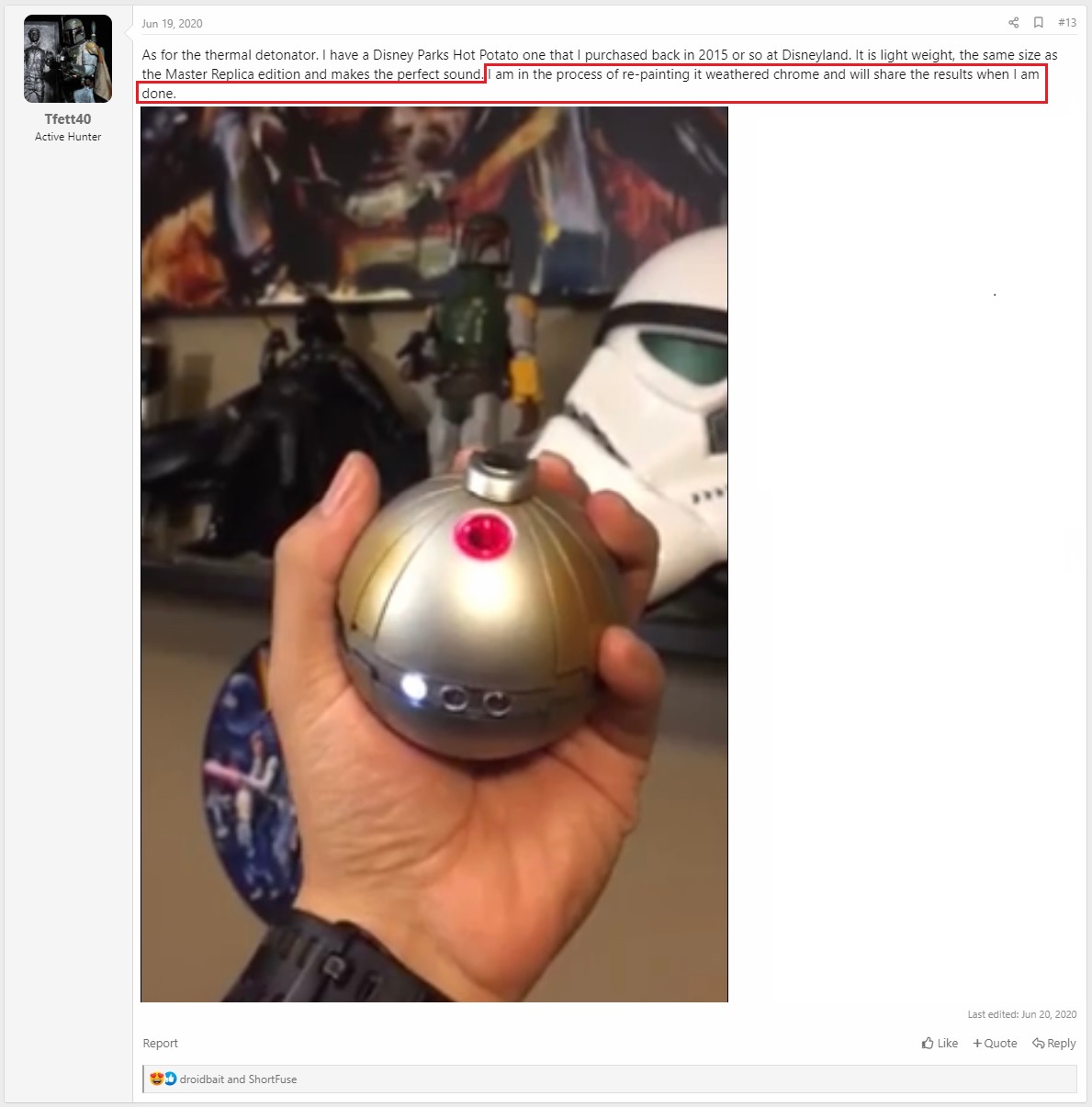

Ah! I gotcha! I picked up a Disney Parks Hot Potato Thermal Detonator for what I thought was a reasonable price off of eBay - $75.00 (US). I didn't see any follow-ups to your other post (this one...)
So I had assumed that the one your wife is holding was the Disney one. But as I look at it more closely - now that I have mine (Came in yesterday). I can tell that it is NOT the Disney variant.
I took mine apart yesterday (Not a fun process), but my intention is to change out the LED's to yellow and then give it the following:
1) Prep with Alclad II's - Gloss Black Base (ALC-304)
2) Then hit it with Alclad II's - Chrome for Plastic (ALC-107)
3) Finish it with Alclad II's - Gloss Klear Koat (ALC-310)
From what I've seen, this stuff is supposedly magic and closely emulates what Alumaluster does at a fraction of the price. It was this video that kinda had me convinced....
Just my two cents on how I intend to change mine.
