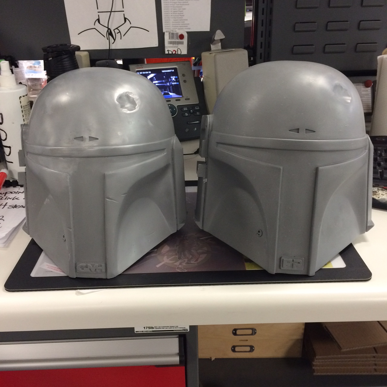

I am currently working on a FP & a GMH @ the same time (first time resin build and built a pepakura last year and want to really focus on a proper paint job) and wanted some pointers on which screws I should use on the ranger finder stalk.I am thinking about going with magnets to hold the ear cap in (any pro's and con's to this?) I live in Canada so if anyone could point my in the right direction it would be greatly appreciated seeing as I haven't found any info regarding what screws to use.Anything would help!
