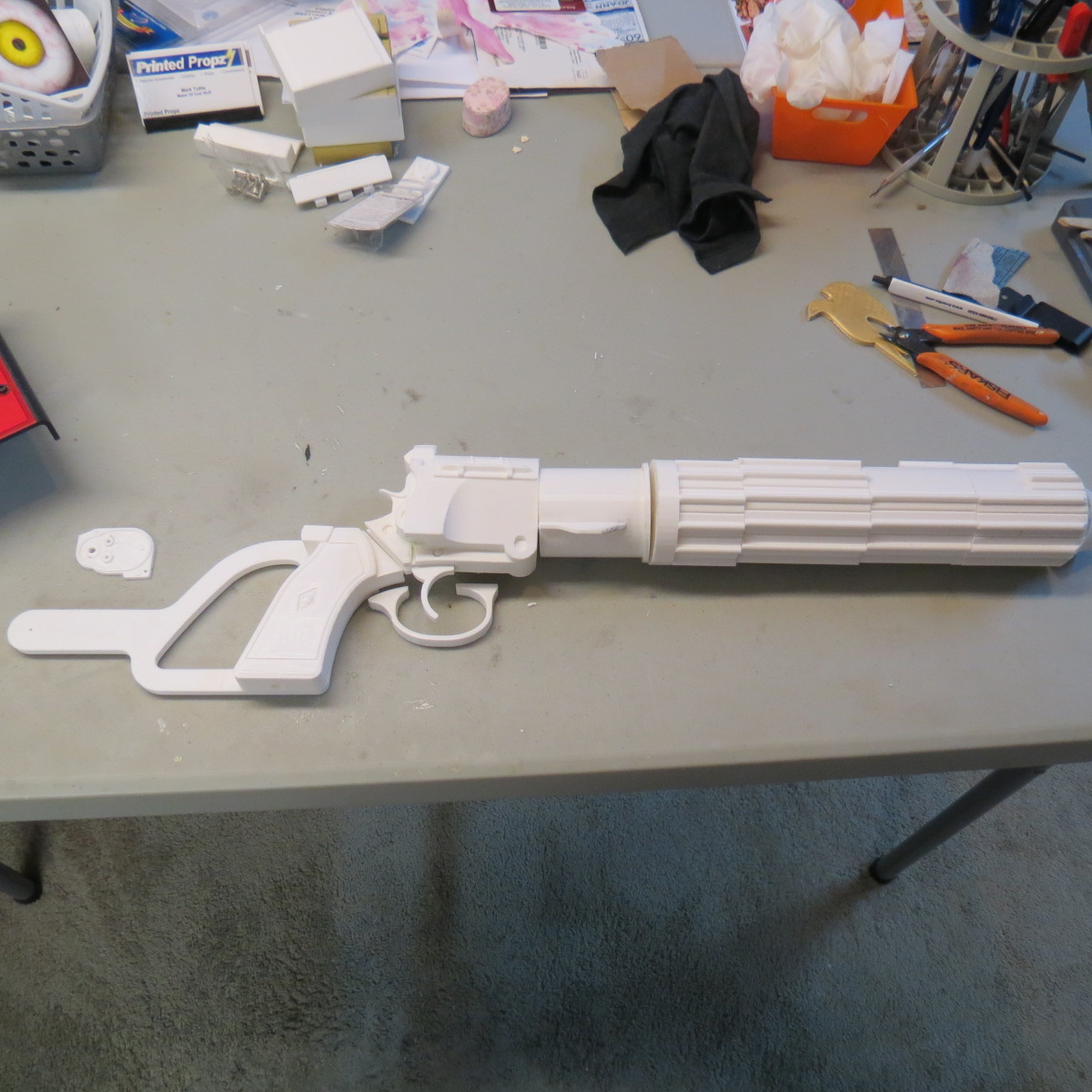

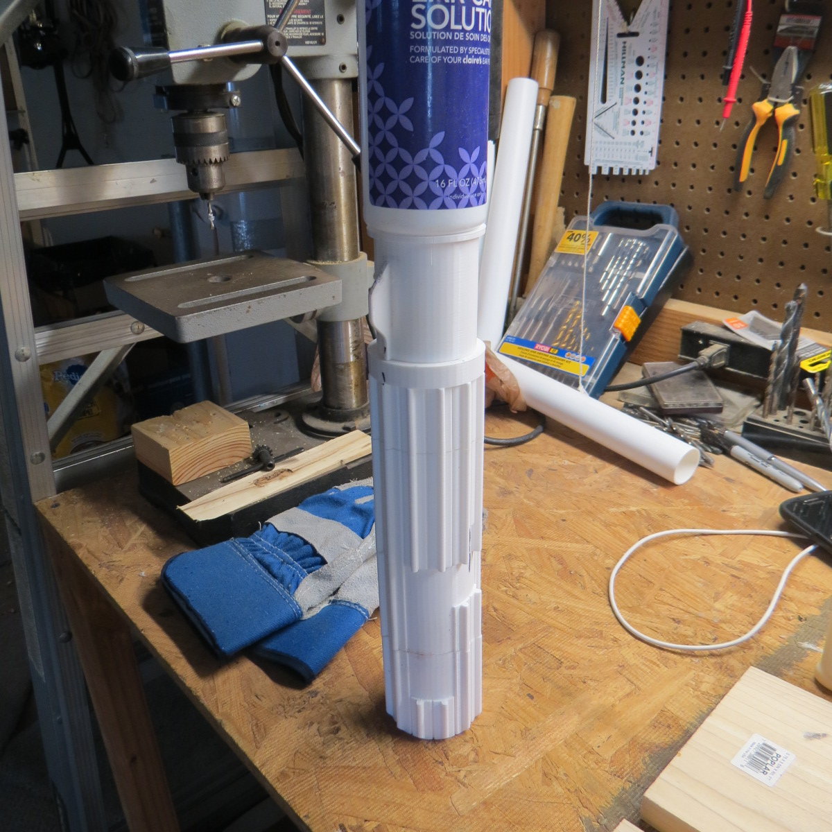

Progress, thus far.
This represents about 15 hours of printing for those of you not familiar with this process. I was considering doing the barrel in PVC and then adding the various bits but since I have the files I just figured I'd go for it. There are three more sections of the barrel to go (another 10+ hours) then the tip, trigger guard, scope mount and a few bits here and there. I've been studying up on making wood rifle stocks so that will be more manual work. Fortunately, I have a decent shop so that's just a matter of time and skill. Any recommendations on the type of wood I should use?

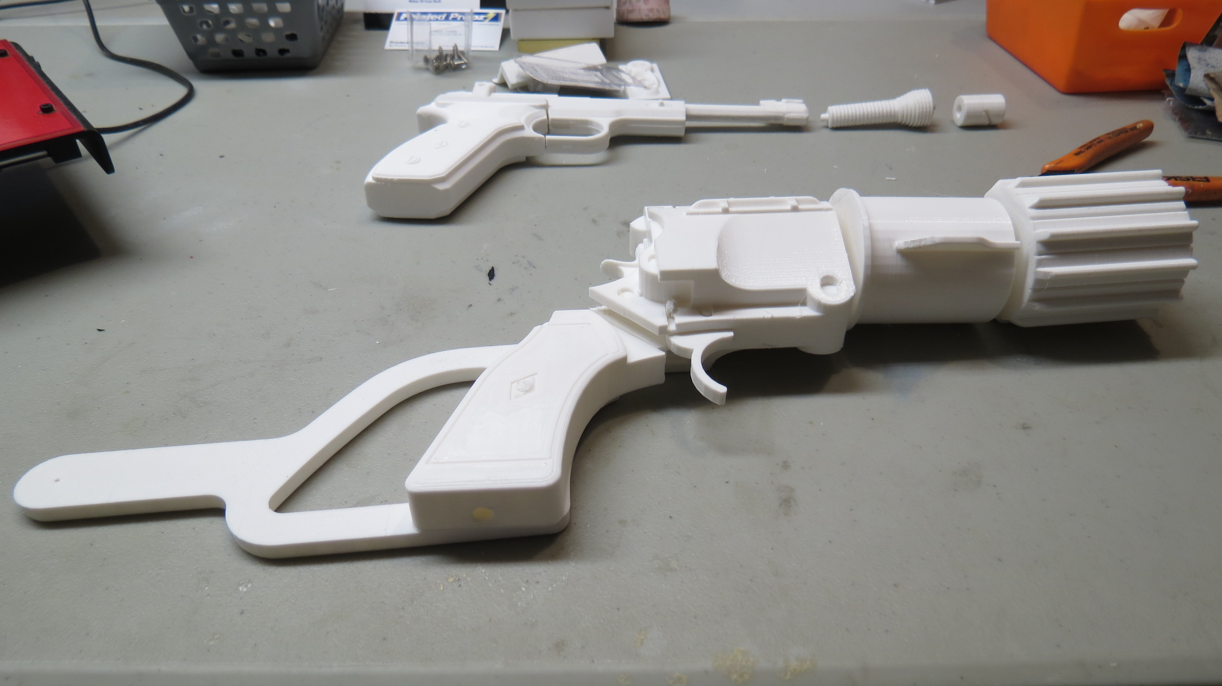

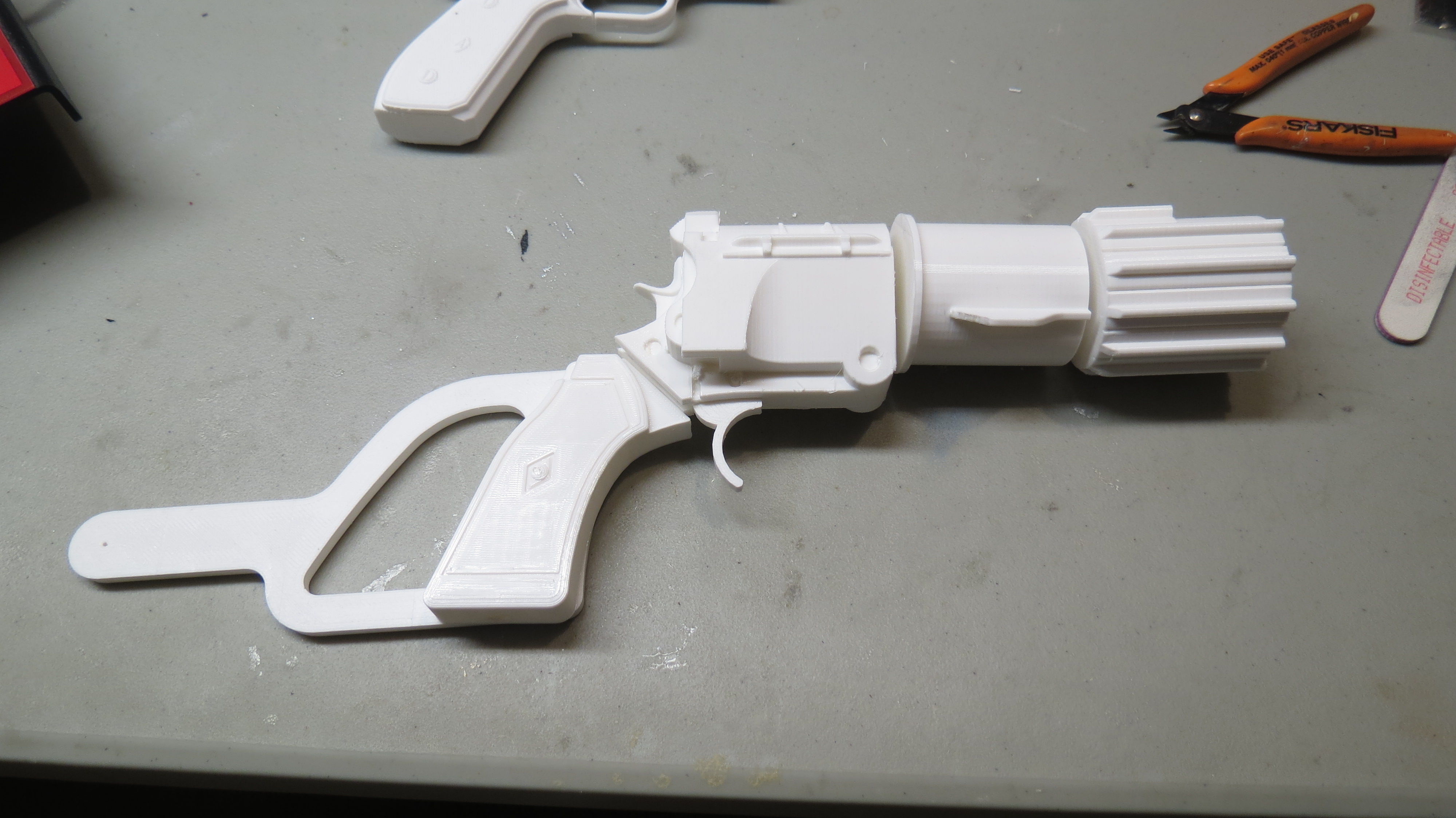

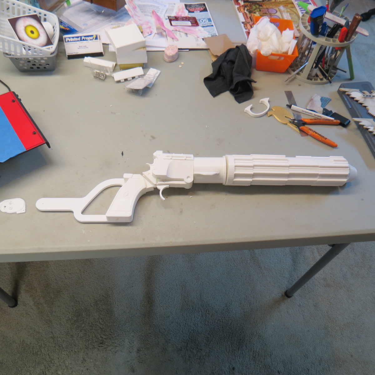

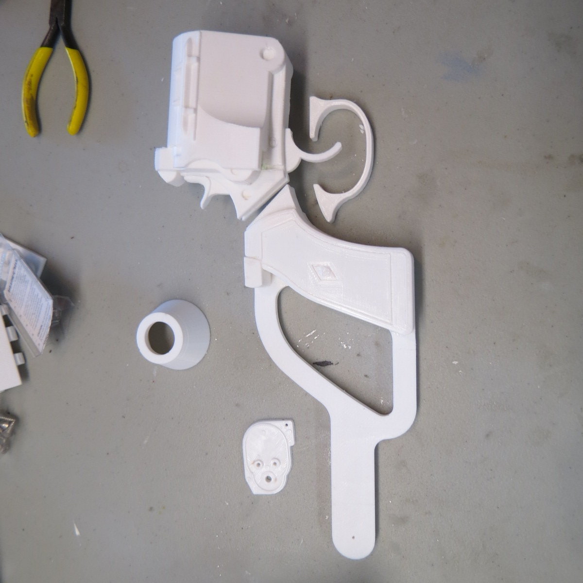

Here are the pieces laid out. (Not necessarily in the right order.)
I began the terrifying process of gluing this all together last night. The attach point between the grip and chamber pieces is stressing me just a bit. It will be tough to clamp because any leakage will glue the clamp to the piece.
My daughter was very upset I was using her earring treatment solution to hold the glue together. I find her lack of faith disturbing. ;)

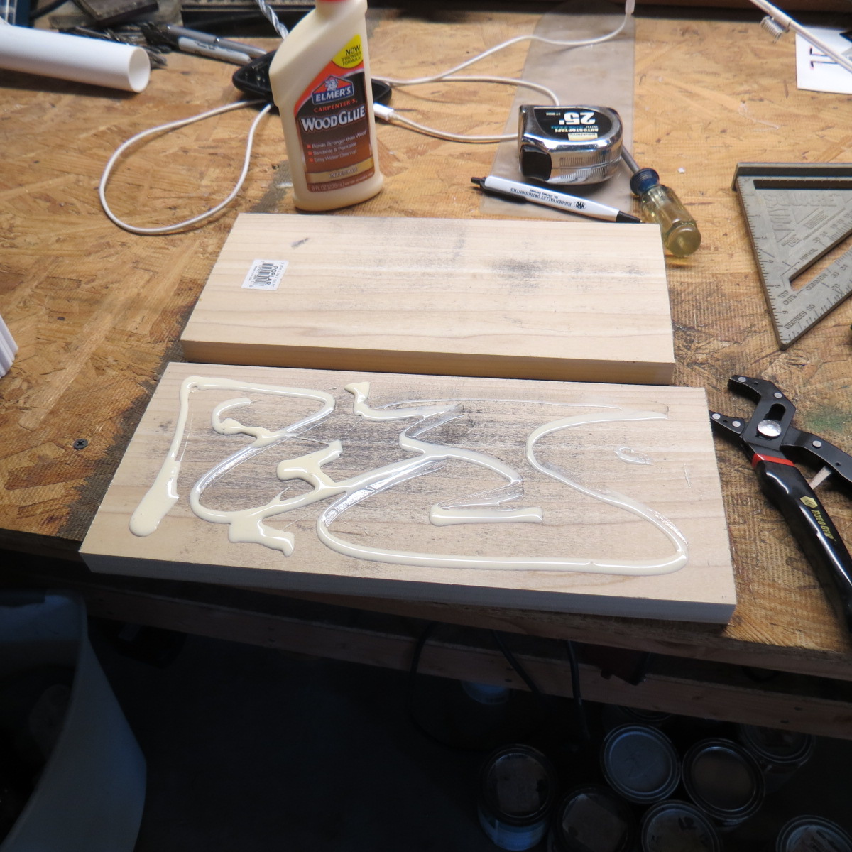

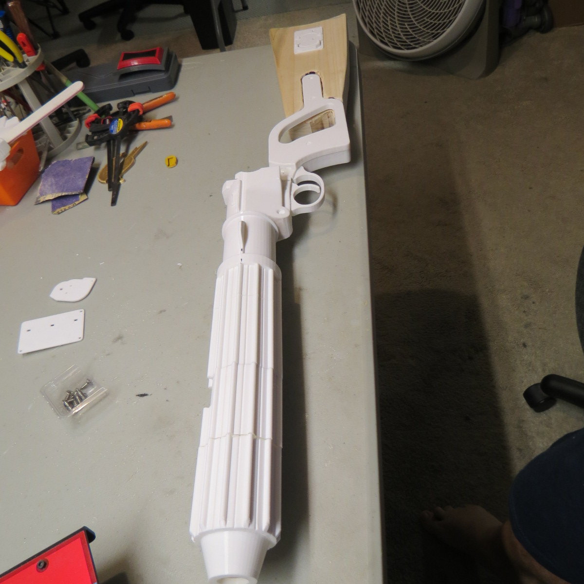

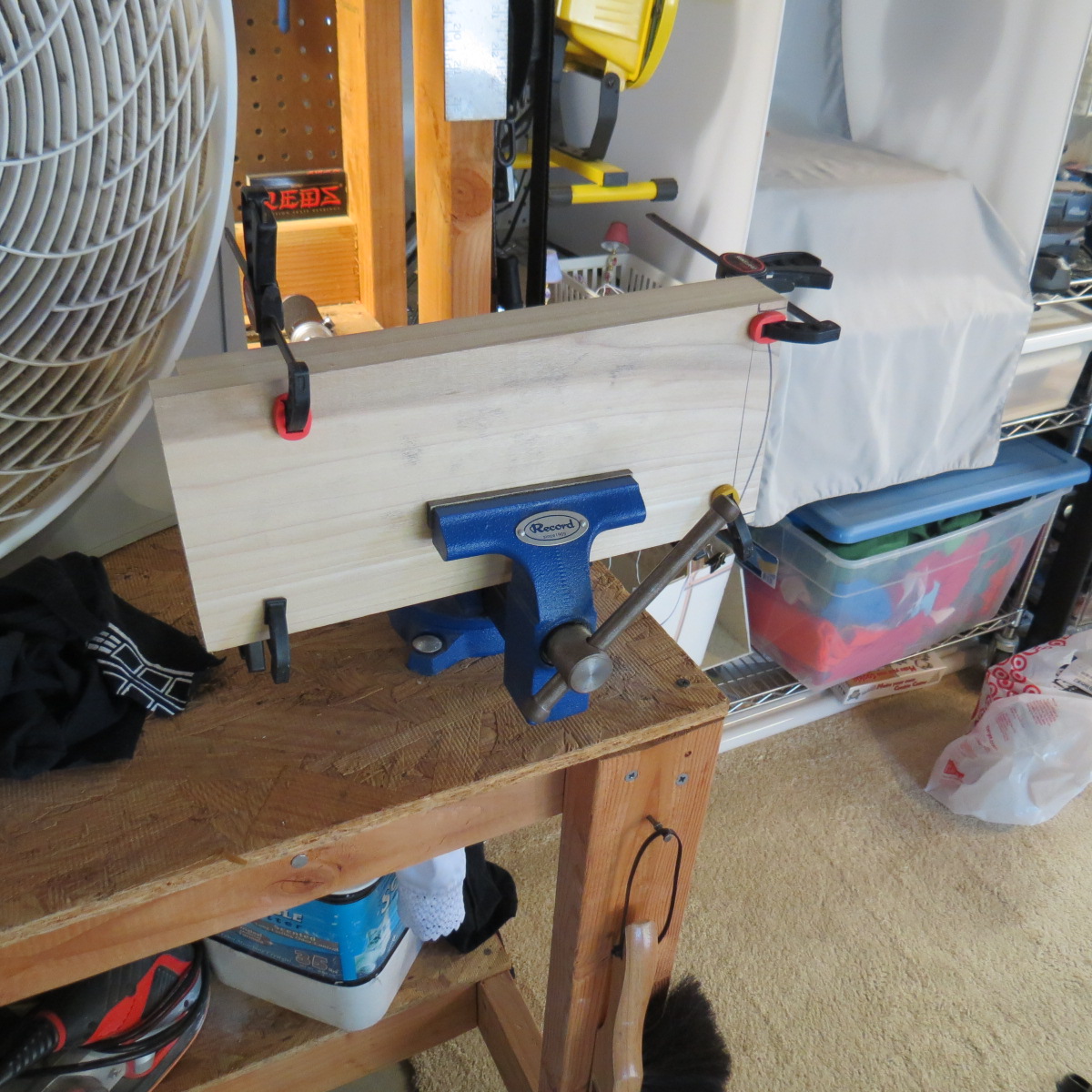

I picked up a piece of poplar for my gun stock. Each piece is .75" thick and I wanted a 1.5" stock so I cut two 12" lengths and am wood gluing those together. I'll probably leave that in the vise until tomorrow just to make sure it's solid.

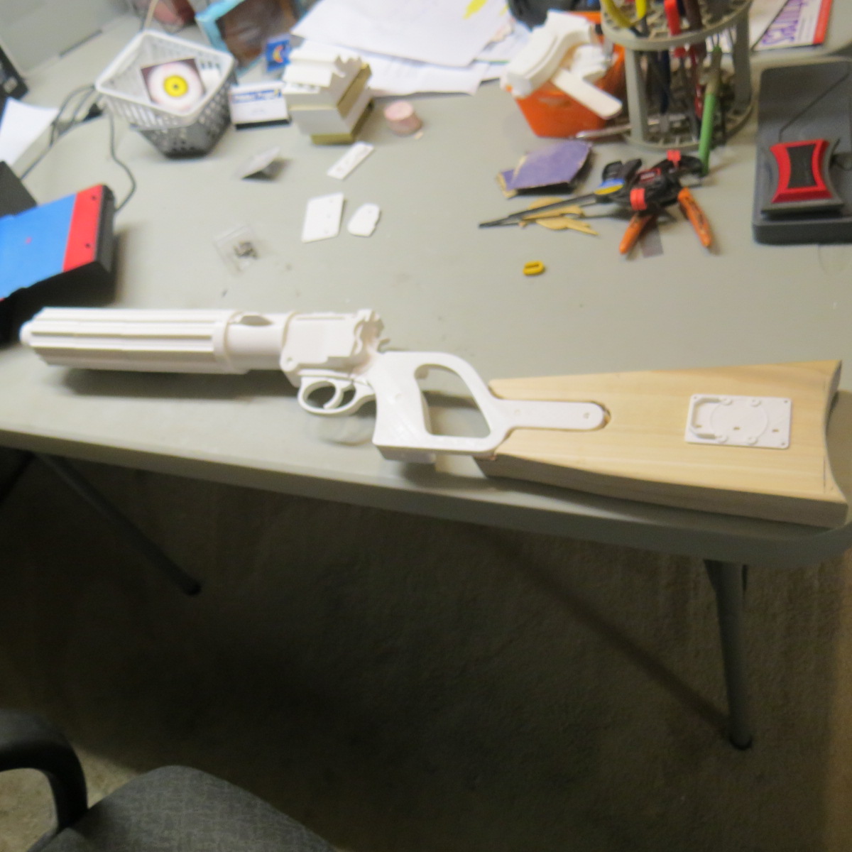

So a lot happened today.

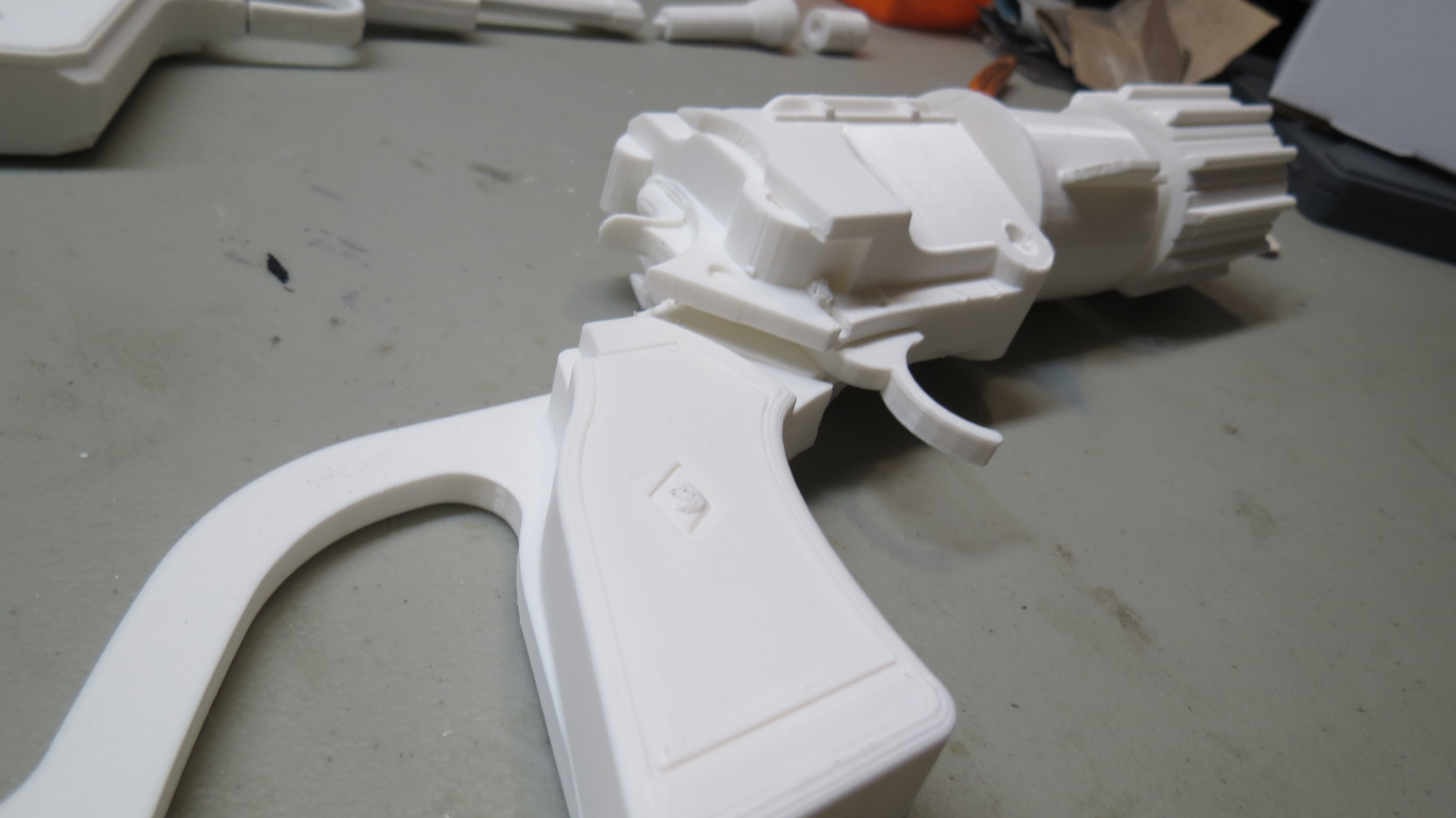

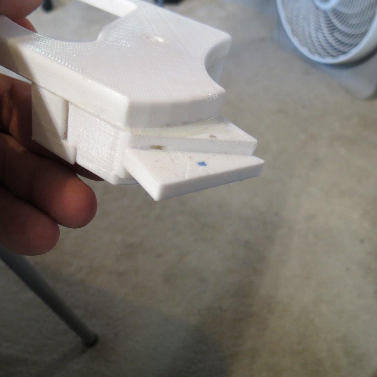

As I expected, gluing the handle grip to the trigger chamber was simply not going to work. So, I constructed a "tab" to slide into the a space left by the designer of this file. I suspect the original designer had intended for something of this sort but didn't include it in the file upload. Regardless, the tab worked beautifully and really helped gluing that connection.

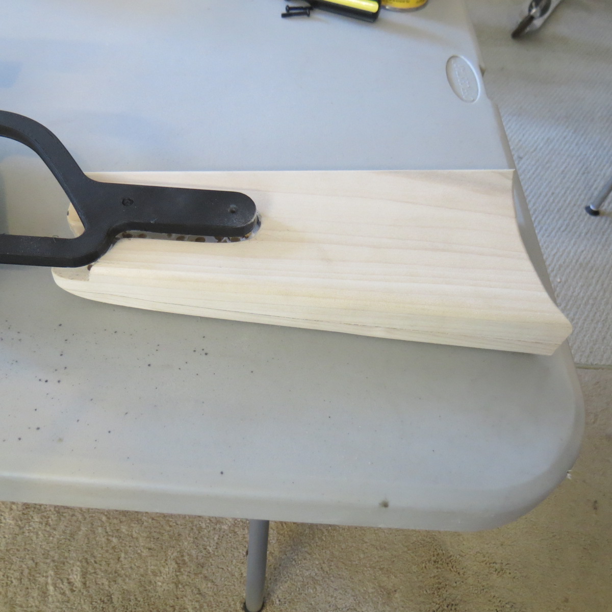

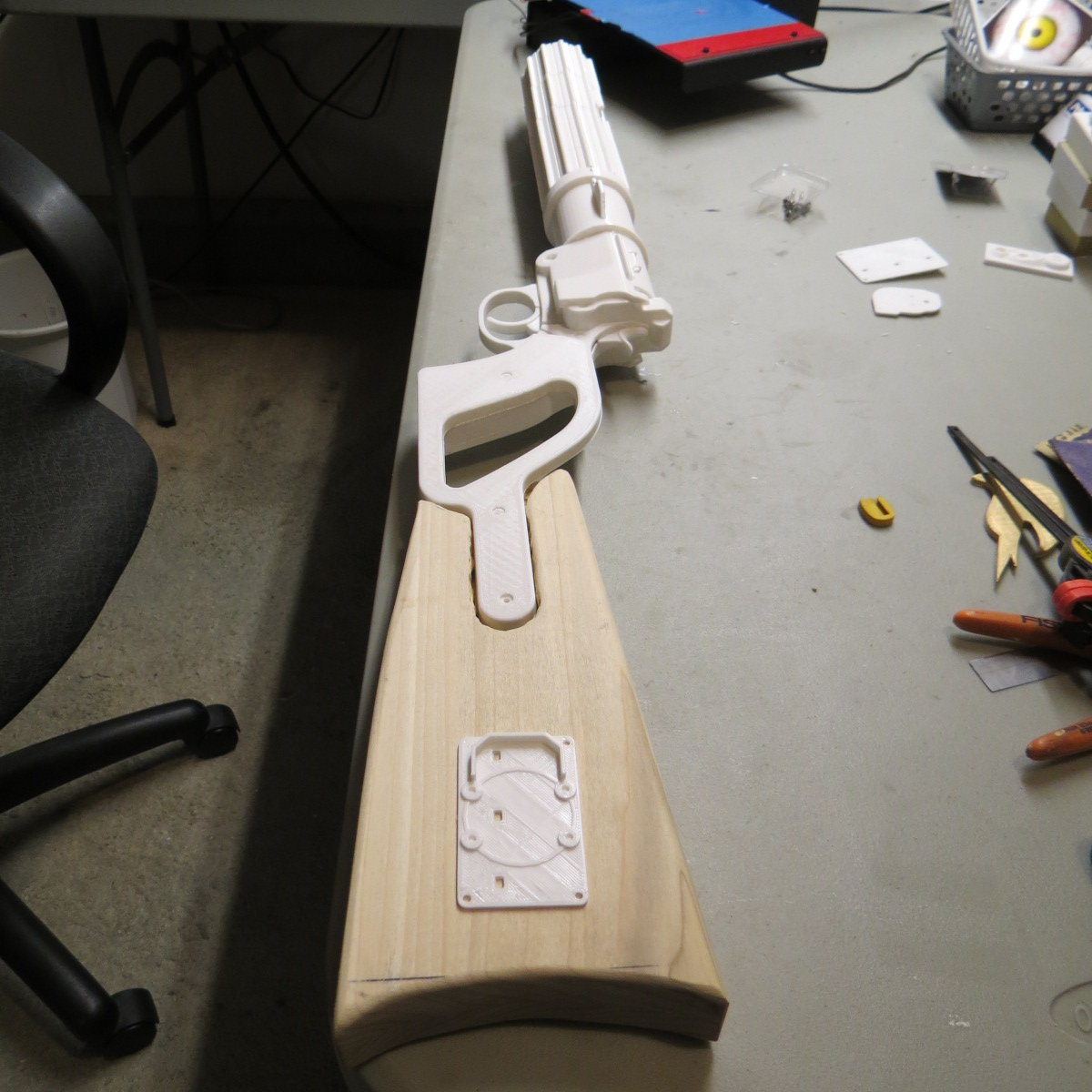

I cut and started sanding the stock today. I have every tool in the world except a planer and a router table. Do you know what are the most critical tools needed to make a rifle stock? A planer and a router table. Sigh. Still, I had a dremel and a drill press so I was able to get a good start on the cutout for the stock holder.
I want to do a lot more sanding and shaping on the stock but my belt sander needs a new sanding belt. A quick trip to Home Depot in the morning and I'll get that wrapped up. Hopefully, I can begin painting tomorrow.

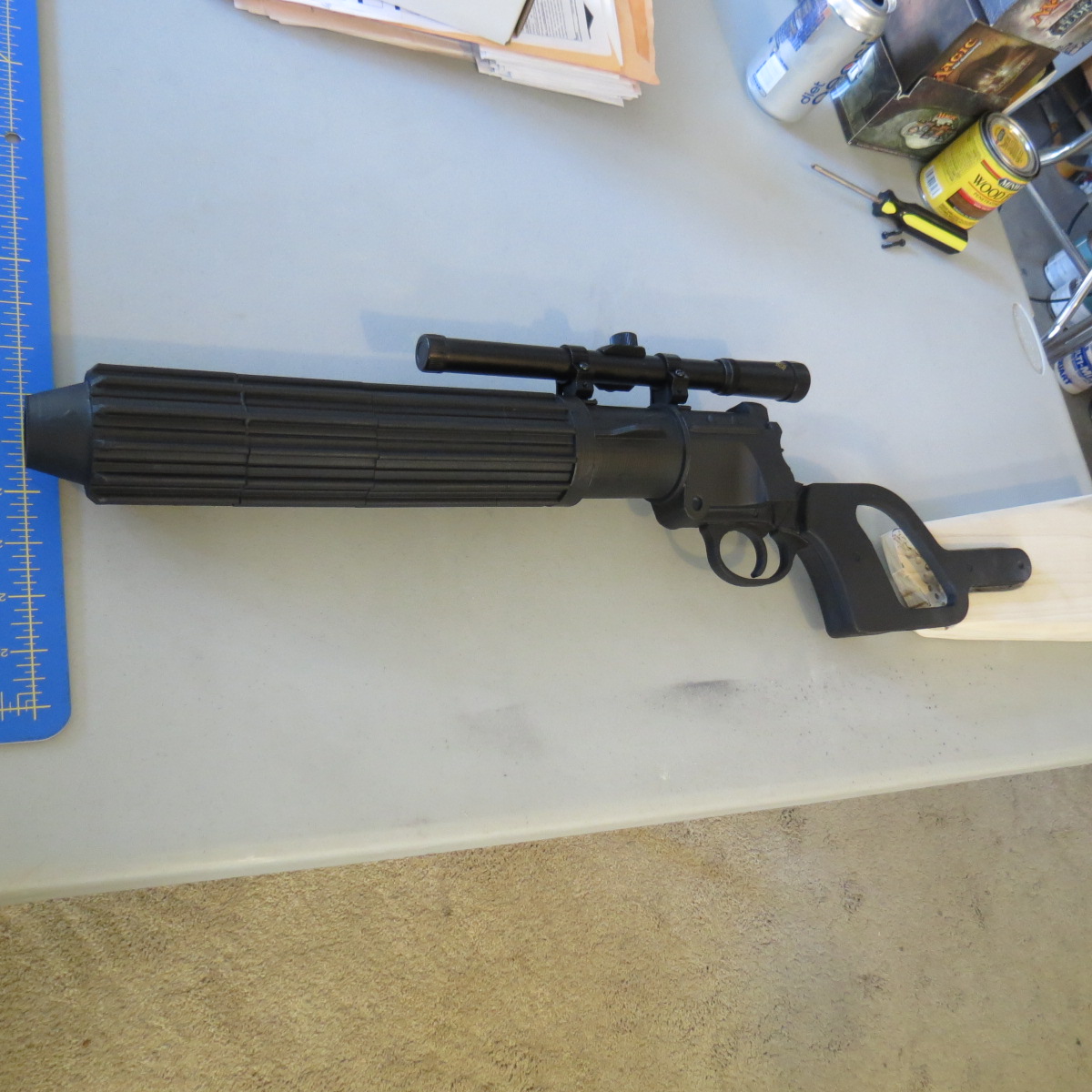

Started painting! Primer is done and I'm on the second coat of black. Yes, I have some blobs that I need to sand out. One more coat of black and I'll start detailing.

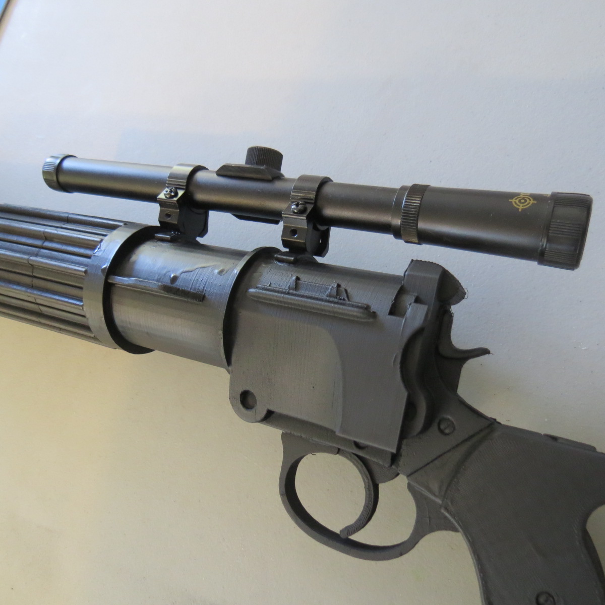

I got my scope from Amazon yesterday. However, the clip in the 3D file wasn't as strong as I liked, so I had to create a new "stand" to attach to the gun so I could mount the scope. Took a while to get the odd angles right but it came out nice. (And yes, I know I need to paint over the Crossman logo.)
I did a lot of work on the stock yesterday. This part has actually been a lot of fun. I picked up new belts for my sander and it's just a matter of patience. It's still too thick so I'm going through the whole process of planing that down.

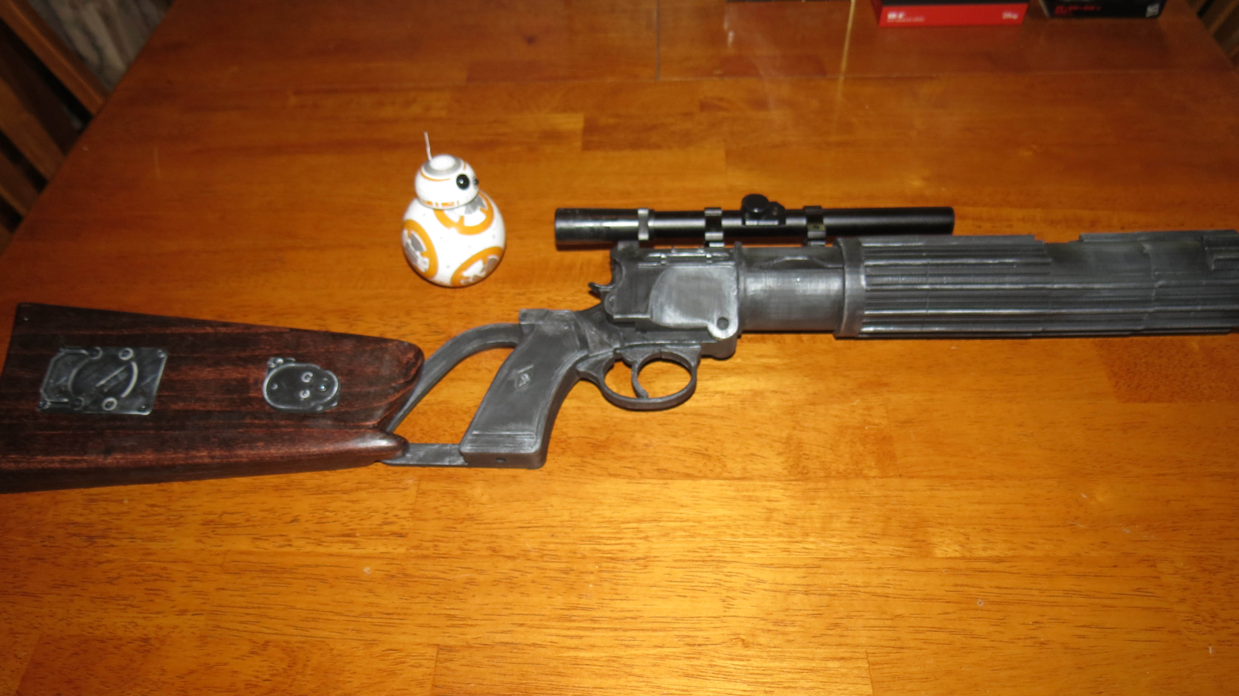

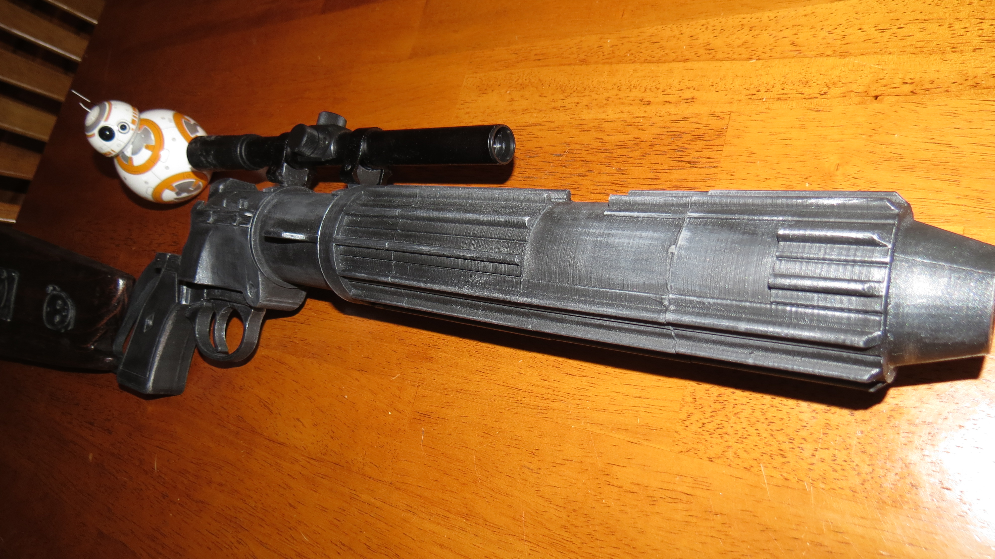

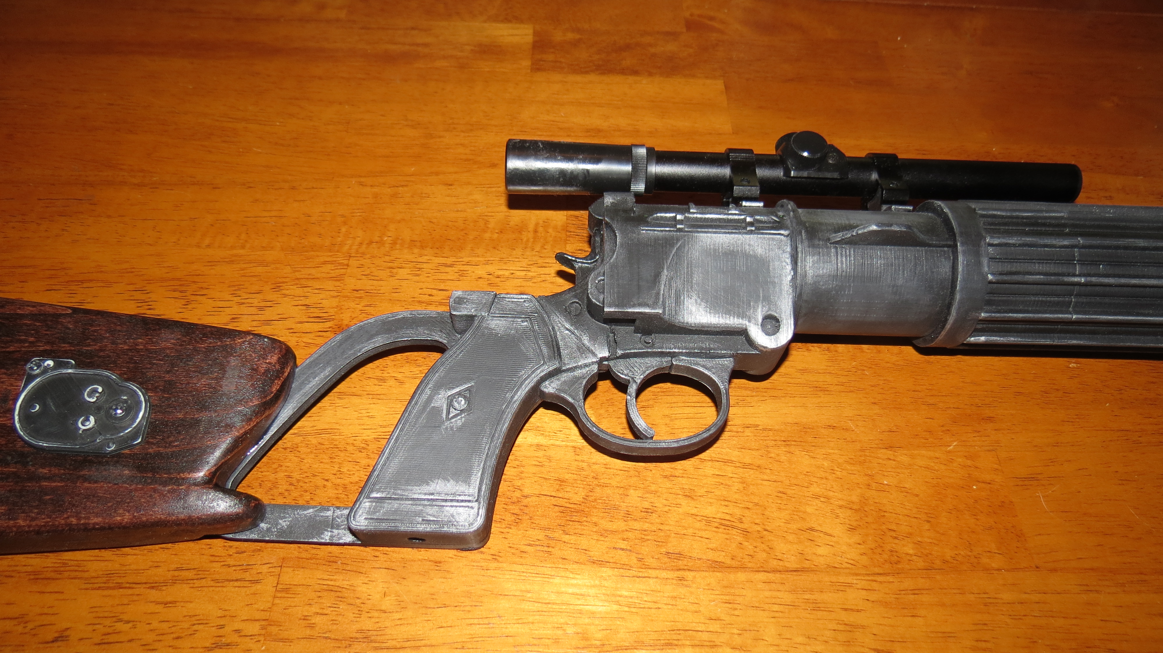

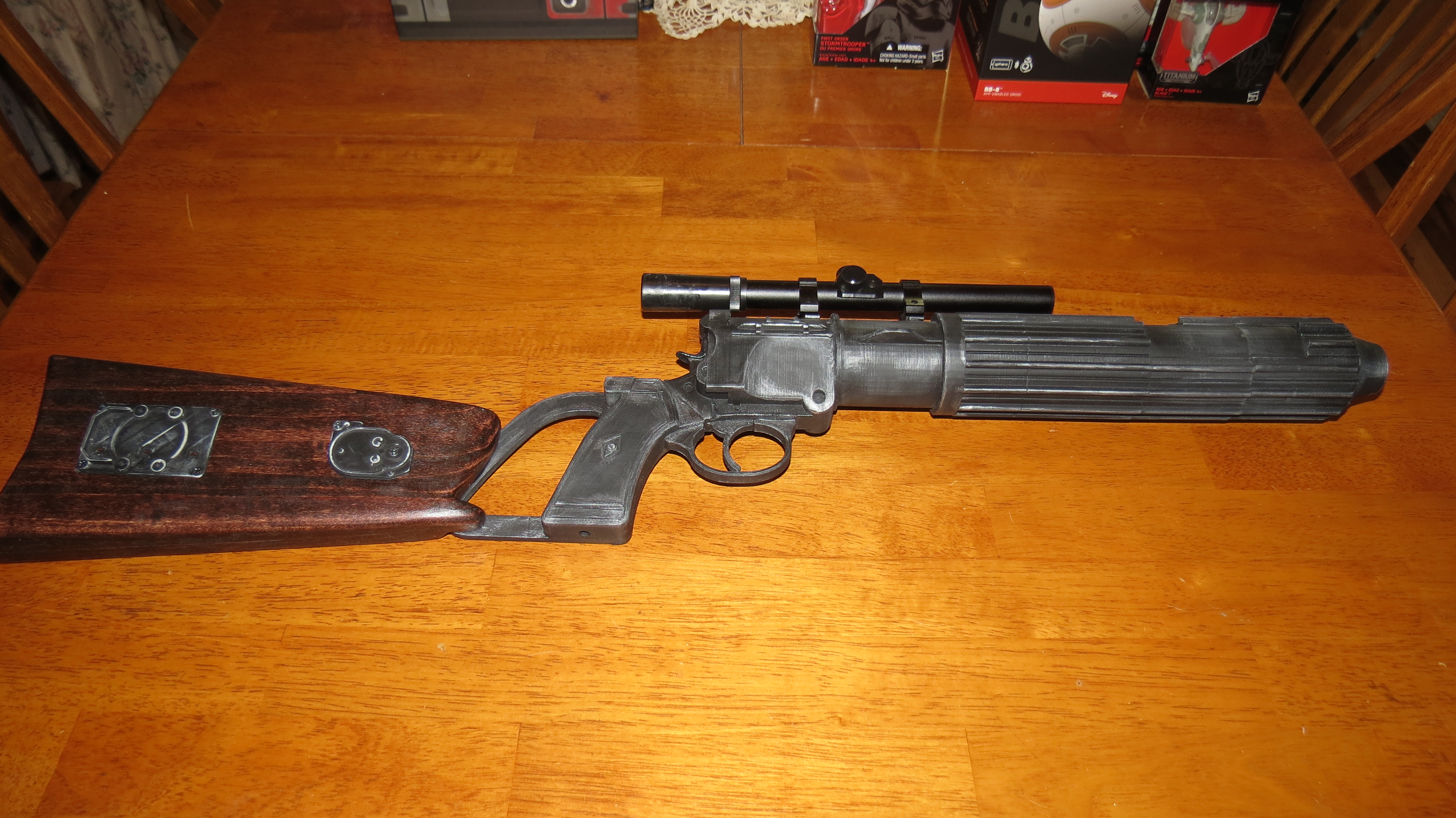

And we're pretty much done! (Although, as artists we are NEVER done, right?)
I still need to dirty up the gun scope but I'm not 100% sure I like the one I used.

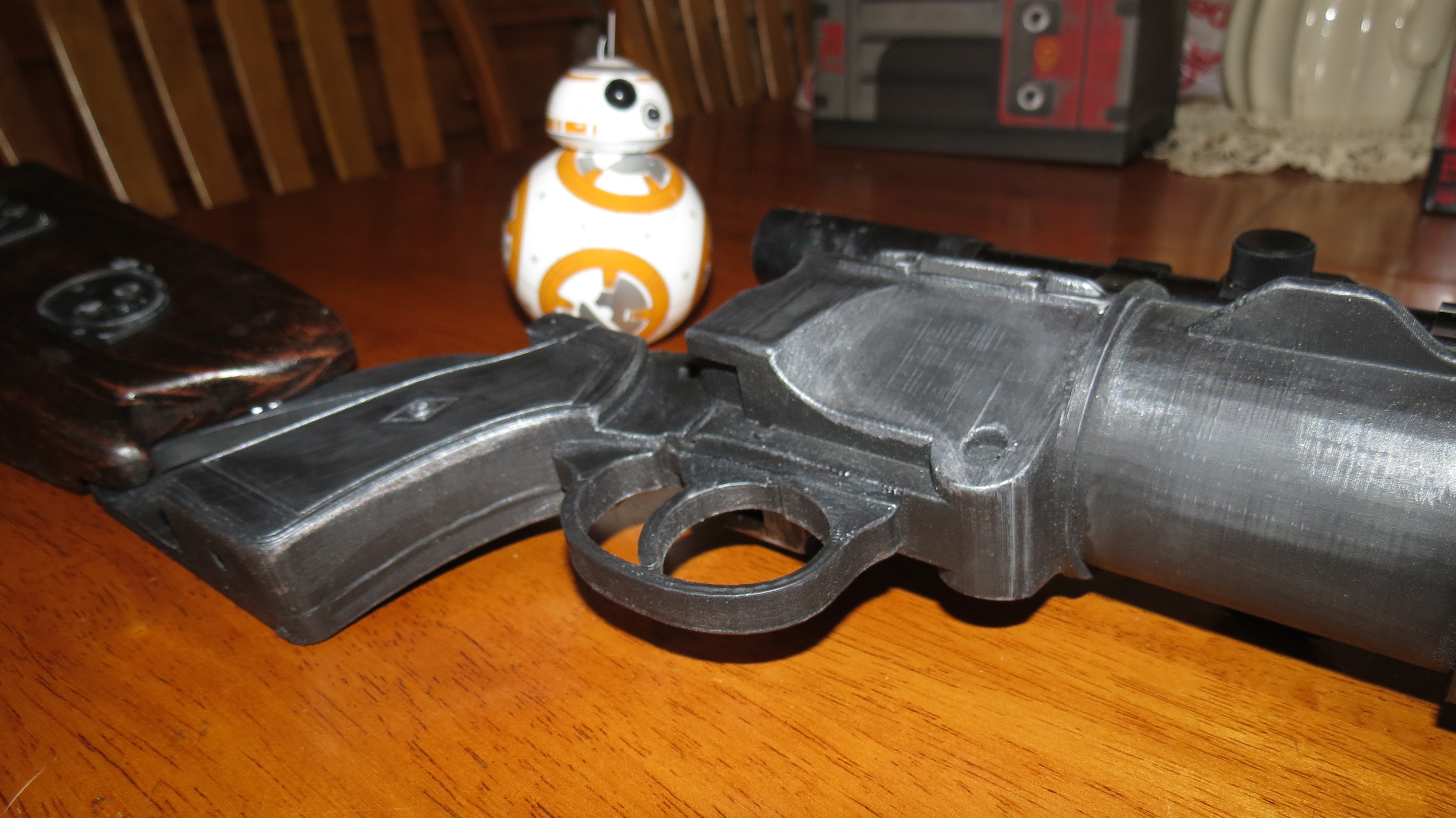

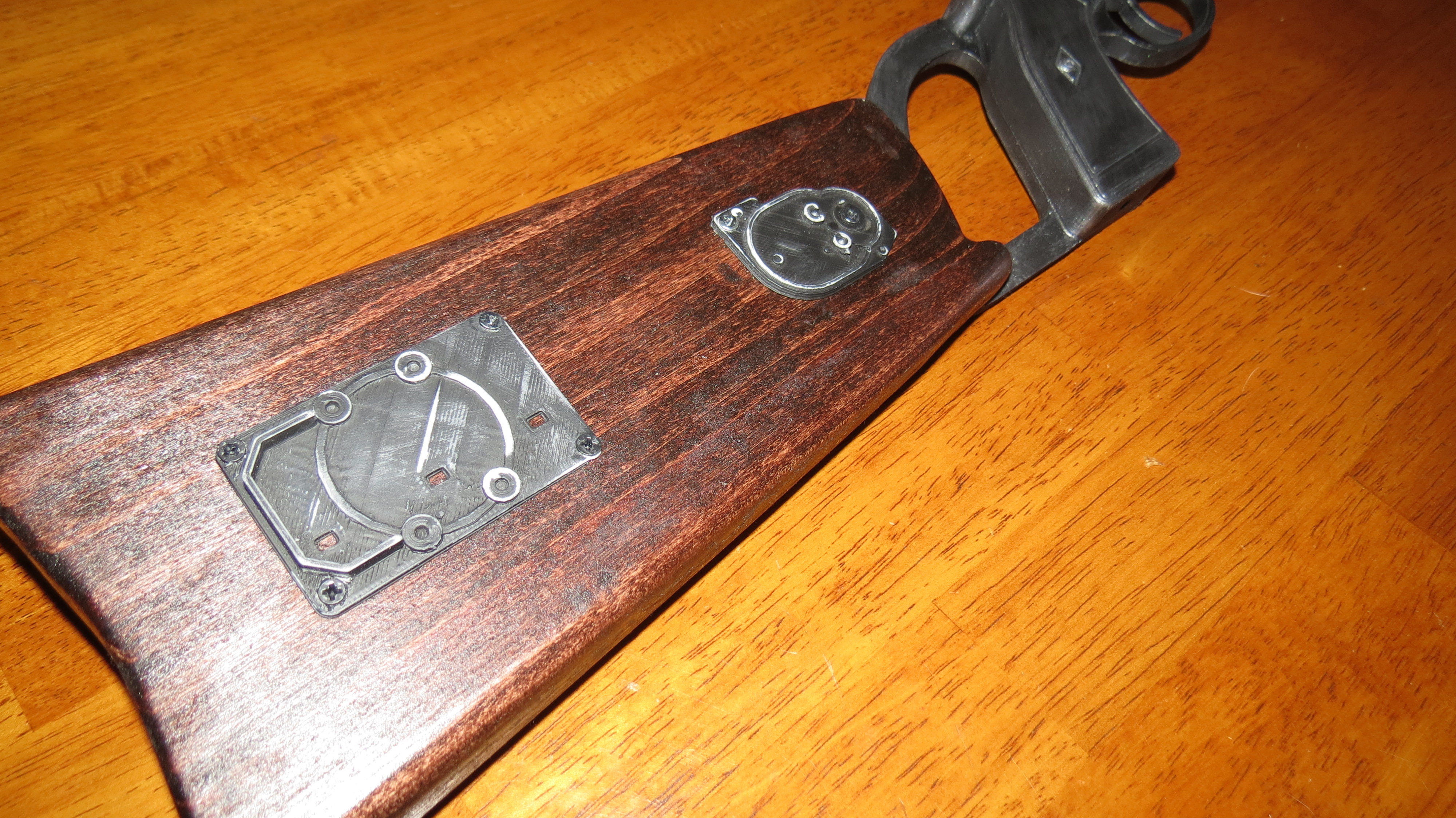

Today I finished up the stock coating, screwed in and painted the greeblies and did some last minute aging. I'm not happy with some of it so I'll be noodling with it in the weeks to come. When I age, I hold the gun a lot and go through the motions that Boba Fett might go through so I can see where the wear might be. Where are his fingers? Where does it bump against the armor on his chest? When he sets the gun down in Slave 1 how and where would it ding around? Maybe that's overkill but for me, it was part of the fun.
Total time on this project would probably be over 100 hours. Materials were probably 1/3 of a roll of 3D filament, a 2' foot piece of poplar, glue, paint, some screws and a scope.
Hope you all enjoy and thanks for reading. Happy to answer any questions.
Mark
